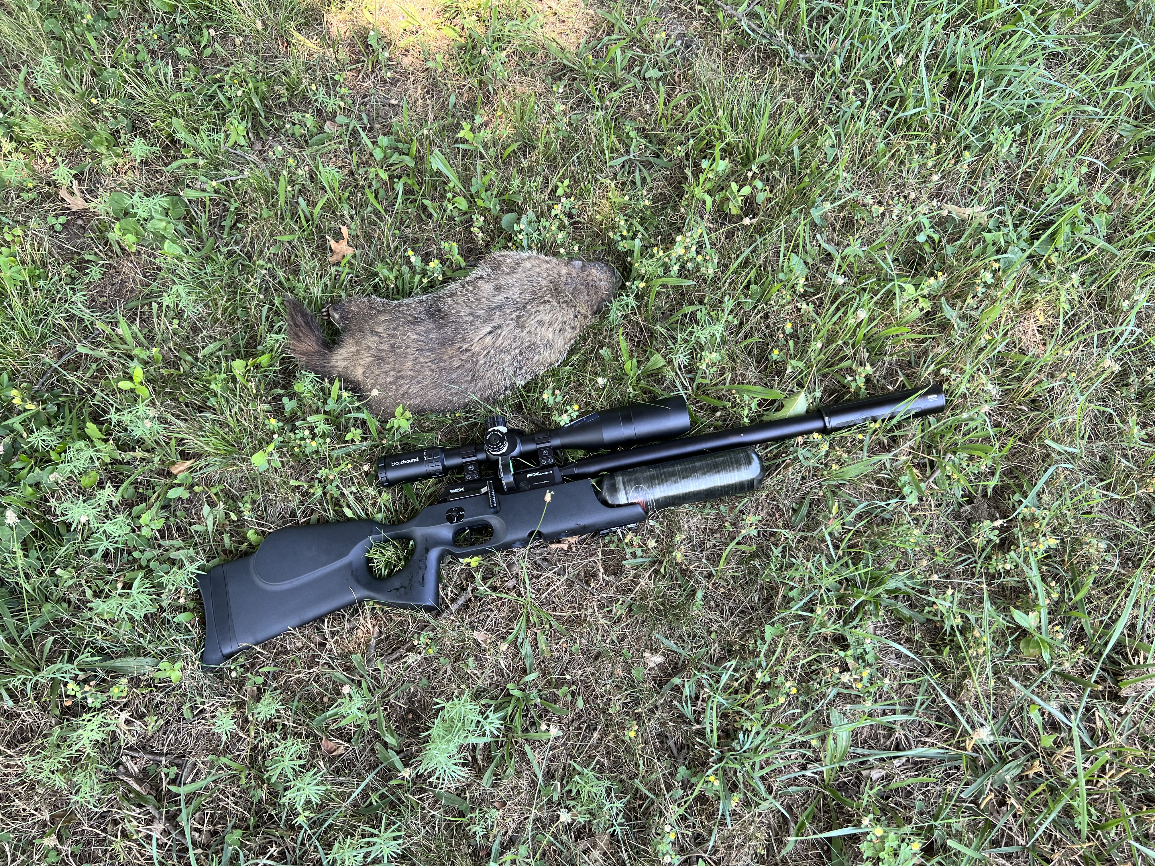

In my experience, slugs for groundhogs. Pellets for paper, squirrels, birds, etc.
Groundhog shots for me are farther than 50 yards typically. Slugs kill groundhogs on the spot more efficiently that pellets. Thats just my experience. Your mileage may vary.

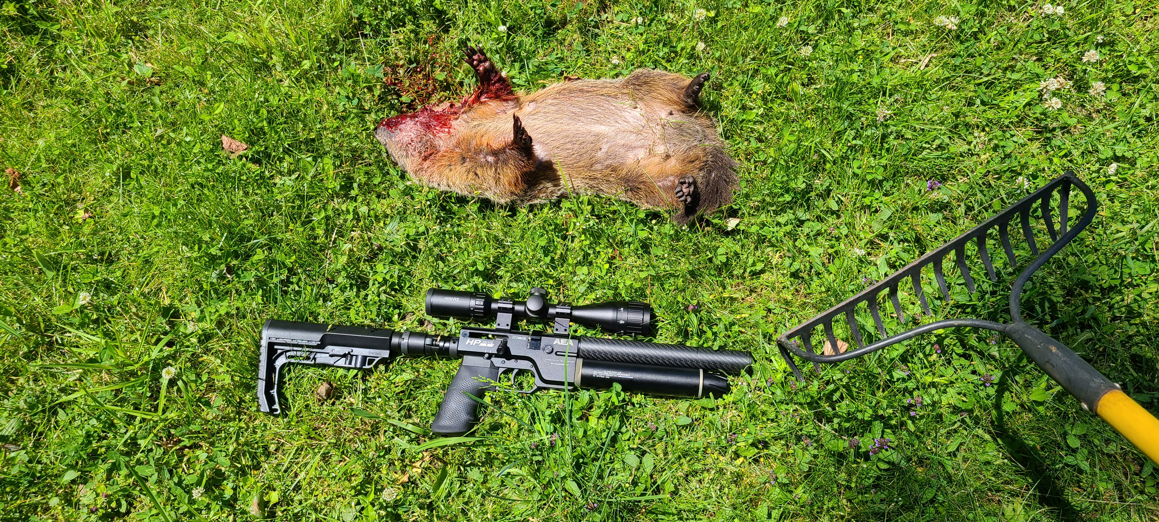

I haven't tried slugs yet but 1 pellet took a big hog down, had to put 2 in the head to completely decease it
One slug is all they need, even at 100 yards
