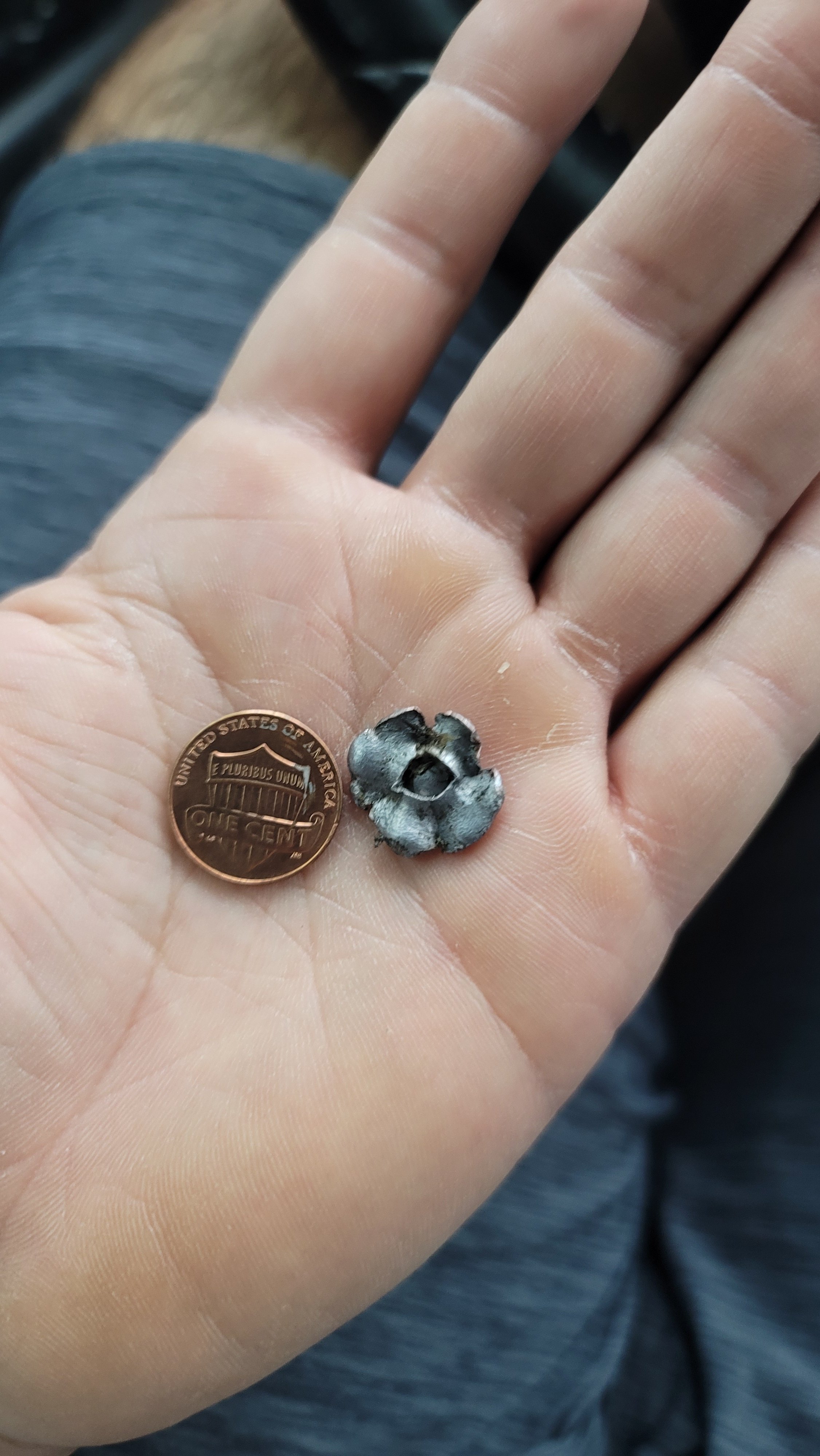

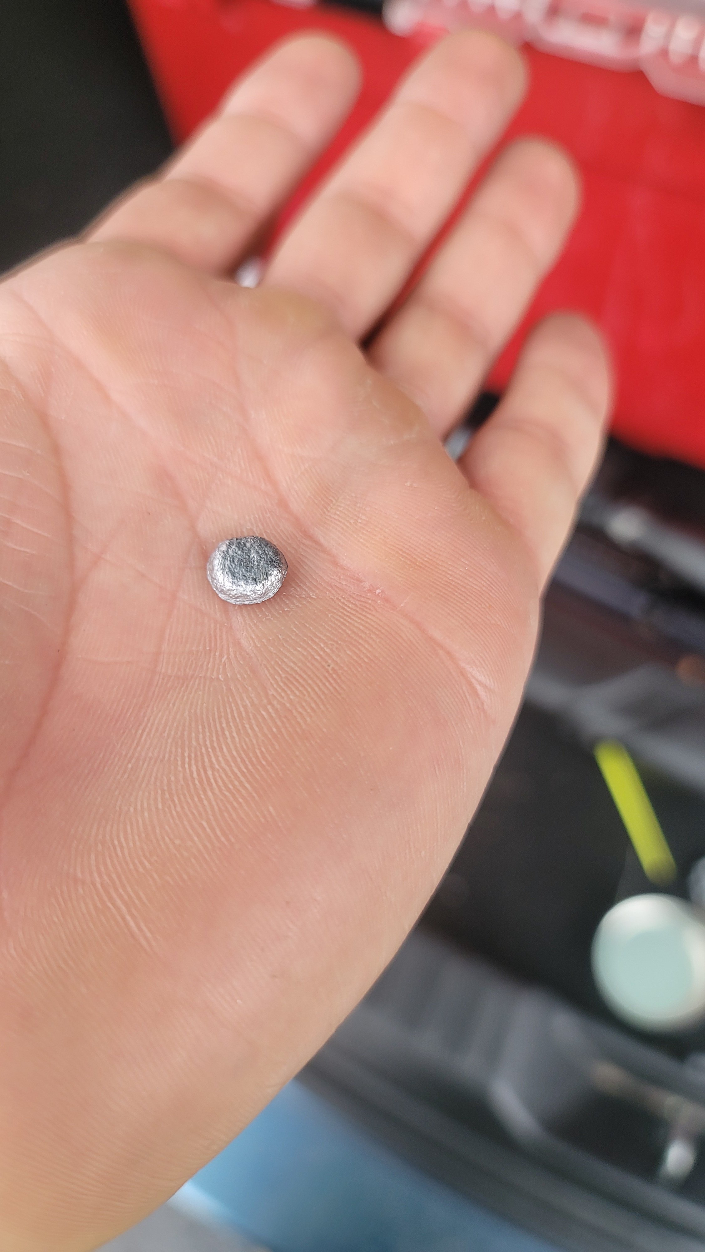

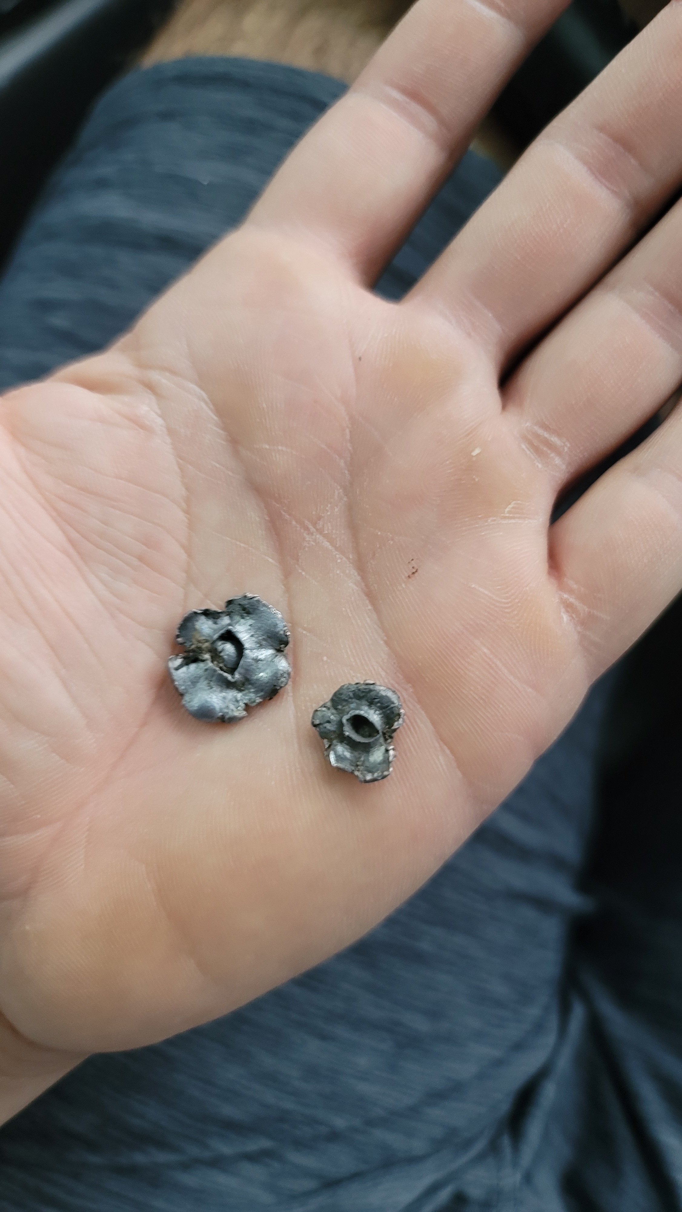

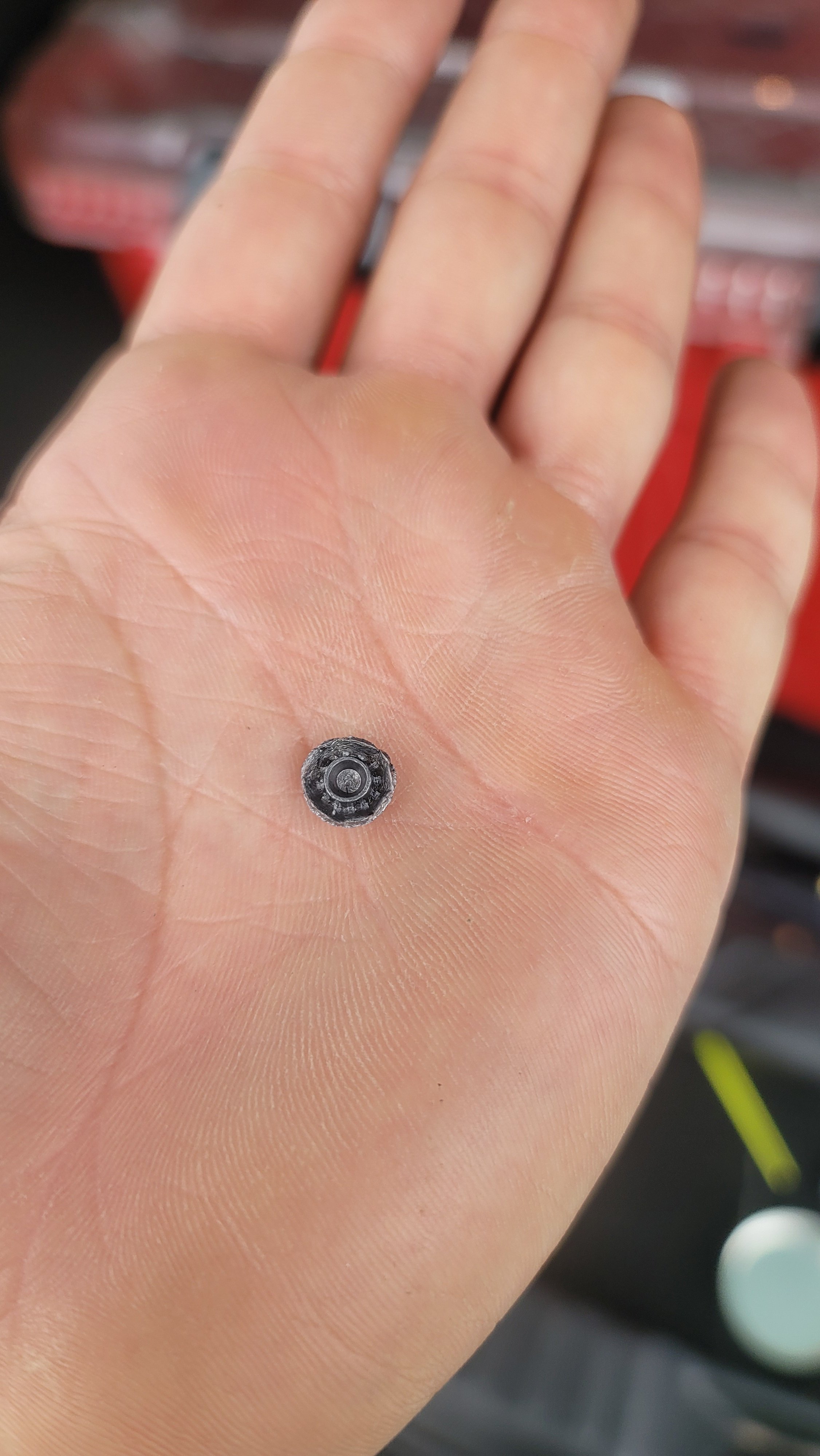

So currently my AT44 is doing 923-930fps with nielsen 15gr. I just shot a slug into a full bottle of water with a trash bag underneath folded 6 times to try and prevent the slug from just burrying itself in the ground. Not sure how fast the 13.4gr KO is moving but I am going to assume about 980-990fps if given the same FPE. Since it's smaller I'm going to say it's moving just a tad slower. I shot the KO slug into a tall cup of water cause that's the only other thing I had on me. But this is what the KO slug looks like after I was able to recover it. The NSA slug just went through everything and burying itself in the ground regardless of fold bag underneath.

Hmmm, this summer I test the expansion of JSB Redesign's vs Knockouts in 25 cal.

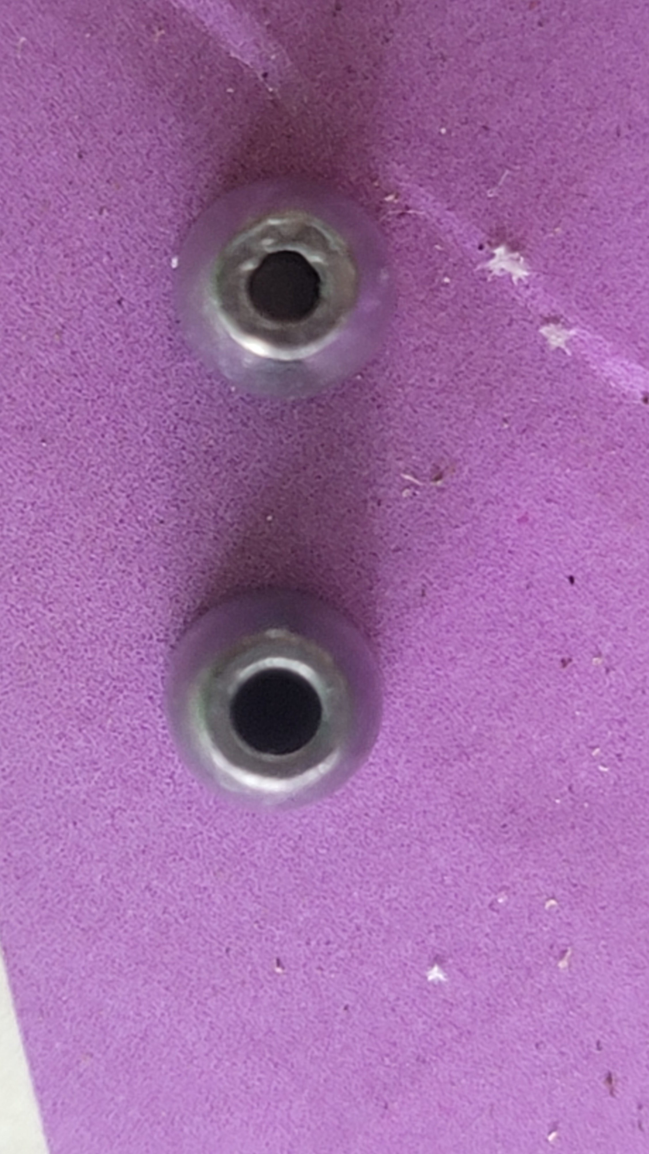

Alright, I don't have anything to measure as precisely as possible at the moment. But here. I took up-close pictures of both slugs, and the tiny wood chip pieces are how deep the hollow point goes and it seems to be about even, maybe 2mm for both? I tried to put a 1.5mm allen in the hollowpoint to see how wide they both are and I could only put it about half way in the Jsb knockout, I'm think the hollowpoint is somewhere between 1.5mm and 1.7mm, whereas the nsa I'm gonna say is somehwrre between 1.1-1.3mm wide. But again, I've never seen nsa slugs expand anywhere near as much as other slugs, so maybe the side wall are thicker? Not sure though.

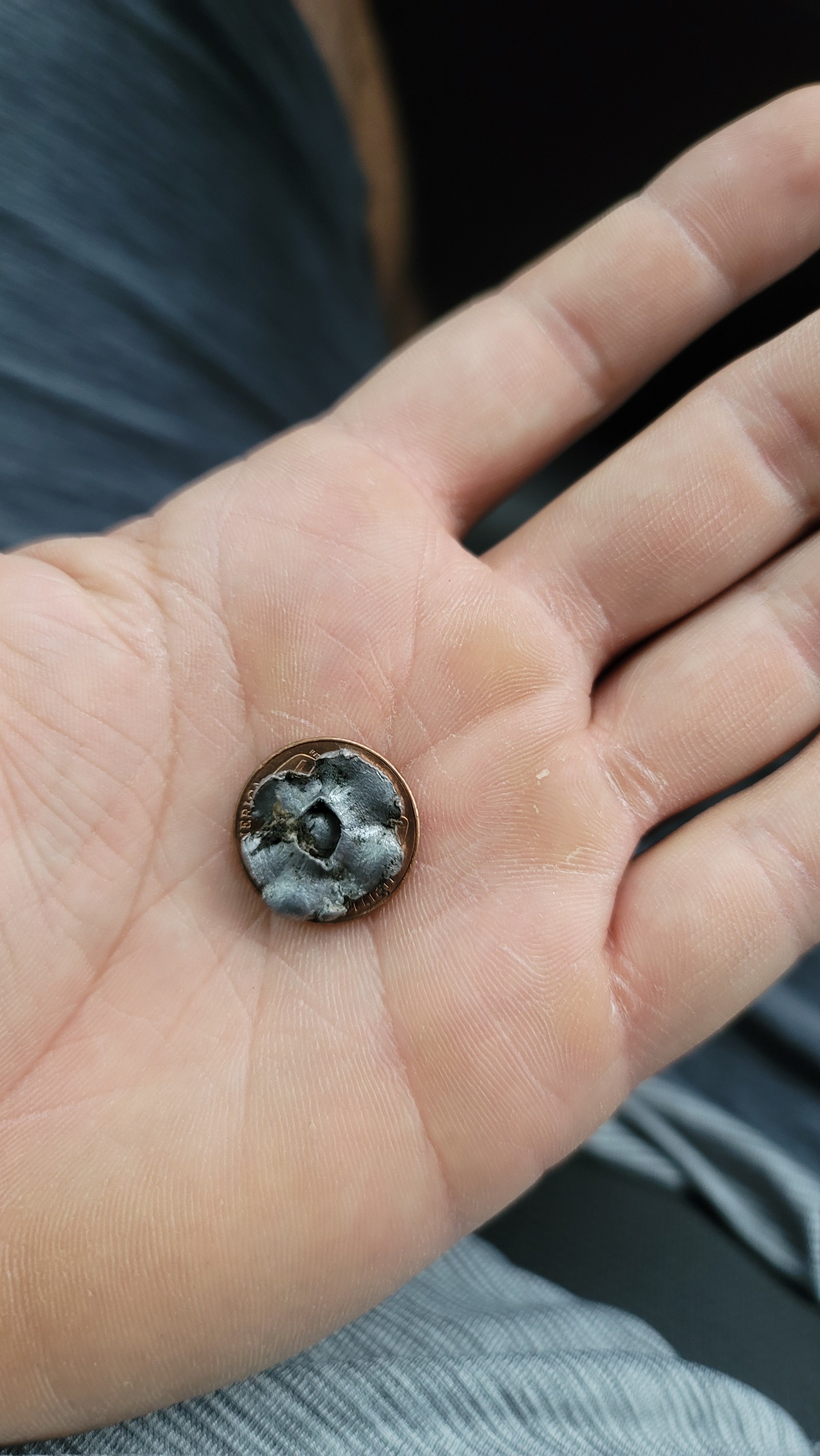

Yes, I do understand that that is also a factor, in .22 varmint knocker I believe uses a n2 nose for their xlhp and anything sbout 880fps and that slugs fragment for me. This is a javelin 49gr going about 935-940 that went into an iguana and came out. And the other one is a 21gr javelin going about 915fps that I also recovered after shooting an iguana. I have seen good expansion from NSA on larger calibers like 35 and up, either way he makes amazing slugs. They just have their place for me.
