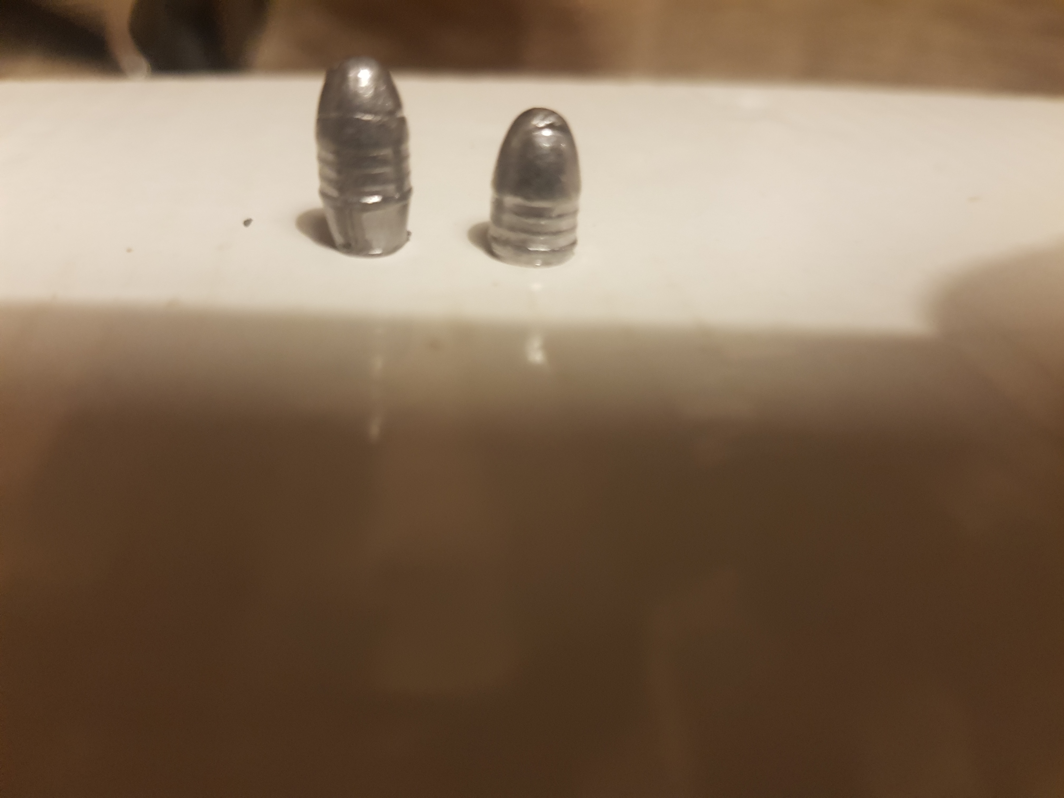

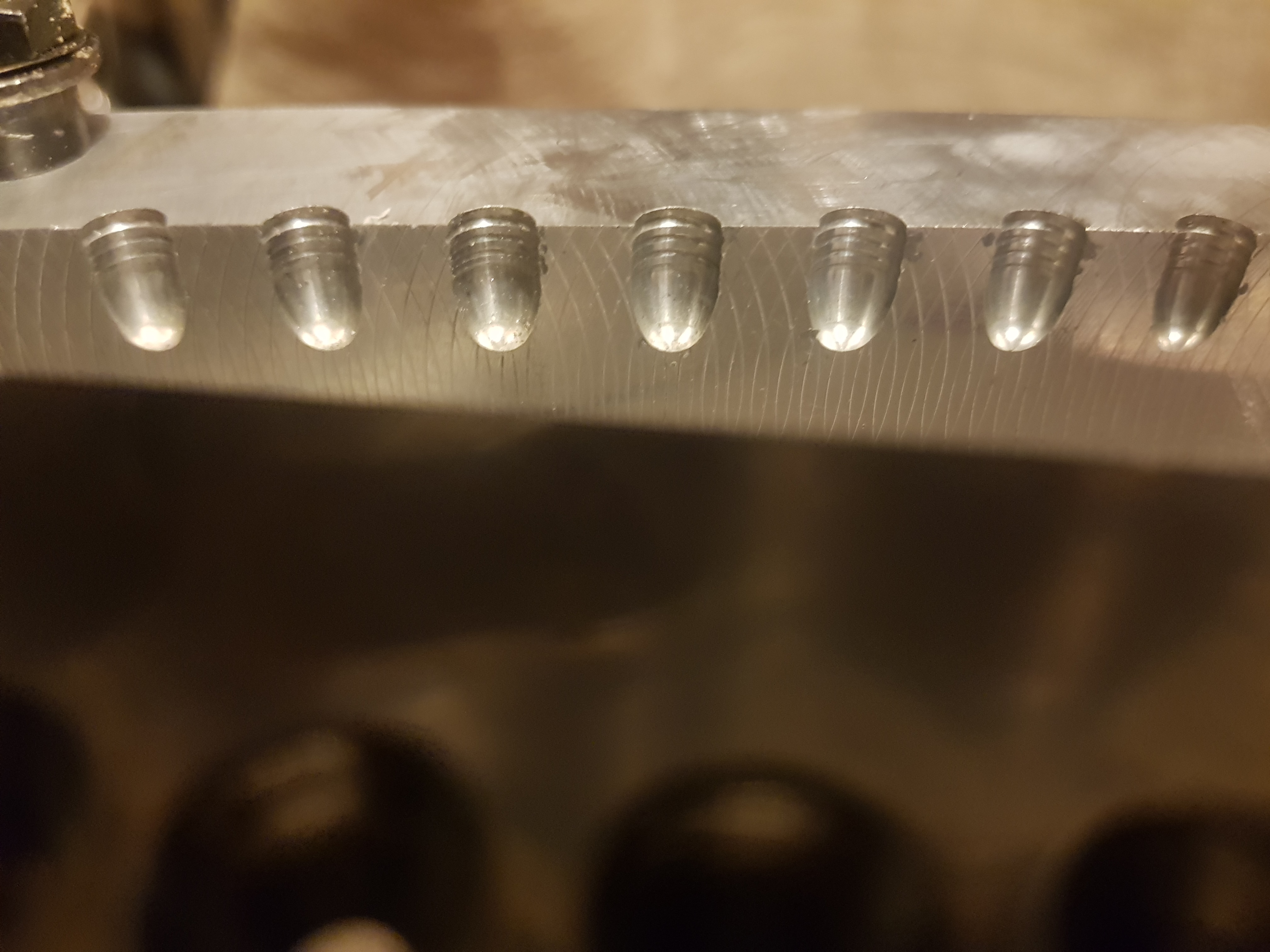

The slug in the pic with 3 bands" I bought the mold as I liked the look of the slug" the mold has had 3mm milled off it " so the boat tail has gone and it's going to have a hollow point in the face
The 3 bands are what hits the rifling ie less friction " whether they work or not is another thing it's all trial and error weevil
