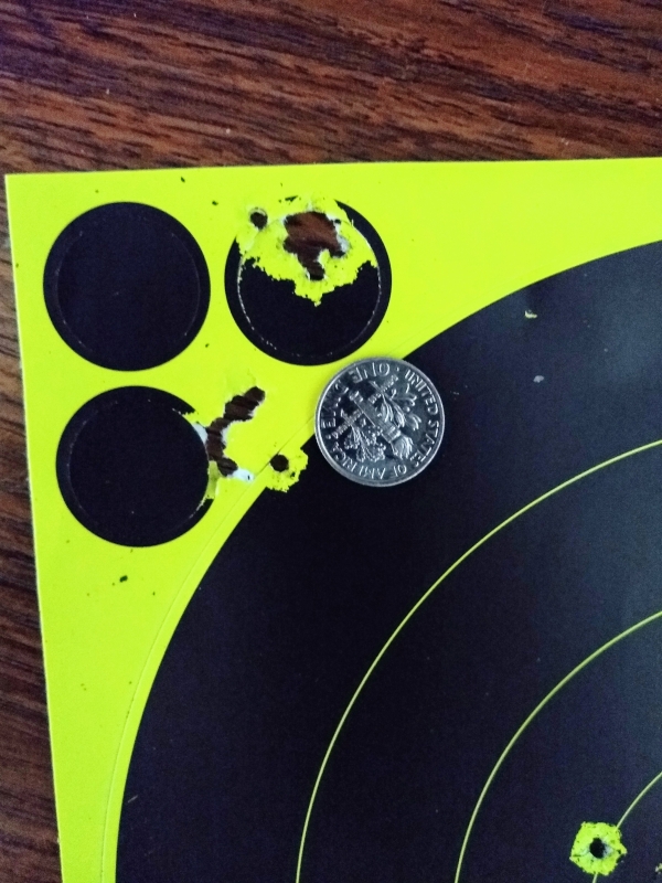

23gr NSA shoot lights out of my edgun R5M Long .22. 2 5 shot groups at 55yds can't wait to try them out hunting.
