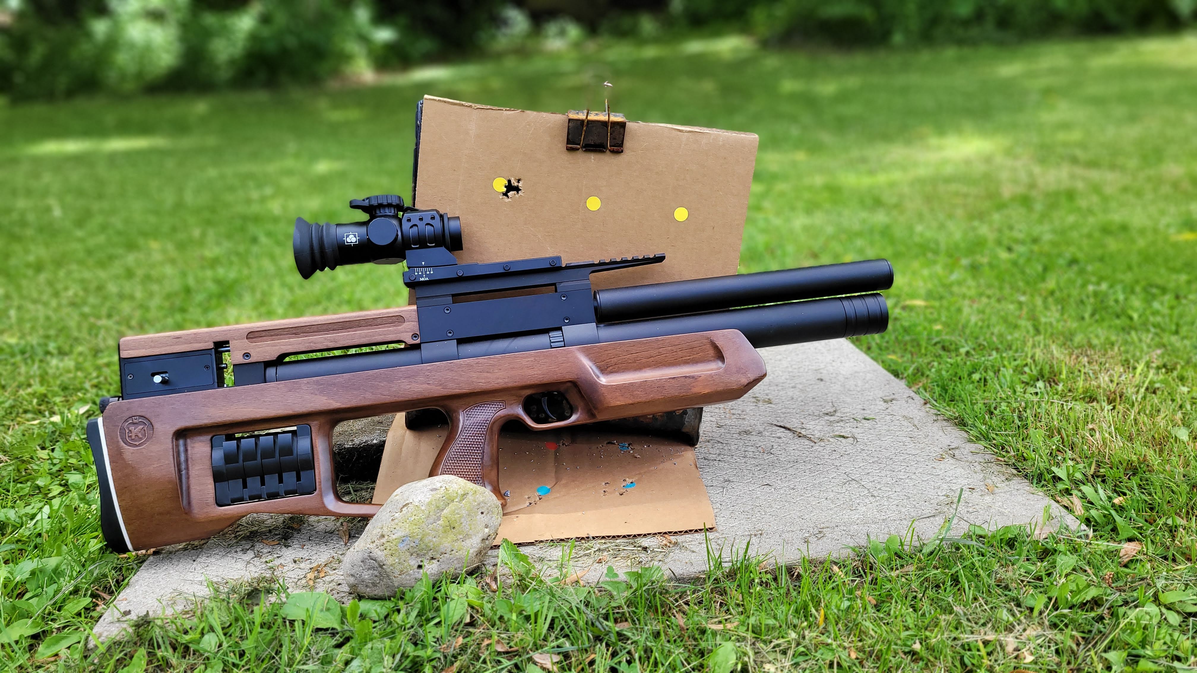

I'm using a West Hunter WHT 3-12x44 FFP SF IR. It has a Mil reticle, not an MOA. It measures 9.6" and fits nicely on my Atomic XR. I wrote about here:
