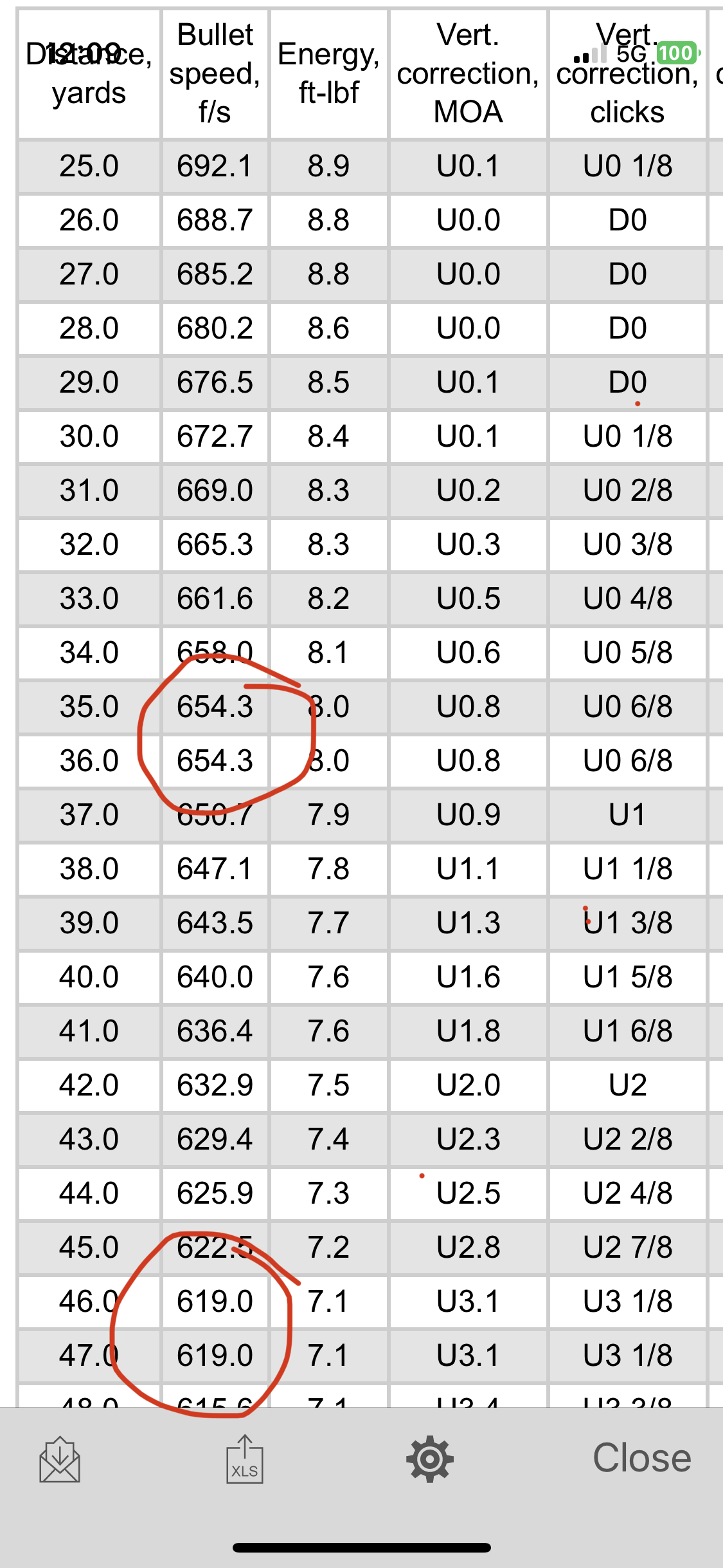

Something to be aware of when using Strelok. It can cause you to be off by a click or two at certain distances, especially with low velocity projectiles.
Past your zero, Strelok only calculates data in meter increments. So if you are zeroed at 25yds, but want dope for say 35yds vs 36yds, there will be no difference between 35yds and 36yds since Strelok rounds them both up to the same meter distance. Same will happen at 46yd vs 47yd, 58yd vs 59yd, etc.
Same thing for ChairGun Elite as they appear to have stolen the Strelok engine (warts and all) to use in their current ballistics app.

That’s a different issue. Scopes base their click and holdover values from the reticle/focal_plane/gimbal. So I take my distances from the magnification ring as that is the approximate location for the gimbal.
The issue I’m talking about here is this, where different yardages (35 and 36, 46 and 47) give the same velocity, same clicks, same dope:
46yds and 47yd are both giving the dope for 43 meters, not for the actual yard distances.
Until they get fixed, if you want the best precision with these apps, you can use meter distances instead of yards and keep the step distance at least 1 meter.
