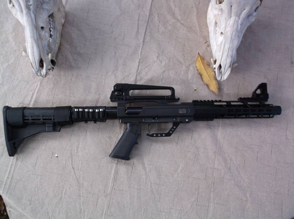

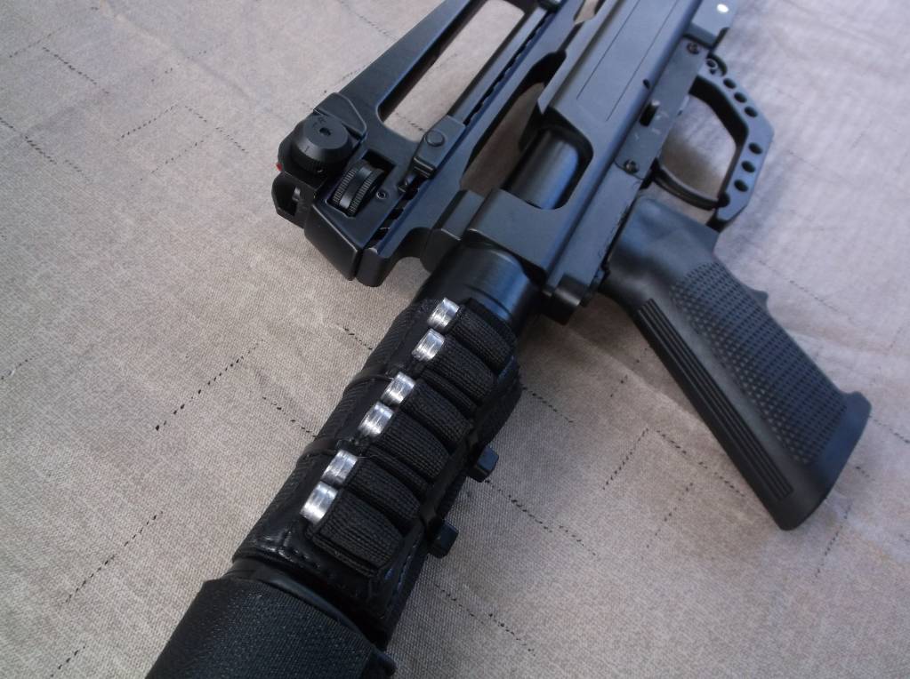

Small, light, open sight Arrow gun.
I had this in mind for a long time but I was waiting to get a .50 to put it together, unfortunately the price of guns nowadays is to rich for me.

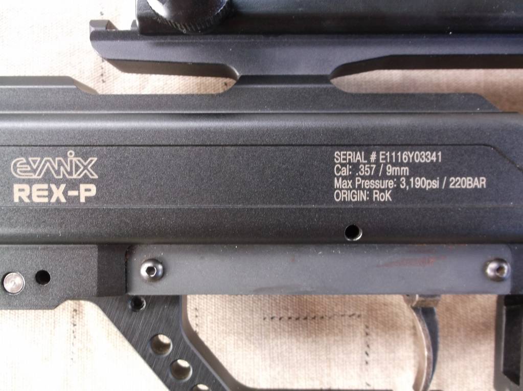

So I got one of my three .357 and build it off that.
This particular gun actually started 6 years ago as a Pistol, it has gone through a variety of configuration and it ended up like this,...for now :)

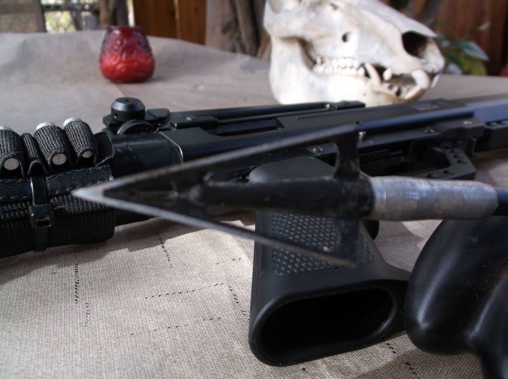

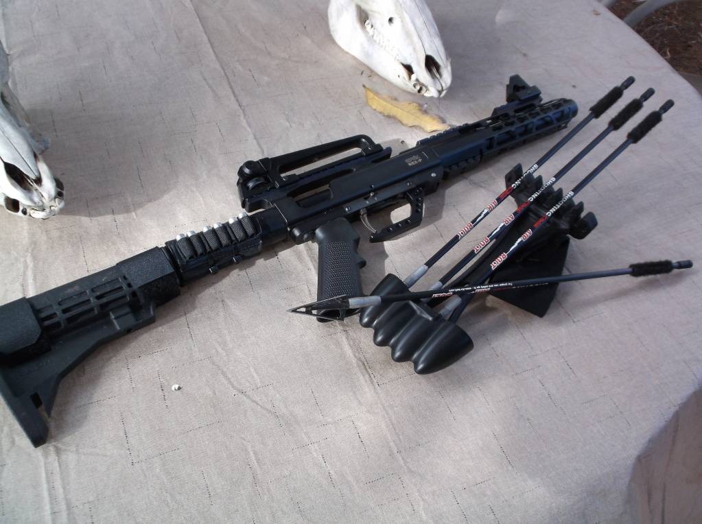

She sports a 14.5" barrel that I cut down from a 20" rifle barrel, AR Grip, AR buttstock, I took a slim handguard from my AR9 that I don't use but I had to cut it down, the bullets holder is from Amazon and I think it's about 11 Bucks
She shoots the 350gr arrow at 475 fps @ 200 BAR, so if I would fill to 250 BAR it should easily break the 500 fps mark.

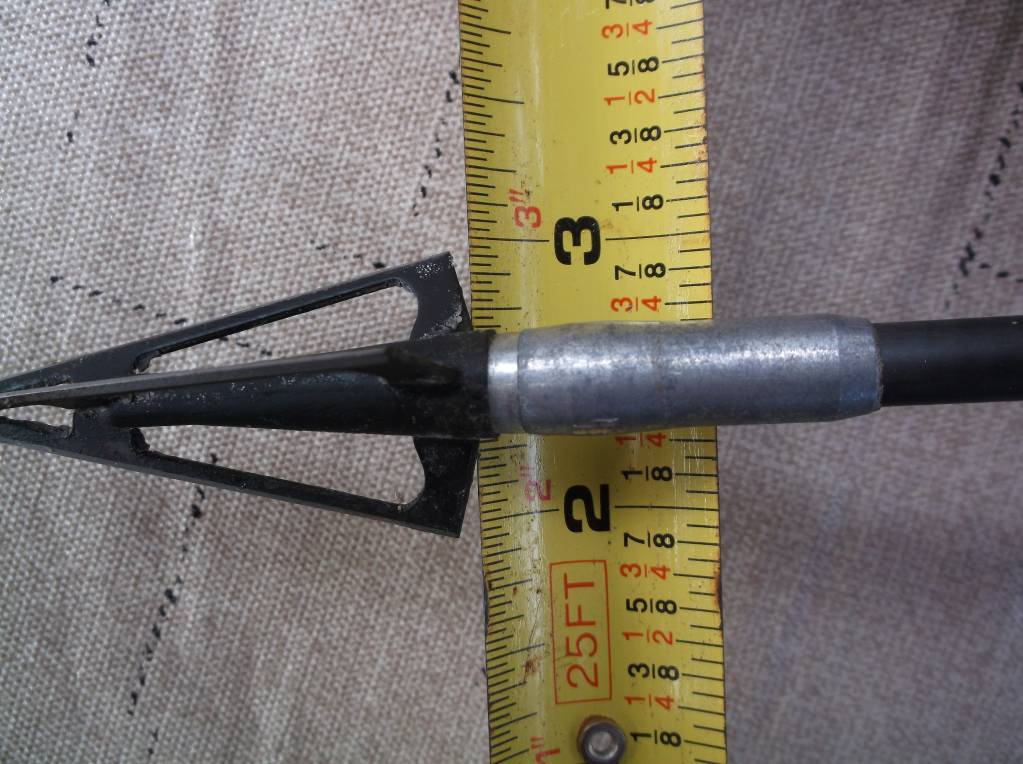

The Magnus Snuffer head has a cutting with of over an Inch, that is a devastating wound channel and this gun could take down any animal on hearth with this set up.

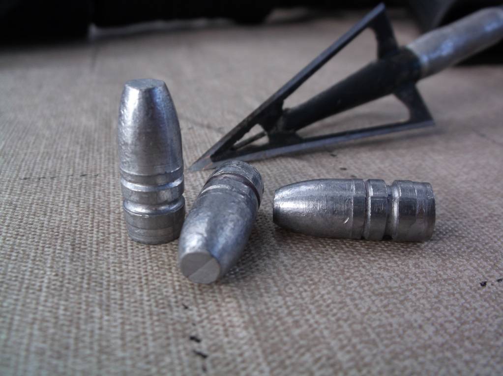

Bulletwise I shoot a 200gr flat nose, this way with the gun sighted in at 20 yards POI with the arrow is basically exactly the same as the Bullet
The gun is 28" long, 5 # all loaded up and when broken down fits in a small pack.
Perfect packable, lightweigh, tiny, powerful, rugged Hunter
She did great yesterday on a hog hunt,
perfect small, light, thick bush hunter
View attachment 210997View attachment 211005View attachment 211014
View attachment 211021View attachment 211031View attachment 211037
