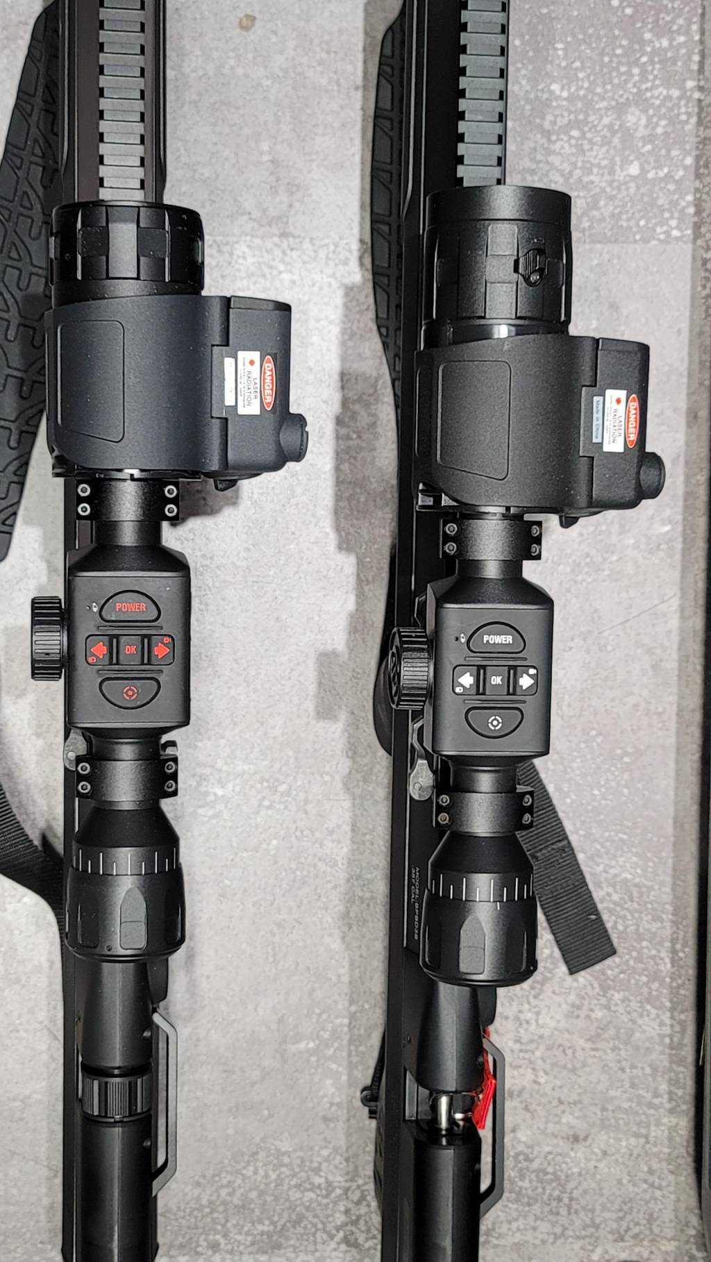

I use the Ballistic Calculator in my ATN X-Sight 4K Pro and my THOR 4 thermal scope, currently mounted on both of my Benjamin Bulldog .357s. Both scopes have the ABL 1000 rangefinder add-on too, which makes adjustment in hunting and pesting situations much easier.
My longest range confirmed kill was 105 yards using a Predator Polymag on a groundhog at a private business service road. I've had a few more hits at 107-110 yards, but by the time the round got to the target, they moved while they were foraging. This ended up with a less than ideal hit. All shots were caught on video in slo-mo.
If I were shooting larger game, like raccoon or coyote at 100 yard distances, I'd switch to the NSA 142gr boat tail slugs, for more downrange energy.
The biggest benefit is being able to swap from one distance to another without hold over/under considerations.

With the ATN Ballistic Calculator, if you add the ABL laser rangefinder add on, all that animal height stuff goes away. Many people aren't aware of that, and I use the Ballistics Calculator religiously on my X-Sight and my THOR 4 thermal.
Just setup your ammo profile, range and shoot. I have three profiles for my Bulldogs shooting Polymags, NSA 110gr HP slugs and NSA 142gr slugs, and when I purchase my Maverick .30, I'll add profiles for the Hades and FX Hybrids.

I checked the beam divergence by ranging at night while using the X-Sight 4K Pro in Night Mode, and it was fairly narrow. I also checked the same ranged distance to my albeit cheap hand held rangefinder, and they showed the exact same distances.
For my purposes, I don't see me shooting over 175 yards, so this solution will suit my hunting needs faster than doing the Strelok shuffle while I'm in the field. 😀
