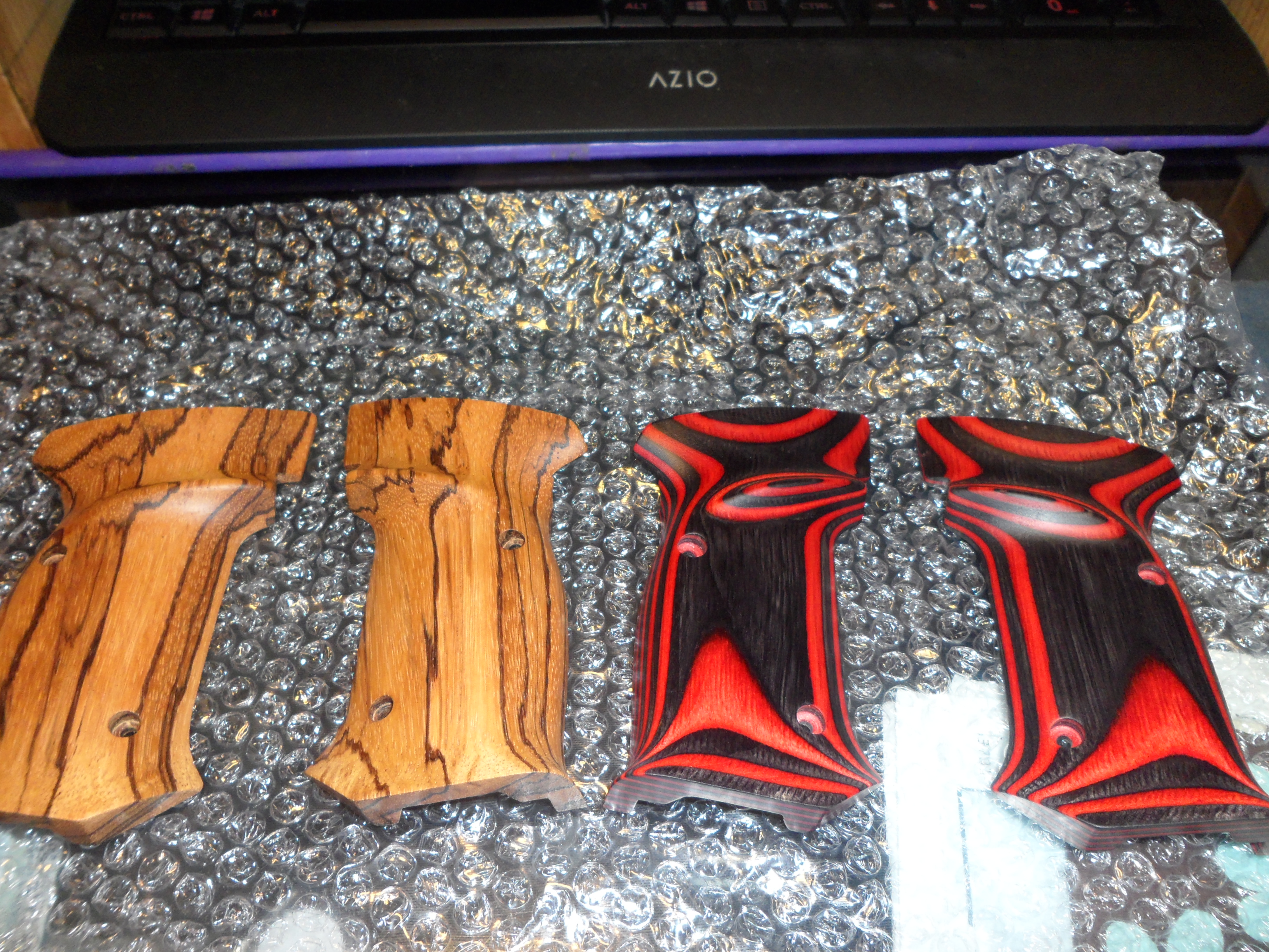

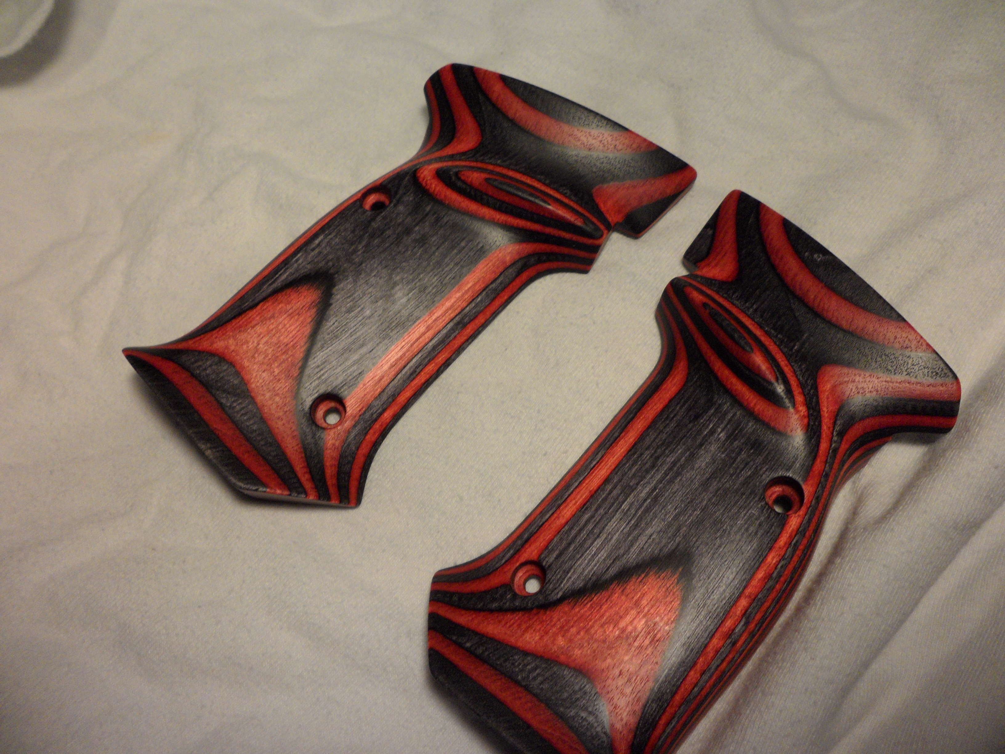

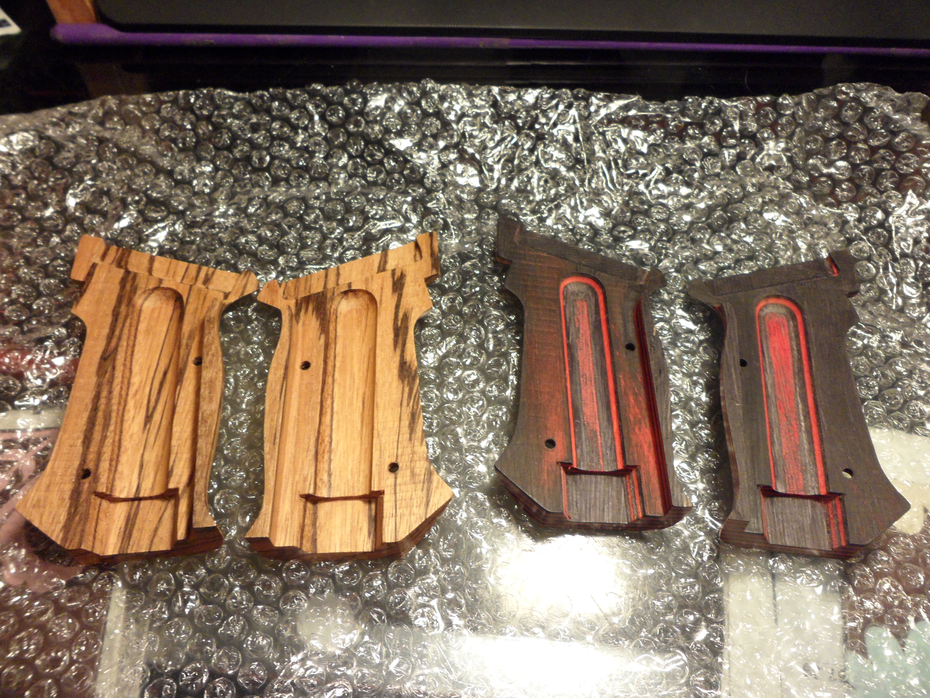

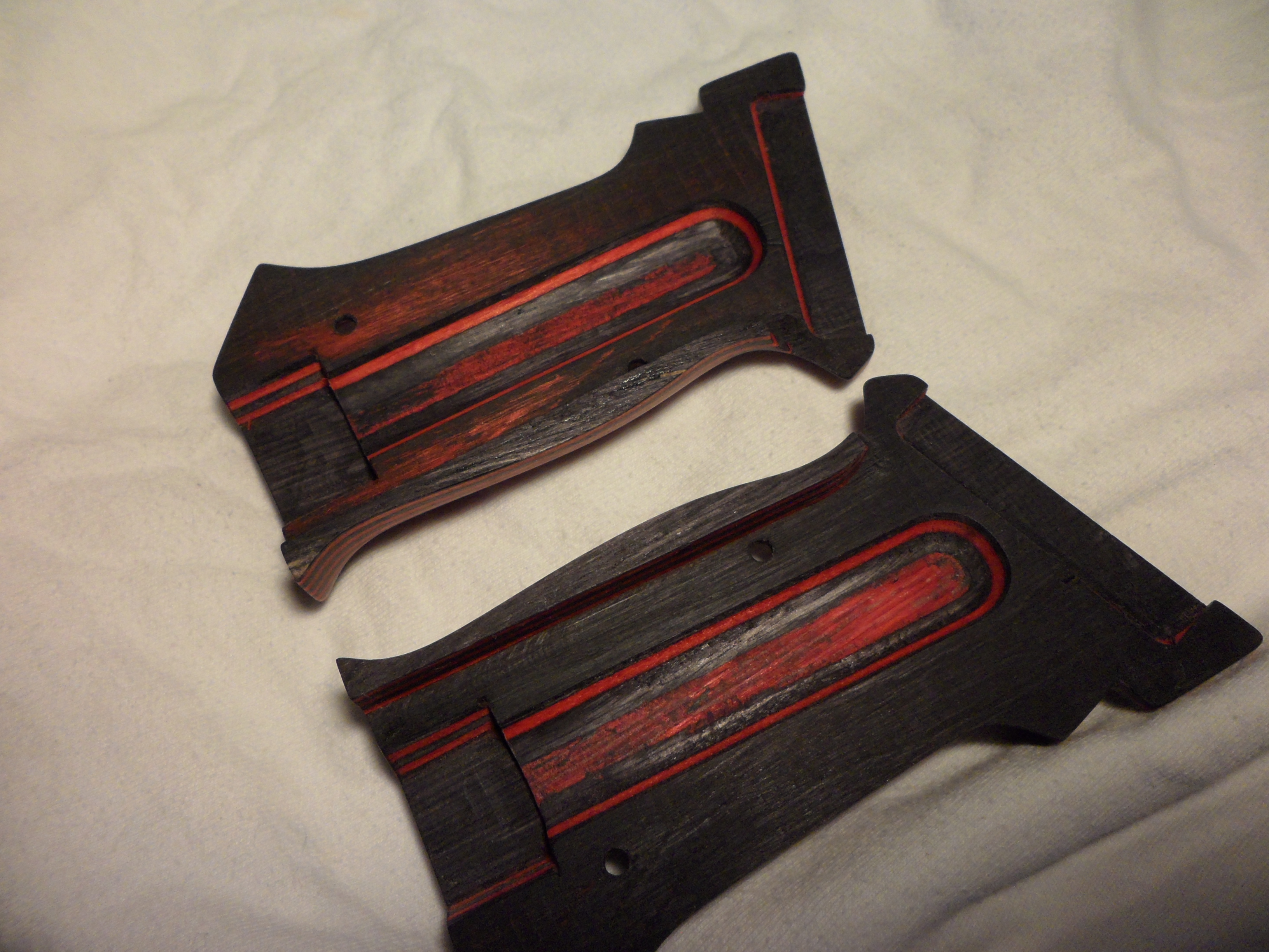

Other Smith&Wesson 78G pistol grips.

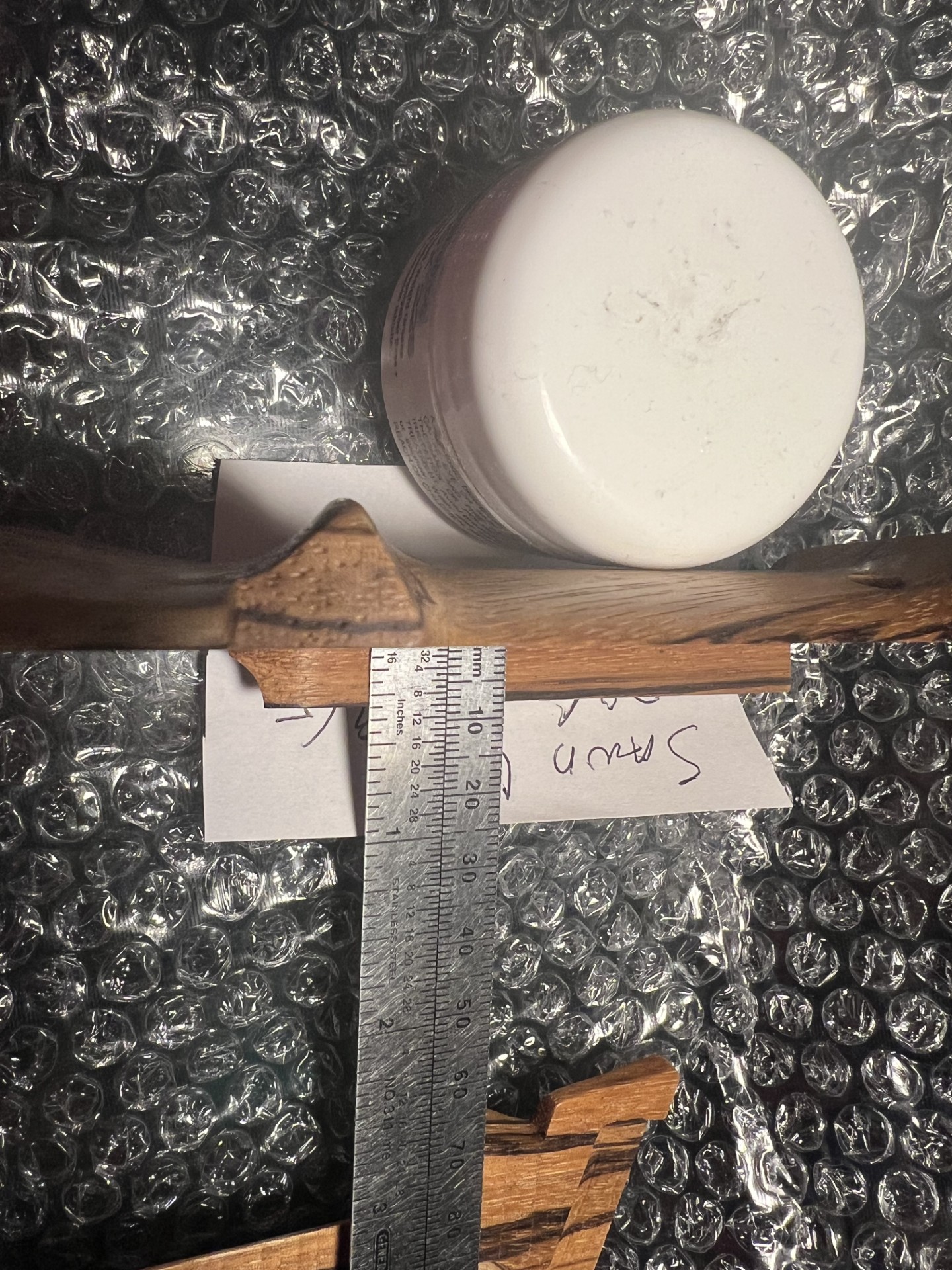

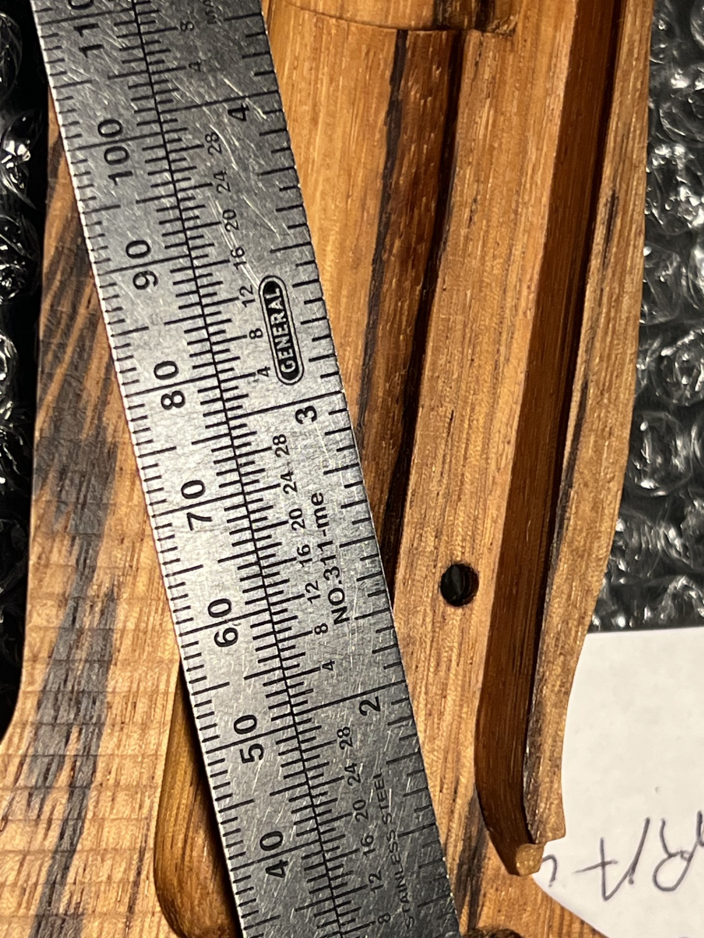

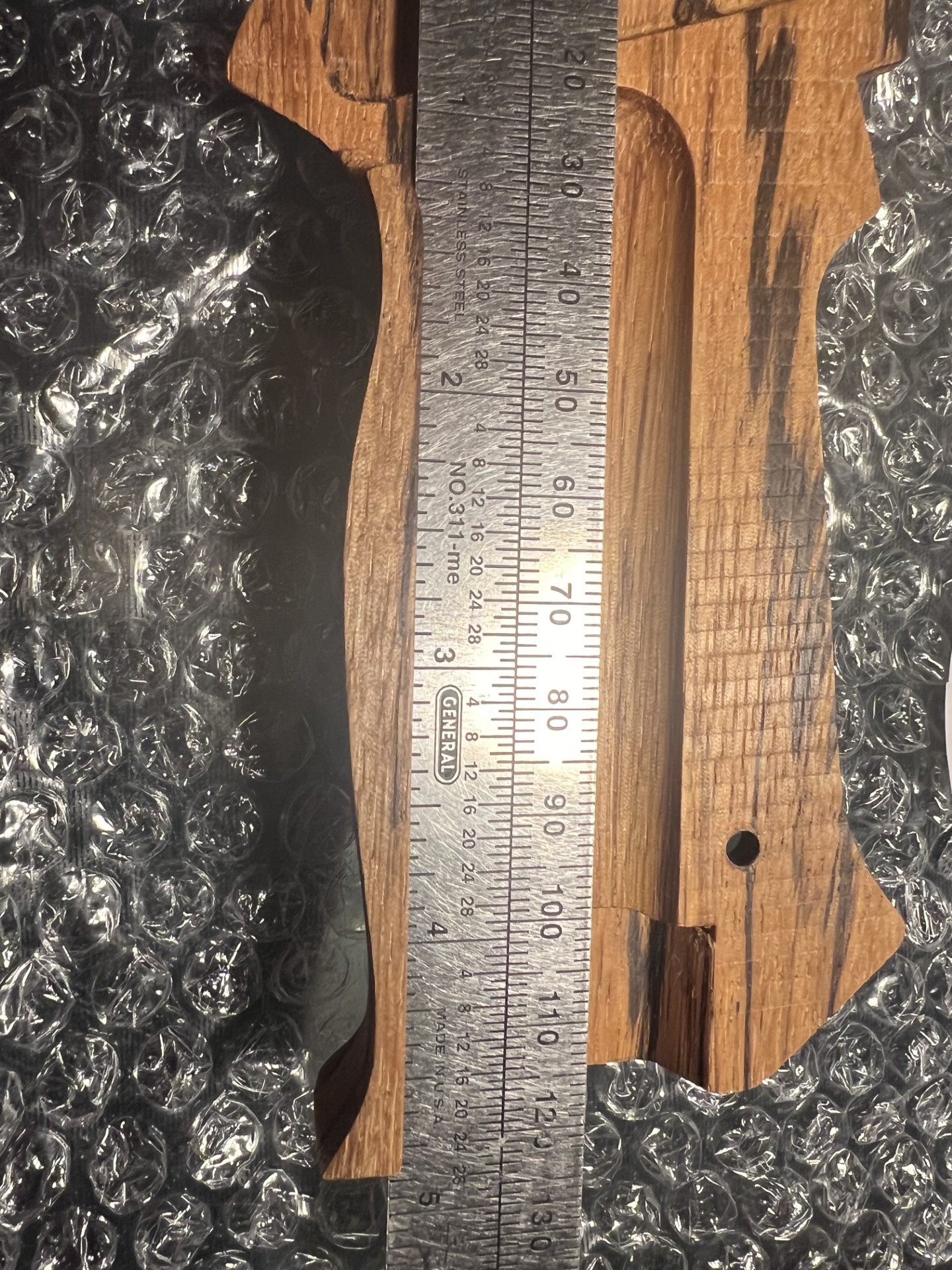

so you will see in these pictures that there is a small edge that could be added on too the flat surface
then the grips have 2 cut outs,
Thank you 777. I think I see what you mean. Once I receive the pistol, (in a few days), I'll be able to better assess what I would need/want to do.
Thank you for taking the time to measure and post these pics.
