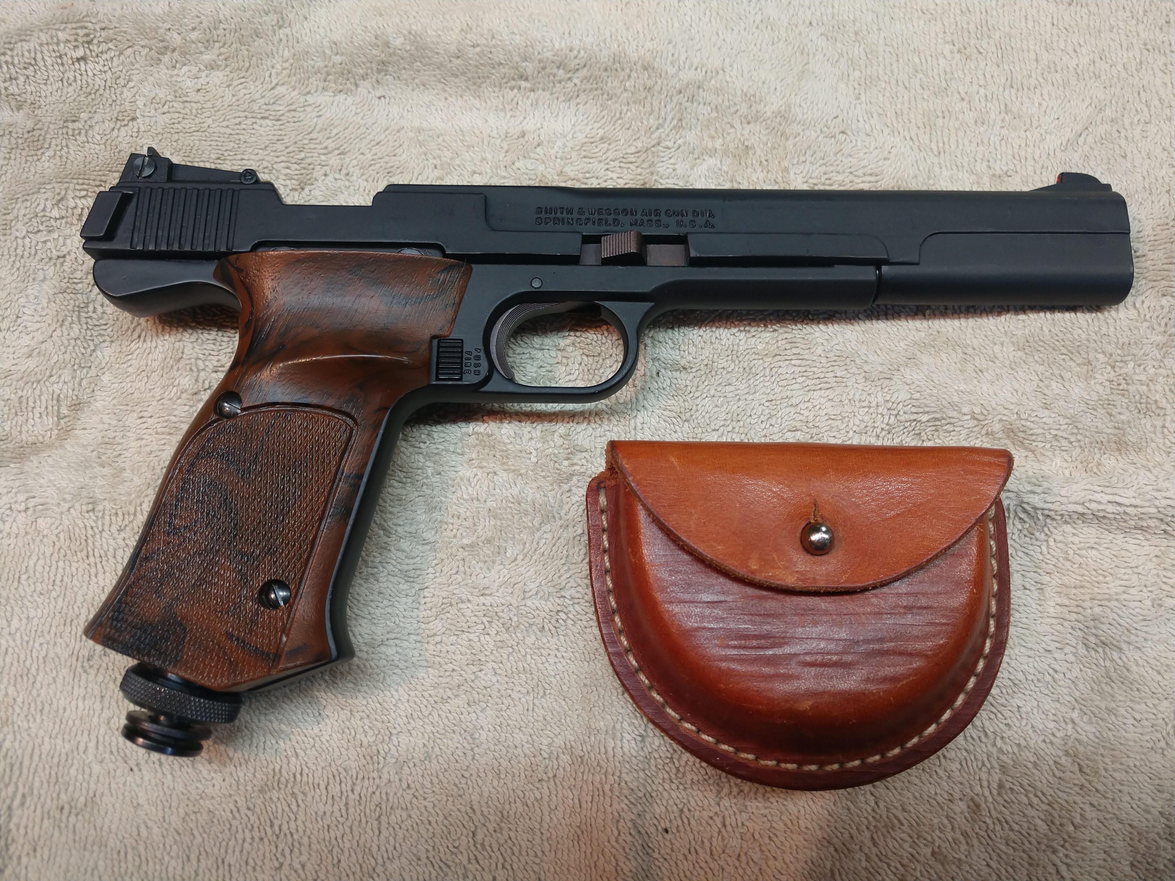

Other Smith&Wesson 78G pistol grips.
so you will see in these pictures that there is a small edge that could be added on too the flat surface
then the grips have 2 cut outs,
Thank you 777. I think I see what you mean. Once I receive the pistol, (in a few days), I'll be able to better assess what I would need/want to do.
Thank you for taking the time to measure and post these pics.
Very much appreciated!

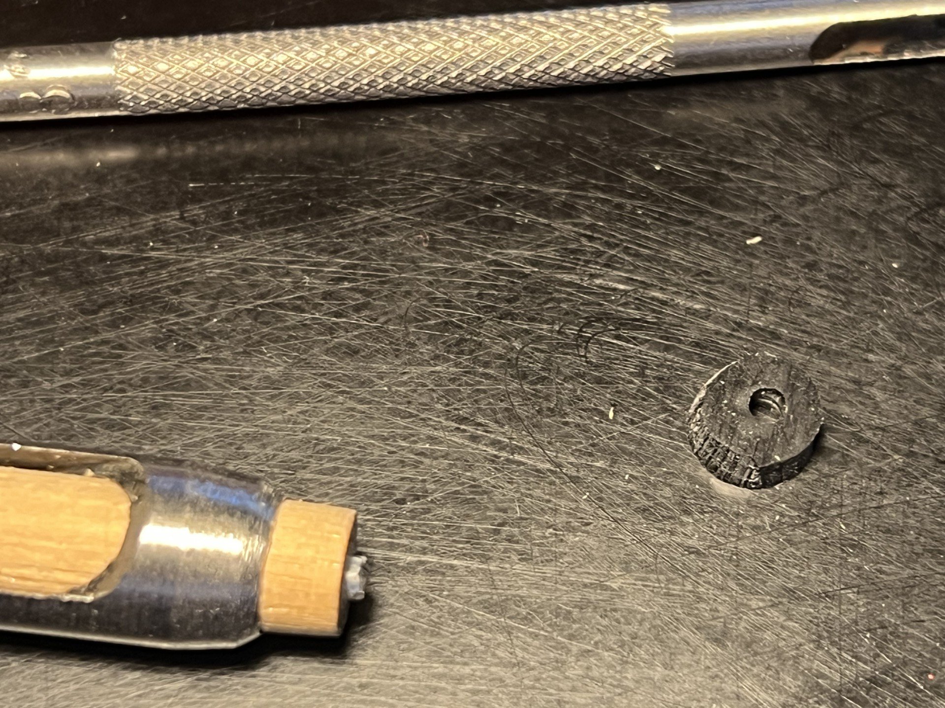

a leather punch will cut it but a few hard strikes are needed

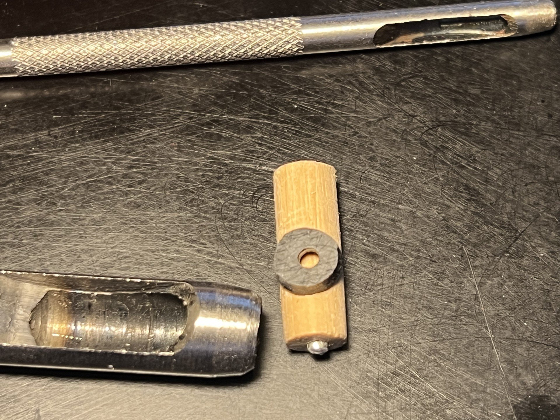

so, i had a problem cutting them and that is because once the small hole is cut you can't see where you are for the OD punch
so i took a piece of wood dowel that would side out inside the OD punch and that dowel had a locating pin installed and now the seals can be punch out as needed of course i needed three in the end but you have to make tools and get much more material to do a damn small job
now why do you have to do this, the stem has a barb for the lack of a better term on the shaft and that barb holds the seal in place
now that is a lot of words and time and money to make a5/16 inch seal with a 1/8 inch ID
but it is easier than sending them to JG to have them rebuilt
just ideas and how i went about it is it perfect maybe not but works as it should
