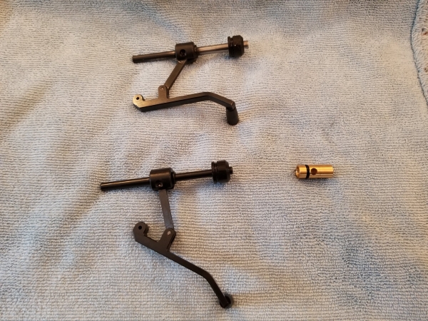

Here on the right, that's what a ST barrel threads into its brass so it's both easy to machine and soft for the probe. It has the caliber specific sized transfer port, caliber specific bore has an inner o-ring groove cut for the pellet probe to seal when inserted as well as the outer 0-ring for the breech. My point was if you just make the liner do everything it's going to cost more as it takes much more work to make.
