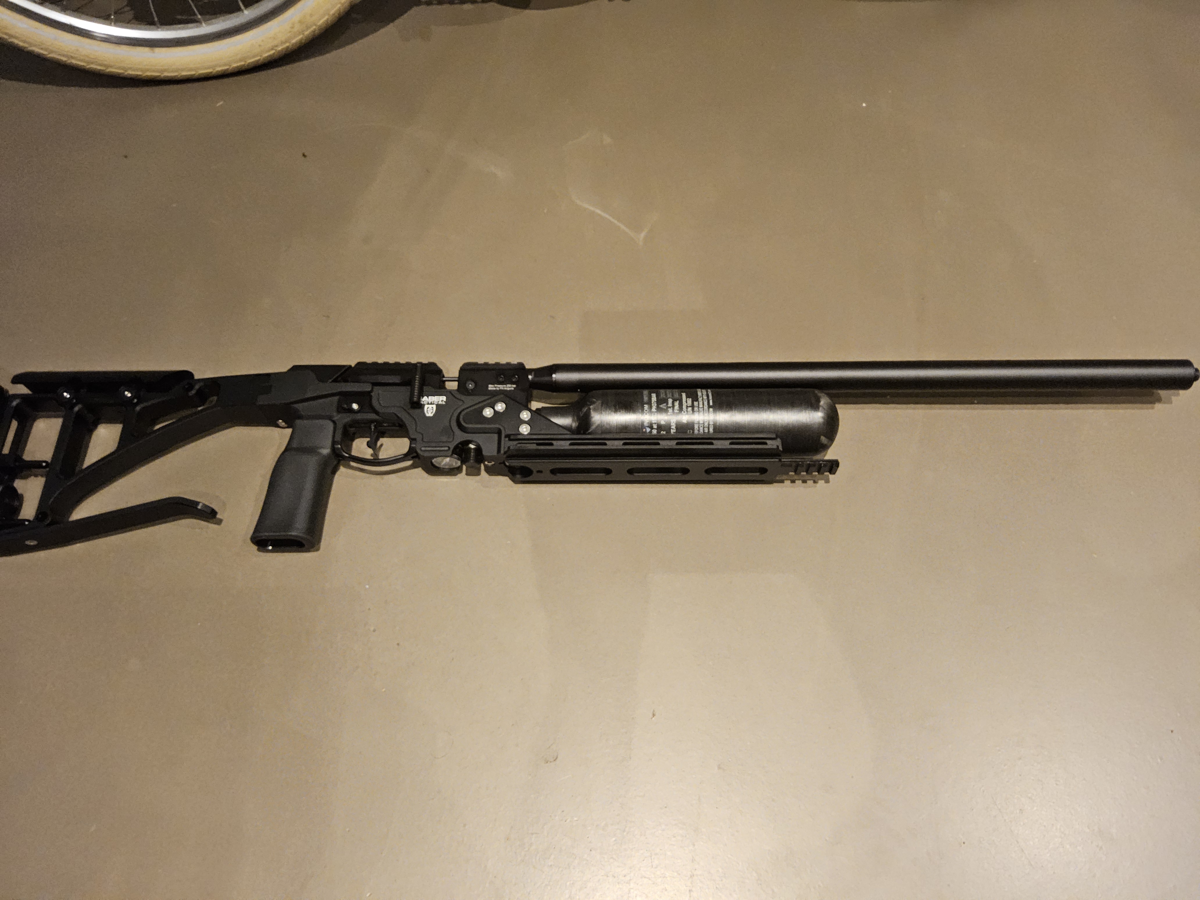

Smooth Twist X barrel kit on a Crown MK2
Almost correct, Liner, barrel, shroud.
Each liner gets a jam nut at the crown end.
Each liner gets a thimble assembly with the thimble and liner nut at the breech end.
The liner slides into the barrel, is held under compression by the nuts and the barrel.
The shroud makes it look pretty.

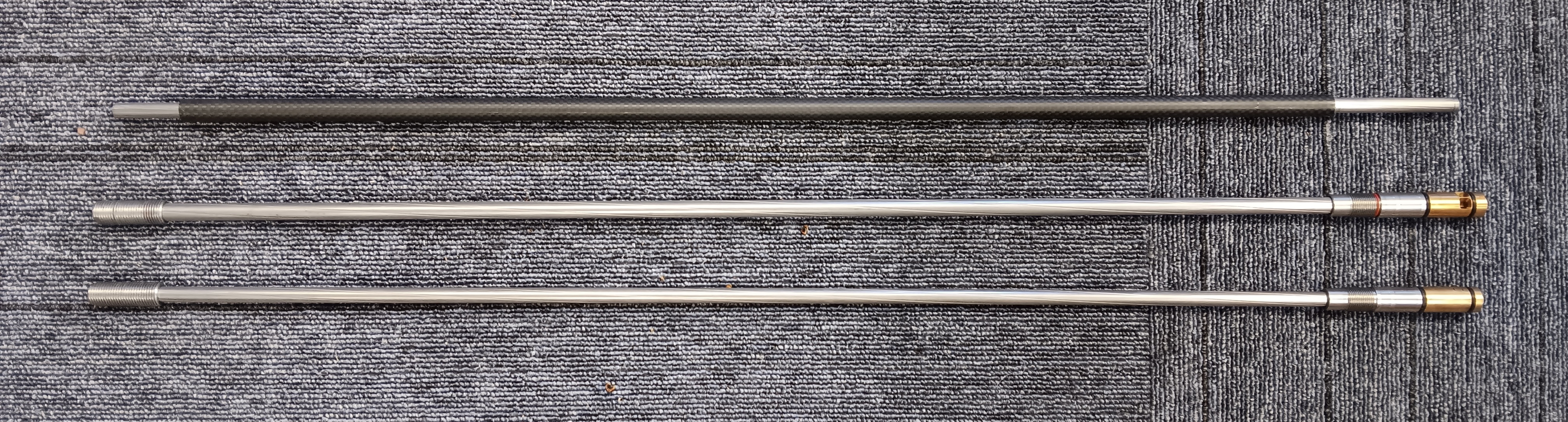

.22 liners and a .25 liner with end nuts and thimbles installed.
Reactions: Corvid_hunter

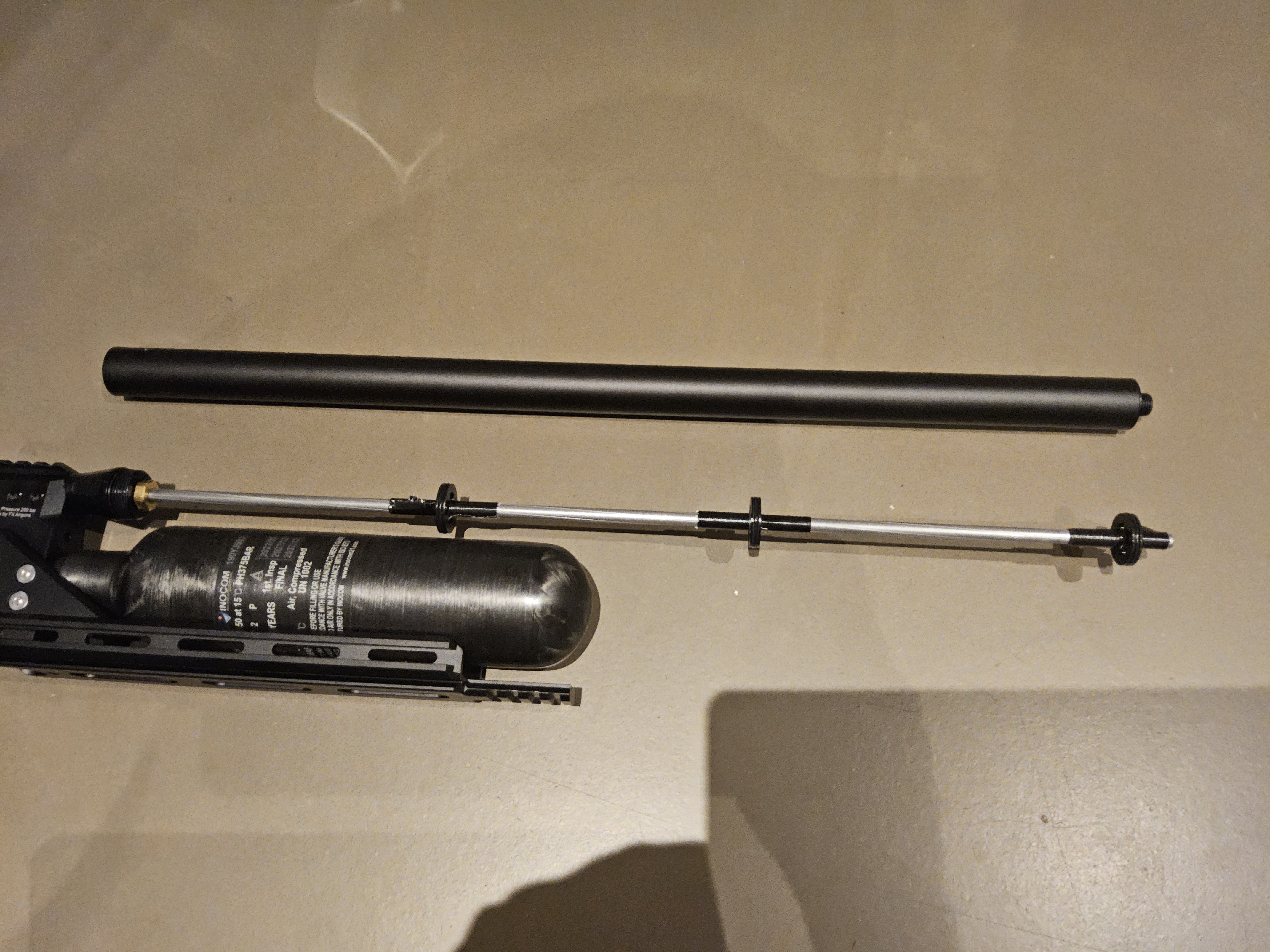

No jam nut on the lightweight kit. Just spacers on liner to "stiffen" it in the shroud.
There was 3x liner spacers in my Crown 600mm. Liner is tightened at transfer port. Complete lightweight system (shroud, barrel, transfer port) is only tightened by 2 small screws and 1 bigger at the breach. Spacers do move because of air pressure in shroud when shooting. They also move when taking off/putting on the shroud. The whole lightweight setup is a joke from FX that havent been seen again. They moved back to the liner housing tube with the jam nut which is much better.
Some ppl have modified the lightweight setup with a carbon sleeve and 3d printed shroud spacers to fit over the sleeve and a barrel/bottle tensioner - that should be better.
The lightweight system is a laugh. FX marketing is making ppl by it. Don't buy it!
Tape is to hold spacers at their place

In the second picture on the left end of the liner there is a brass jam nut that has 5-6 O-Rings within....to me that is a JAM NUT. Maybe it's not to some?
You would need to remove that brass jam nut and O-Rings to install a different caliber liner. I assume that the jam nut and O-Rings would need to be the correct size for the different size caliber, but perhaps the outside diameters are the same, except for .30 caliber (?).

Maybe they are called the same? Due to FX parts list the jam nut is the nut to tighten barrel in the other end of the liner tube. That jam nut is not a part in the lightweight system since there is no liner tube.
The system with a liner tube around the liner and a jam nut to tighten the liner is much more reliable. Only problem that system has is if the jam nut isnt tightened enough - then the liner will rotate during shooting whick will give poi. Its a easy fix - jam nut must be tightened. If tightened too much - liner will bend though. FX states finger tighten and then 1/4 turn - then you are good.
The superlight system is crap. The spacers that holds the liner do move and in time gives poi. Many threads about it.
