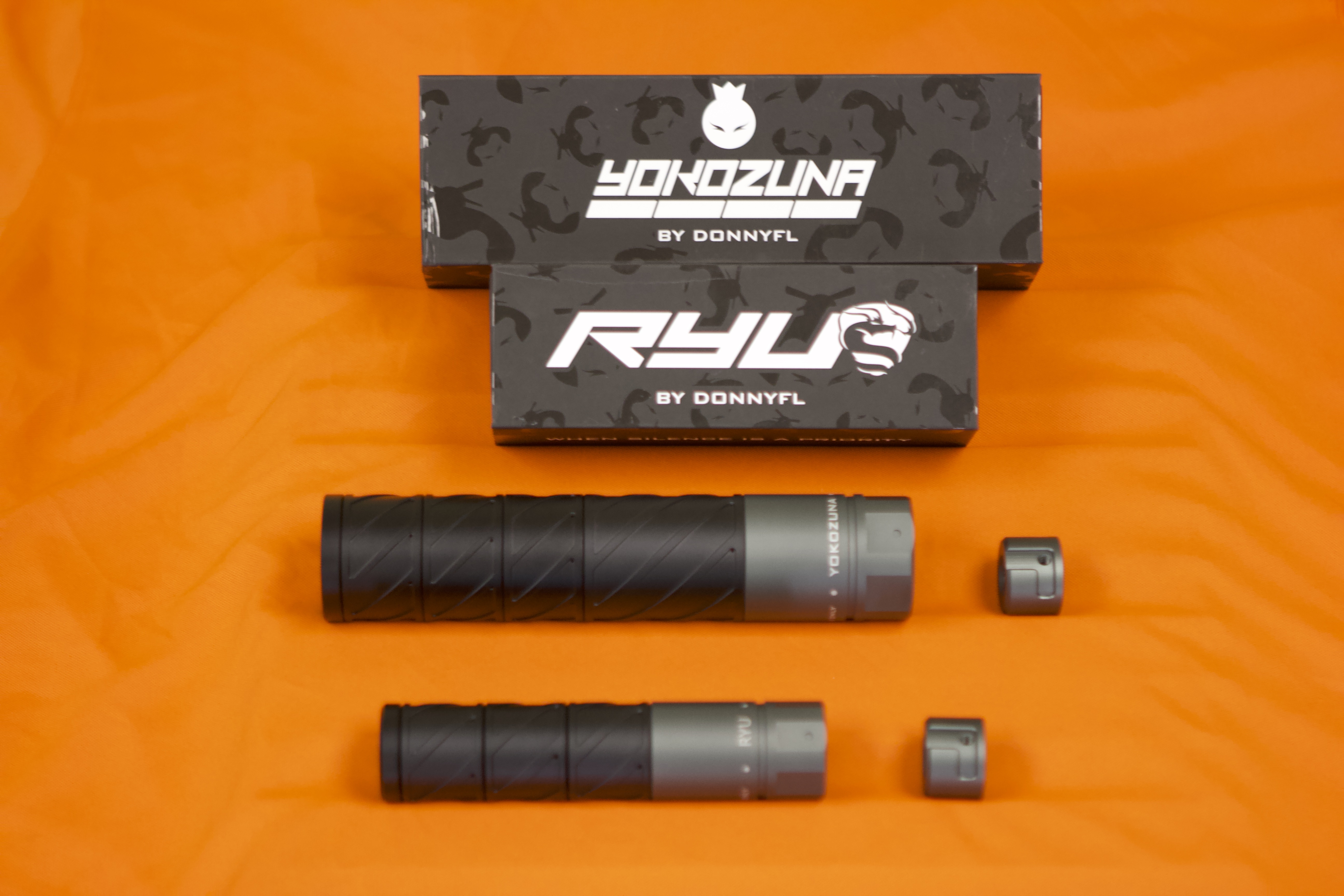

We were able to talk with Donny and the crew last week and get our hands on two of the newest silencers they are making. With great enthusiasm and honor we would like to introduce the RYU and the YOKOZUNA
These are both Aluminum made user adjustable silencers that are quick disconnect. Both units use the same barrel attachment system. They have the 1/2x20 threads that will screw on to any air rifle currently. With the Tri-Lug design you are able to match up the dimple on lower unit with the set screw on the mount. A Multi wave compression spring keeps tension on the unit, then a simple twist and the unit is secured and you have a solid lock up. With the two we currently have we are able to use the same mount for either of the silnecers.

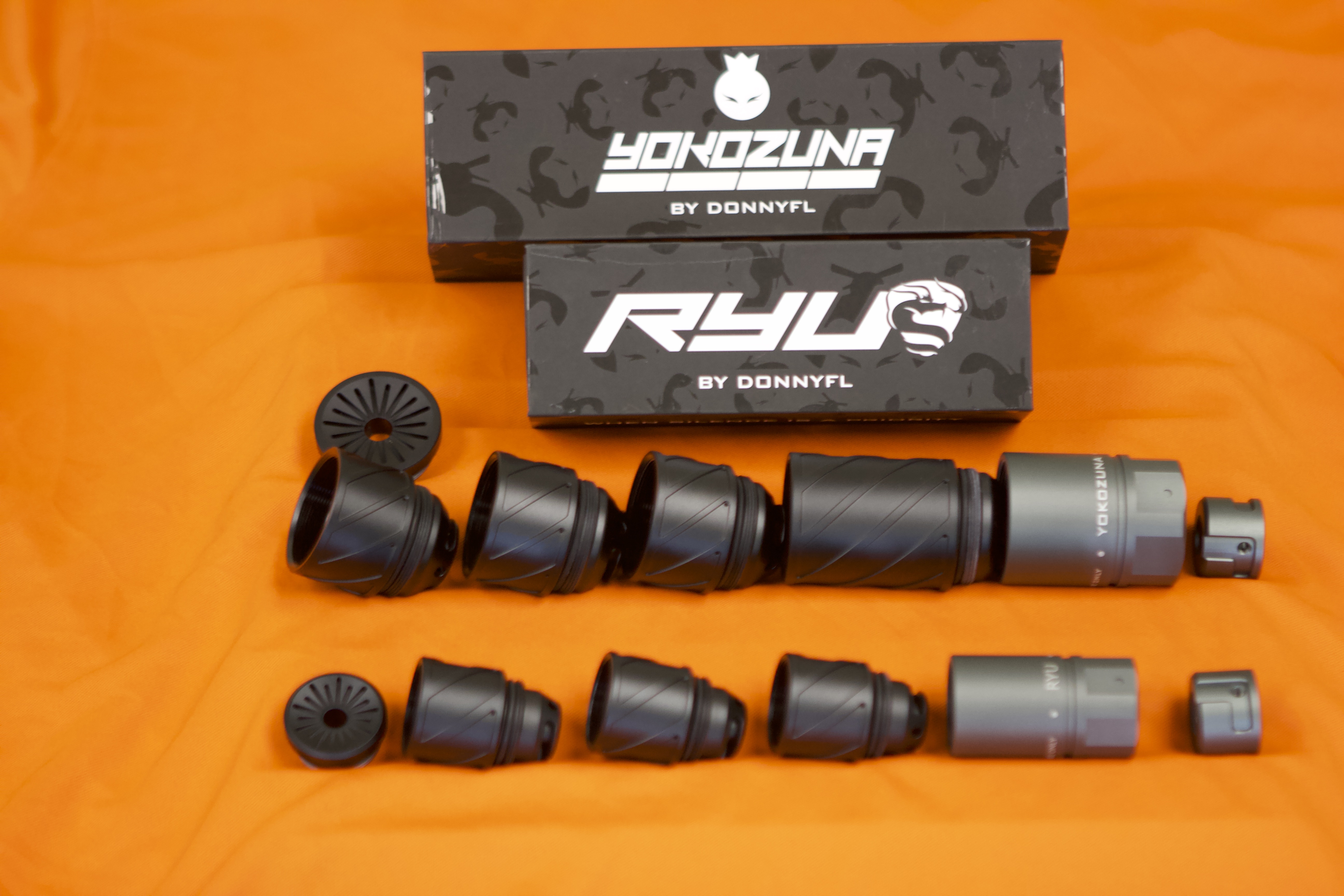

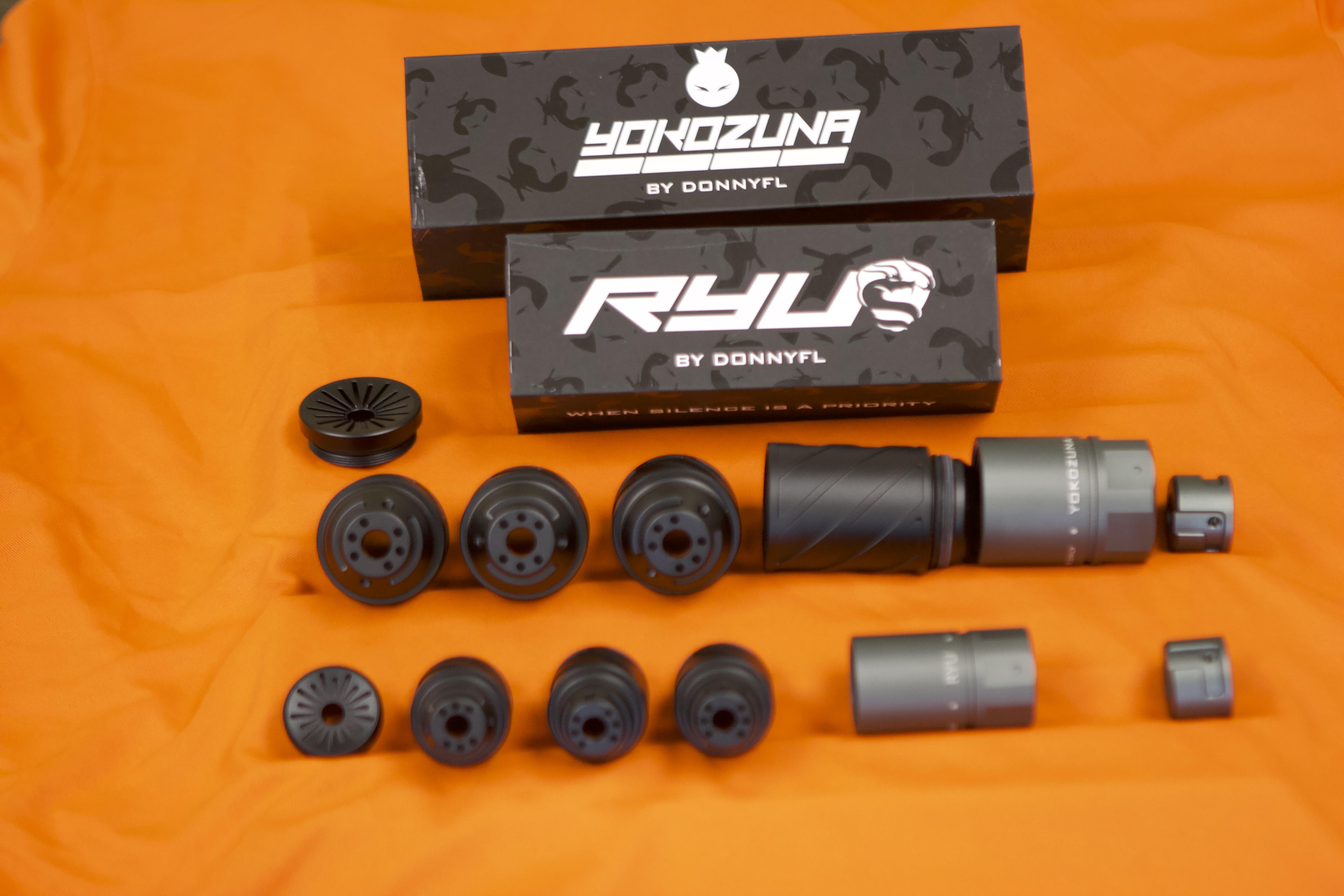

A look at the break down of the two silencers. Again the YOKOZUNA on top and the RYU on the bottom. The threads are very smooth and there is no apparent grittyness or roughness when tightening the parts. Each baffle has an o-ring on it to help seal the unit and keep things snug, while still maintaining the ability to take down easily. There will be the opportunity to add baffles to the silencers in the future, so you can customize each unit to your needs at any given time. There was talk as well about the possibility of having adapters being made for other silencers on the market right now. There was no time line mentioned about this part, but they are working on it.

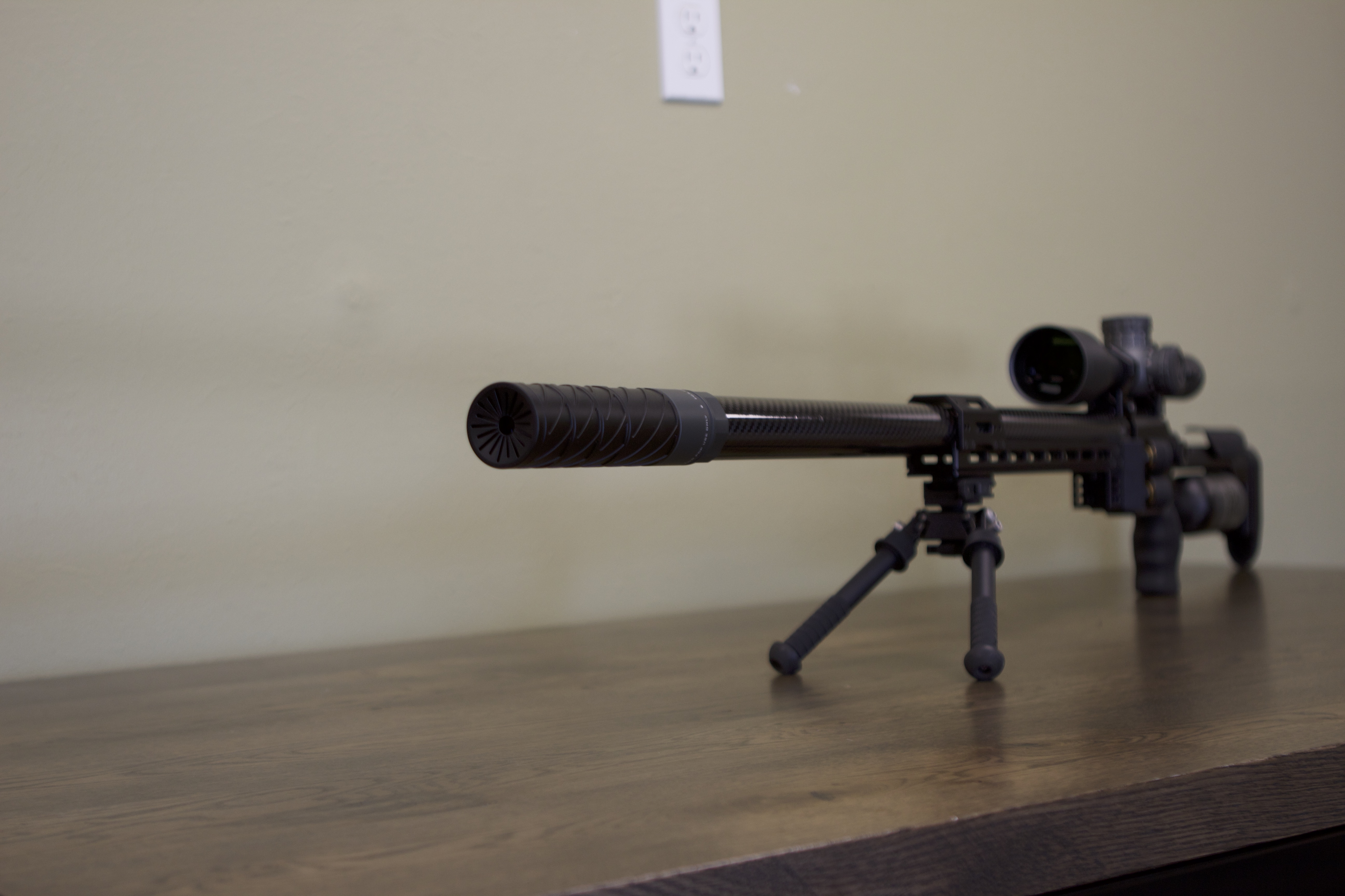

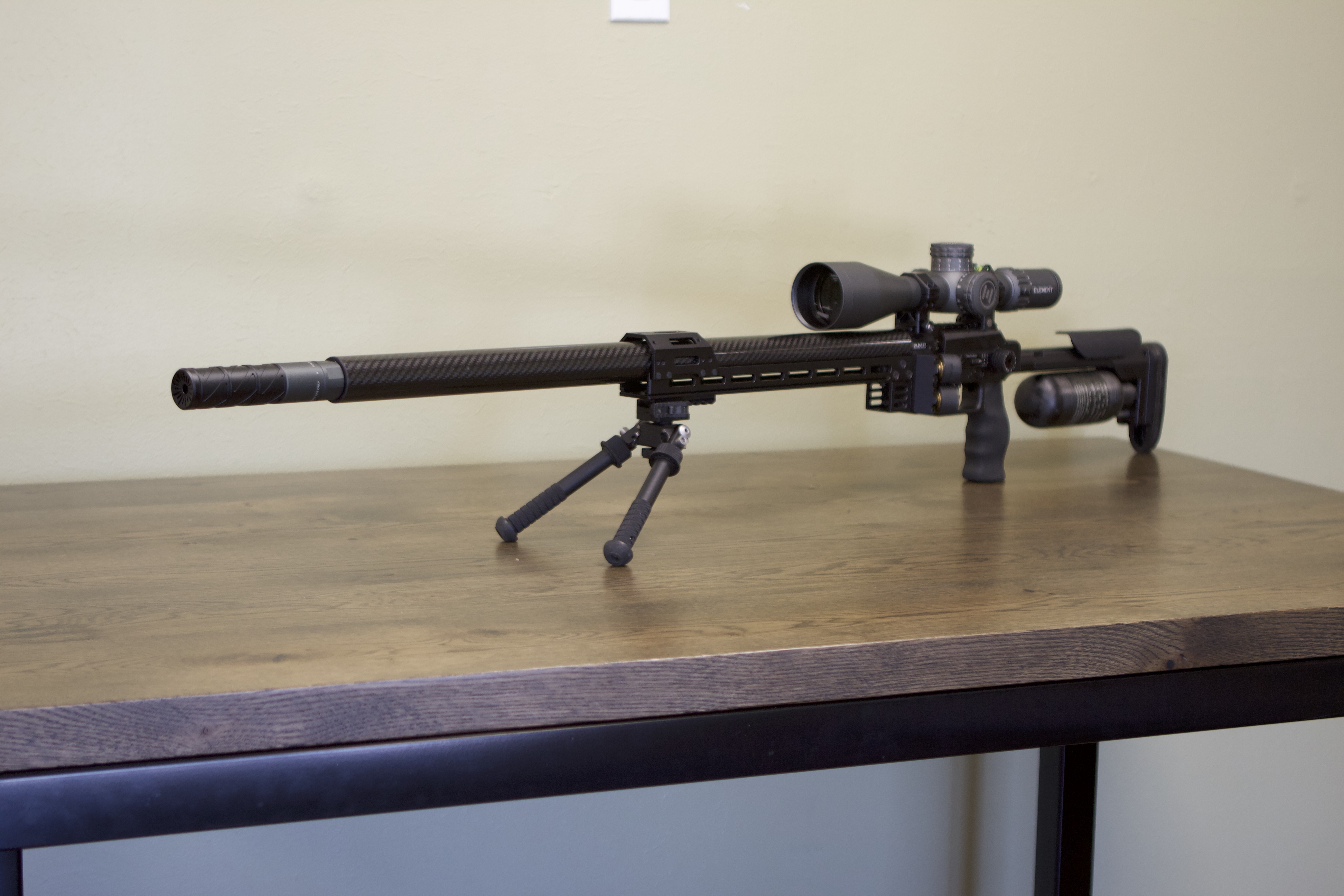

We have been able to shoot both of these unit for a little bit and we are quite impressed. We have been shooting both of the silencers on the FX Panthera 700mm in 22 cal tuned to shoot the Javelin 34 grain slugs at 960 fps. Between the YOKOZUNA and the RYU to my ears there is a difference in the tone and pitch, but both are very quiet and able to tame the bark from the Panthera. The most impressive aspect to these silencers is going to be the price. Donny is looking at getting these under $200, because as Donny said "I want to be fair". And honestly a silencer of this quality for under $200 is a great deal and extremely fair.
