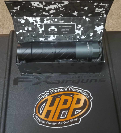

I got my hands on one. It's seriously next level. I can't wait to test it out. I just need to figure out which gun is most worthy of this thing!
