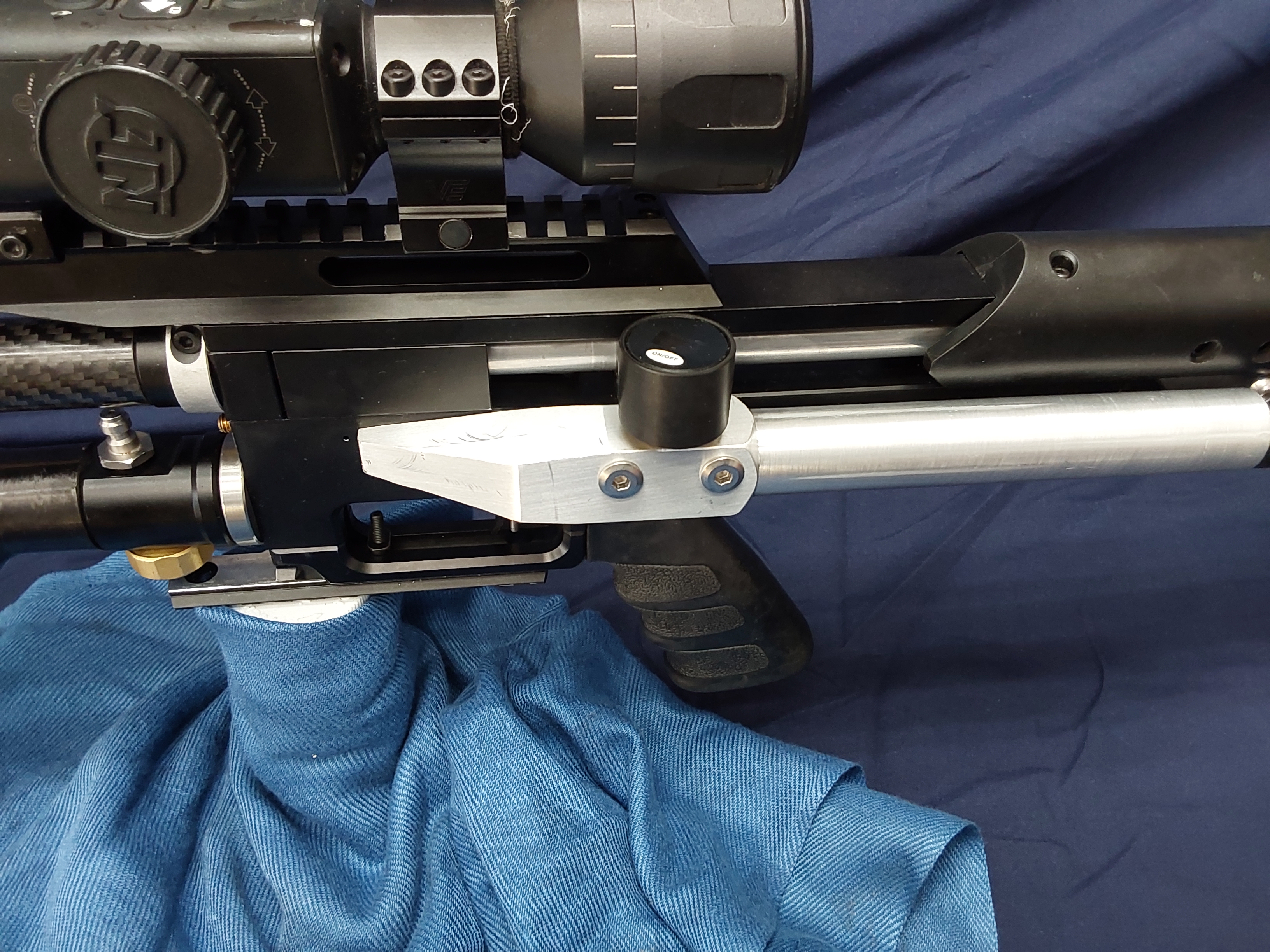

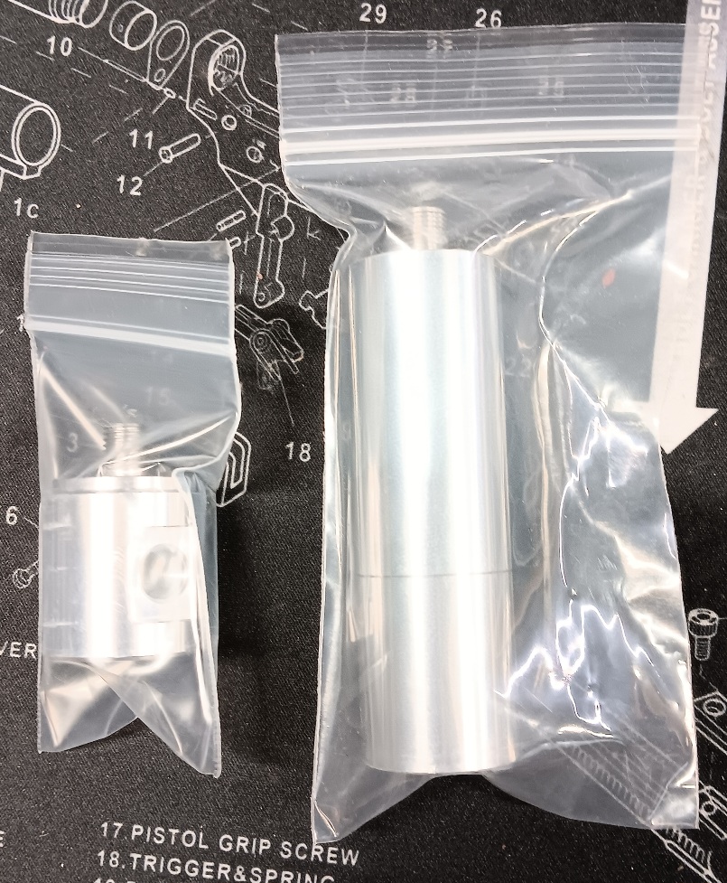

I've got one on my bench made by c88machining that I'm evaluating currently. It's raw aluminum because it's a prototype but it will be anodized when it hits the market.
I've not installed it yet but I plan on getting it on my .22 M60B and running a string today.

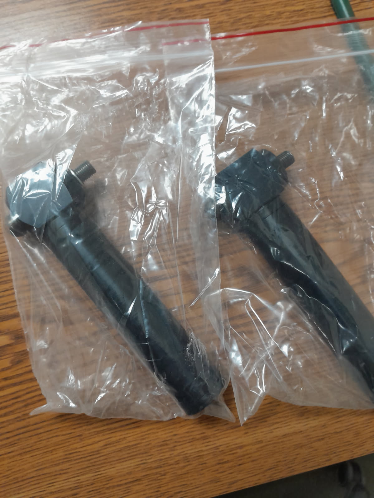

I know this is an older thread but I've just run across it. The external plenum for the M60B as seen on the Brother Of Air YT videos is now available stateside. I initially called the fellow listed in his videos but they didn't have any American stock. They have since got a distributor in Kansas City whose name is Hannes. His number is for 1 913-326-2230. They cost $130.00 per, I just text him and ordered that way. He's very responsive and ships Fed Ex 2 day. Mine should be arriving tomorrow but with snowstorms in the Midwest it might take a couple extra days. I ordered two because it's my understanding they also fit the original avenger rifle. I hope that helps anybody who's looking.

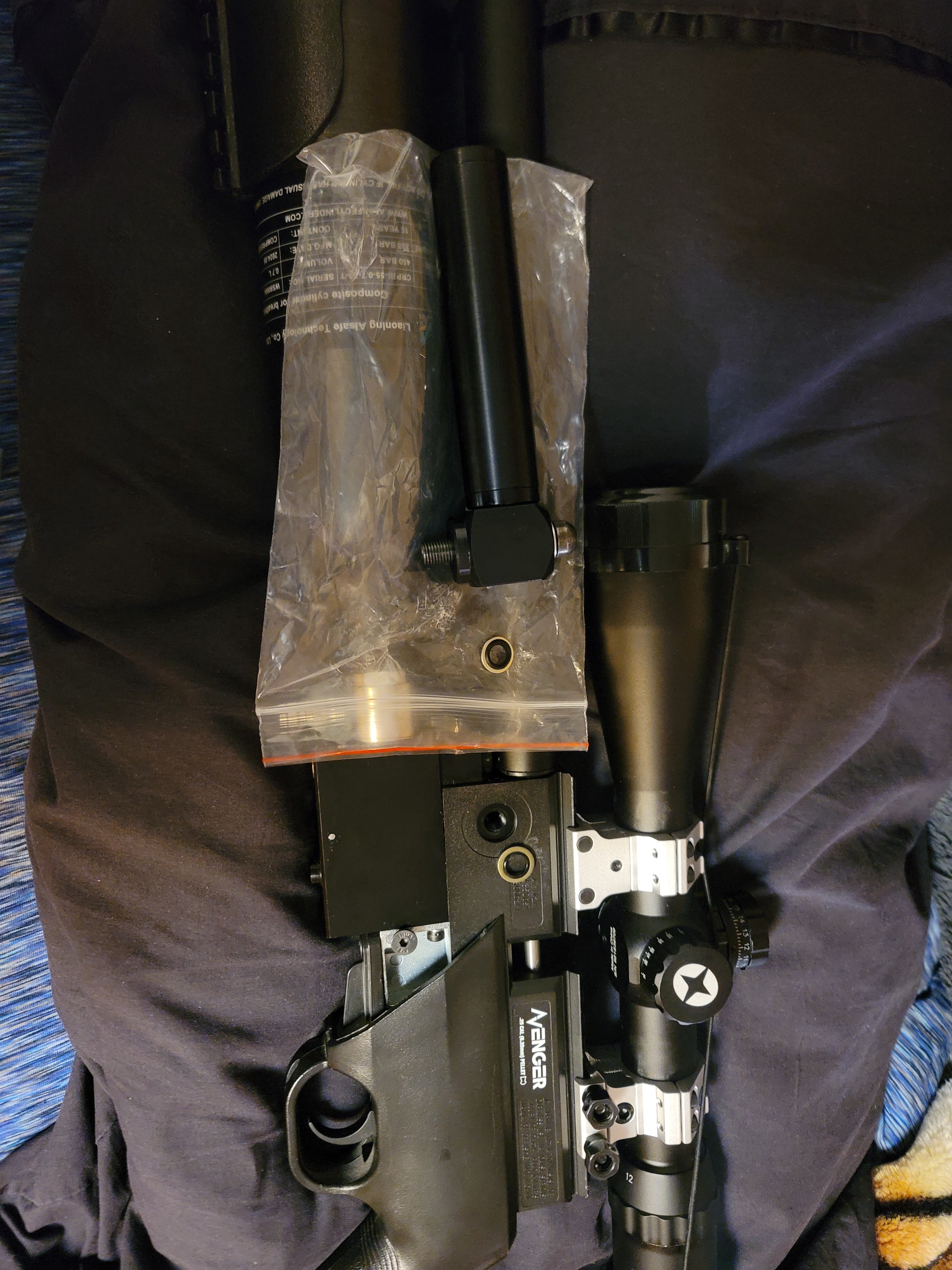

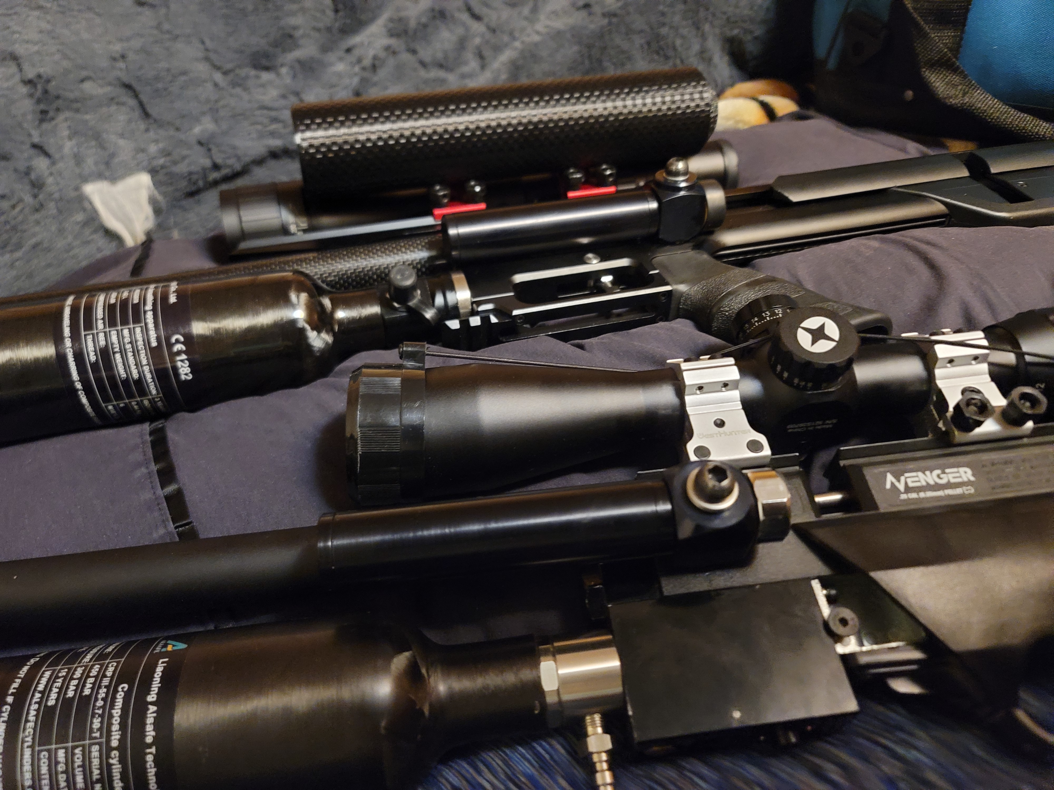

Here are the plenums installed. The M60B install was easy breezy. The only thing is the gauge washer stays (right of the gauge hole) where it is when you take it off, the plenum mounts to that. The washer that comes with the plenum (right of the plenum)
you take off and use it when you mount the gauge to the back of the plenum.
The avenger mount I had to add a couple washers because the specialized bolt is a little long for that application and bottoms out before seal is achieved.
