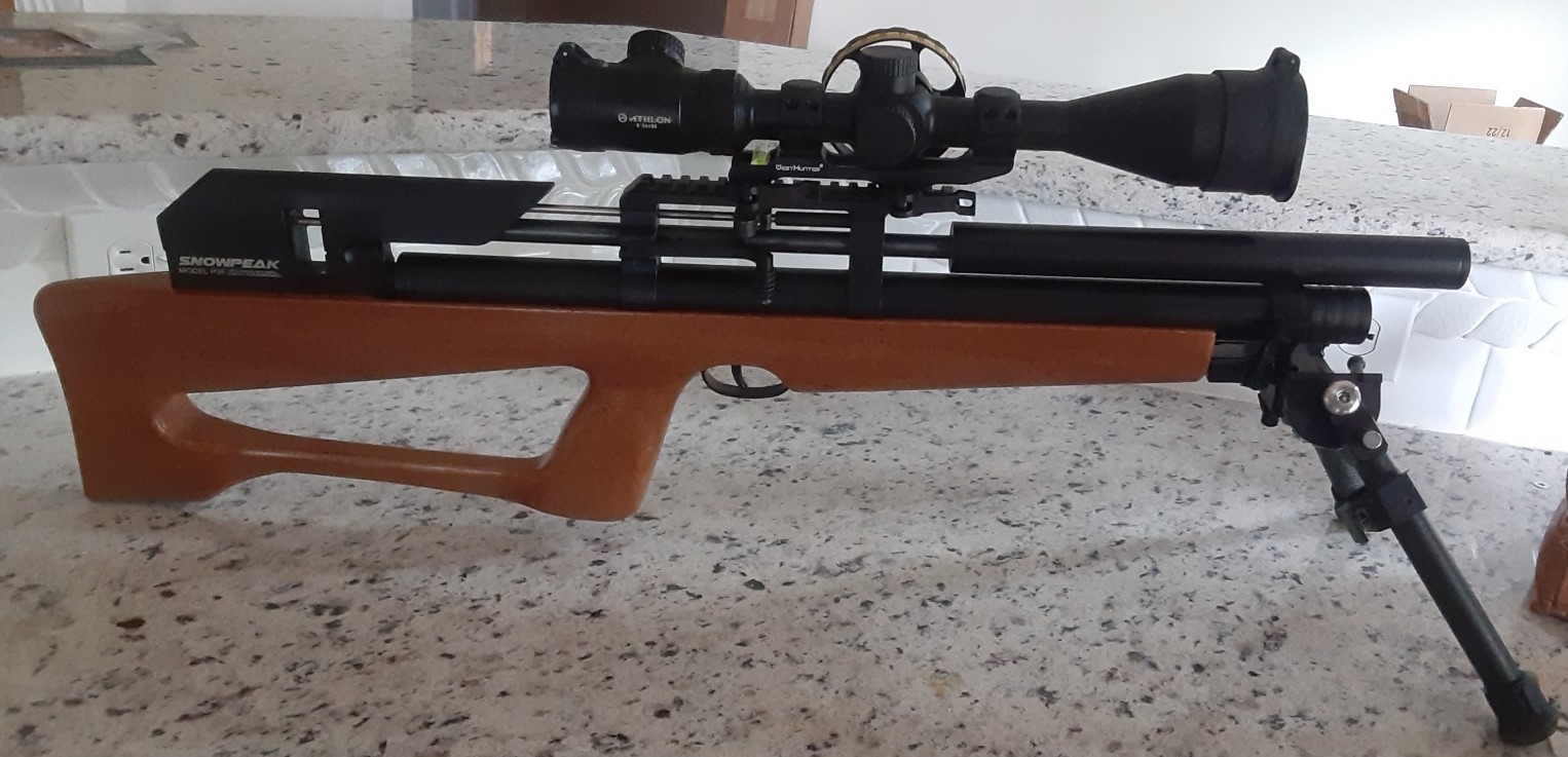

show us a pic of this p35 you speak of!
@Perle it's dismantled now, waiting for the power plenum. I'll take a photo and share when I had assembled the gun. :)

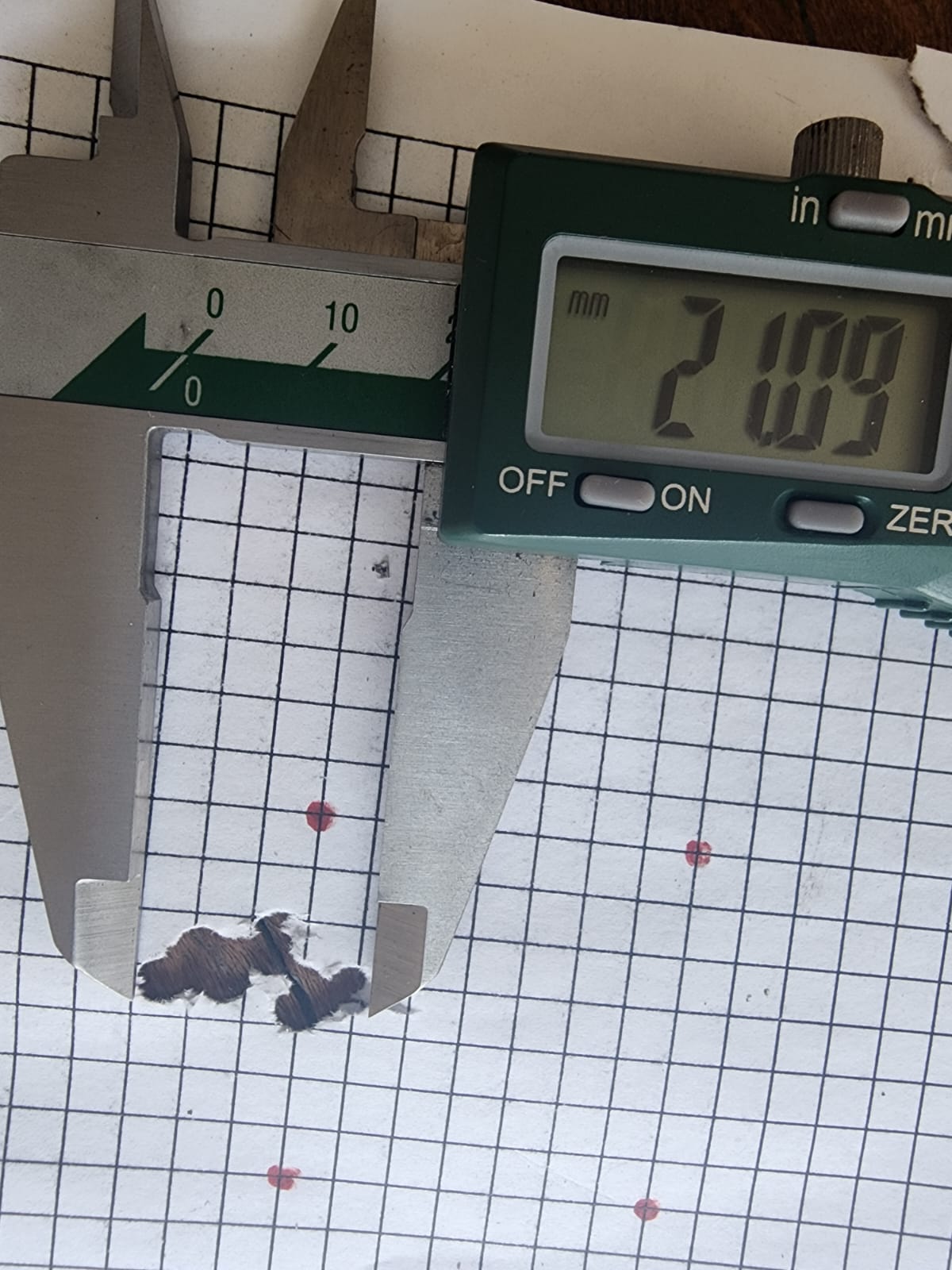

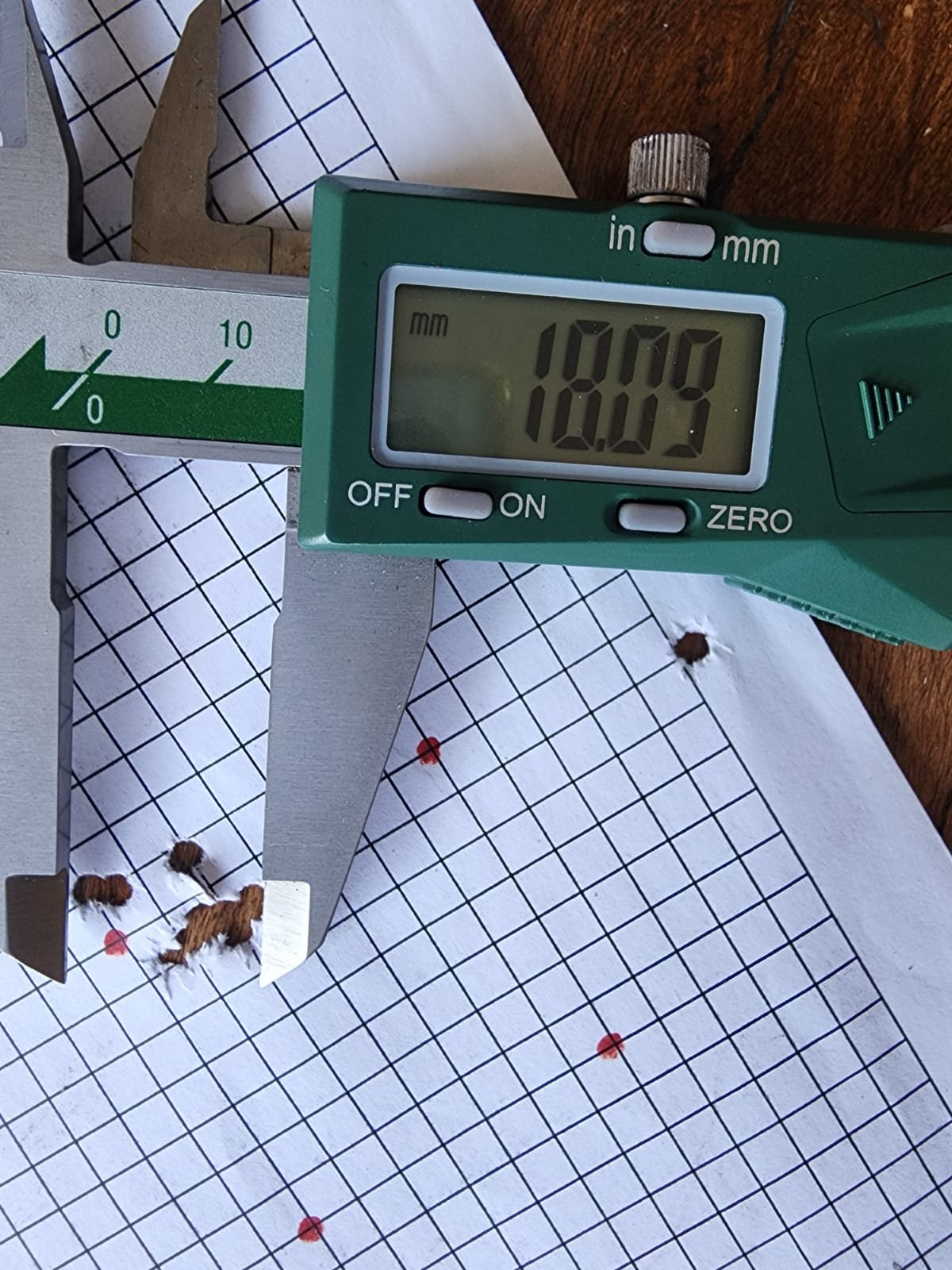

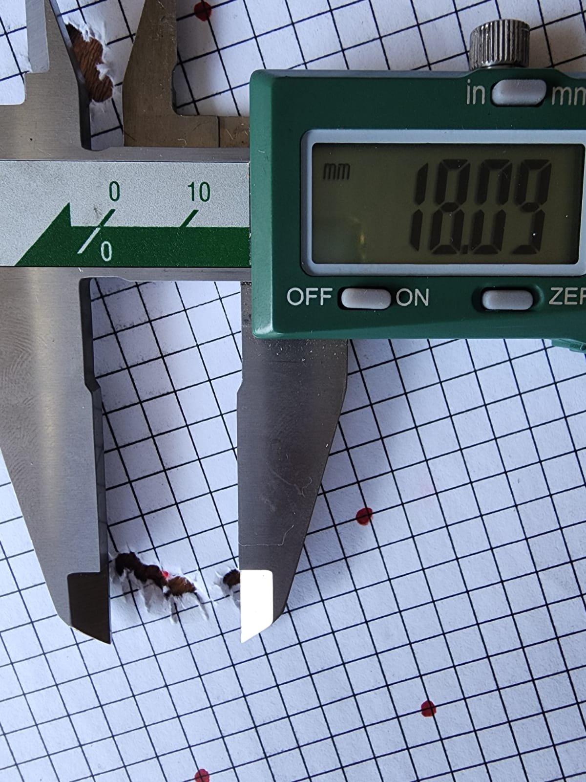

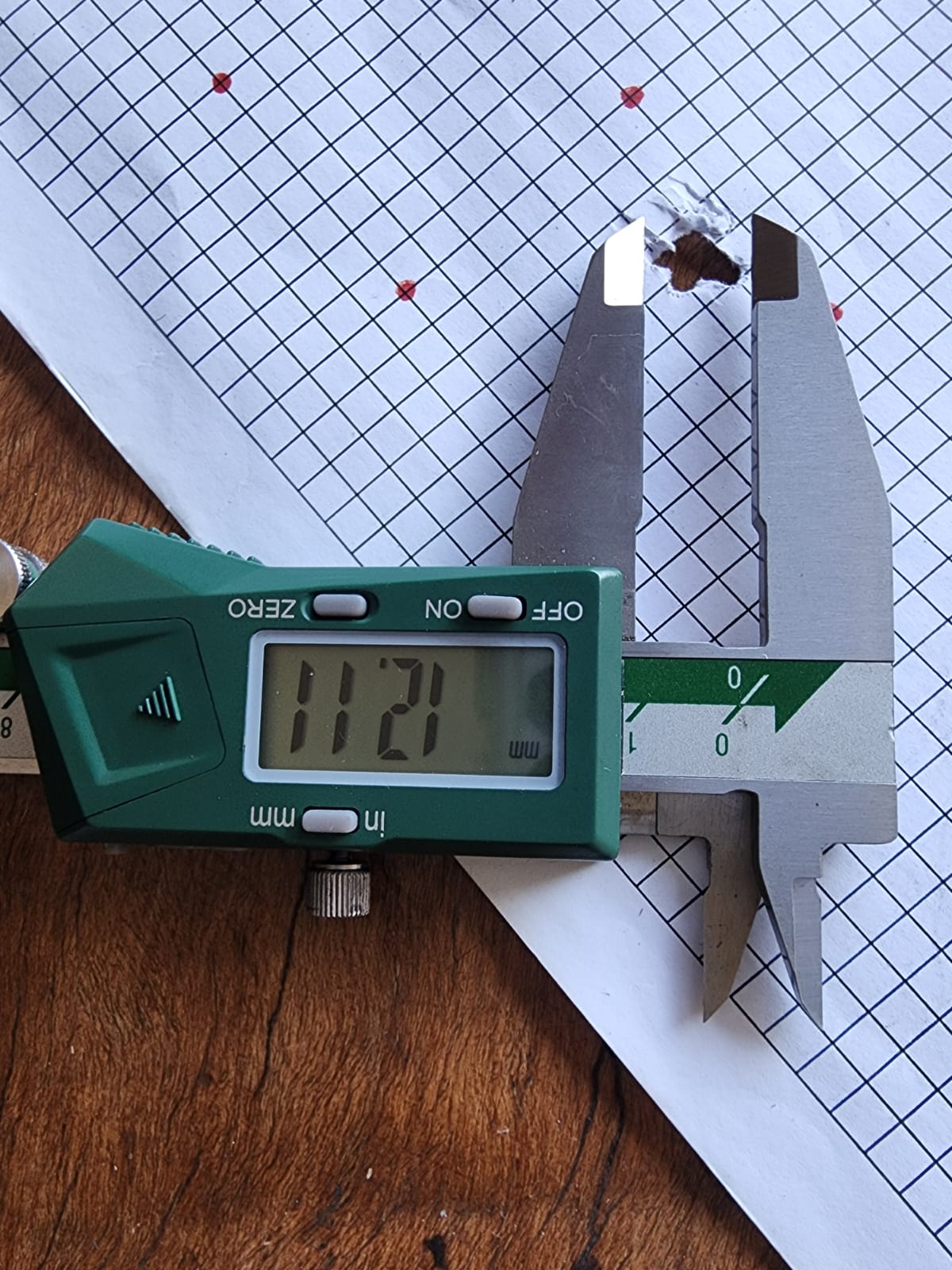

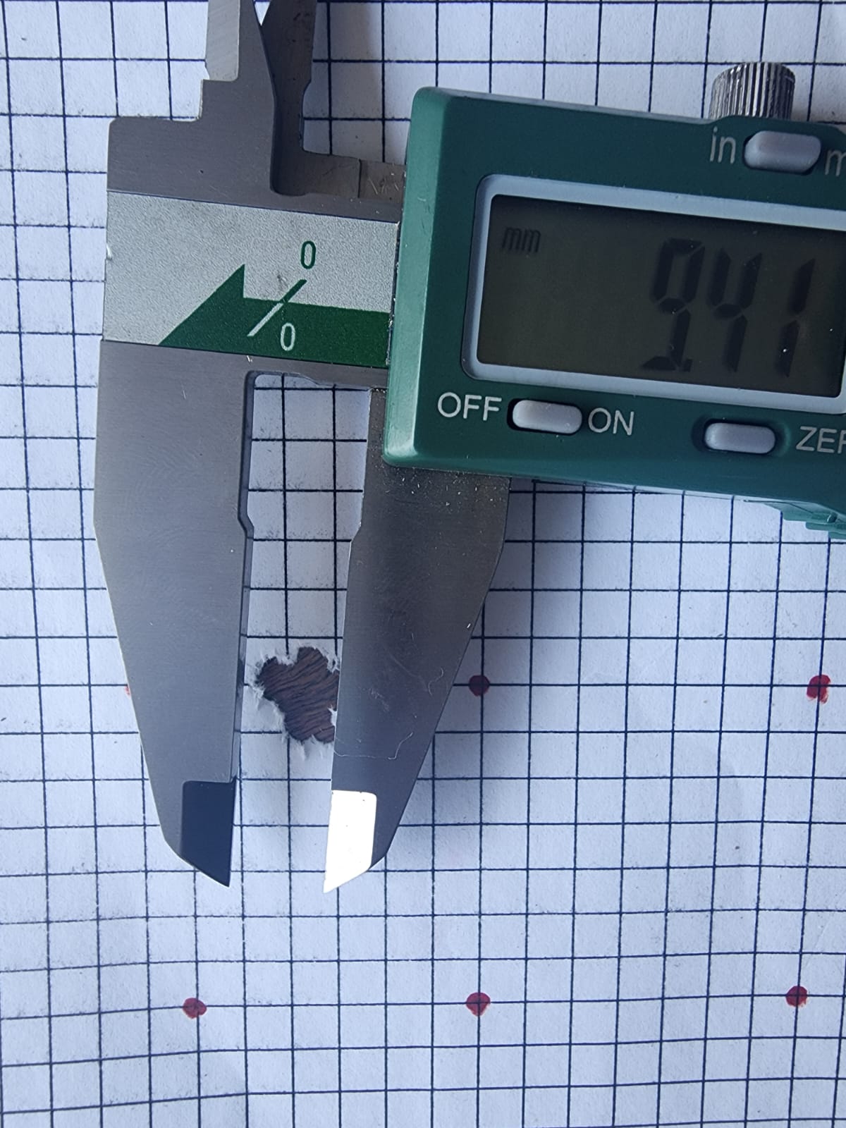

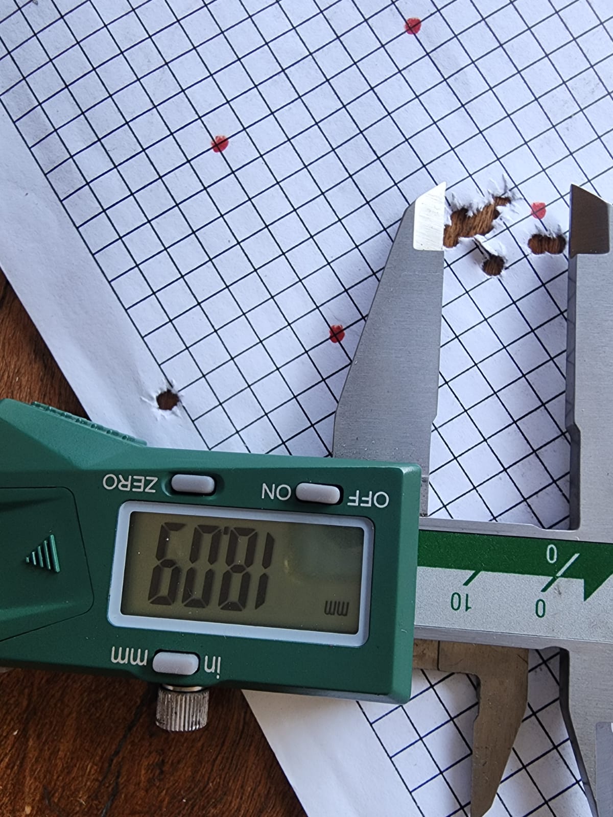

Speaking of results, I found for the target paper that I shot 15m out of the factory. And I realised that I made a mistake in my first post. The 16gr Zan slug was at 658 FPS!
I'm sharing my group shots with different pellets as a ref, but this was the first time that I was looking for the right pellet for the gun at 15m (roughly my shooting distance when ratting). And I probably pulled a lot of shots, since I wasn't (and still not entirely) used to handling of the gun
1. JSB KO 13gr @752
2. Zan slug 13gr @745
3. JSB KO 10gr @826
4. Hades 10gr @868
The paper around the group was a bit shredded. I don't know why. Did the Hades spiralled?
5. Zan Slug 16gr @658
I like the 'thump' sound of this slug hitting the target. It seemed to dump a lot of energy, which is why I want to install a power plenum to see if increasing the speed can stabilise it further.

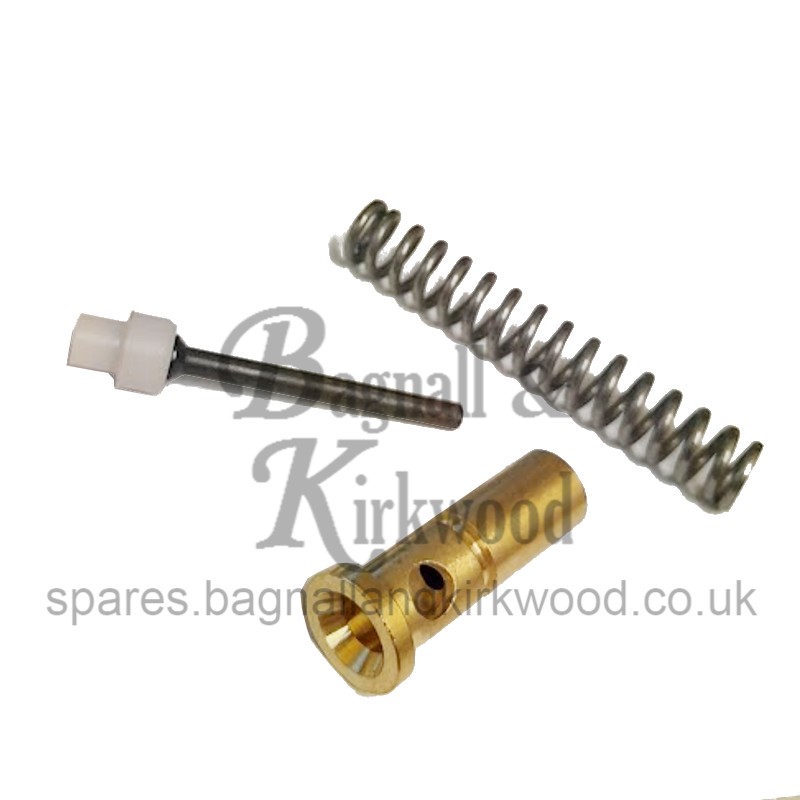

I found on the net a Artemis / Snowpeak P35 High Power Valve Kit
Has anyone tried this? I'm not technically savvy, I don't really understand what it does and how much more power it can produce.

I'd have to examine that power package of modifications and/or install them to know what they will do. Making the valve smaller in diameter can increase airflow adding power. But is the valve smaller in diameter? Maybe. The brass piece would replace an existing piece that is either aluminum or stainless steel. It may also support higher airflow. The spring may be more powerful but I can't really tell from the picture. That could support a higher regulator pressure. I don't think the stock spring will support a regulator above about 150 bar. Maybe that spring will. I would not think a 177 needs a regulator pressure above 145-150 the maximum the stock spring can support. Another low cost thing that will add a little velocity is to drill out the barrel port and the passage from where the valve is to the barrel port (the transfer port but it is pretty long in a P35). I did that in my P35-25 taking it from about 75% of bore diameter to about 85%. Bigger than 85% is not recommended, you do not want a pellet falling into the port. I got a little more velocity drilling out the ports but the biggest gain was from the power plenum. On my P35-25 it either made the gun more accurate or added enough velocity I was willing to switch to 34 grain JSB pellets which are more accurate in my gun. I tried them initially and found them accurate but velocity was so low I decided to use lighter ones. It shoots them about 800 fps now making it a pretty stout little P35 (about 50 fpe).
@JimD Thank you for the very detailed information on how to mod the airgun and detailing the pros and cons. I'm no longer thinking about buying the High Power Valve set. It's too expensive for just a few FPS bump that you predicted. And I'm not brave enough to enlarge the port myself. I'm really good at taking stuff apart and playing with it, but I'm really bad at putting it back together. :(

So, @Perle, Sorry, you'd have to wait a bit longer for the pic until the P35 is out from the ICU. :)
