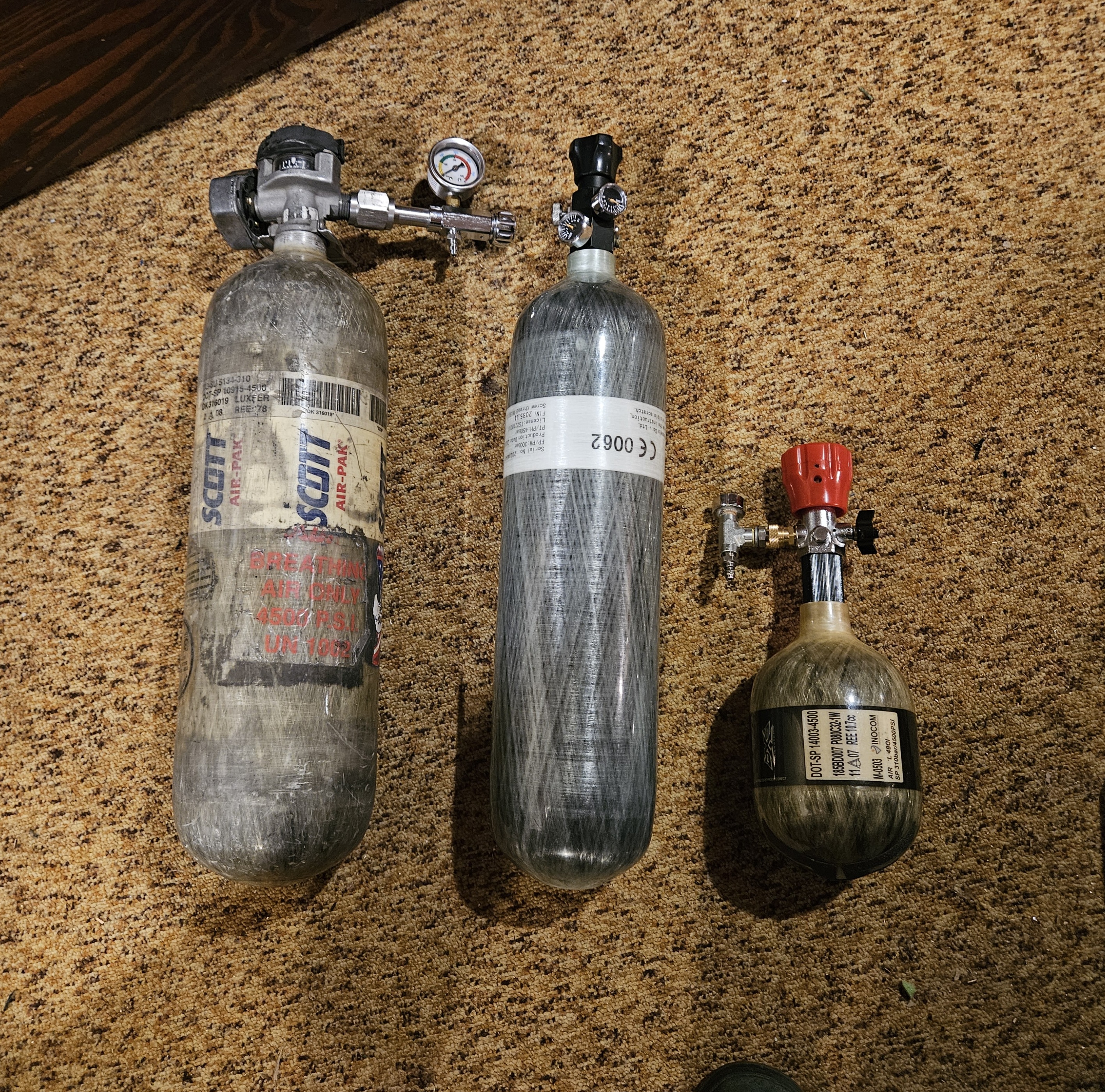

I have a 3L bottle and a 4.5L MSA bottle. Both 300 BAR. No way I'd be lugging that 4.5L around the woods. The 3L gets old too. I have a 48ci 300 BAR bottle I can toss in a backpack and get a few fills on some of my guns.
Here's all 3 for reference.

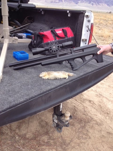

Bought a Snowpeak M60B .35 from Krale in March. Came with older, "remove-bottle-to-fill" system, instead of updated installed foster fitting. In your case, get an early style M60B and a second bottle to switch out, as needed. The bottles don't vent when removed, you only lose air from gun which is recharged from next bottle. Finding a second bottle might not be too hard since many replace heavy aluminum ones for lighter carbon fiber. I'd try a "Want to Buy," request in AGN Classifieds or contact Wes at airgunarcheryfun (Canada.) WM
