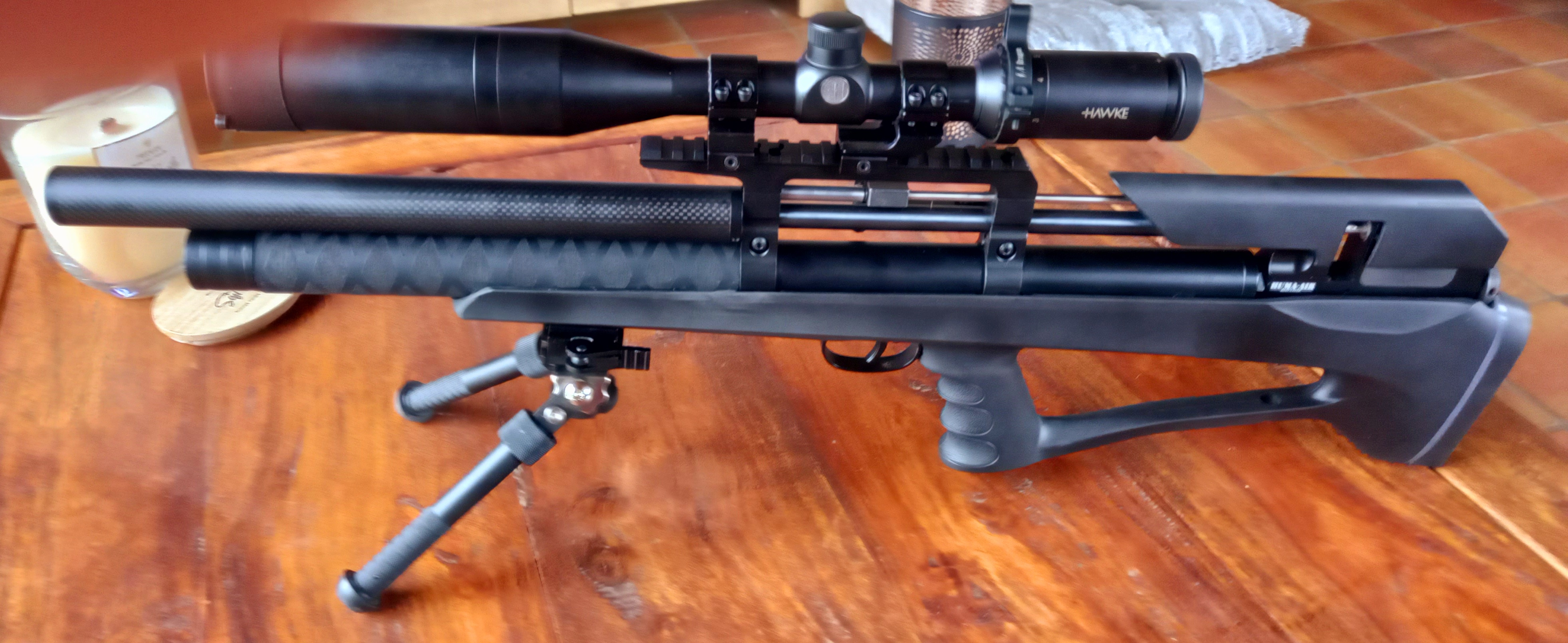

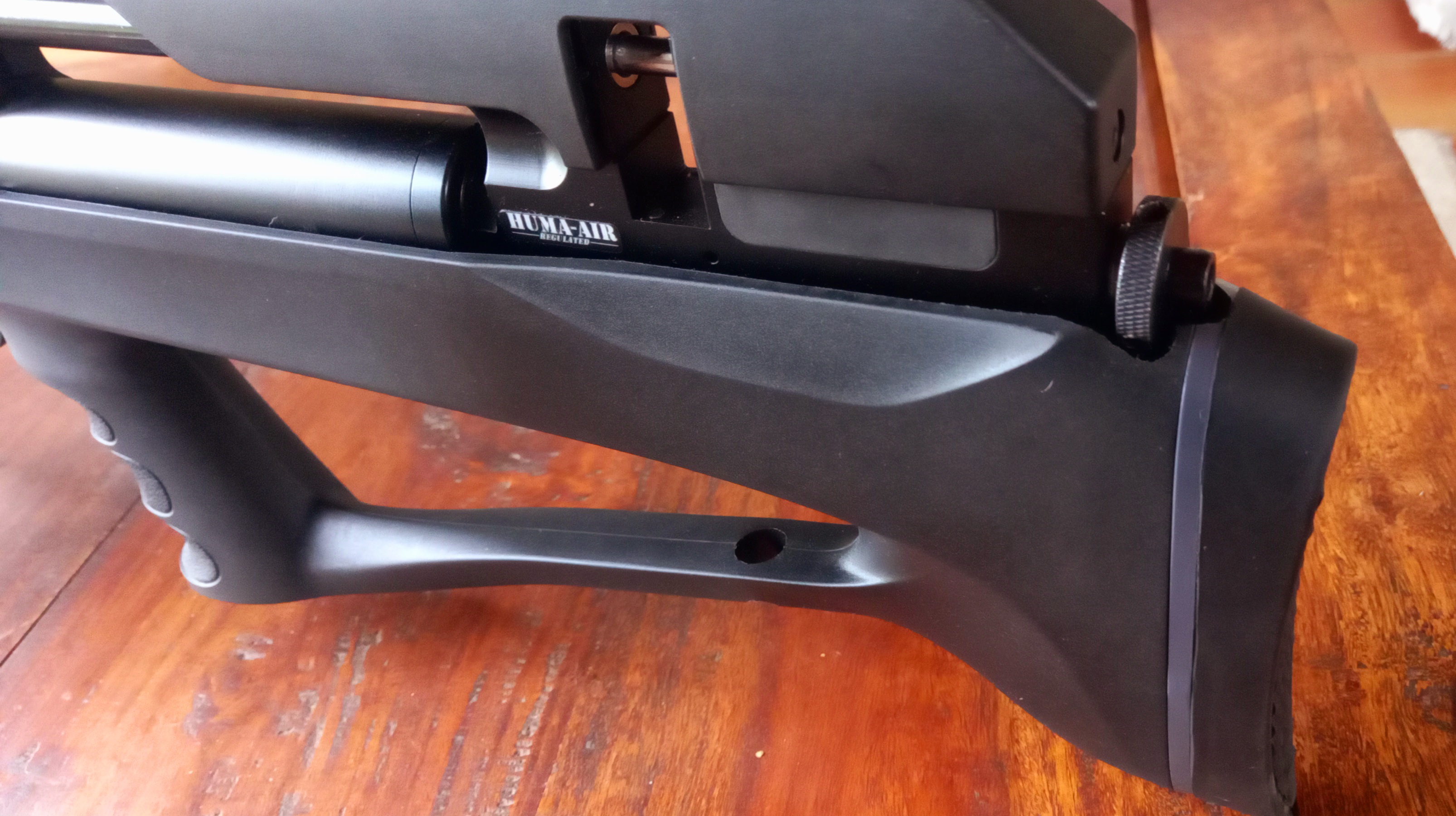

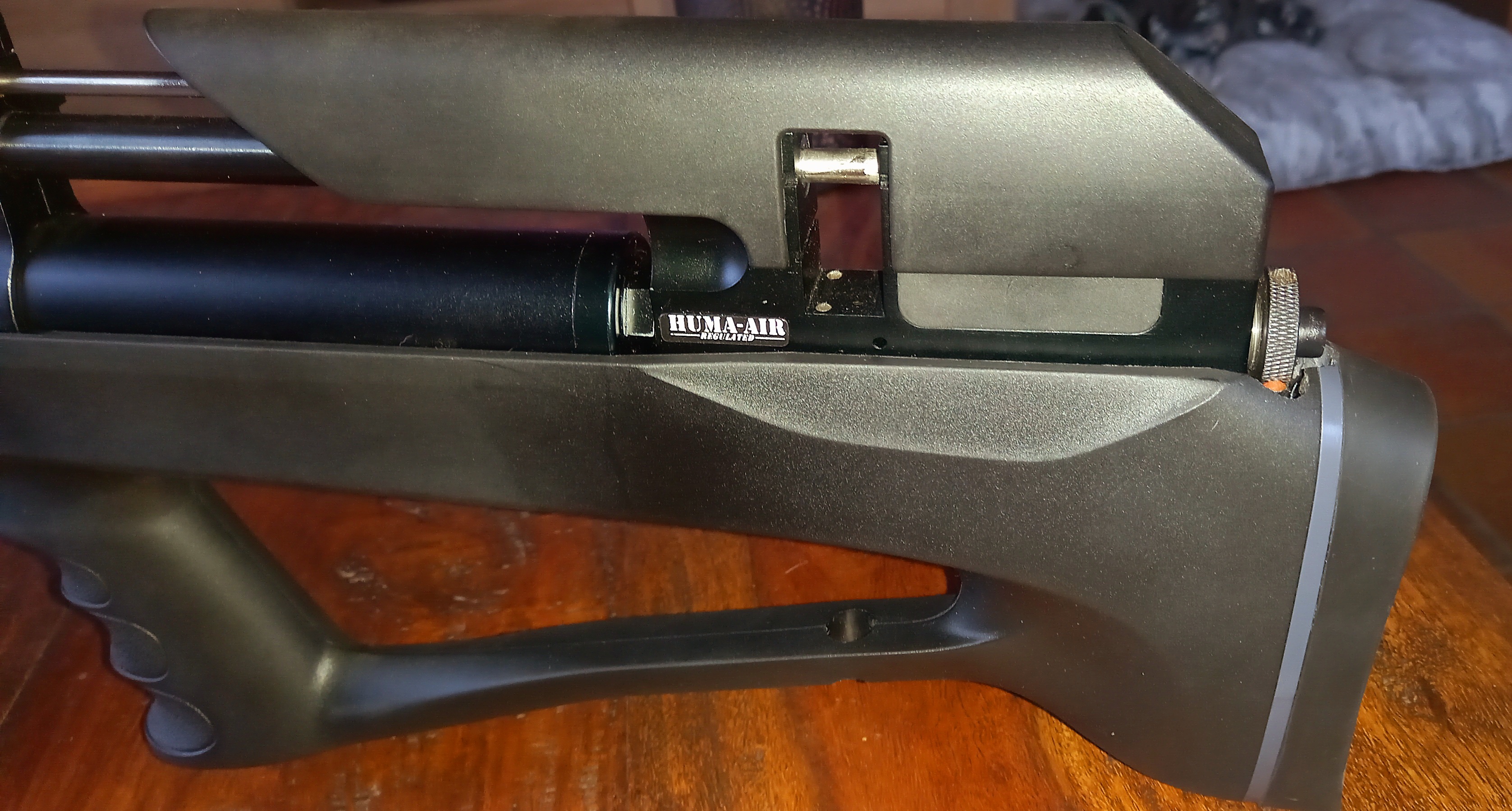

Thanks. I ended up installing a huma reg it came with. I need to do some ammo testing. I can’t remember if it’s at 110 or 115 bar. Shooting 10gr knockouts at 940 fps and 13 gr at 880 fps. A prevoius owner said it liked Knockouts. I’ll eventually find a pellet it likes.
