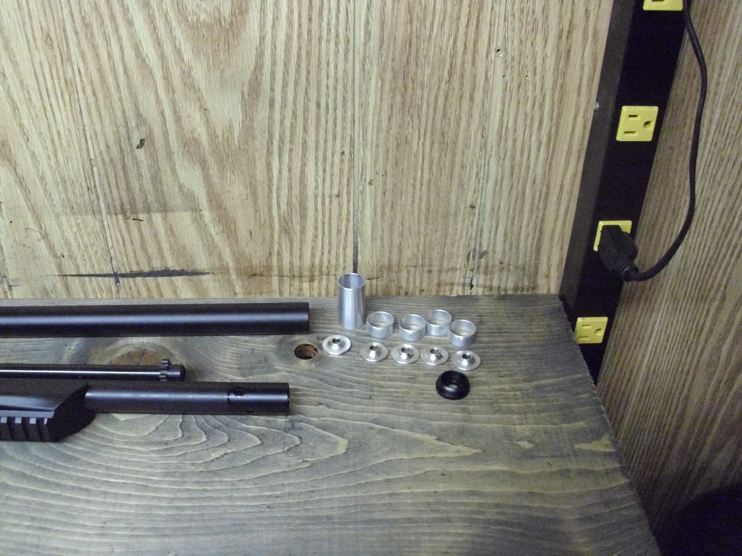

i have one in 25 cal not shot it yet doing a ldc add on useing a donnly fl adapter thats made for the hatsan qe shroude i took top cover off the t rex and its the same action as the daina storm rider its post to have a 150cc cylender but same action air tube barrle as the snow peak 900 i have a stoger xm1 s 4 and this rifle has same action as the remington t rex bull pup so its not any where like the stoger xm1 bull pup same gun as snow peak 35 the t rex bull pup is not any thing like a p35 its made on the strom rider action
