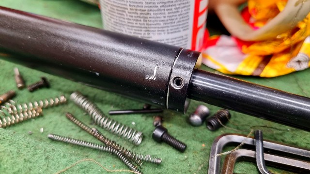

WHY WHY OH WHY does Snowpeak insist on trying to convert the pcp world? First up, already at 20J that there in the pic is nothing short of useless. What Andy at AAR on YT came to dub "the Toblerone".
Might be. It carries a shroud right? Well, for a shroud to be of use it helps if the through hole on the diffusor makes for directing air down the shroud, IF there even IS a diffusor. Which there isn´t.
Then from that "void" on that thing there´s 4 minescule little holes designed in that´s supposed to make this happen?
Look. You ram the two pins out that retains the end cap. Then get a stiff pair of pliers and yank that there insert out. That done the outer housing is held in place with a sorts of castell nut and of COURSE this isn´t on a 1/2"-20UNF thread but on a regular metric M12. As the barrel outer is on 12mm flat.
I´m all good this is a budget tier gun but what would it have cost to just delete that there junk and add a 1/2"-20 thread out front?
So what i did was turn the snout of the barrel down some to take a press fit bung - to hold a decent diffusor (by me). Well...
Threaded the front portion 1/2"-20 to gain linearity of the unit as it was all on there. This no doubt worked, just shoving the stock diffusor tube forwards handing that it needed a fresh rear plug.
Yeah. Scratched it while at it but.. whatever. That rear plug now carried an o-ring vs the tube and in turn an o-ring in a pocket so cut vs the actual barrel. The whole "free floating" (within reason).
