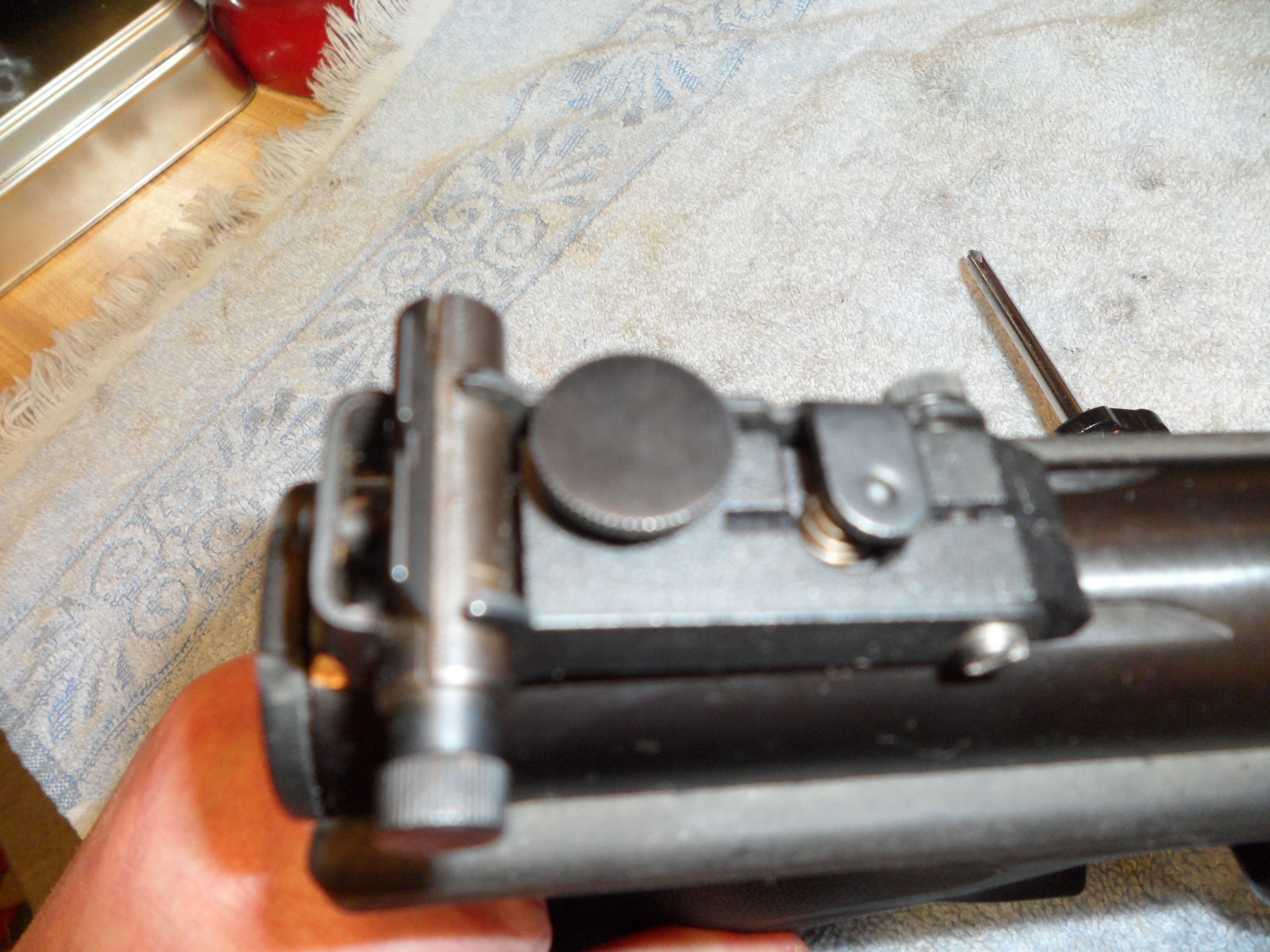

So, the thing shoots to the moon, REALLY high. Un-adjustably high, sight-wise. So, I removed the rear sight and installed a red dot. MUCH better but- the thing will not group for a crap at 10 yards. I have tried all kind of pellets. Cleaned the barrel profusely and even took a good close look at the crown, seems ok. It has a really crappy trigger, but we're talking bench work here, so I can overcome most of that.

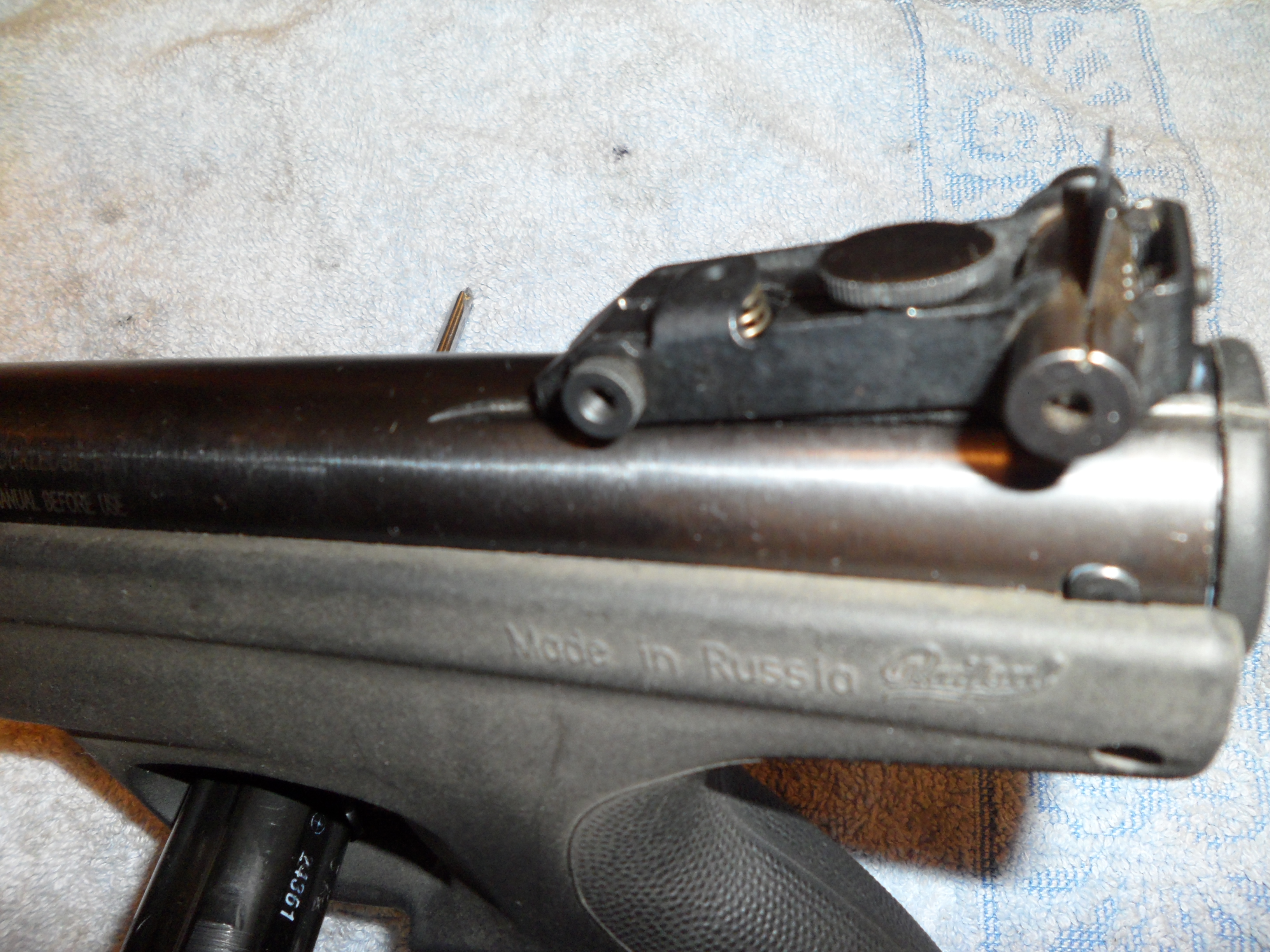

the last version of the 53M has a very questionable rear sight
the second version has a very good rear sight

when they took the rear sight and made it also the rear cap the replacement was from a very good rear sight to one you saw broken on most of the guns being sold as used

Yup, thats the version I have, same sight. Even came with a an extra blade. No amount of adjusting would bring it down to within 4" at 10m. I do like the spring loaded front sight, nice idea. I have a Tex (Czeck gun) that has the same thing. I need to run my borescope down the barrel and see what I can see.

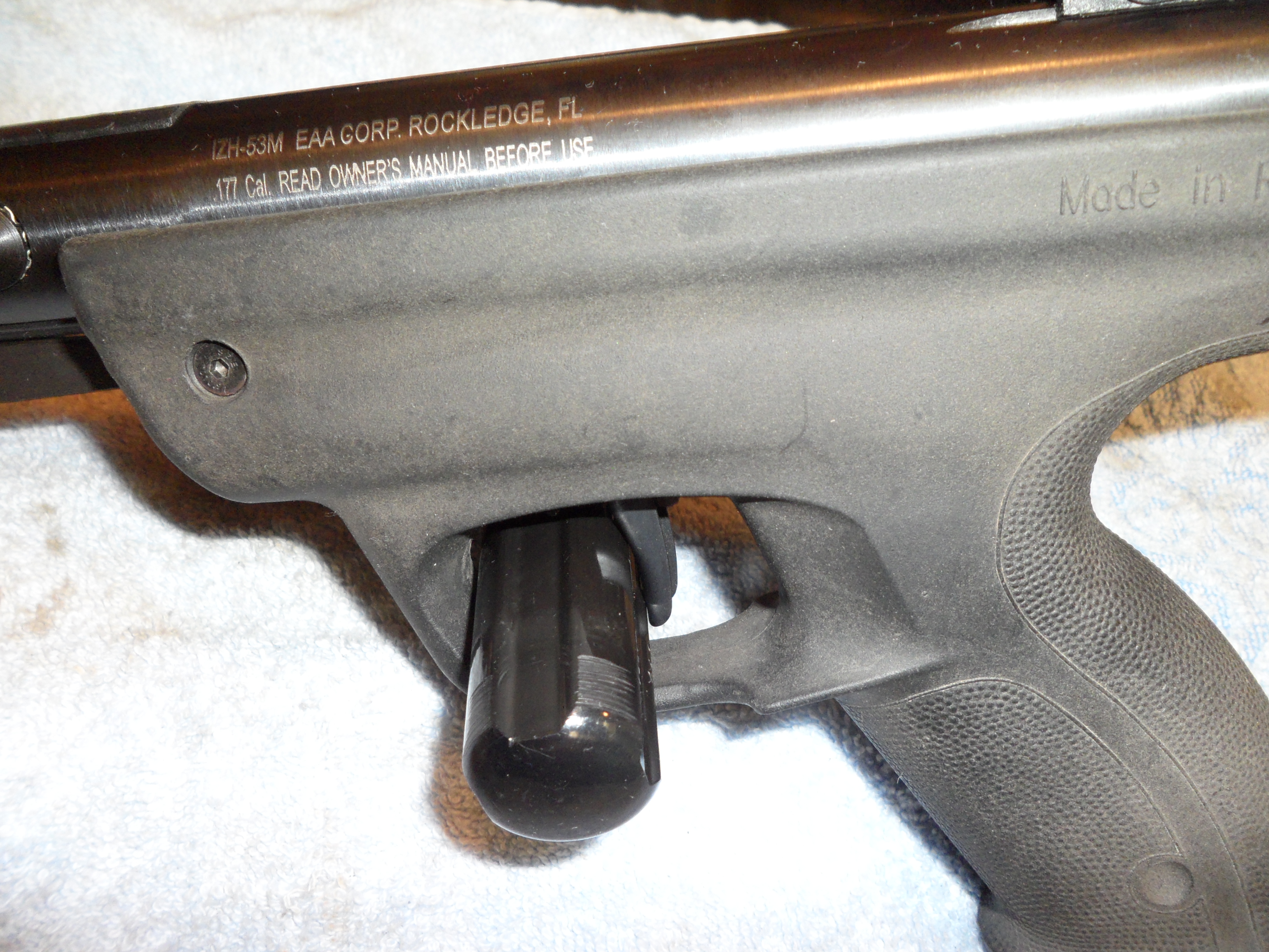

i assume you have adjusted the trigger adjustment screw through the hole at the front of the trigger guard

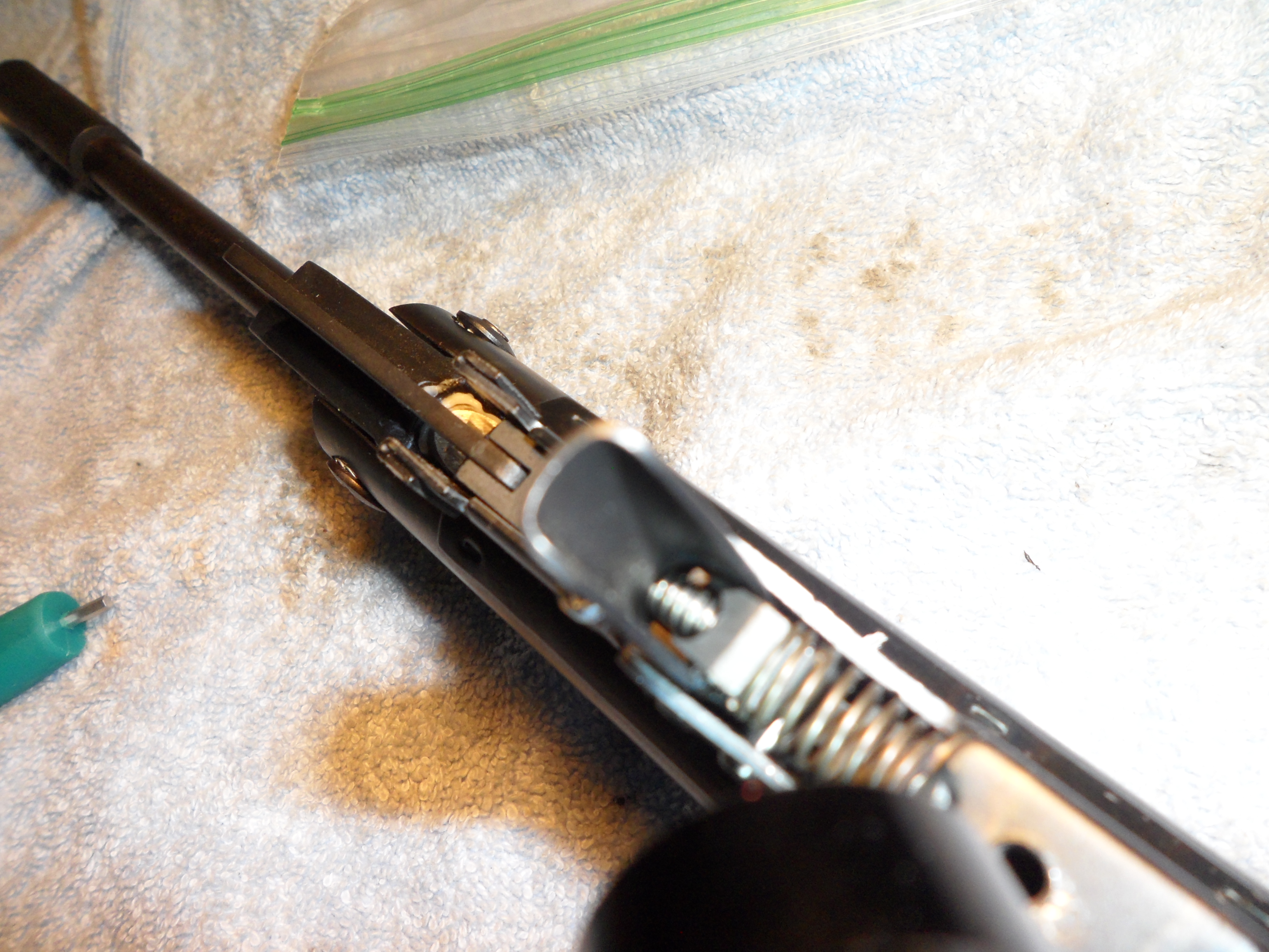

in the first picture you will see behind the trigger is a spring, and it is not the big one and it does nothing and before the trigger does anything you have to compress the spring
so instead of compressing the spring i made it solid by add a 3mm x 8mm grub screw and now the trigger has a positive feel

one picture shows the white nylon spring guide hat i made that fits in the rear cap it has 2- .5mm stainless washers to act as a thrush bearing and the from has a small top hat with 2 more washers and of course the spring was polished and a new seal was installed

So, I removed the gun from the stock to reveal the trigger adjustment screw. Could not turn it in... WTF! Took it out completely to inspect, the part of the frame that it screws into is like a square nut captured in a formed sheet metal tab. Well, that tab had not been drilled "just enough" thru and the screw could not pass. So I Dremelled it out with a ball end carbide cutter. Put the screw back in and adjusted it untill just before sear engagement. And that is not something you want to do with this pistol as it locks up the whole thing and requires a bit of fiddling to release. Trigger now "better", still a lot of takeup and the release is not the greatest...but better. Taking it all the way down and polishing the sear parts would no doubt add a bit more silkiness to it.

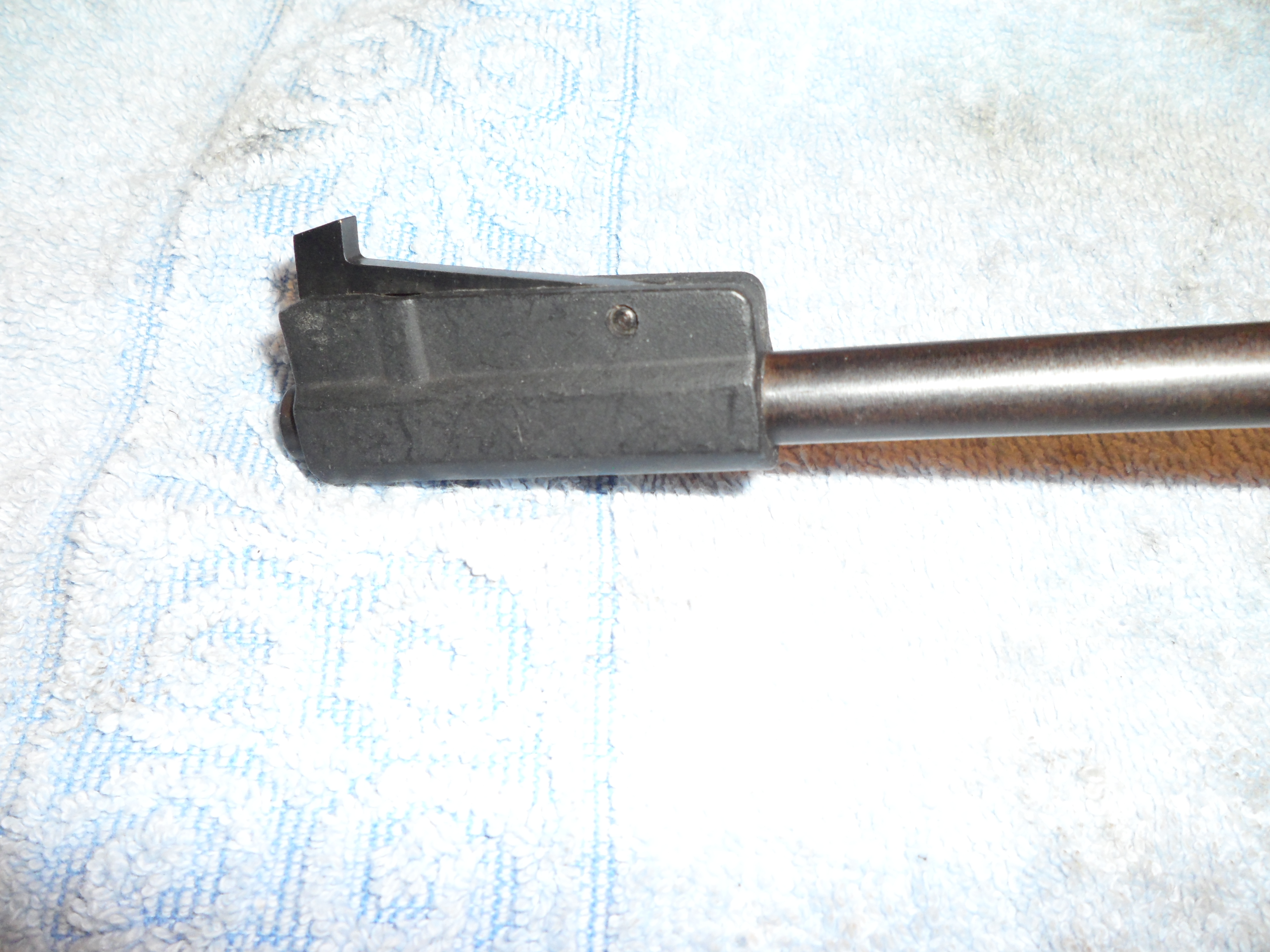

Finally found the breech seal, it's on the compression tube of all places. The only way to get at it is to remove the barrel. And the front half of the breech, the part that the barrel goes thru is, of all things, plastic. Nope, I'll just stick with the red dot. And the seal on this gun is phenominal all things considered. If I put my thumb over the muzzle and pull the trigger, it holds pressure for several seconds. And the barrel is like glass inside, very nice.
