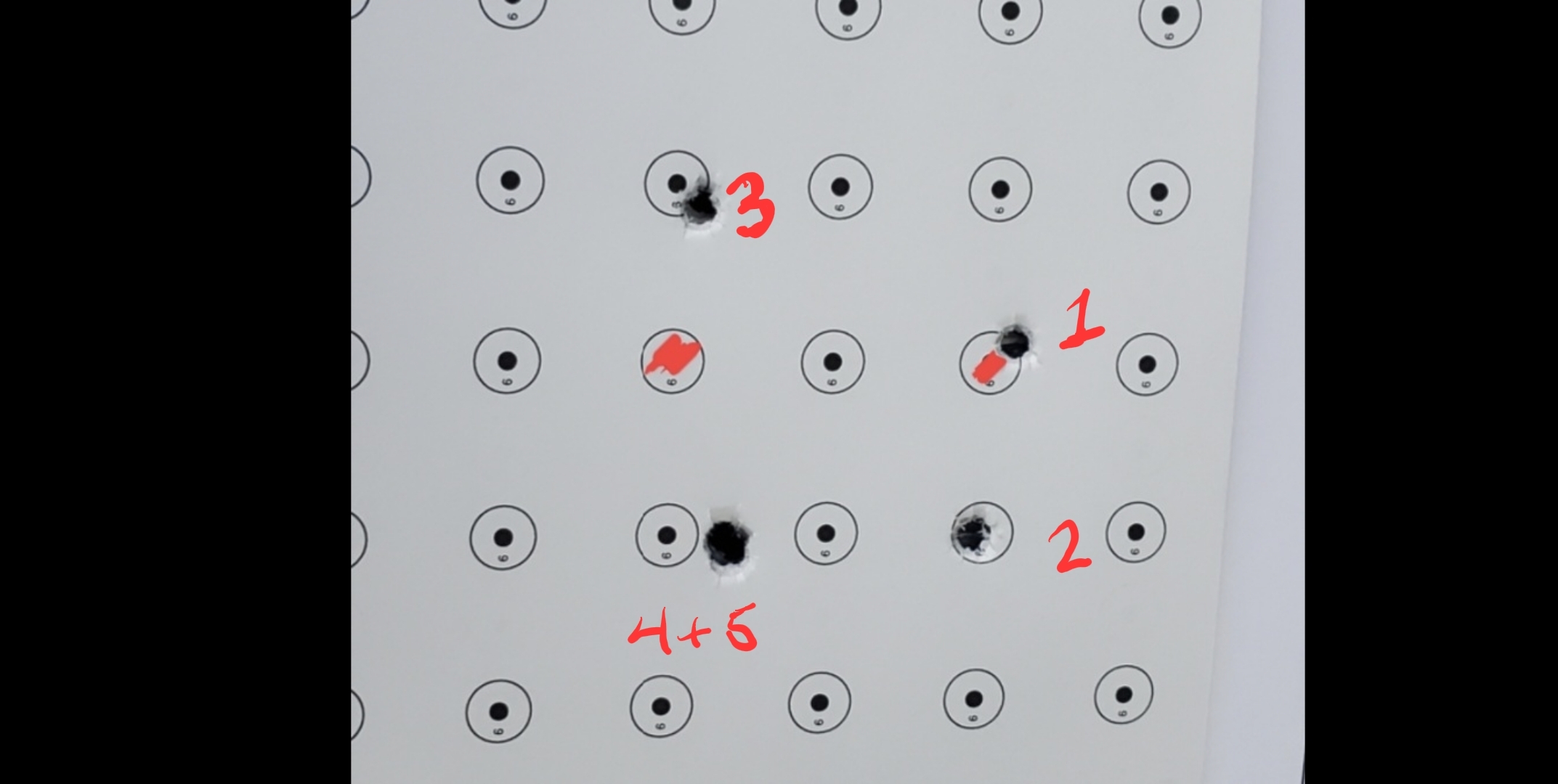

But if you really really think that your tensioned barrel is actually that stiff. I dare you to try this. Put on a small/or no moderator on that ultra stiff barrel you have. Fire it at a point at least 35 yards away. Then get a heavier moderator like a emperor and aim at the same spot. Just the barrel without support and see what difference if any do you actually see. If it was actually that stiff there would be very little movement correct?
Allen
And it would be nice if it actually was stiffer than the ones you can buy. So after I wrote that statement above I decided to try it myself to see if it is stiffer and if the holder helps at all like you stated. This is all done at 34 yards. Since the barrel holder is already on the number one shot (red dot on right) was also my zero. I have a small hugget on the end. Number 2 shot is with the Emperor screwed on. It did drop some all the way down to the next bullseye. Now I removed the holder and screwd the hugget onto the barrel again. It shot high one bullseye above my bull I was aiming (red dot left). I screwed the Emperor back on and shot two times to make sure it was the same with the heavier moderator. It shot low on Bulls eye. So basically the way I see it the barrel holder cut the barrel droop by half and dramatically increased the stiffness.
Now if I actually was really smart I would have done the same test with the side retainer bolts in and hopefully get better results. 🤪
Allen
Sorry I may be misunderstanding here, but are you entirely sure the barrel holder hasn't just in effect pushed the barrel down when installed?
The poi went up without it installed with the lighter mod, the your zero poi is where it is by the barrel holder pushing the barrel into a position that aligns with the whole rail.
but with the heavier mod poi simply drops to the exact same height with or without the holder. If it had significantly changed the stiffness the poi at shots 4/5 should have been higher.
Anyway, with mine I don't get a lot of shift with different mods. Some for sure, as it's pretty much impossible to make a long barrel stiff enough not to move or change harmonics at all. That said Hein tightens that nut at the front of the CF tension tube WAY tighter that anything I would have ever dared attempt had I not seen him doing it, so that may well make the difference.
Anyway not trying to tell you not to use the holder or anything. Just an interesting topic I think. It'd be nice to see if your long range accuracy is better with or without it installed too.

Yes, I think it was a bit late getting home and I was a bit excited to start testing with all the variables at hand. I do believe the barrel was pushed down a little. As POA vs POI was different. However POI with the barrel holder vs. without is still a lot smaller. I will have to redo the test later tonight afterwork or in the morning tomorrow.

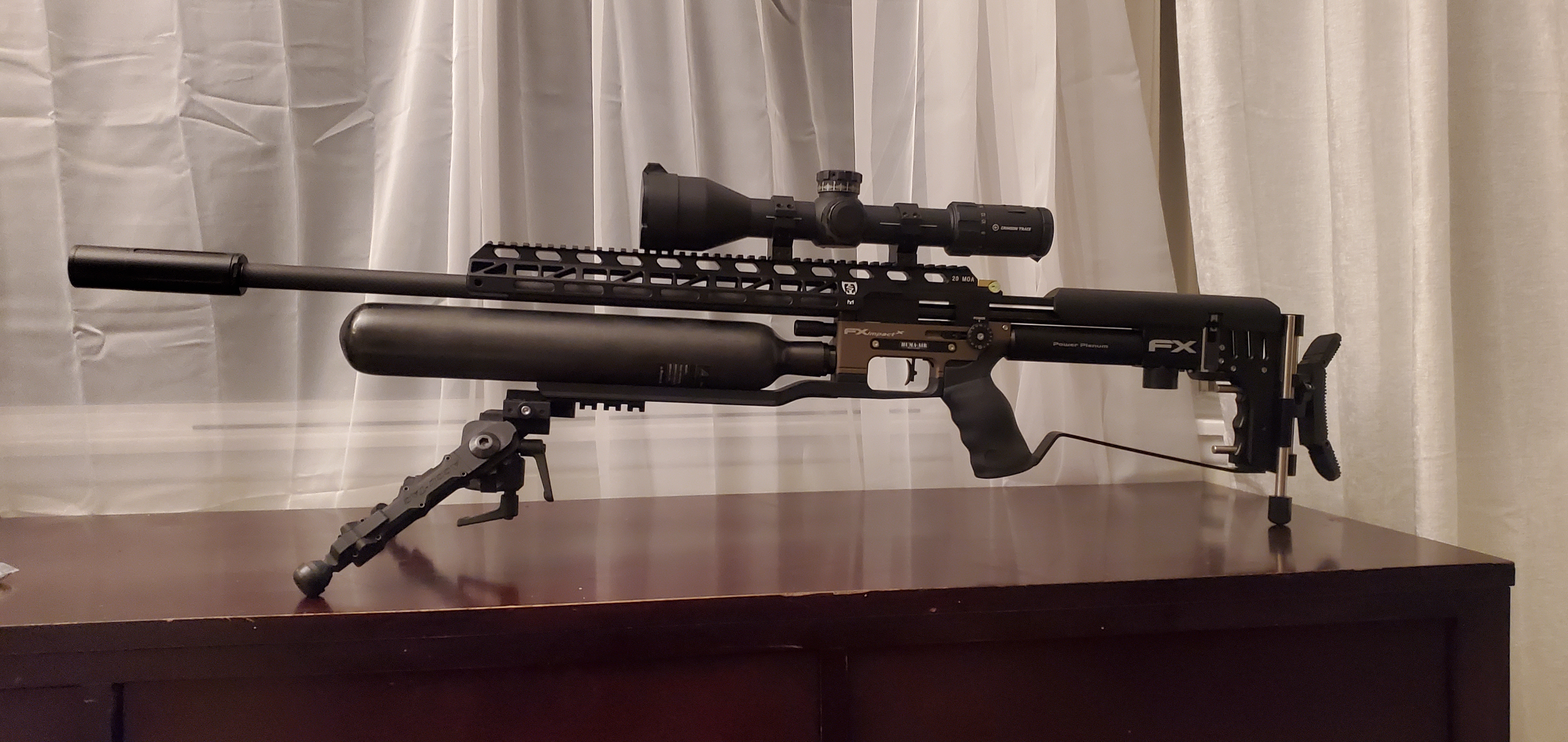

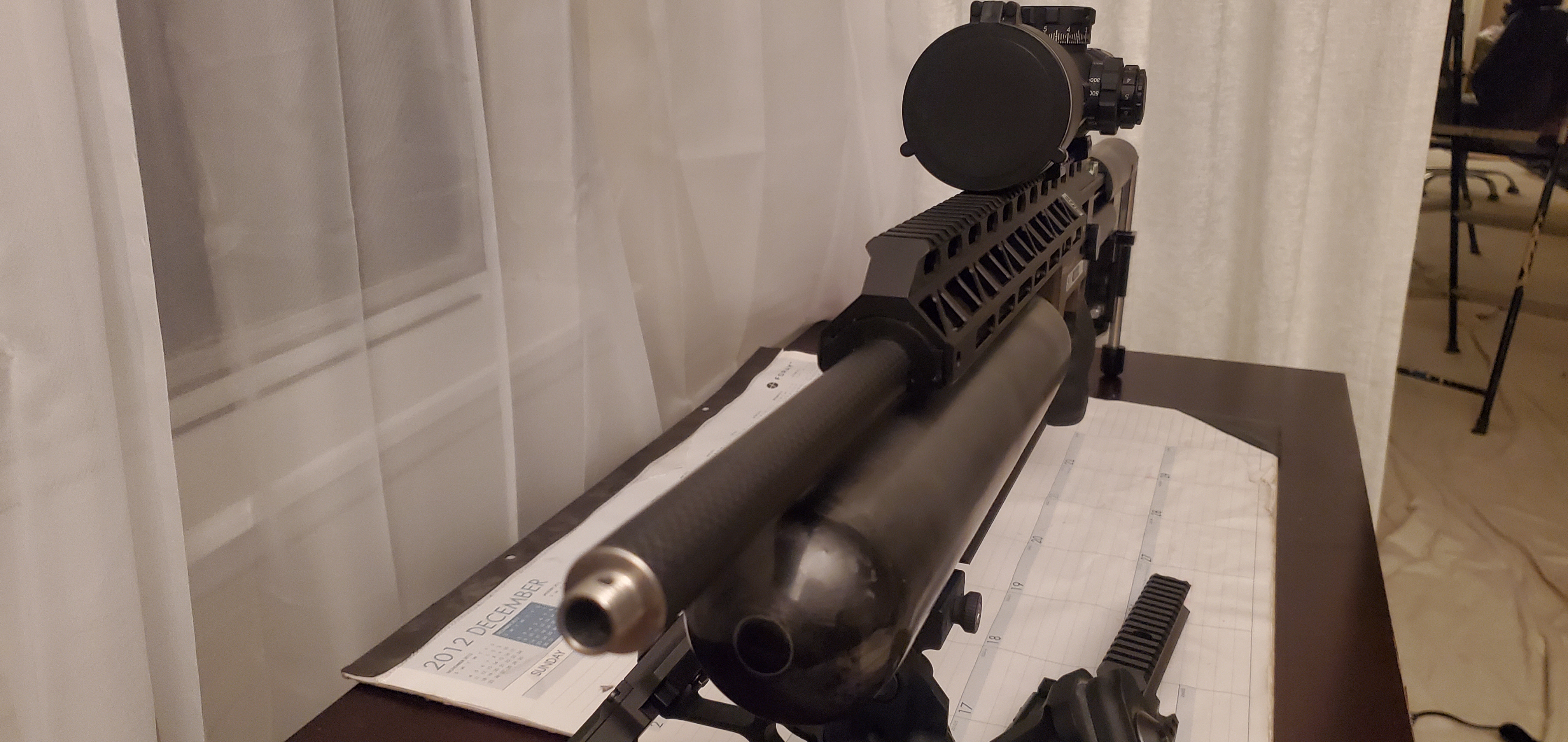

I just ordered a utg off of amazon to see how I like it. I will see how it works the Monday after next. But I have not been able to test much around the house. Been trying to get a tactacam to work with the scopes and not having fun but lookie!
And surprisingly you cannot see the mount when looking out the scope.

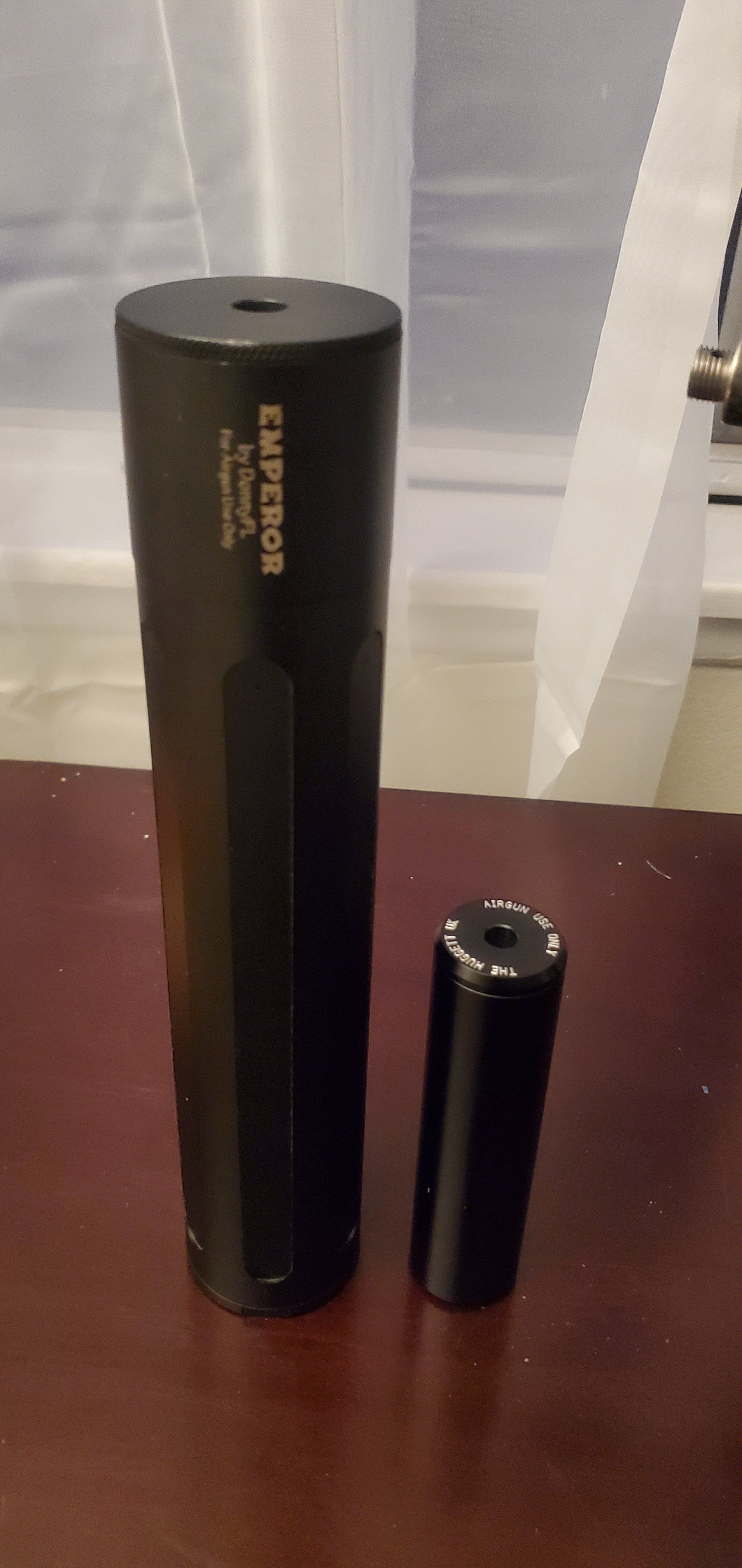

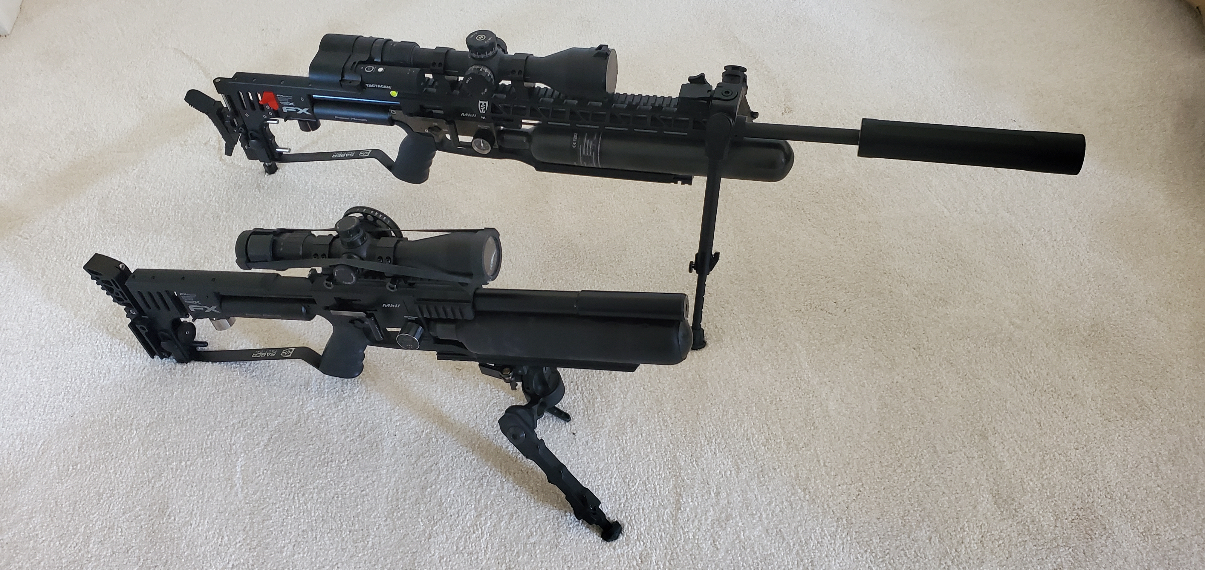

That's with a little hugget . This is with the Emperor compared to a compact with a 580cc tank.

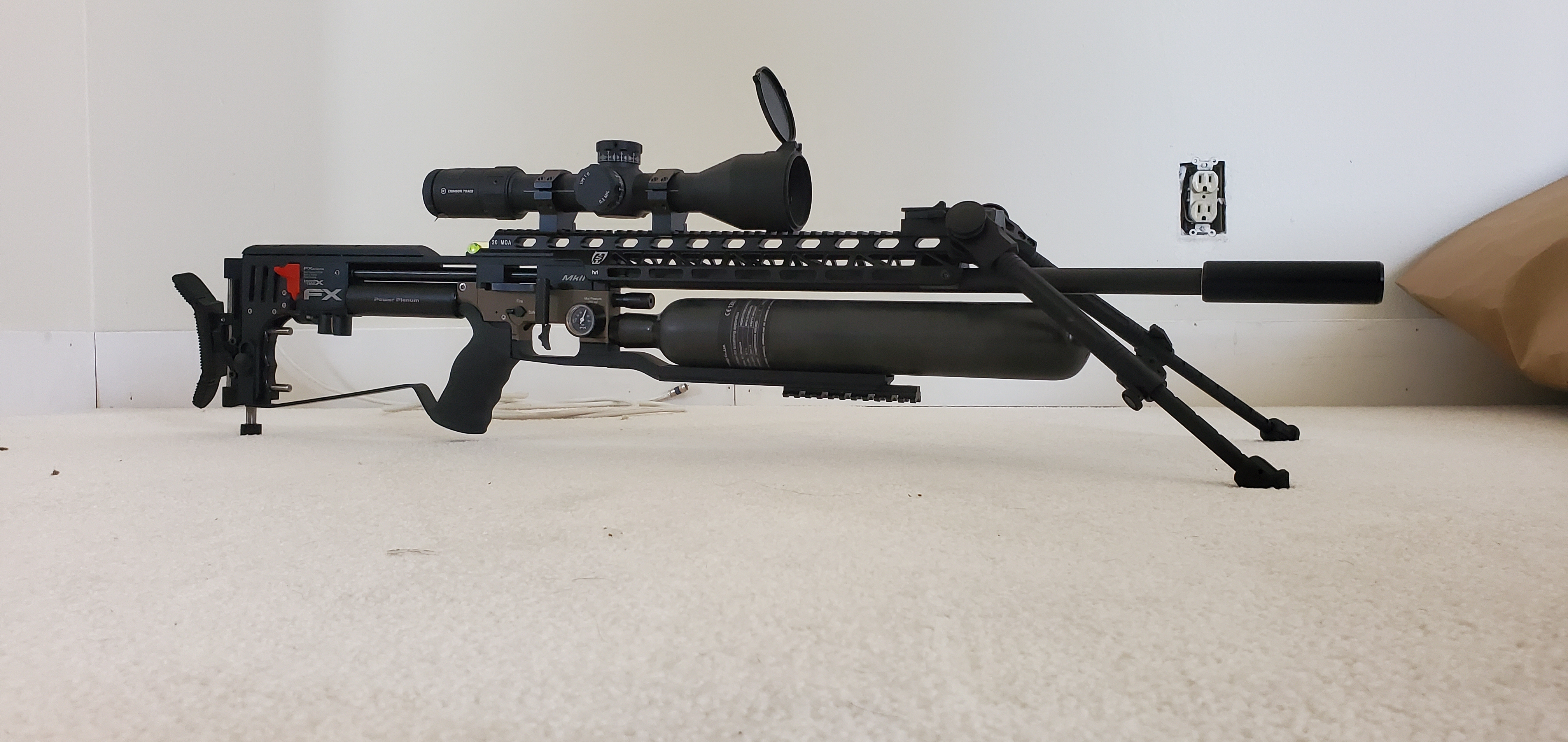

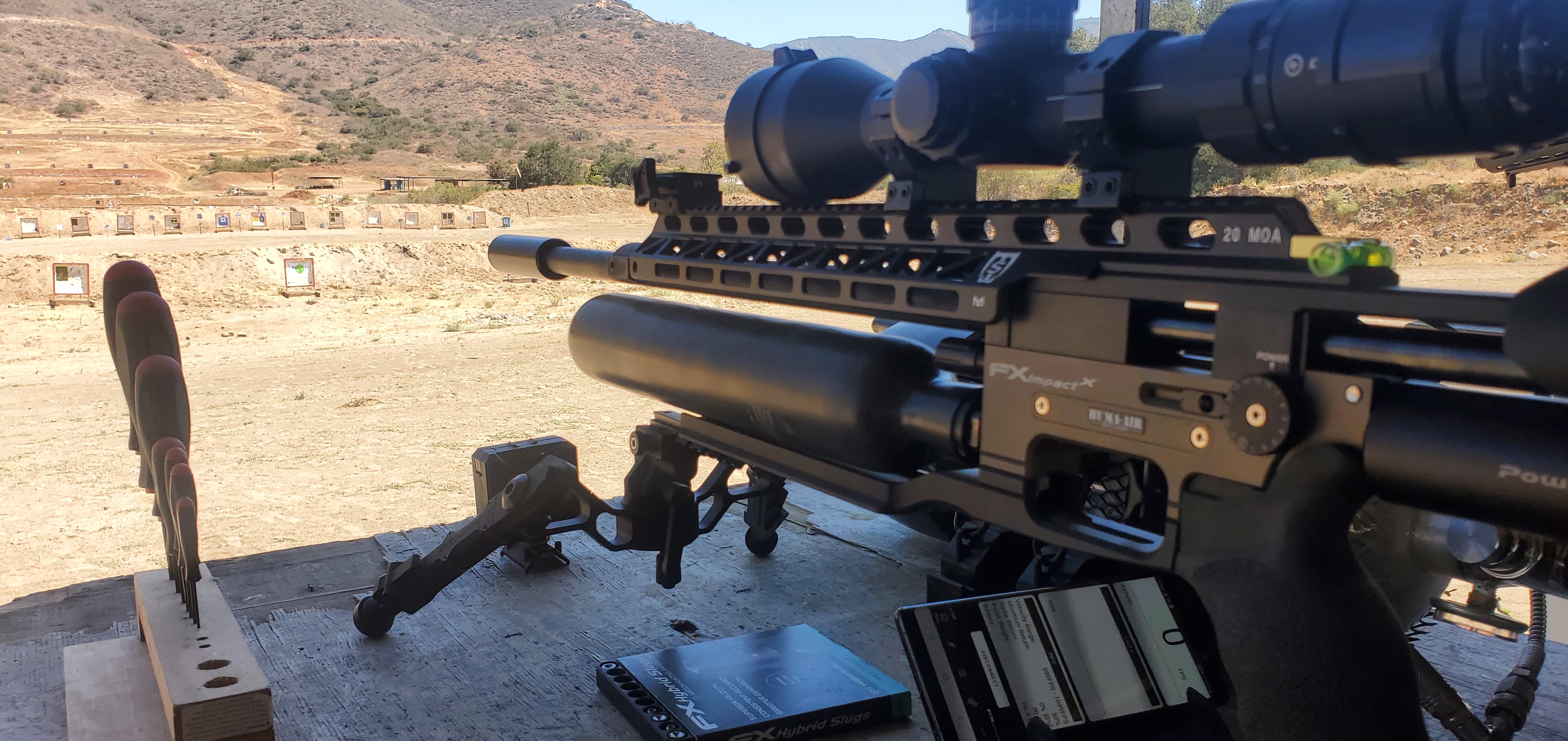

Today I finally got to use the bipod and TRS rail. I kind of like it. Yes there are some issues. I wish the bipod would lock up the cant at any position I want, but it is just a resistance bolt. It won't stop the cant from moving. My monopod is on the right so the gun canted counter clockwise. The legs don't fold backwards. Like if your table was too short. I used both the Accu-Tac and the UTG bipod today and the UTG tends not to jump and rotate when fired like the Accu-Tac does. Is that better? Well it depends on how you hold the gun I guess.
Sorry forgot to take a picture of the over the barrel bipod at the range as well.
I also noticed I ran out of scope at 200 yards with the 20MOA TRS rail which is weird because my impact has 20MOA stock and my CT5 series scope is 34mm too! Hopefully nothing is bent. Edit the scope lid was touching so I removed it and I got some elevation back. Towards the end of the day I did change the rings out so the scope was more centered.
NOTE : I DID NOT HAVE THE FRONT BARREL SUPPORT INSTALLED DURING THIS DAY AT THE RANGE It was on but not pushed back where it was touching the rail system.
I was able to get a slightly smaller group with the Over the barrel bipod. But there was wind involved and I'm definitely not a great shooter. So it's just my point of view. Pretty good considering it is compared to the expensive bipod that is 3 times more costly.
