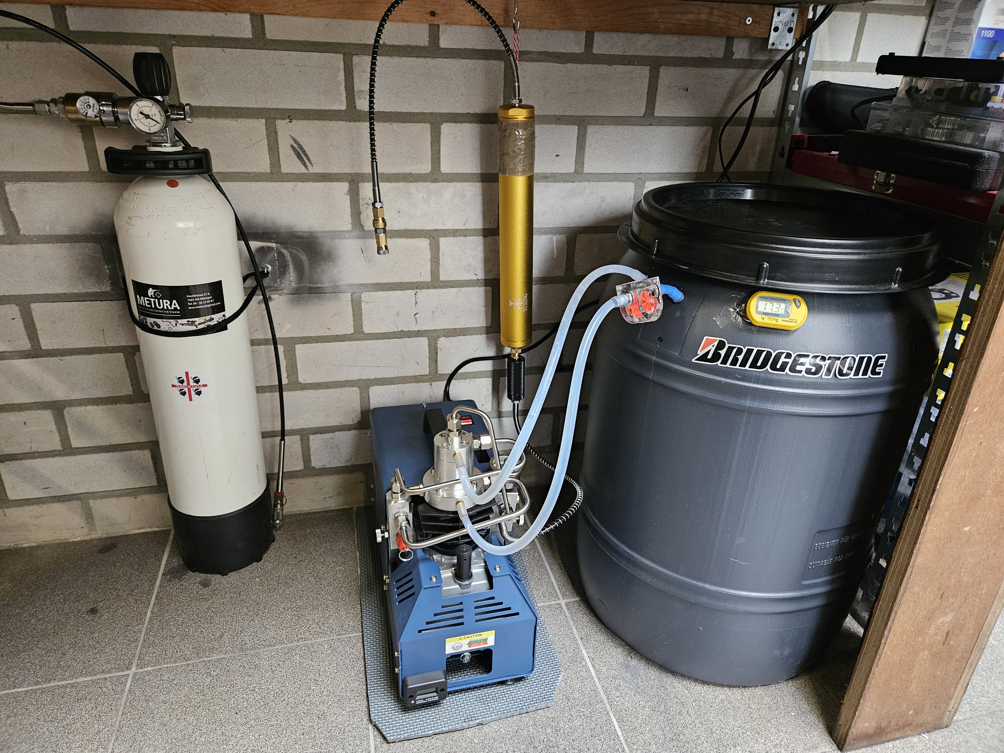

I'm using a 16 gallon pet food barrel, filled with soft water and an upgraded aquarium pump. That's it. It's all about volume.
The temperature gauge on the compressor won't exceed 34 degrees Celsius when I fill my air cylinder to 300 bar.
That's waaaaay below the mandatory shut off temperature.
Do you run your Yong Heng exactly in that position? I ask because my Yong Heng is very similar to yours , in fact it looks to be identical to yours , even the filter on the air line is the same. On mine though, if I had that end right up against the wall, it could not pull in cooling air for the electric motor that makes compressor pump and the electric motor would overheat . The electric motor has a fan built on the end you have against the wall On mine, perhaps mine and yours are not the same if yours runs well in that spot you have it in or the pic makes it look closer to the wall than it actually is. There are so many different versions of that Yong Heng I guess anything is possible really. I like your overall set up though, that is a nice set up with the cooling water for sure, I hope you don’t mind I’m going to pretty much copy your cooling fluid set up. Happy shooting!
Reactions: Tuinschutter
Yup, I run it in that position, but it's not against the wall actually. There is a 3 inch gap between it.
The compressor itself is yet another rebrand. It's a VEVOR.

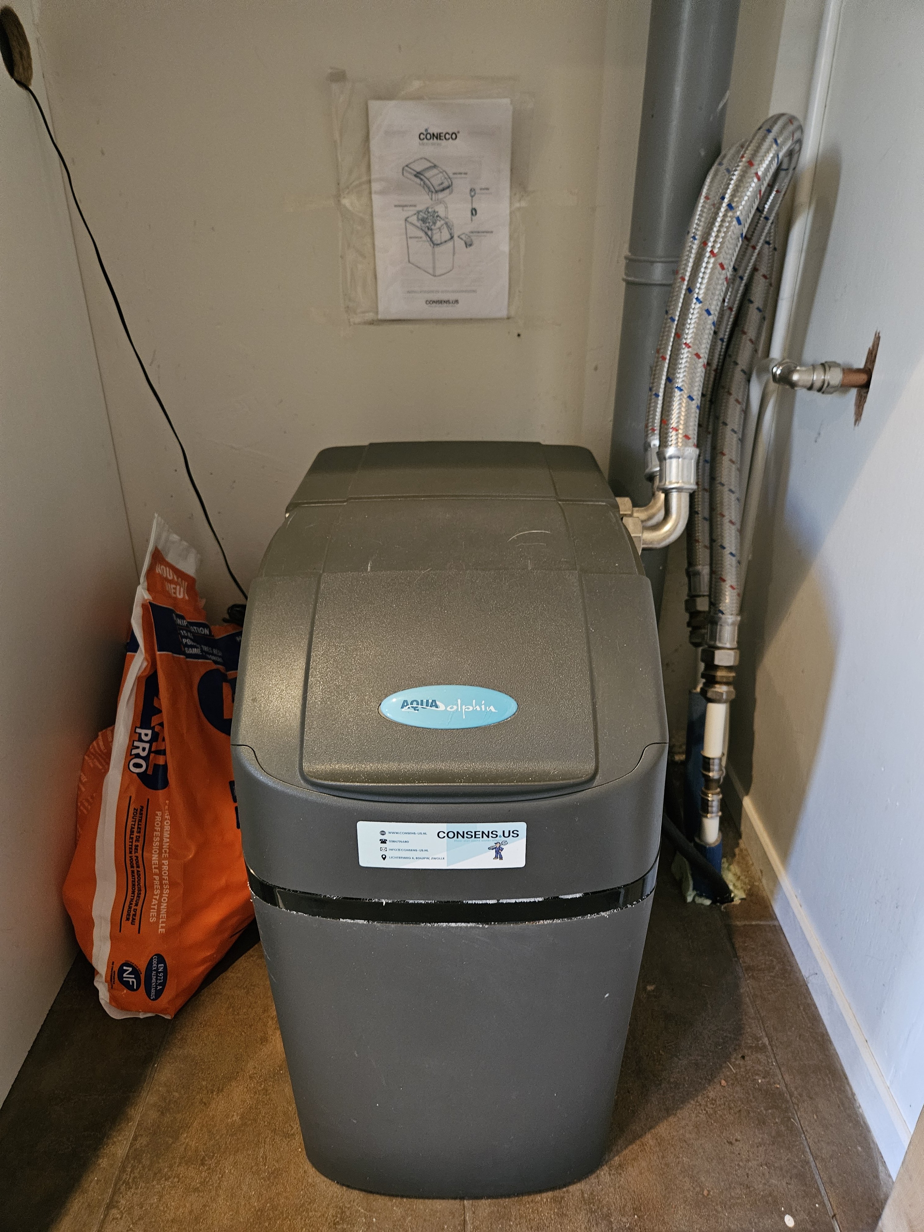

I'm in a somewhat lucky position, because we have a descaler that's connected to our main water supply.
I was told it is made from an aluminum alloy. If you don't want calcium deposit, use soft water.
You might want to check on how much damage the sodium that water softener adds to the water may do to aluminum. Salt will cause aluminum to oxidize. I bought a thing that is electric, i had to wrap an electric copper wire around a 16 inch section of my water supply pipe and connect this box that sends current through the wires I wrapped around the water pipe, this changes the stuff that sticks on a molecular level and it can no longer attach firmly to metal parts , the stuff will slightly stick and then pop off on its own. That is my water heater elements it does that to, I still have to clean the pieces of deposits that pop off out of the bottom of my water heater once a year. It doesn’t work on extreme hard water, it has to fall into a certain range , I think it’s well worth using if your water is in the proper range for device to be effective. No more sodium in your water. The minerals in the hard water won’t hurt you any really, if worried about kidney stones just drink some real lemon aide once a week. The sodium can contribute to high blood pressure and higher levels of sodium in general. If you sweat a lot at work or working out then the sodium is less of a health concern really. Just some fyi on those softeners. The membrane that hold about 1 million resin beads in the pressure tank on mine burst and sent those million little resin beads inside my house and trashed every single fixture I had installed , I had to replace them all and that’s when I found an alternative to those softeners. Something to consider maybe.
