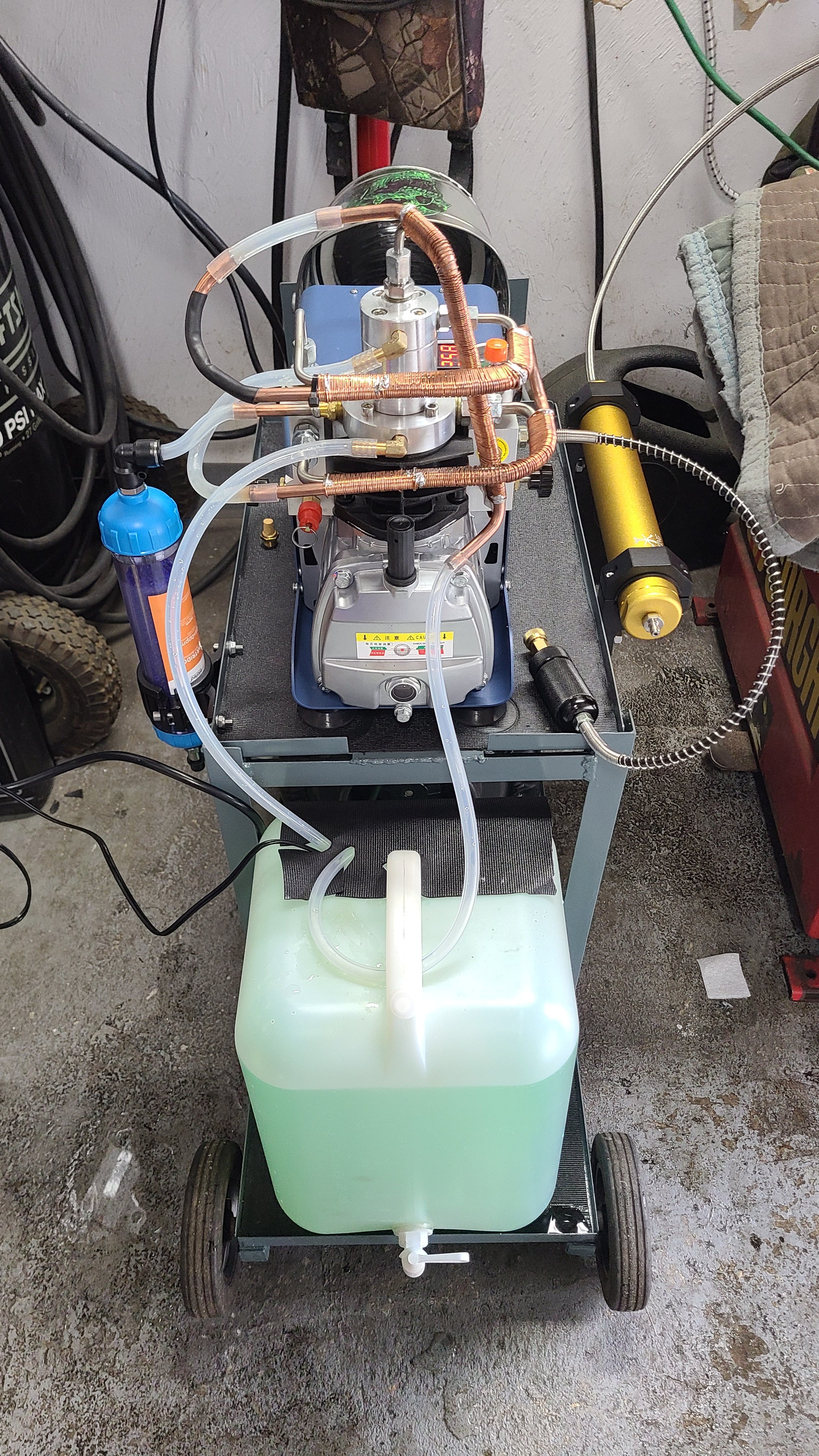

Updated the water pump also added copper tubing to the high pressure air lines which helps
I have a 5 gal res but I also made a cool can for summer temps distilled water with water wetter I also restrict the water flow to allow heat transfer otherwise it flows to fast
Over all I can keep the temp between 125_137 cyl temp
I dont run it any longer than 45 min at a time and change the oil every 10 hrs use
