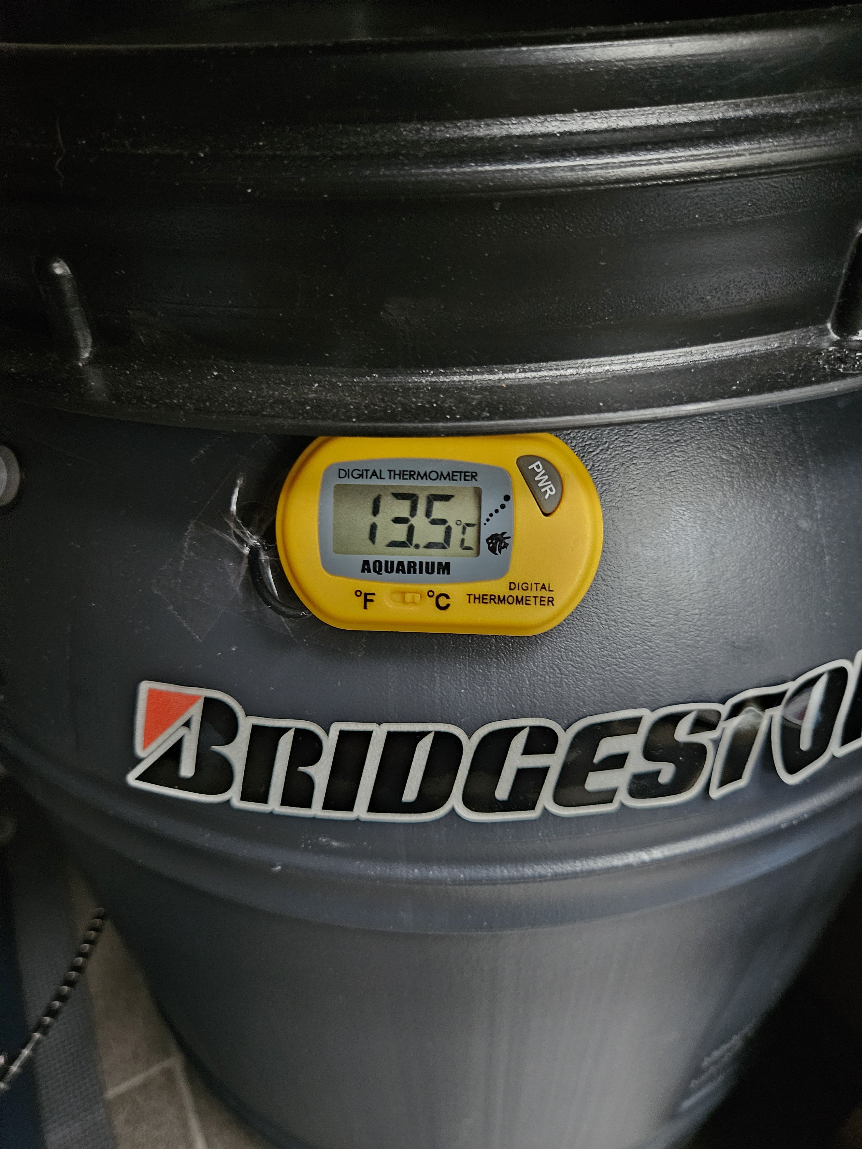

My setup is in the annex (hope that's the right word, as I'm Dutch).
The temperature will rise in the summer!
As we speak, the water temperature has dropped from just under 18 degrees (inititial setup) to 13,5 degrees this moment.
But still, I do believe this is the best setup.
Even if the (starting) water temperature in te barrel would rise to 25 degrees in the summer, it would still do it's job in a proper manner. No way the temperature in the Yong Heng would exceed 65/70 degrees.
I'd be monitoring it the first summer though, just to be on the safe side.

Yeah, I noticed that your water temp was pretty cool -- I thought maybe you had just filled the barrel from the cold water tap. I don't have a water temp gauge yet (I threw my Ph monitor away that had the temp on it). With my room-temp water running through the room-temp compressor head and my high-flow fan on (230 cubic feet per minute) that is bolted directly to the back of the compressor, the compressor head temp is 22.6 degrees C. If I start the compressor from that "cold state", it takes about 10 minutes for the compressor head to get to about 53 degrees C -- and it would still be climbing, but I was actually done topping off my rifle. So the compressor got hot, BUT the big-assed bucket of water didn't feel any warmer to the touch. The bottom line is that I just need to get a lot more of that bucket of water through the compressor head per minute. I'm confident that the new water pump and my 20 gallons of water (might go to 25 gallons) will let me top off two 45-minute Scott scba tanks plus top off my rifle several times a day without me needing ice and without me changing my usual duty cycle of about 10 minutes on and 5-10 minutes off. It'll be nice because ice isn't an option for me and I will no longer have to dip gallons of warm water out and empty it into the bath tub and replace the warm water with cold tap water during fill operations. This will be a fun experiment.

That's not a picture, but a videoclip. So you can see it for yourself. 🥳
I had just rolled out of bed when I looked the first time -- was waiting for my first cup of coffee to brew and didn't notice the play button.
It's funny that your end temperature is not even 5 degrees more than my starting temperature on the compressor head.
