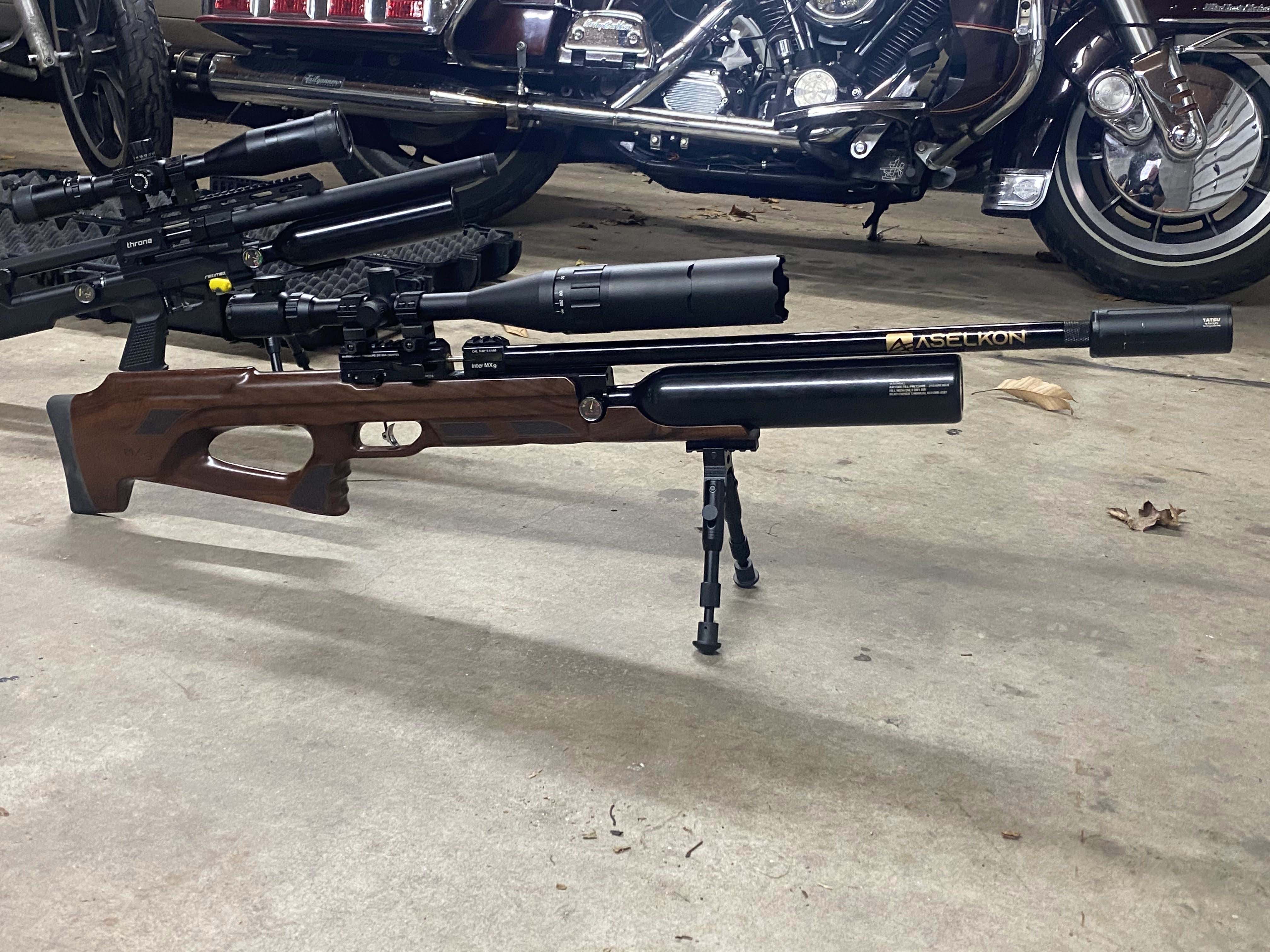

Mine then as you can see the MX-10 bullpup flavor (same hardware just about though). Yep, it even came to getting rid of that god awful two comp PLASTIC clear coat some idiot at Aselkon decided on was a good idea to drape that actually wonderful walnut in. (Yeah i´m a sucker for oiled n buffed wood stocks.. so shoot me).

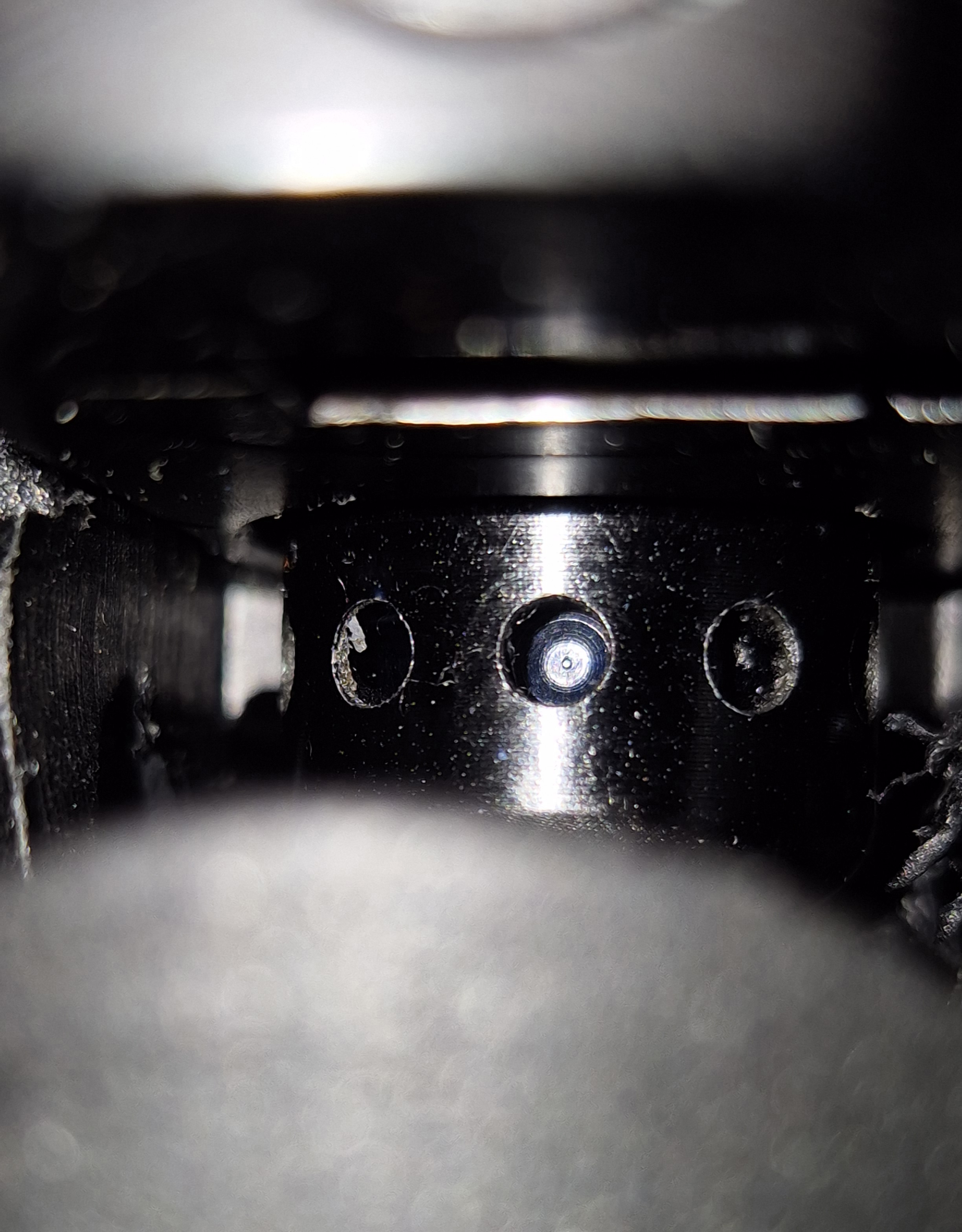

As these are regulated guns just port to caliber size and be done with it. Ie; if a 22 make transfers 5.5mm and a 25 6,3mm (1/4") Point being that power can always be adjusted DOWN, it´s way harder to increase on a gun that isn´t let to breathe.
