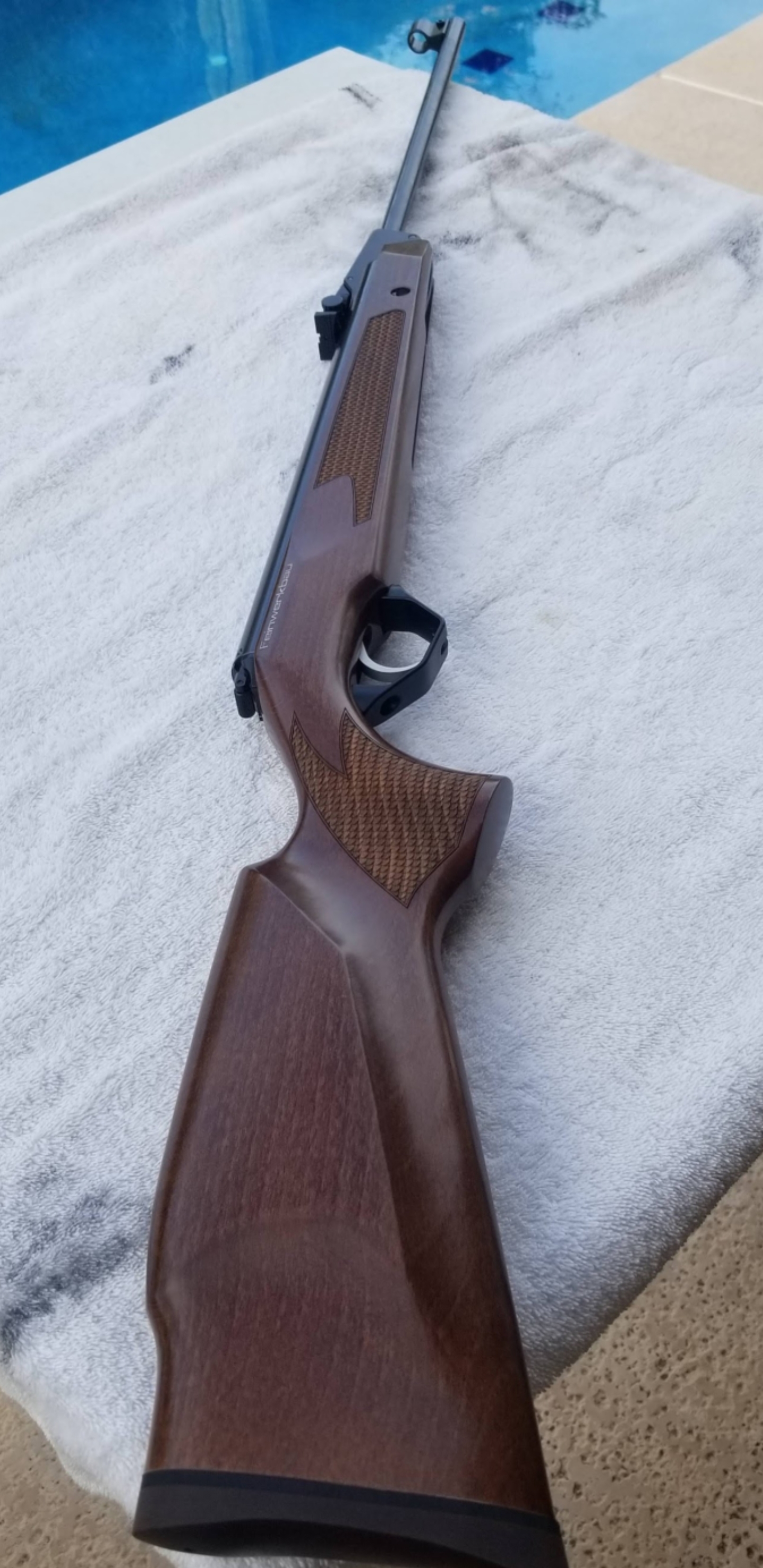

I was curious how many were actually manufactured (mine is serial number 552), so I contacted Feinwerkbau directly and received the following info from a Mr. Volker Müller:
The Sport model was launched in 2014 in variants with 7.5J and 18J muzzle energy and was produced in small quantities until 2022.
Total production figures:
7.5J variant - 120pcs.
18J variant - 607 pcs.
At approximately 80/yr over the course of nine years, those are shockingly low production numbers. Equally shocking is how low the power level is for the German market. I knew they were regulated, but I didn’t know they were that restrictive. 7.5 joules is only about 5.53 FPE.
I like the gun and its a great addition to my collection.
