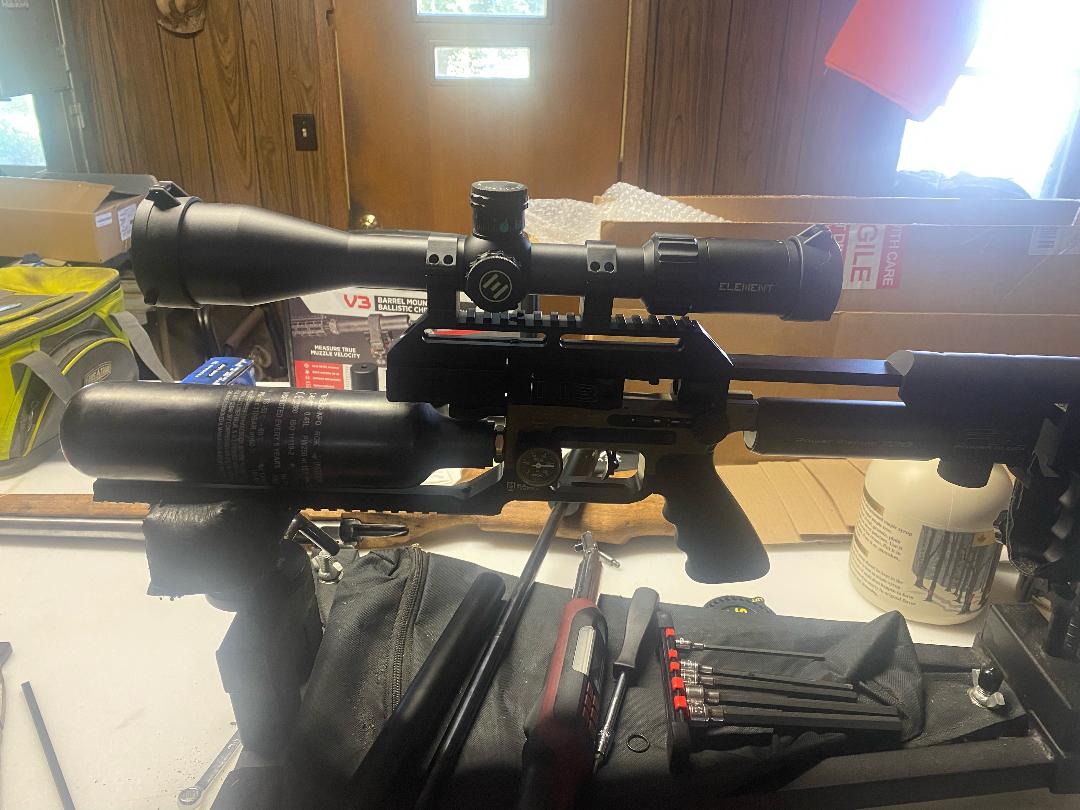

2.) The scope rail does not allow for centered scope rings on the tube. The front ring has about .100 of clearance from the turret. It is currently sitting in the only place for proper eye relief.

I've attached a picture of my scope mounting so you can see what I am talking about.

3.) Installed a MSR mount to get the scope higher and space out where the ring caps sat on the scope (no effect, not enough recoil to move the scope at funky angles while shooting.)
