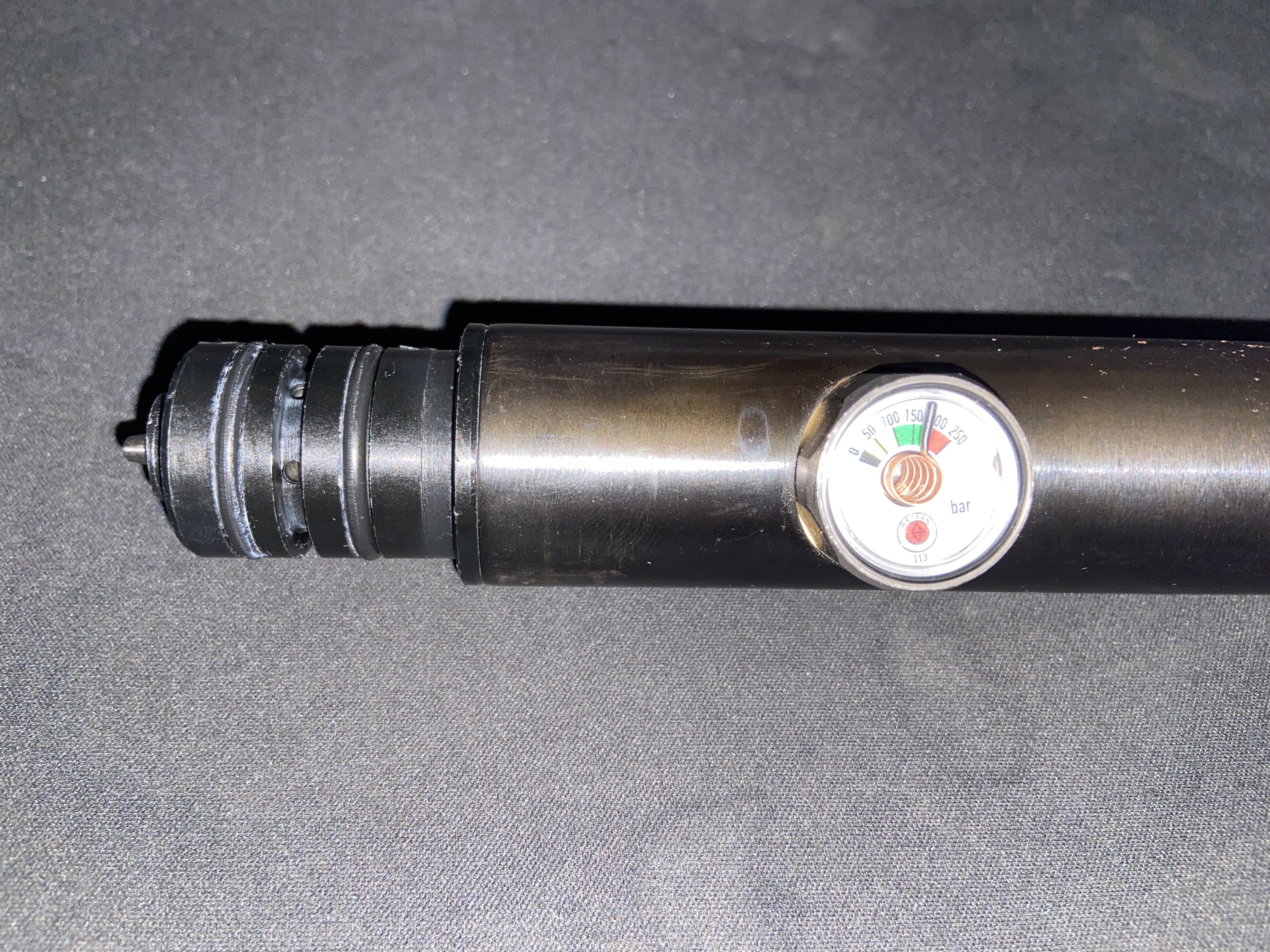

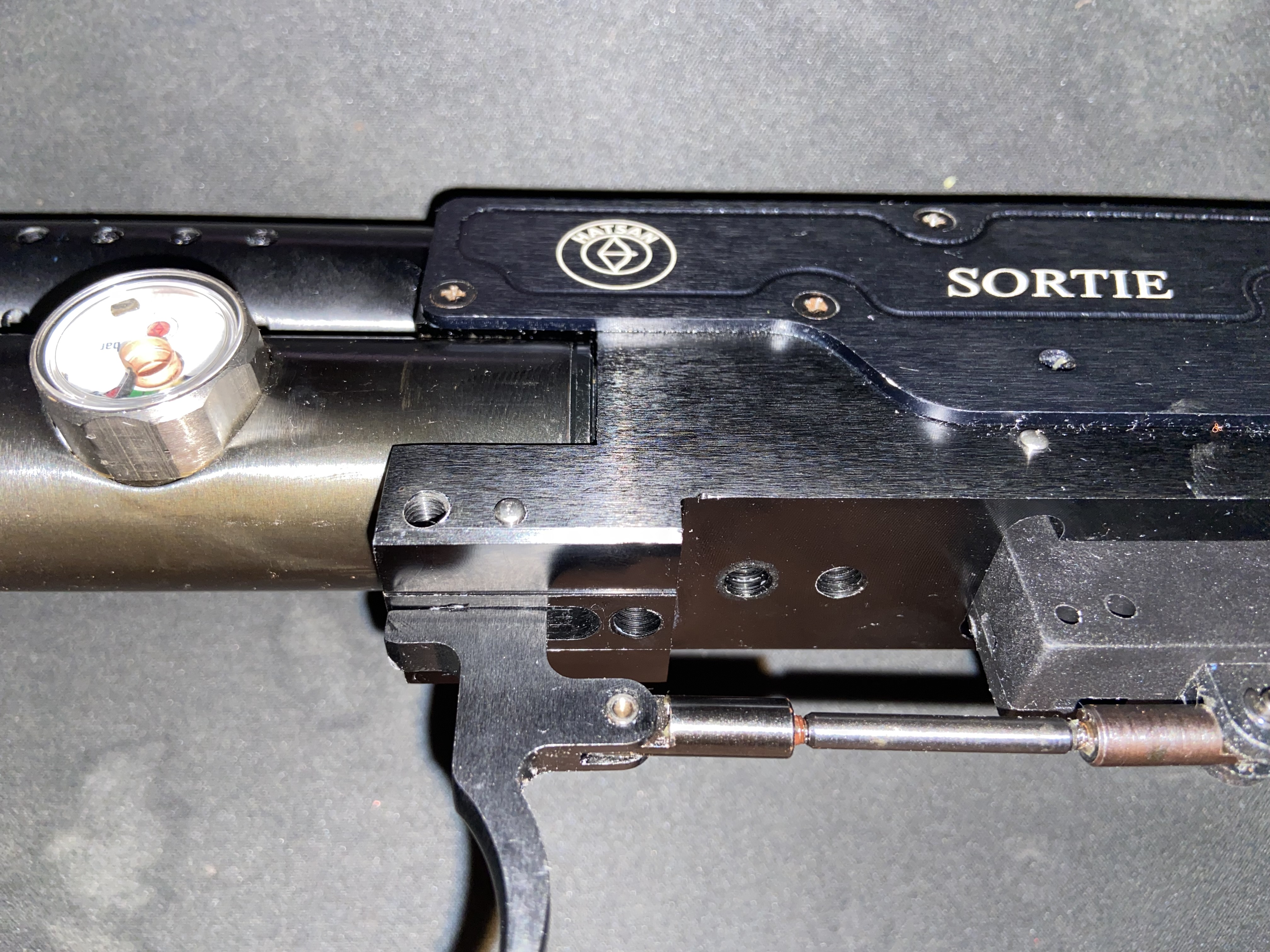

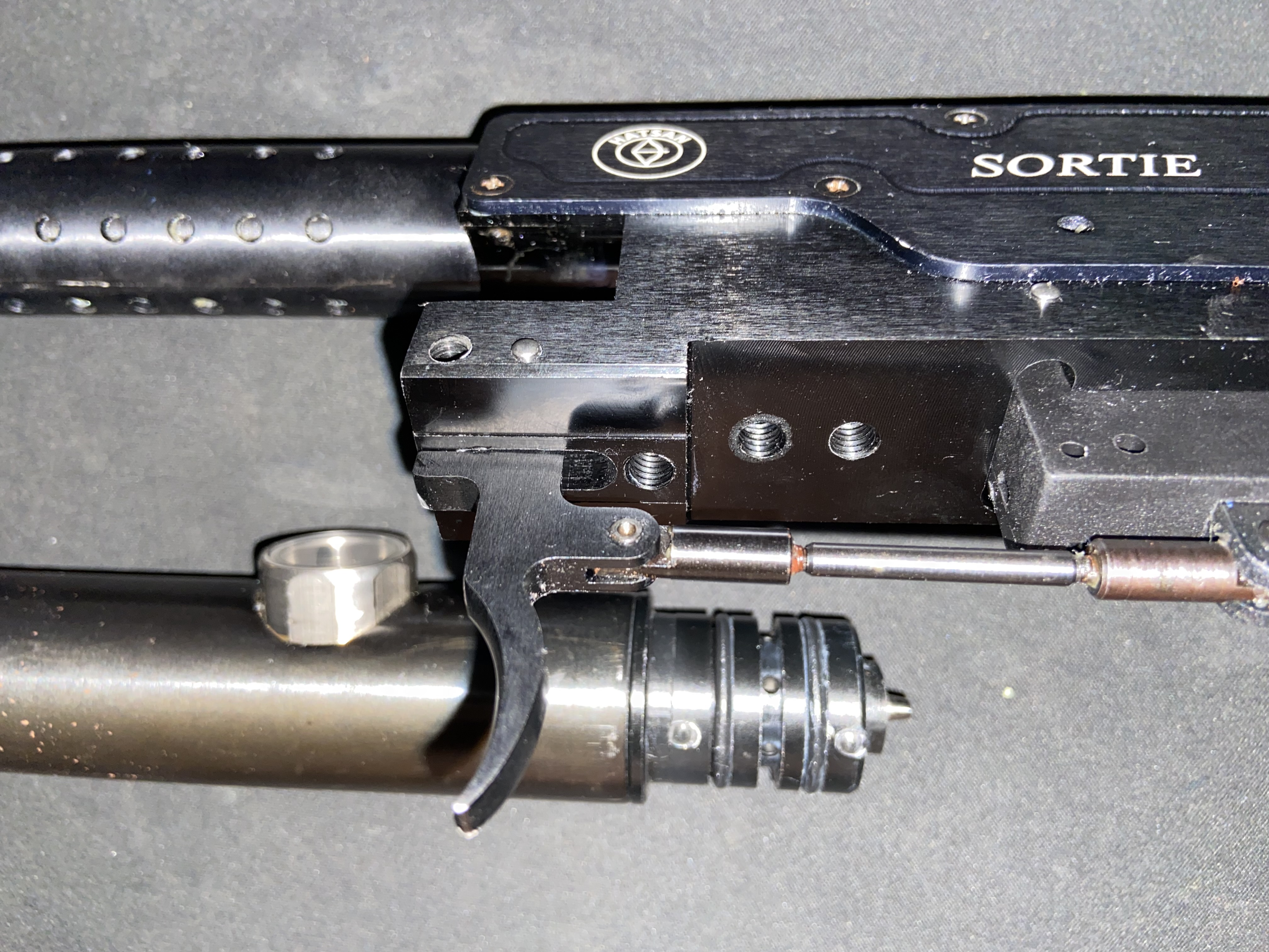

Hey, just a little tip...the Sortie air tank can be removed without needing to de-gas it. There are a few grub screws under the trigger that hold it in place. Loosen/remove those screws, and the air tank slides right out.
Hope this helps.
