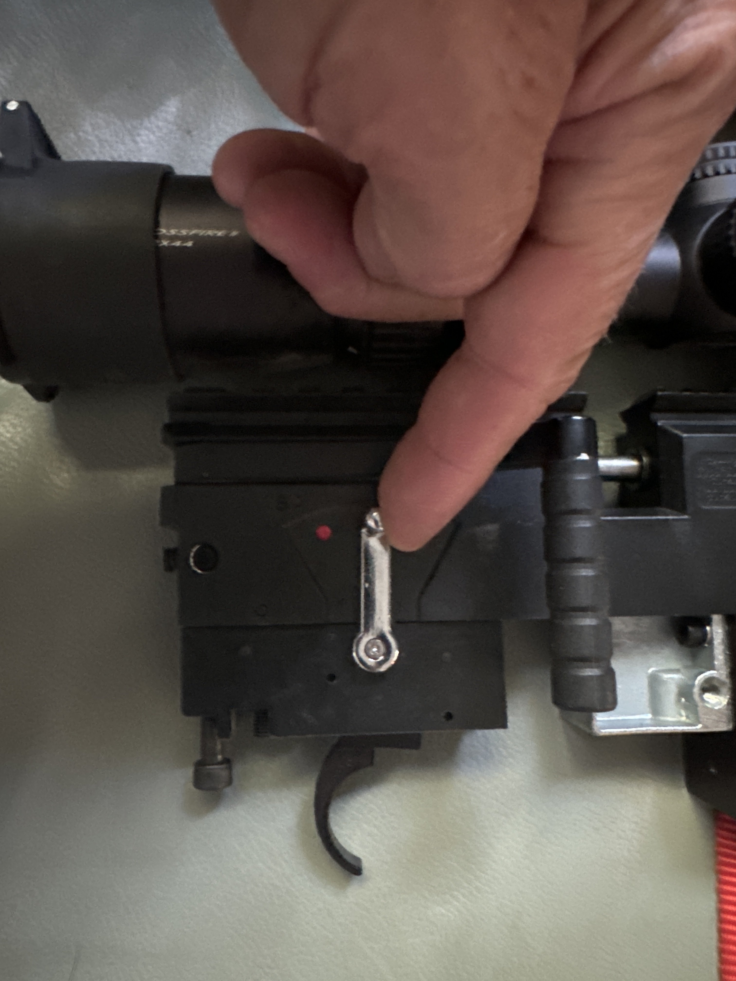

So I was shooting my Avenger today and when I was done shooting I went to engage the safety and it only moves halfway. Nothing significant changed that I'm aware of. Can anyone help me fix this? The gun is a couple years old and was working normally until today.
My guns have done that when the trigger adjustment is set too light. Is there a separate SAFETY, set screw adjustment? After looking at the picture again it appears any safety adjustment would have to be made inside, around the sear mechanism.
So I removed the trigger because I did mod it by replacing the adjustment screws with long grub screws a la Walnut and Steel on YouTube. After taking it out the safety was free to move. I put the safety into the on position and reassembled. And it works as it should. Not sure how the pieces got crossed up so it wouldn't engage but they did. I'll keep an eye on it.
