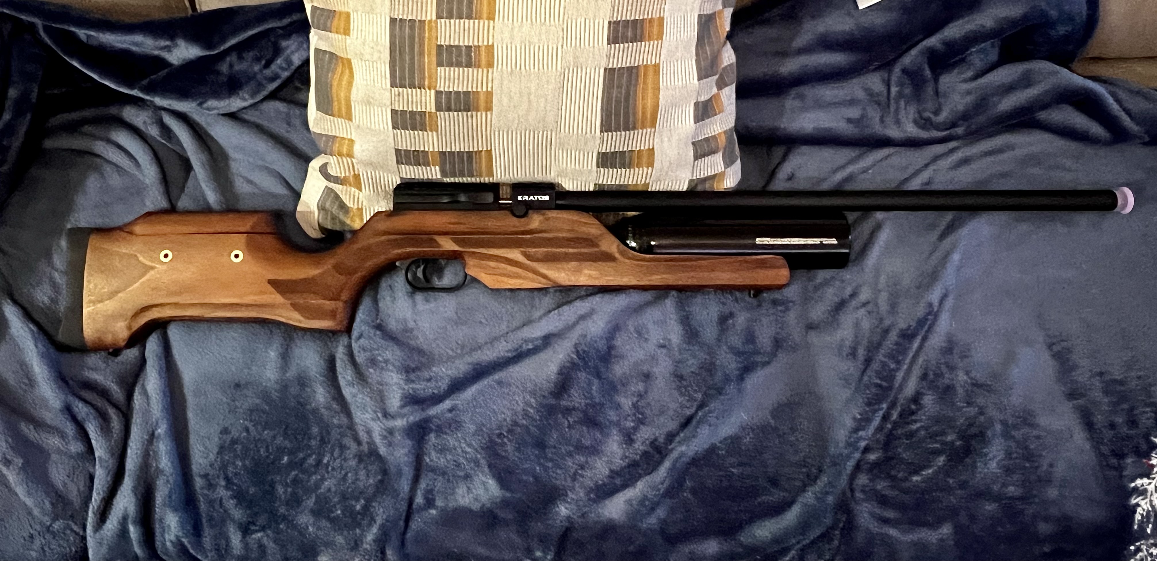

My 44in long Kratos just showed up in a 30in box. I’m heading back to work and haven’t opened it yet.
Guessing the seller removed the barrel and shroud to save shipping in a bigger box. Or he shipped me a Red Ryder by mistake lol
Quite the assumption on the part of the seller to think everyone is an air gun mechanic lol.
I'd guess the common remove stock . Maybe 4 easy screws?
Yup. You win. It was just the stock removed. 1 screw.

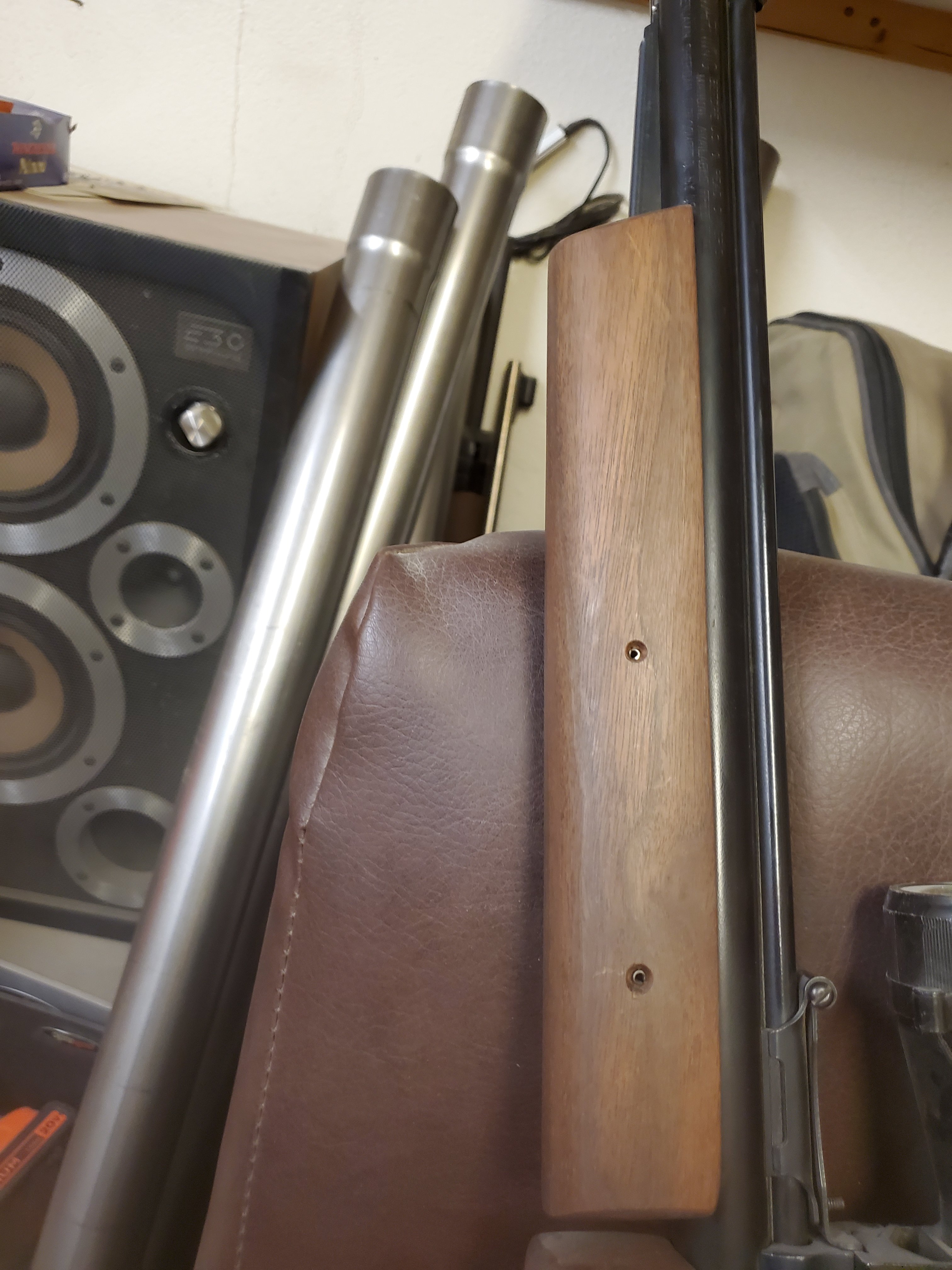

Funny you say that. It happens to have some dings that need raised.
Also would like to do some selective staining in places on it. IE:darken,shading.

For the lurkers benefit, you can use a larger one but I use a small iron for covering rc planes with plastic called monokote and a damp rag to steam dents up and then blend it in with sandpaper do the grain takes stain similarly. I don't know what you have at your disposal for tools, chemicals, and technique but I would probably use an acetone thinned penetrating dye stain and an airbrush to fog some Medium Brown Walnut on the areas I needed to darken to match(heavy on the acetone so you can take baby steps on shade darkening) . You can also do this between wiping stain coats or after (to a lesser effect) and before oil if you give it a good dry time and are gentle.
This is the unicorn product advice. IF, IF you could find a can of oldschool watco oil at a yard sale or an estate sale it would cover you in all directions. I have a can that's almost as old as me that I used to refinish my benji 392 stock. On walnut that stuff is nearly magical.
