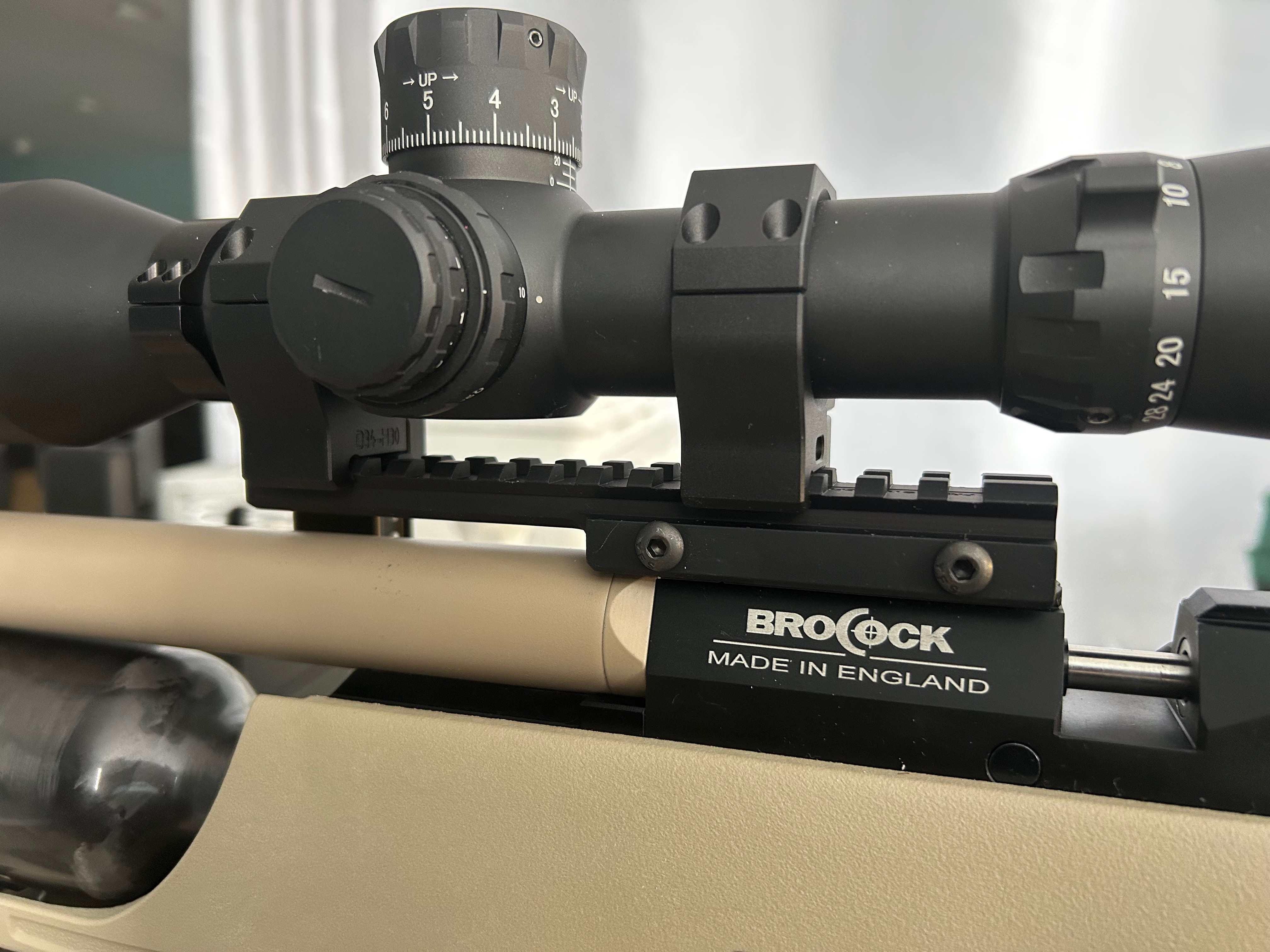

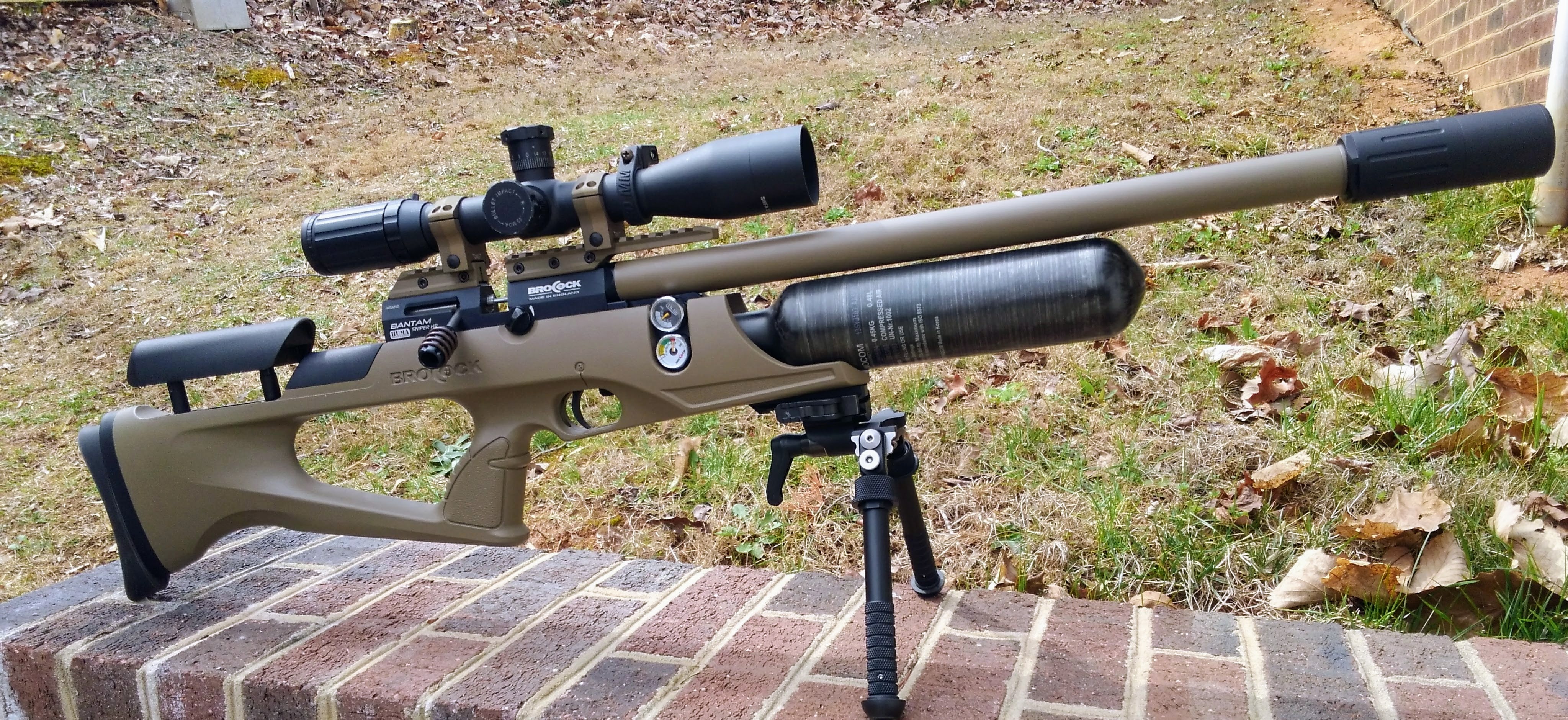

No worries - all advice is appreciated. I wouldn't ask if I wasn't sure on this platform. The problem, as you can see in pic, is with the Sniper it's a bit of a hybrid between a standard rifle and a bullpup. If I remove the pic rails - which was one of the thoughts - then I have nowhere to mount the front ring.
The rings are pretty low as is - forgot to mention this is a 34mm scope so rings are more limited. I think the ideal solution would be replacing the BRK dovetail to pic rail with one having 20 moa.

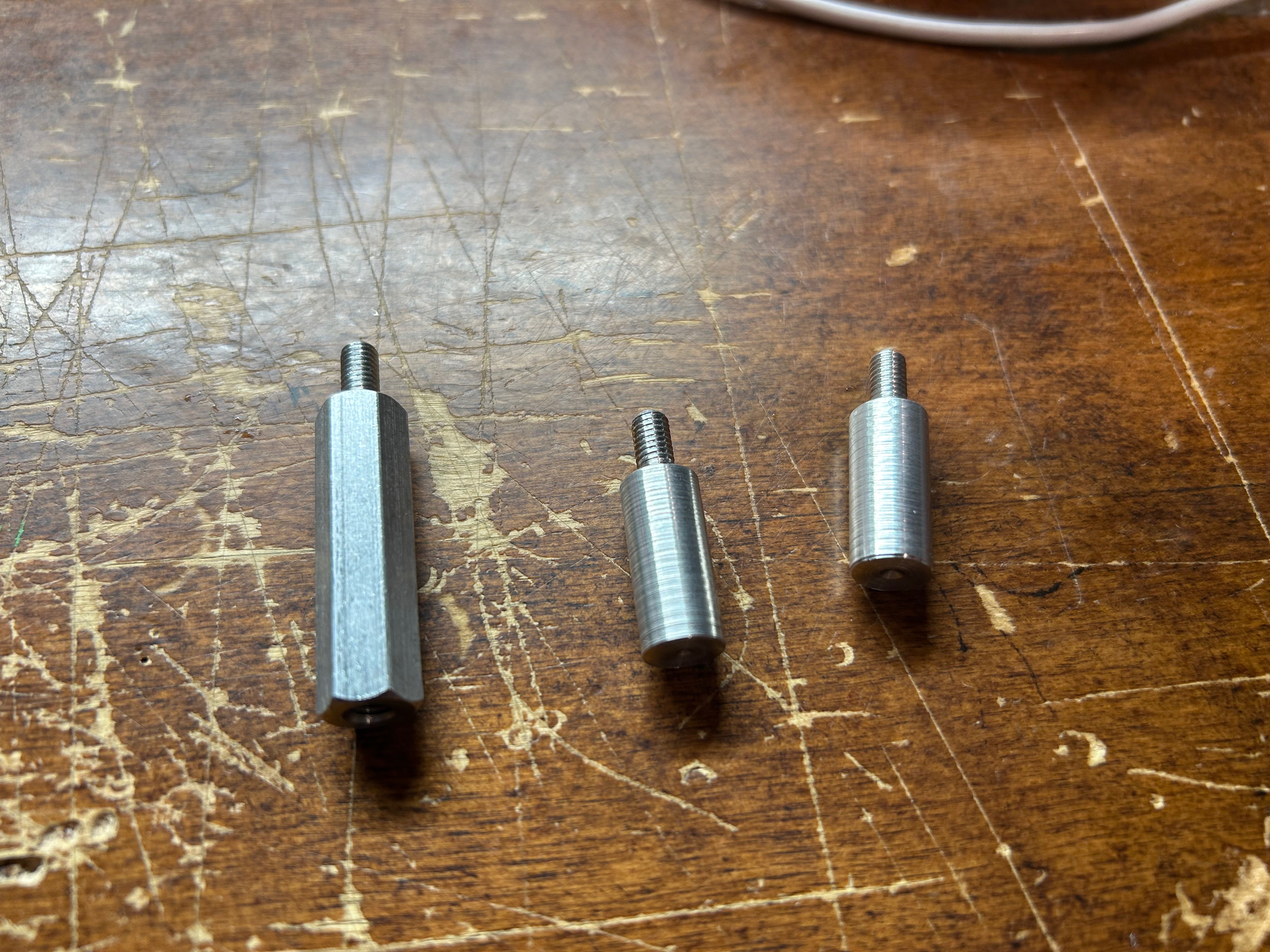

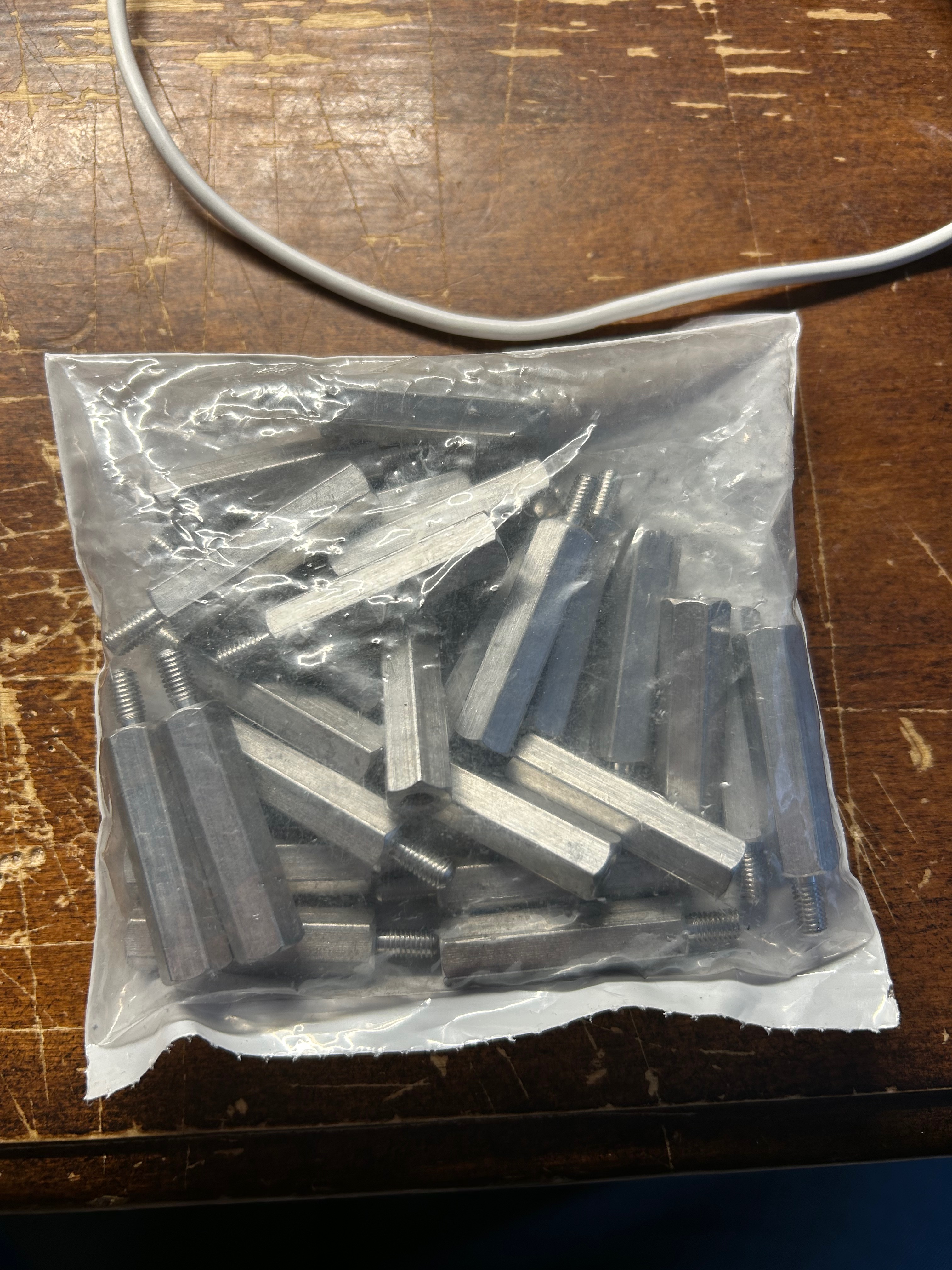

For this post I am focusing on the cheek riser. After some of the links from above posts it got my brain spinning and the electrical engineer in me remembered the standoffs that we used to use to separate circuit board layers.

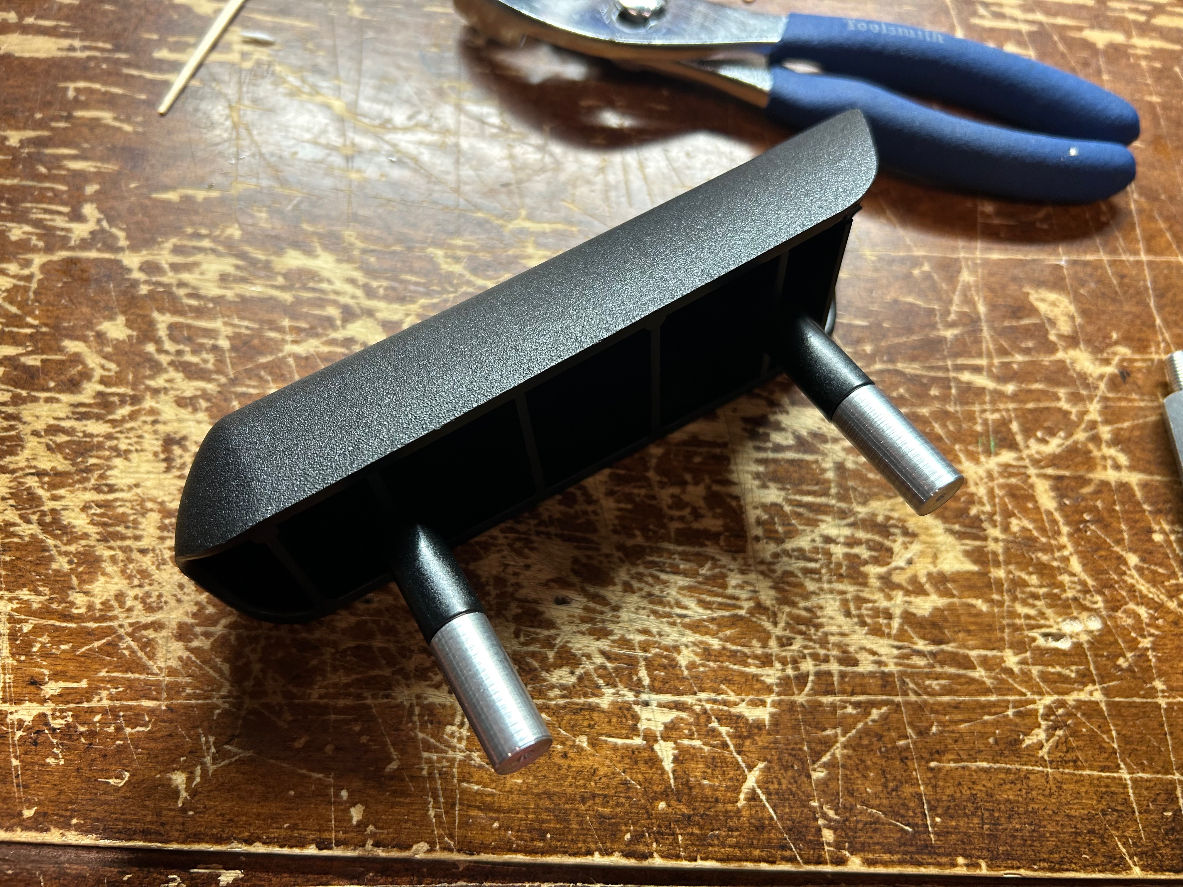

I measured the plastic posts on the cheek riser and they measured 3/16" ID and 3/8" OD. Come on - too easy. A little time on Amazon and I have an order for these. It's like they were made for the BRK - the 10-32 threads are a perfect 3/16" and if you take your time cut a nice set of clean threads in the riser.
Note: These are specifically the Al ones as the steel would've been much harder to turn.
I took the standoffs and mounted them in the mini lathe. Took the OD down to approx 0.375" (3/8"). Took the length to approx 0.875" (7/8"). Not bad for a non-mechanically inclined person.

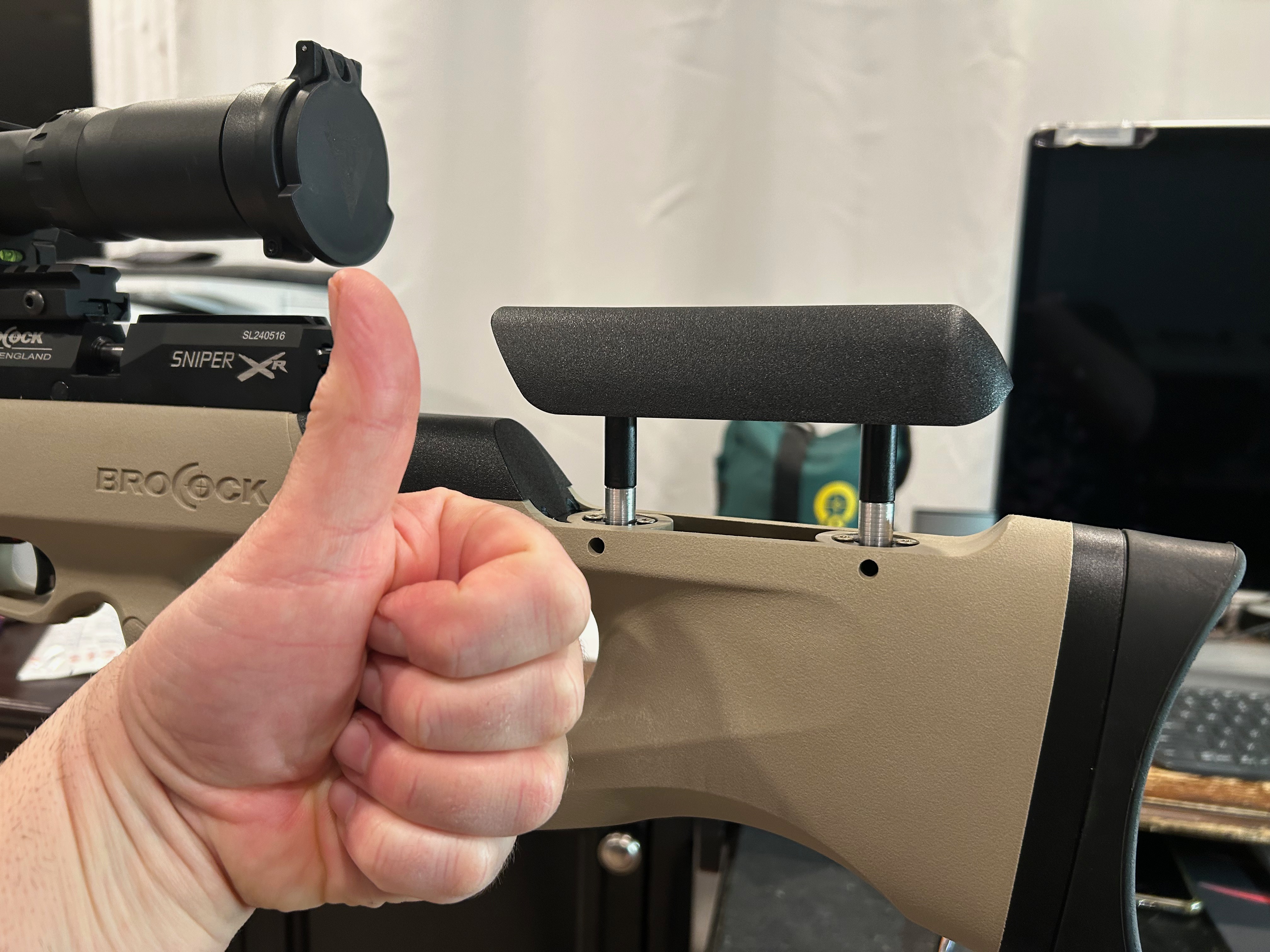

Installed on the cheek riser and rifle.

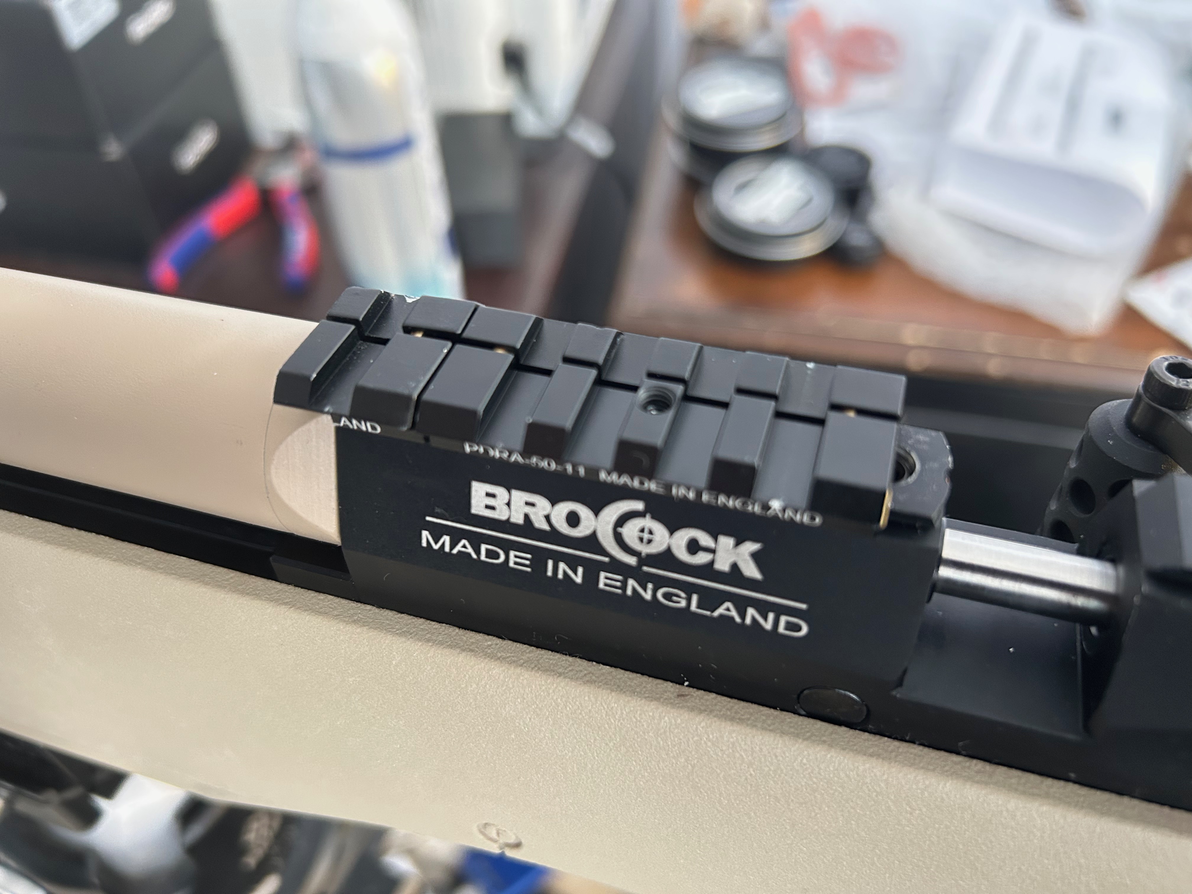

All the parts came in to complete the scope elevation fix. It's not a huge difference at ~6 Mil but it gets me that much further away from the max scope elevation settings. I now have a good 10-11 Mil of elevation with a 50 yard zero, whereas I had about 4 or so Mil before.
Here's what I used:
Eagle Vision 50mm dovetail to pic adapters: https://utahairguns.com/product/eaglevision-dovetail-to-picatinny-adaptors/
PRI AR15/M16 Riser Rail w/ 20MOA: https://www.precisionreflex.com/rail-risers/347-pri-ar15-m16-top-rail-riser-2-hole-with-20-moa.html
Some dremel work is needed to trim one of the 50mm adapters down to fit.

Final mounted rail.
