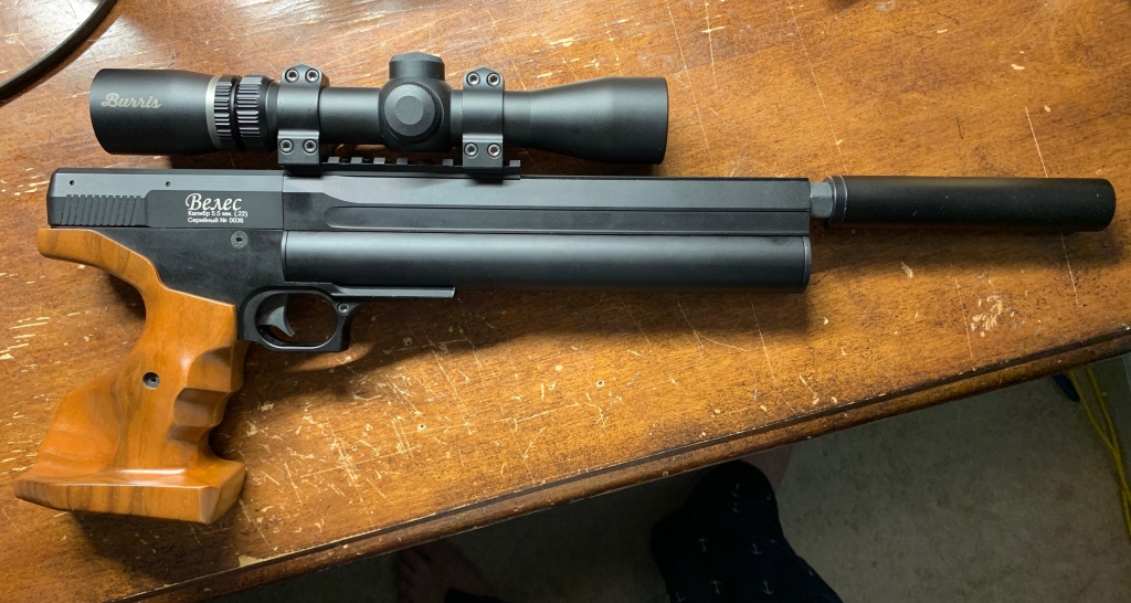

I purchased a used EdGun Veles in late 2019. I've fallen in love with the pistol. The Veles is simplicity in engineering: decent single stage trigger mated to a 1911 style hammer/spring setup (although all hidden inside the frame), hammer hits valve, air pushes pellet. The loading mechanism is the whole top back of the block. Without the scope this pistol is so lightweight it's nuts - maybe 2 lbs.
Man this pistol shoots so smoothly and pushing 20 fpe the recoil is this beautiful soft push back into your palm. It warranted spending the cash for a Burris 2-7 handgun scope.

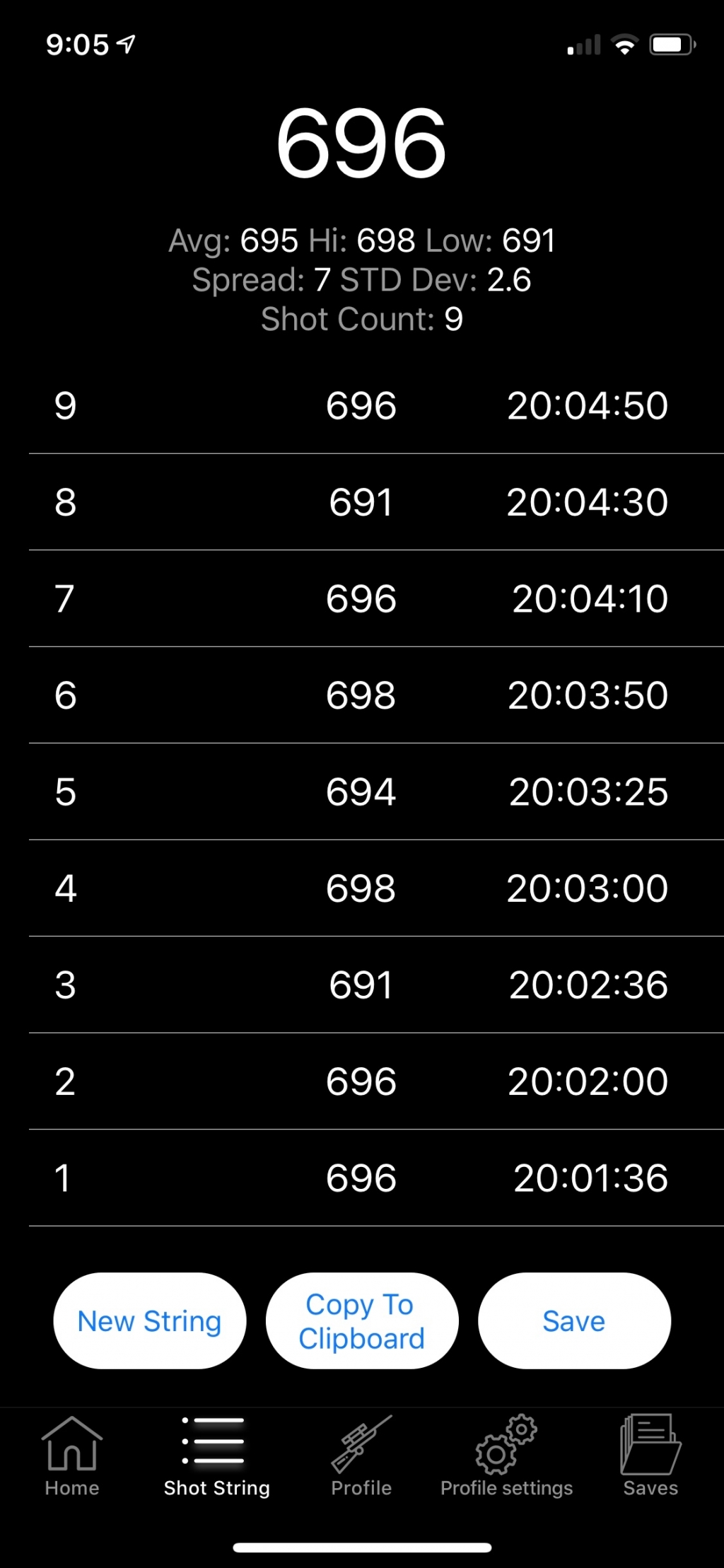

Now reg is in place and confirmed with a Huma tester at 130bar. I have the hammer spring set for ~700fps with JSB 16gr. This is the shot string I recorded after getting the hammer spring setting finished. Went from 20 shots per fill to ~35 on reg.
