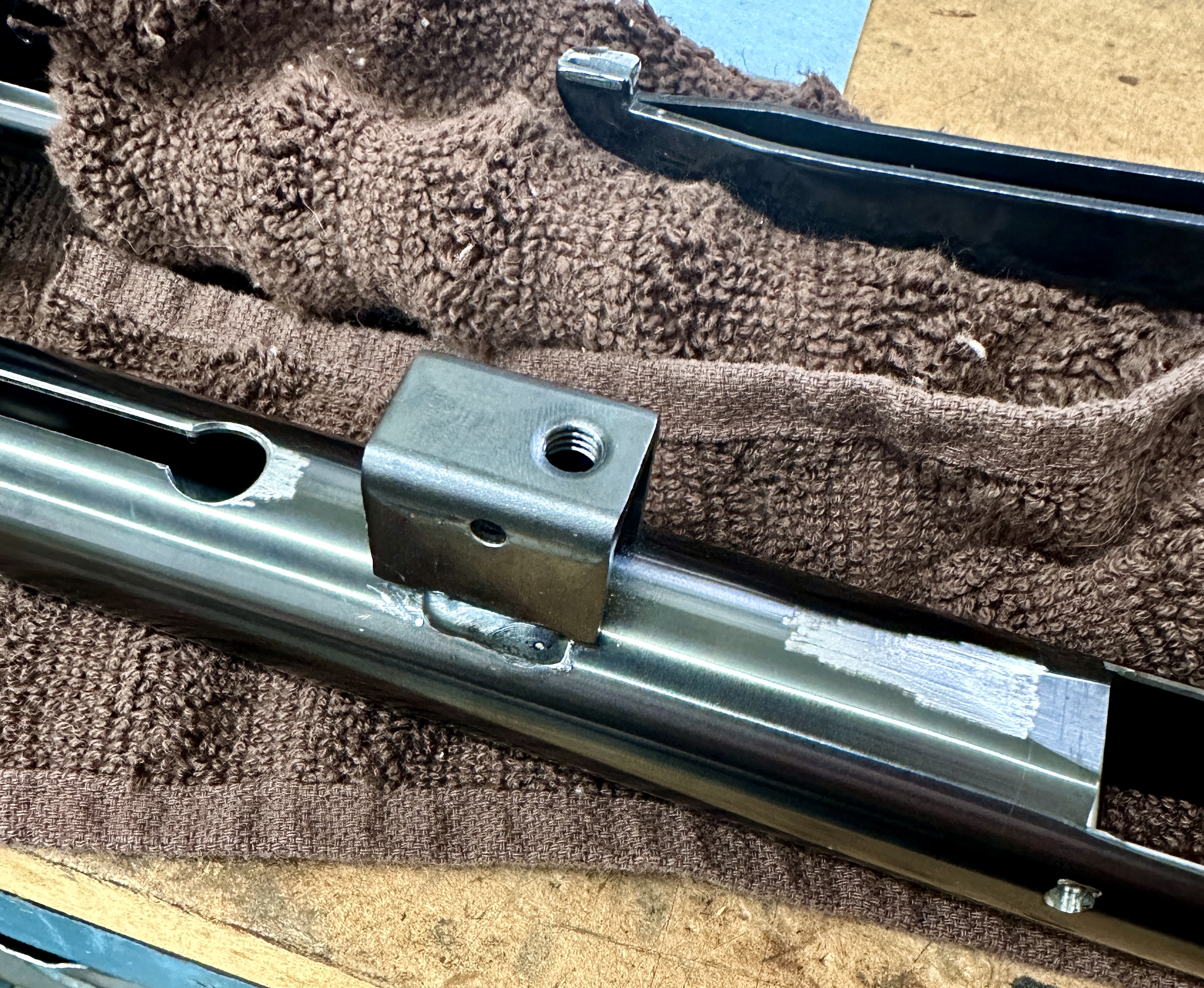

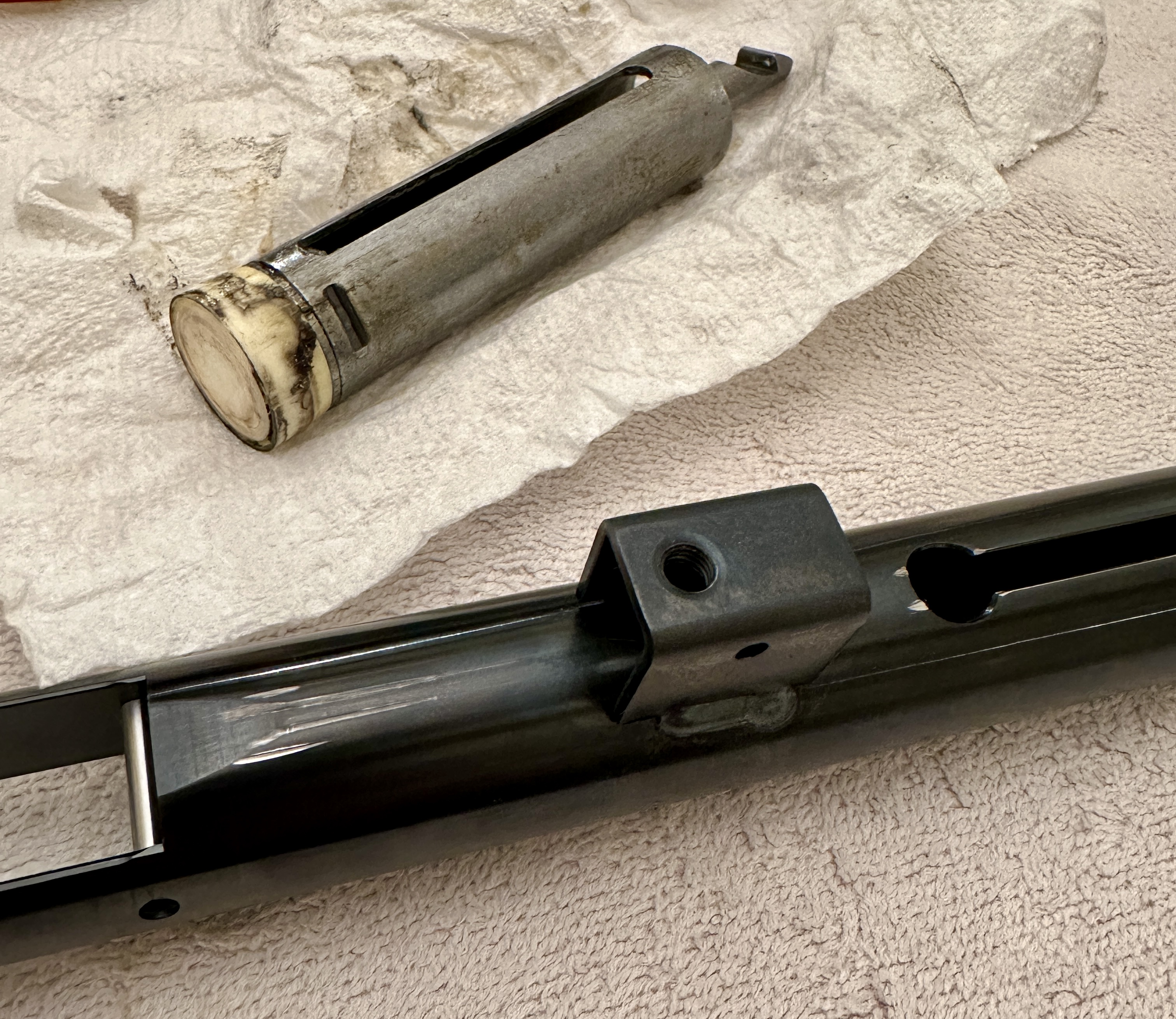

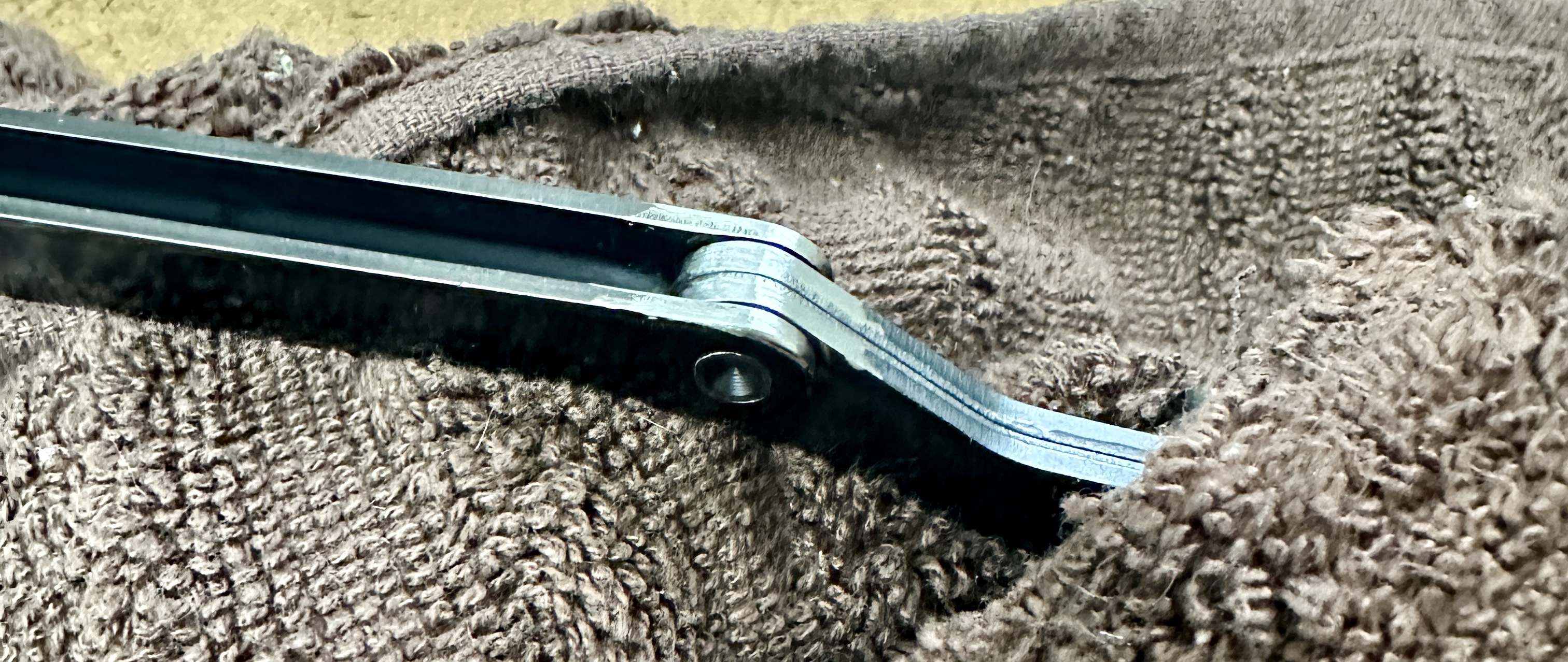

It already has wear marks on the receiver tube from the cocking linkage.
So I deburred the linkage and tube with a needle file and polished them with a cratex bit in my dremel.

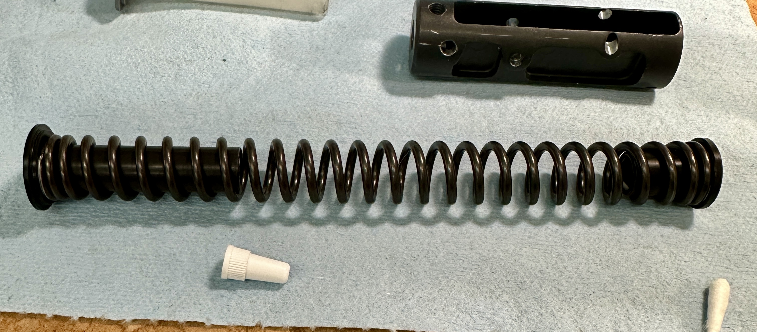

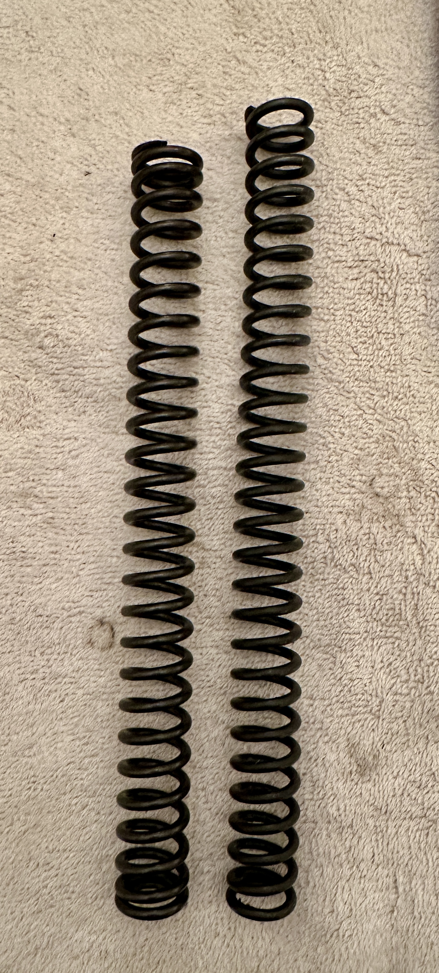

I reblued the receiver (not shown here). Deburred all the receiver cut outs and holes. The factory spring guides are sloppy loose and the spring was kinky, so I ordered 2 new JM HW30/R7 springs, they are shorter by about .600" and use a thicker wire, .113" - 27 coil vs the .106" - 29 coil factory spring. Then I made new guides for a snug fit.
After consulting with Ed Canoles about his break barrel oring piston sealing process, I decided to follow his play book and try to oring seal this HW30. After making a gage with a couple of interchangeable heads, with different diameters.
I then checked the receiver tube to find a tight restriction where the hanger is welded on. With this, I made a hone, similar to Ed's out of PVC pipe. After honing 95% of the restriction out, I made a test piston head to attach to my gage handle and checked to see if it would seal, and it did. pushing or pulling it held tight. The factory seal didn't hold as well when tested.

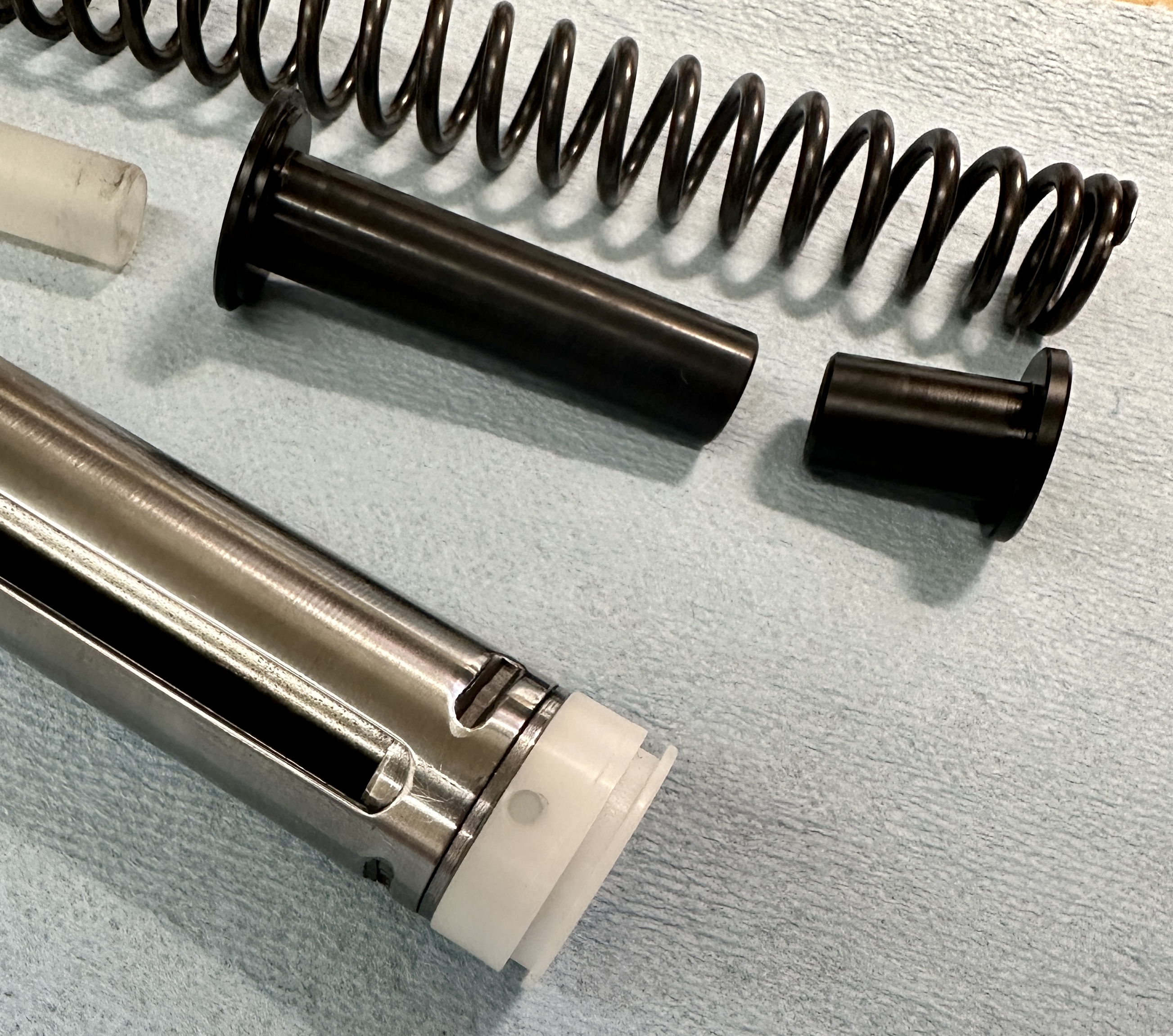

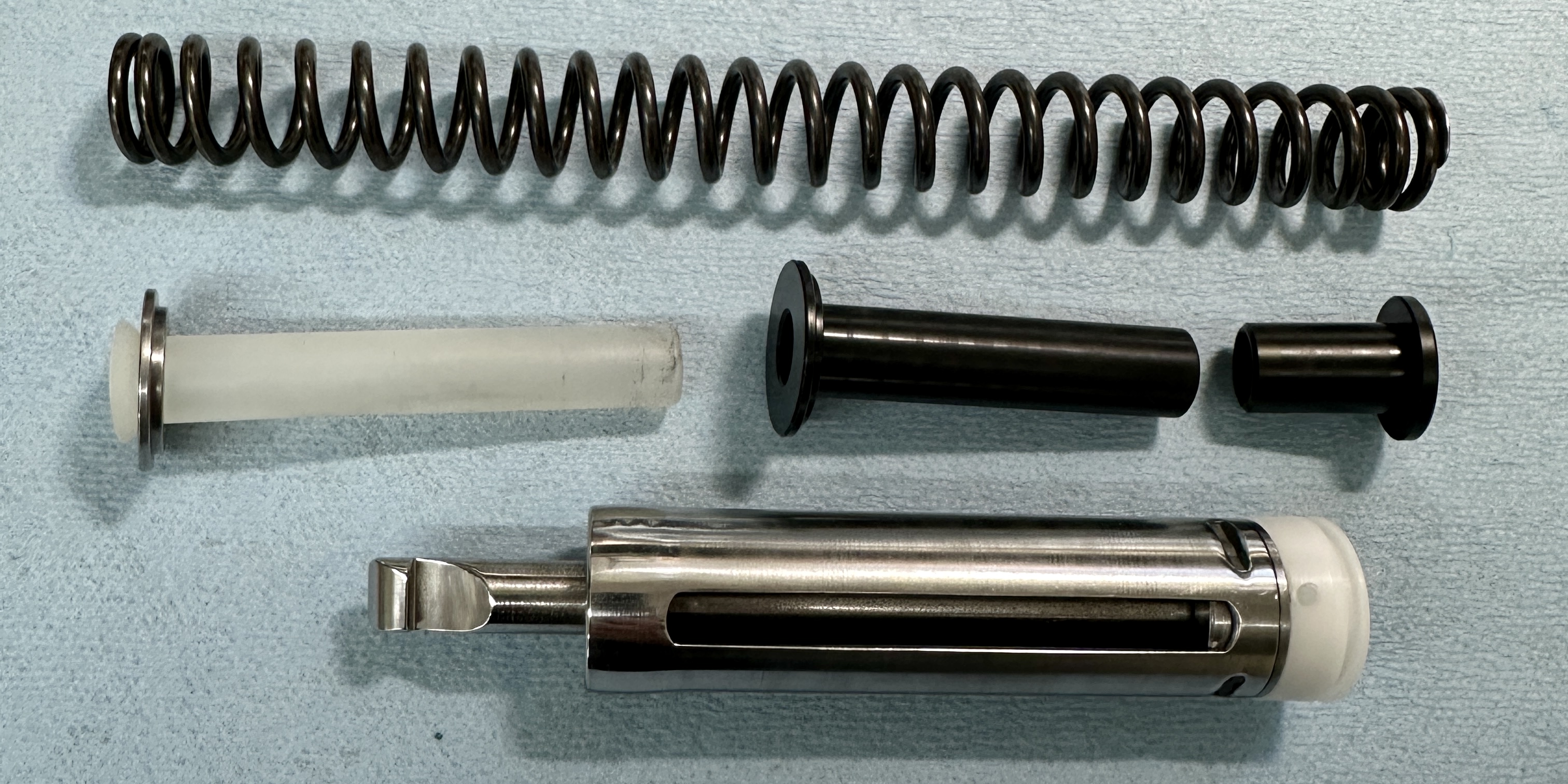

With this, I went ahead and made the real oring piston seal, polished the piston and checked for latch rod run out. Factory guide beside my guides.
Lubed everything with Krytox 223, don't have time to go thru the trigger, cleaned it and adjusted. Here's the JM spring on the left vs the HW on the right.

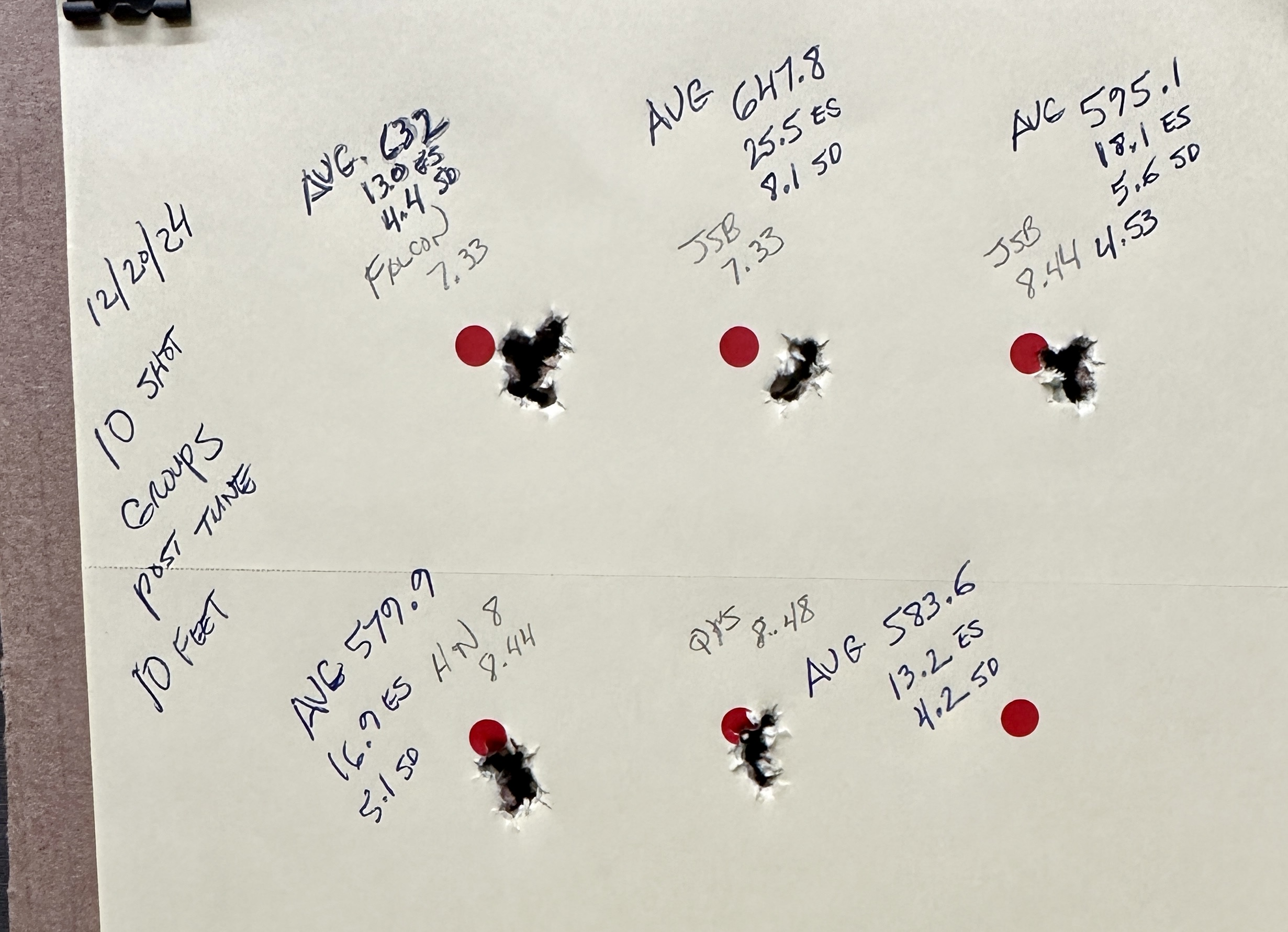

Tonight I tested five different pellets at 10' over the Garmin Xero in my garage, I'll retest at a longer distance tomorrow. Anyway, I gained 51 fps with the falcon 7.33 and 36 fps with the JSB 7.33 which are a looser fit. Not much gain with the 8.44 pellets 11 fps, but a gain none the less.
The H&N baracuda 8 was the tightest fitting of the five I tested. I don't have time for anymore testing, but I will when I go thru my own HW30 later on.
Will have to see how it settles in after they shoot it a bit. Right now only about a hundred pellets thru it. I'm calling my effort a success with the 7.33's.✌🏻
The jointed linkage in the 2pc cocking lever on the 30,35,50 is the chink in the armor of these models. The only way I have not had a galling issue with one is after installing a Vortek PG3 tune kit with the nylon liner. Keeping the spring contained and not putting pressure on the piston wall. Everything starts going wrong when pressure from the spring starts turning the piston. Eventually binding the cocking lever joint. The galling is always off center and chewing the one side of the receiver slot.
Reactions: bustachip
Thanks, I will keep an eye on that. Not enough shots on them yet, slots are good.
Nice job there. The compression tube's are always deformed where the hangers are welded. Its just a matter in which manner and how much. Welding to any thin steel tube deforms it.
You would think they would hone it out, but I guess it doesn't matter with the rubber parachute seal. This is the first break barrel I've ever worked on, so I'm learning as I go.🤔
Reactions: crowski
Most of the ones I've seen leave a depression at the weld. Straight hones leave shadows where the cylinder hone skips over. it's not a terrible issue because air pressures expands the umbrella seals lip into the depression. A tight spot is a bigger issue. At least tight spots can be honed. There's nothing easy you can do with the depressions. If the depression is slight enough you could hog out the tube straight. It's slight enough that an umbrella seal will work fine.
Normal umbrella piston seals are pretty forgiving of tube irregularities. Square and oring piston seals are not. The need a straight round bore
