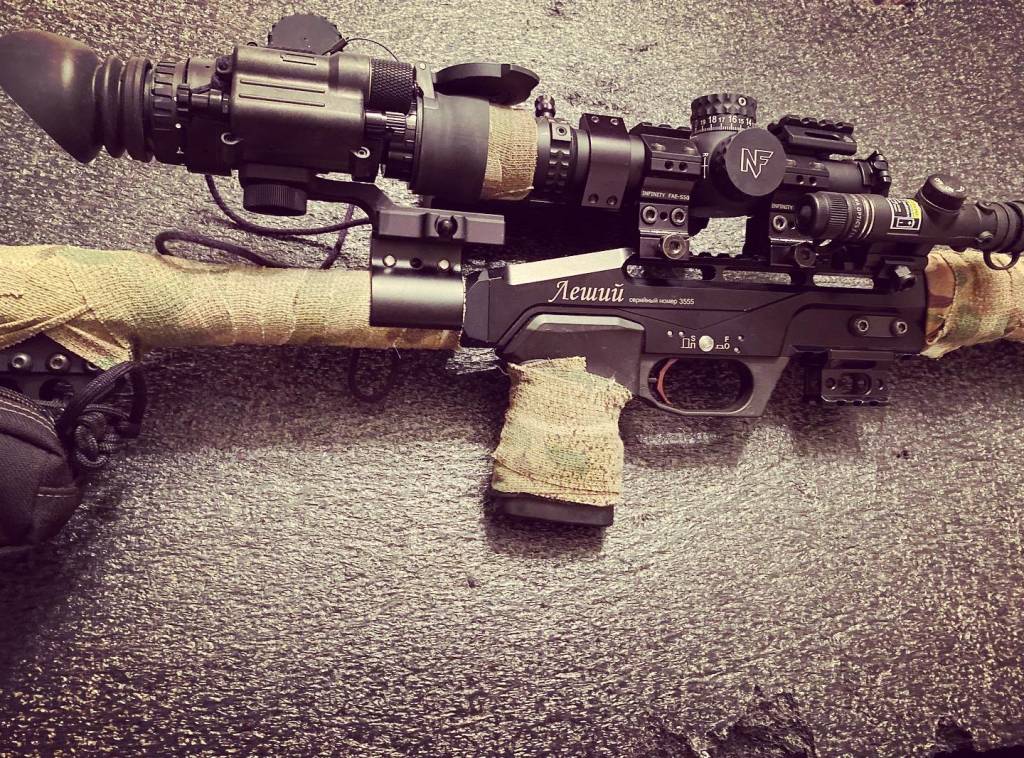

Some Leshiy Classic Love - Share Some Pics of Yours
Love mine. No real interest in the Leshiy 2. The Leshiy 2 just seems to throw out the simplicity that makes the original so special.
I have wondered about that. I, too, am in love with the simple excellence of the Leshiy, but I'm still anxiously awaiting the '2. Will I like it? I'm sure I will. Will I love it as much as Leshiy 1? That remains to be seen. L1 is so elegant that it will be hard to match, but L2 may be as elegant in the world of repeaters. Can't wait to find out!
GsT

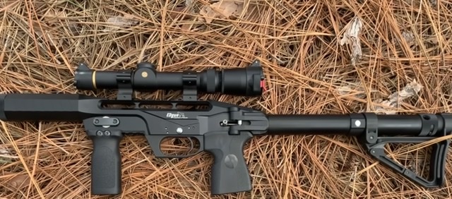

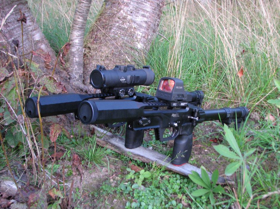

My two babies, nothing fancy, like to keep them light
Front, .22 cal, Edgun reg. at 130 Bar, HST 25, JSB Exact 1.03 gram at 260 m/sec
Holosun HS510C Circle Dot Open Reflex Sight
Weight total 1679 gram
Back, .177 cal, Edgun reg. at 130 Bar, HST 15, JSB Exact 0,547 gram at 295 m/sec
Dedal Stalker with flip-ups
Weight total 1903 gram

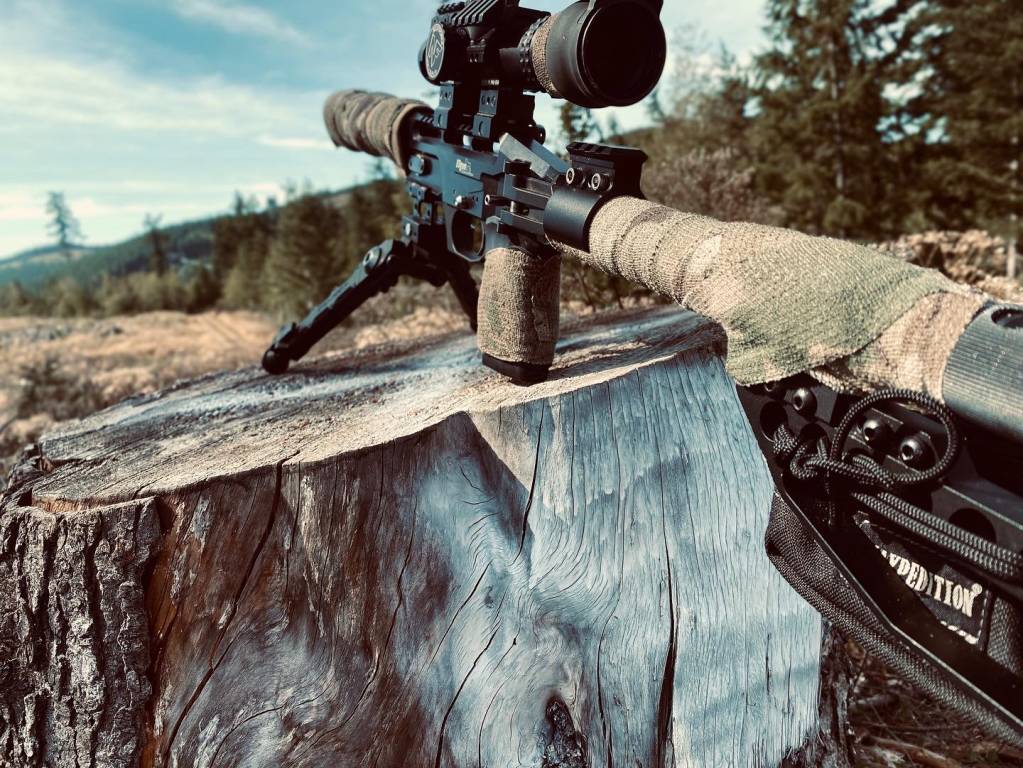

Beautiful!, clean and tactical. Nice grips
The original had a critter sleeping with its friend, hehe. I like to Keep It Simple Sam! I love this gun; the cool factor is too much. Simple, accurate, and packable without complexity. I upgraded from my old Sheridan Blue Streak with the bluing rubbed from pumping it for 55 years to a Leishy. I couldn’t be happier. Some day I will add a L2 when all of the waiting nonsense is over.

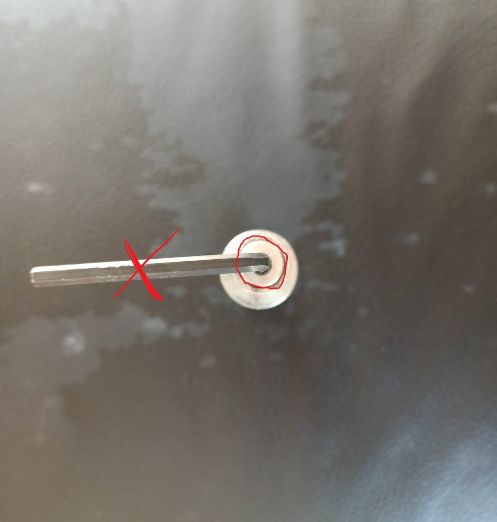

I tested Still about the same, Can tell me your spring How much to adjust?In addition,
If the picture below is stuck and cannot be turned, it will cause the regulator
Does it affect?In the red circle

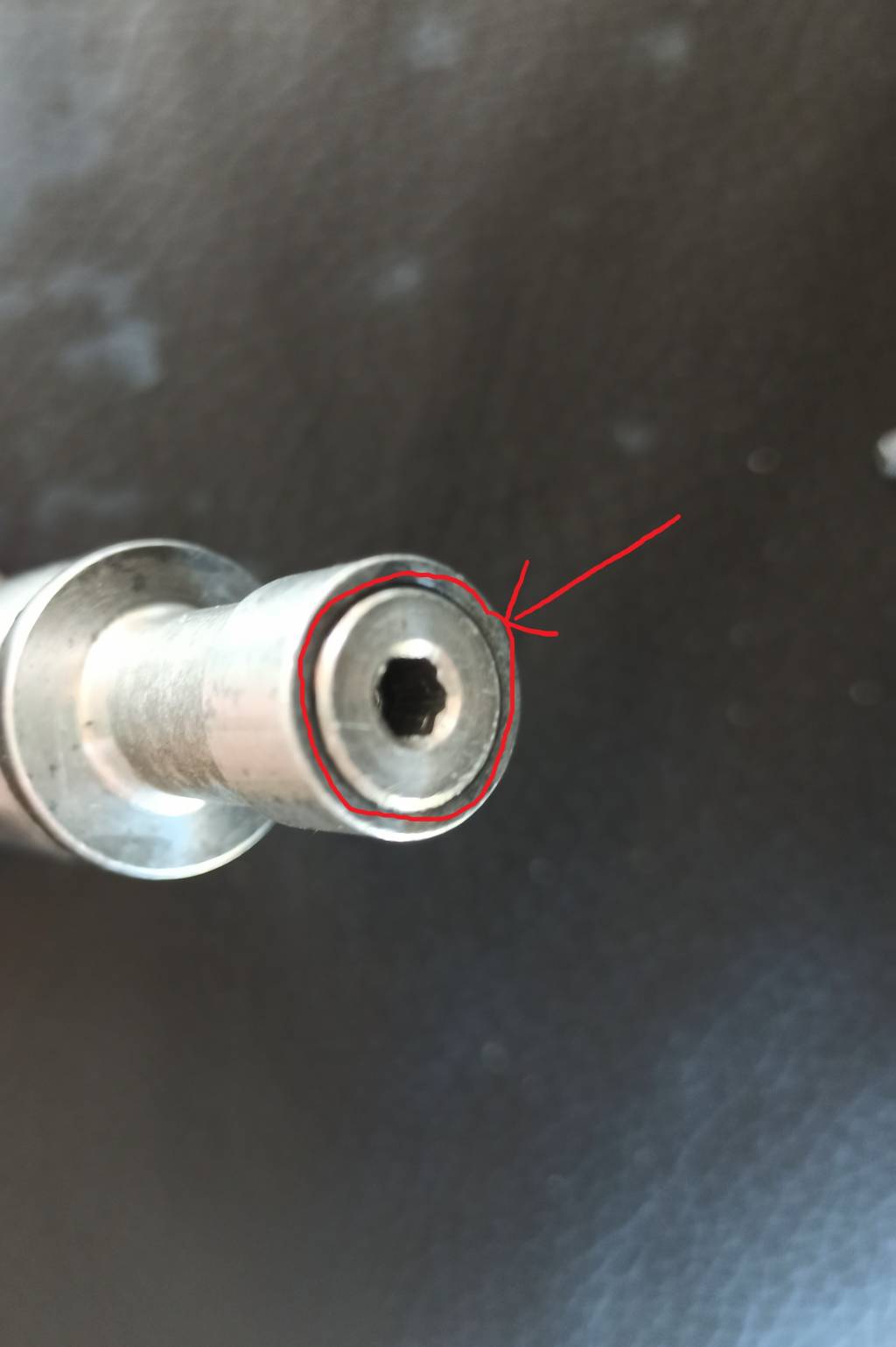

Understand, i know
It is stuck and can hardly rotate left and right. Its thread is broken and must be rotated with brute force. It is difficult to rotate,only fine adjustment,I want to know if this will affect the regulator?Will it affect the venting?
Which are you saying is broken - the Hammer Spring setting screw or the regulator screw? I would contact Brian at EdGun West and see if he can help you get things back to stock setting on the reg and fix any issues with the hammer spring.
The top adjuster screw, thank you
