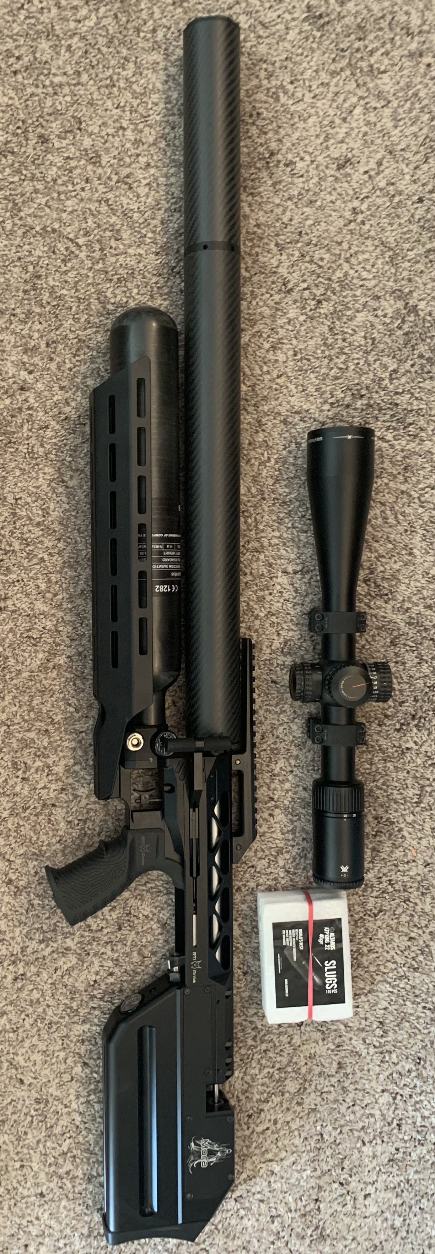

It’s going to be a slow roll. The first impressions are that it’s heavy but stupidly quiet shooting the Altaros Kings at 900fps for 72fpe. Maybe I’ll get a chance to sight it in tonight. Absolutely crazy quiet and plenty backyard friendly, if 72fpe is your backyard thing (not me). Did I say quiet? It’s absurdly quiet, 🤫, in case you missed that…

What a beauty!
40 grain slugs, 72 FPE, quiet, and backyard friendly are not something I hear often in the same sentence!
Looking forward to more of your impressions and accuracy feedback!

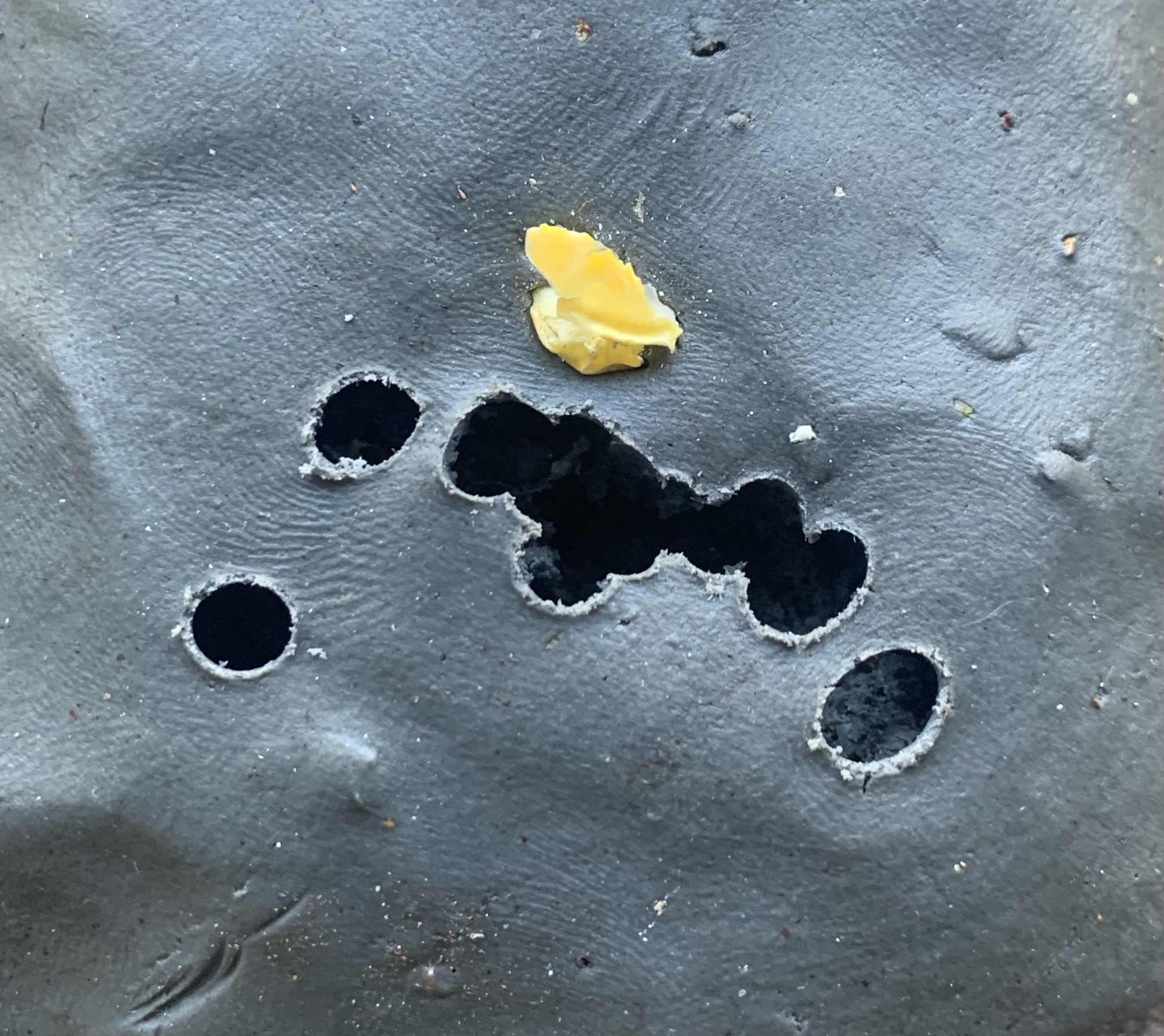

Some 85y shots (12) including the first shot after sitting for 24h with 200bar in the tank. This followed zeroing at 40y and slightly underestimating the holdover.
I felt some lateral shift on a few of these and need to find a bigger front bag to secure the wide front rail. So, I think this can be a lot better with the support figured out. But, it shows great potential and no obvious creep or stiction on the first shot. Still can’t believe that it’s delivering 72fpe with just a clicking sound.

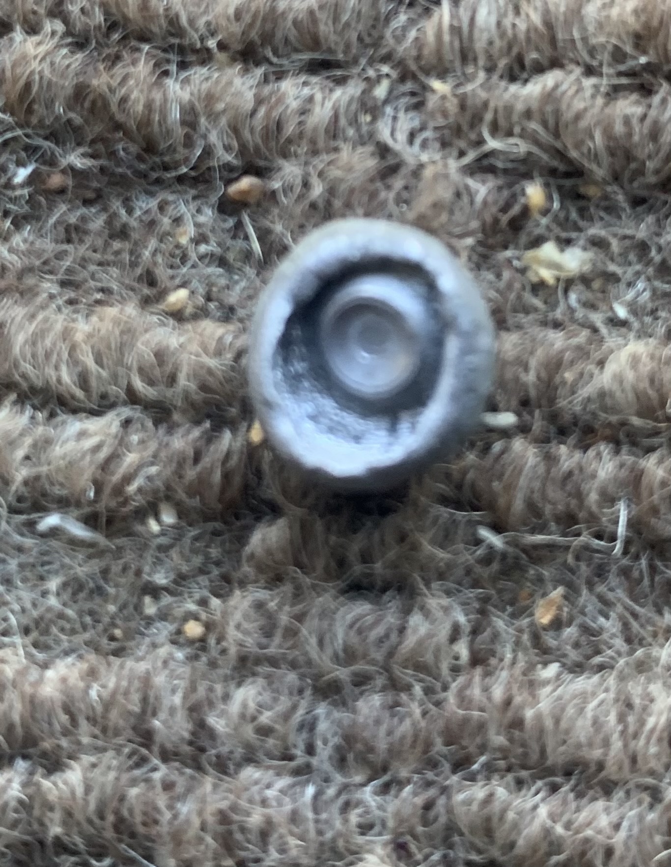

One of the recovered slugs, fully expanded:
