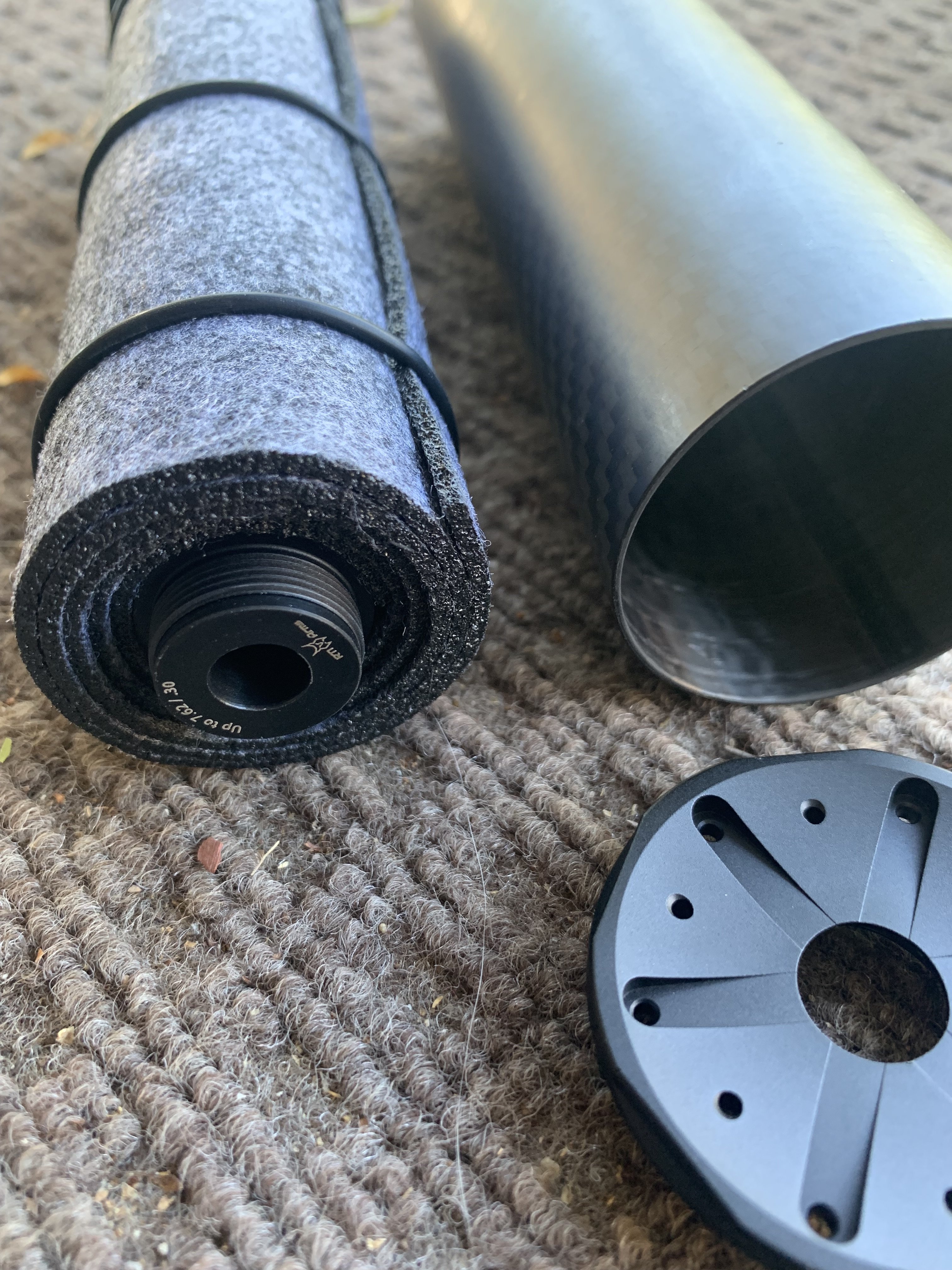

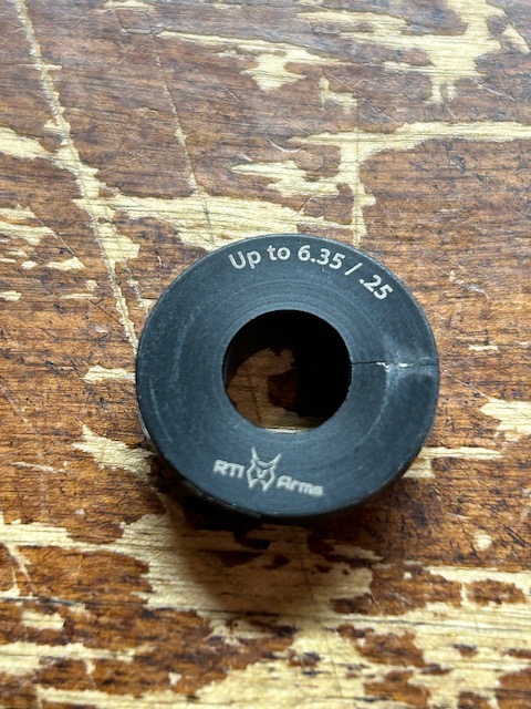

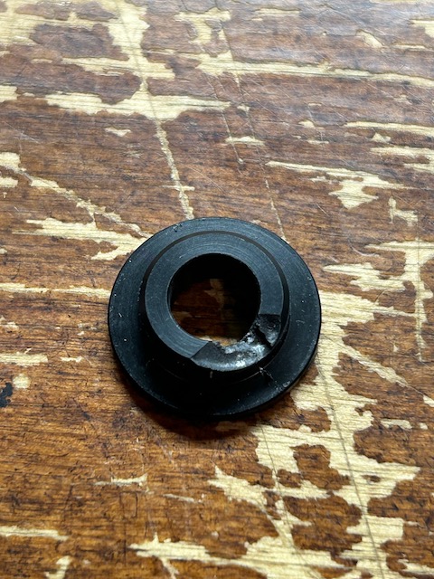

Can you maybe post a pic of where/how your's is installed? I went to install the .25 at the front of the additional moderator and first two shots just about shattered it into pieces. Some pics are in Tony's Mora thread.
I could be wrong but I think jaxjax was referring to the bushing at the proximal end of the shroud that can be removed to allow the barrel to be fully free-floating. Your’re talking about the washer at the distal end of the moderator. I’ll post a pic later but interestingly, my .22 came with the .30 collar installed and I didn’t see any others in the case. I thought about asking where the others are but since the gun is so quiet, why bother…

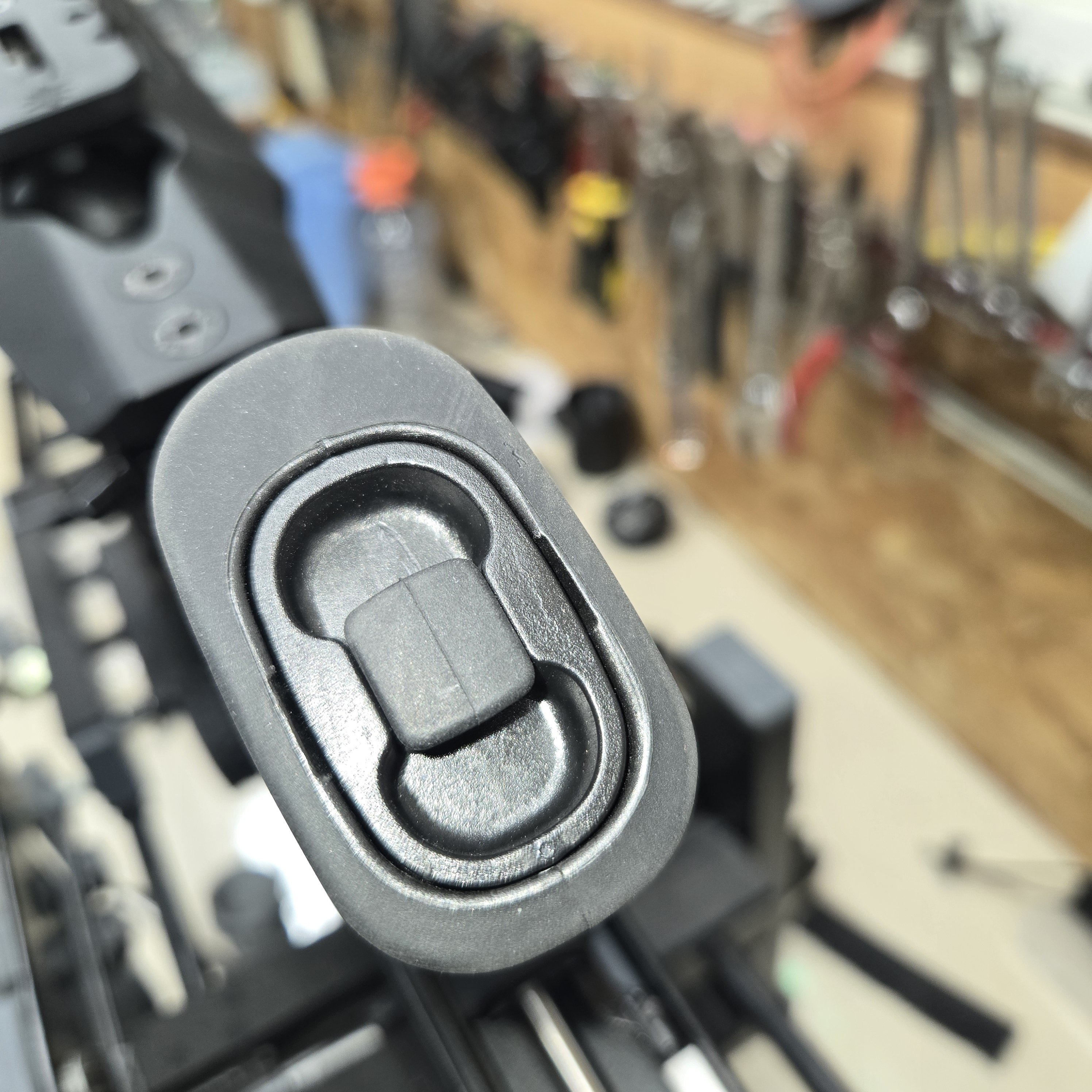

I found a nice touch RTI did with the Mora. I'm not sure if anyone else has found it out yet. There is a place inside the pistol grip to store extra ammo.
View attachment 498904View attachment 498905View attachment 498906
The bottom pic is it with 6 .357 slugs in it.

Yeah, it surely clipped but even a minor clip at 100+fpe would cause much damage. As I mentioned my shroud was loose on arrival and it is now very tight, as is the moderator. I keep checking that it isn’t working loose from the pressure during shooting.
Also, perhaps it’s no coincidence that my 22 came with only the washer for 30. Perhaps RTI sent out a memo to dealers.
For extra insurance, you could drill the 30 out a little.
Lastly, as you mention, there’s a chance that you have some poor machining/alignment in the system or even that your projectiles are clipping earlier in the system of baffles and deflecting into that plastic collar. It seems like it would be pertinent to inspect the baffle unit in the moderator for any signs of contact!
