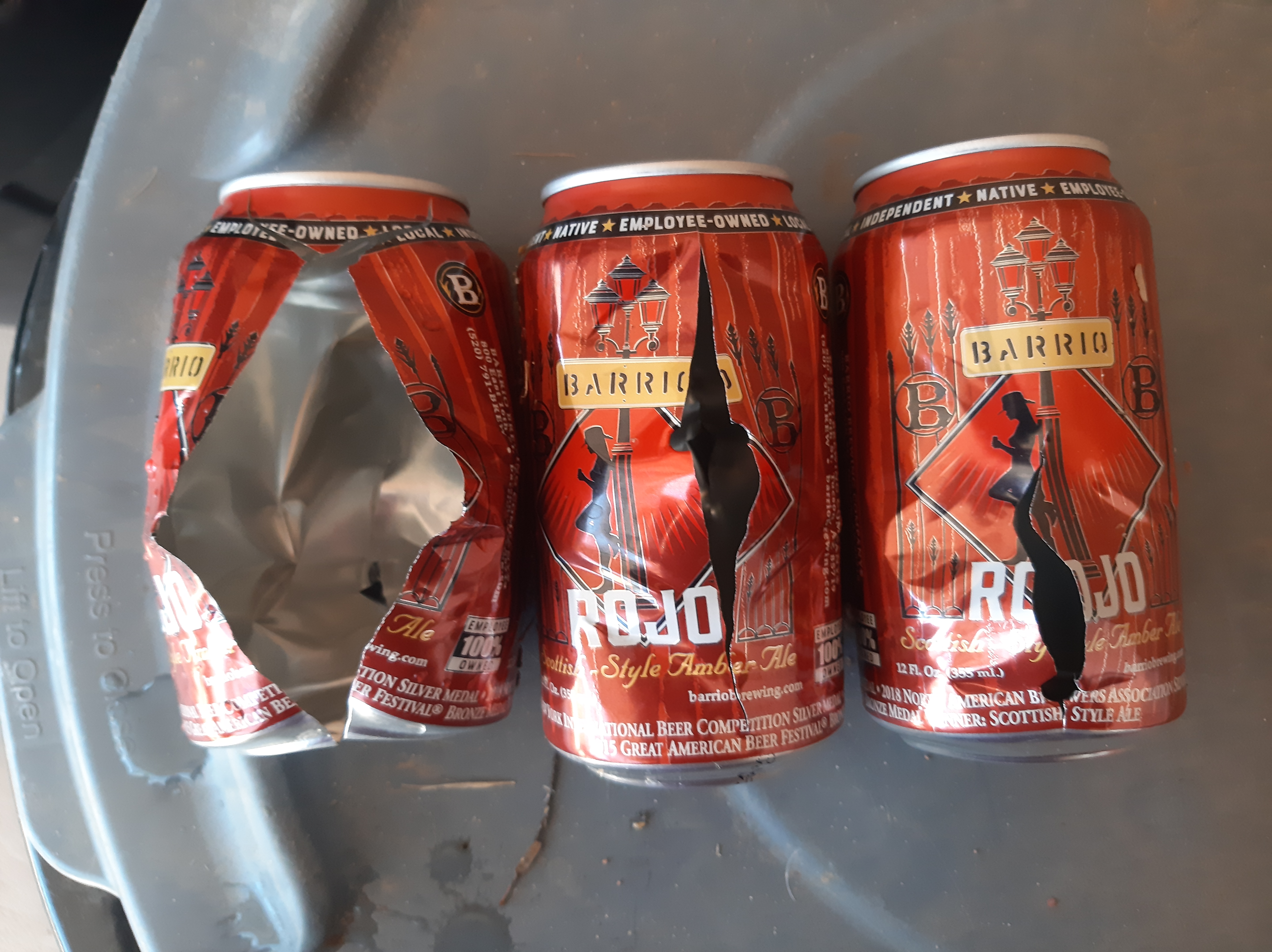

Here is an example of the expansion of the Zans. Three cans, Disclaimer " No beer wasted during testing"! 😁 All cans filled with water. Shot from my Rti Prophet 2 at 50 yards. All shot within 20 fps of each other around 980fps. Zan 16gr, H&N 16gr and NSA 15gr. I bet you can guess which one the Zan is!!! The damage they do and the sound they make when the hit always bring a smile to my face.

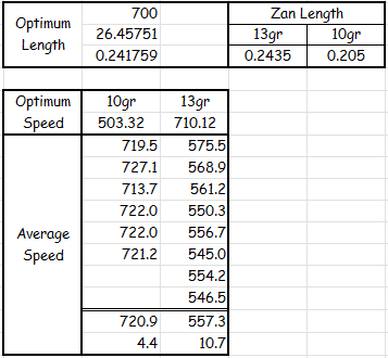

So you folks had me curious. I am home with bronchitis and so I did a quick experiment with Zan 10 grain and Zan 13 grain .177" slugs in my TX200 MK III. It has not historically shot the 13 grains well, but has done nicely with the 10 grains. It is a stock USA version rifle that has been cleaned with new breech seals. It has about 7000-10000 pellets through it.
As of today it was shooting one lot of Norma 8.4's at 858 with another lot at 836. AA 10.3 (4.52) straight from the can at 728.5 with waxed and sorted to 10.4 at 735. AA 8,4 (4.52) straight from the can with one run of 10 at 814 and another at 821 (I moved the chronograph). These are all diabolo style. Typical SD is 3.5 to 4.5 for these.
As slugs are not diabolo based stabilization the twist and speed (FPS) per caliber is foundational to stabilization. Yes, there are some other things that play a role, but this gets us in the game. The optimum projectile length for a gun with a 1 in 12 right hand twist in .177 caliber is .2418" if firing at at 700 fps. The Zan 10 grain is 0.205" and the 13 grain is 0.2435'. The minimum stabilization of a projectile that length in a 1 in 12 right hand twist barrel is 503.32 fps for the 10 grain and 710.12 with the 13 grain.
Slugs fit tighter, and in the case of my TX200, MUST be pressed firmly into the chamber to seat them properly. The 10 grains, on average, shot about 721 fps with the 13 grains being at about 557 fps. So for me I get a sense of the consistency and function of each and why the Zan 10 grain work for me but the 13 grain do not.
I use the slugs to shoot at 100 yards with the TX for giggles and because it is a challenge. The Zan 10 grain slugs are more consistent for me than the diabolo style pellets. I have a couple videos but here is one.
In the video the groups ranged from 2.31" to 4.10" (6 shots). The average was 3.29 inches. I do not see a lot of posts with 3 inch or smaller groups from springers at 100 yards so I am pretty satisfied.
