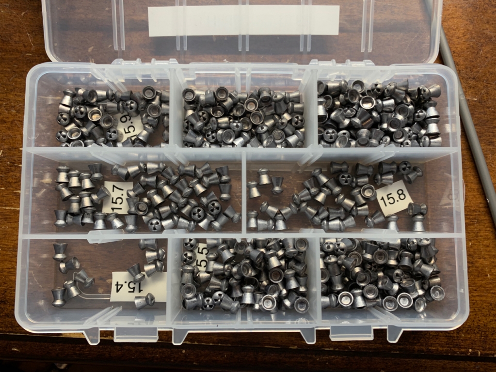

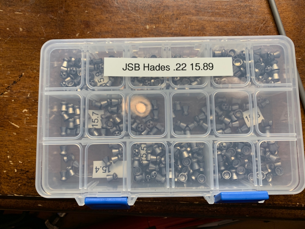

I hopped on the bandwagon and grabbed a 4 for 3 pack of the JSB Hades .22 15.89 pellets from Pyramyd. They seemed to shoot pretty nice. A few not fliers but definitely a bit off from the group shots. I found the fps to be very inconsistent with a wide spread of 30-40 fps. I decided to sort the tin and the results were surprisingly bad. I usually weigh and sort to the nearest 10th - my scale was $30 and made in China with claimed resolution to 0.02 gr - but I don't know so 0.1 gr seems enough for me.
Here's the JSB .22 Hades 15.89 sorted:
Most pellet sorting threads I've read show that a random tin of 500 pellets, when sorted, will produce some semblance of a bell curve. The Hades sorting has two humps in the curve. I tried to show the labels I didn't stick on yet. It goes from left to right starting with the bottom row, measured in grains. 15.4, 15.5, 15.6, 15.7......15.9, 16.0, 16.1. The sort produces two major weight distributions in the 15.5-15.6gr range and the 16.0-16.1 range and is kinda scarce outside of those ranges. I'm definitely glad I sorted these and I definitely recommend you guys do as well.

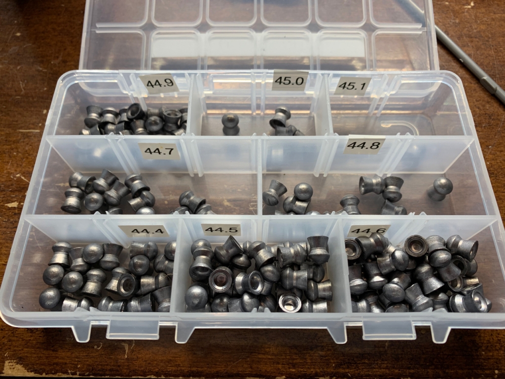

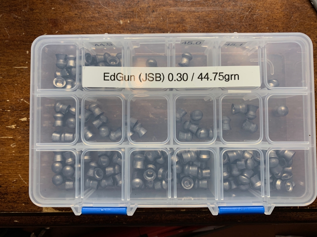

EdGun (JSB) 0.30 44.75 gr:
Very nice pellets with most in the 44.4-44.6 gr range.

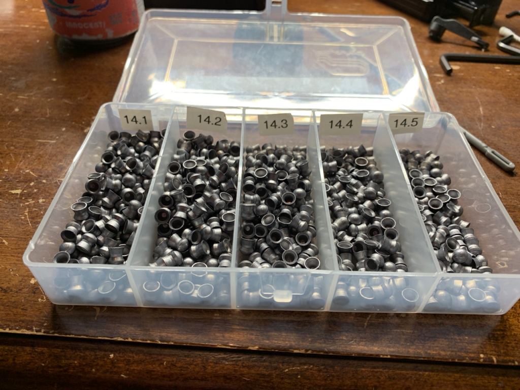

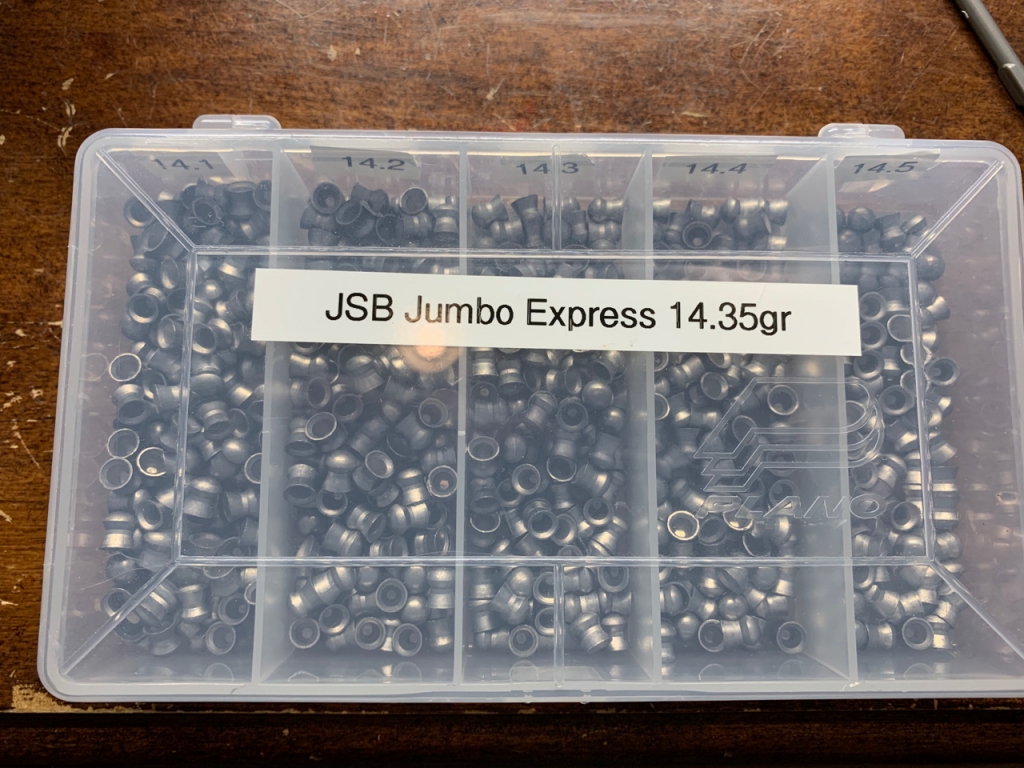

JSB Jumbo Express .22 14.35 gr:
Hard to see based on the picture but most pellets in the 14.1-14.3 range. Curve goes downhill towards 14.5. Surprisingly except for a few stragglers that got tossed in the trash, all 500 weighed in to this 14.1 - 14.59 range.
