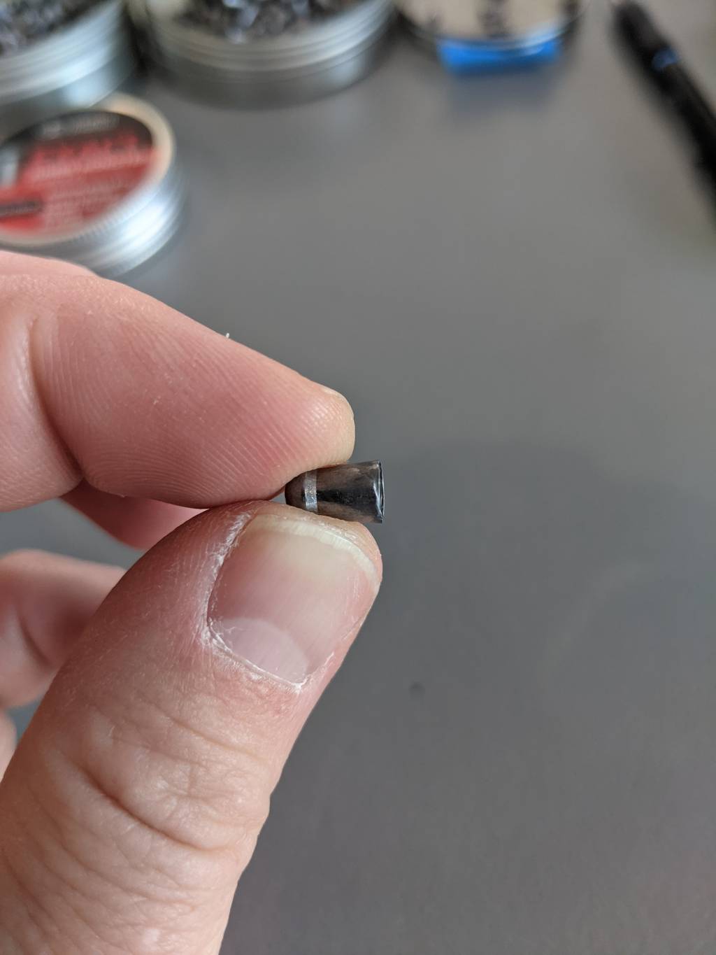

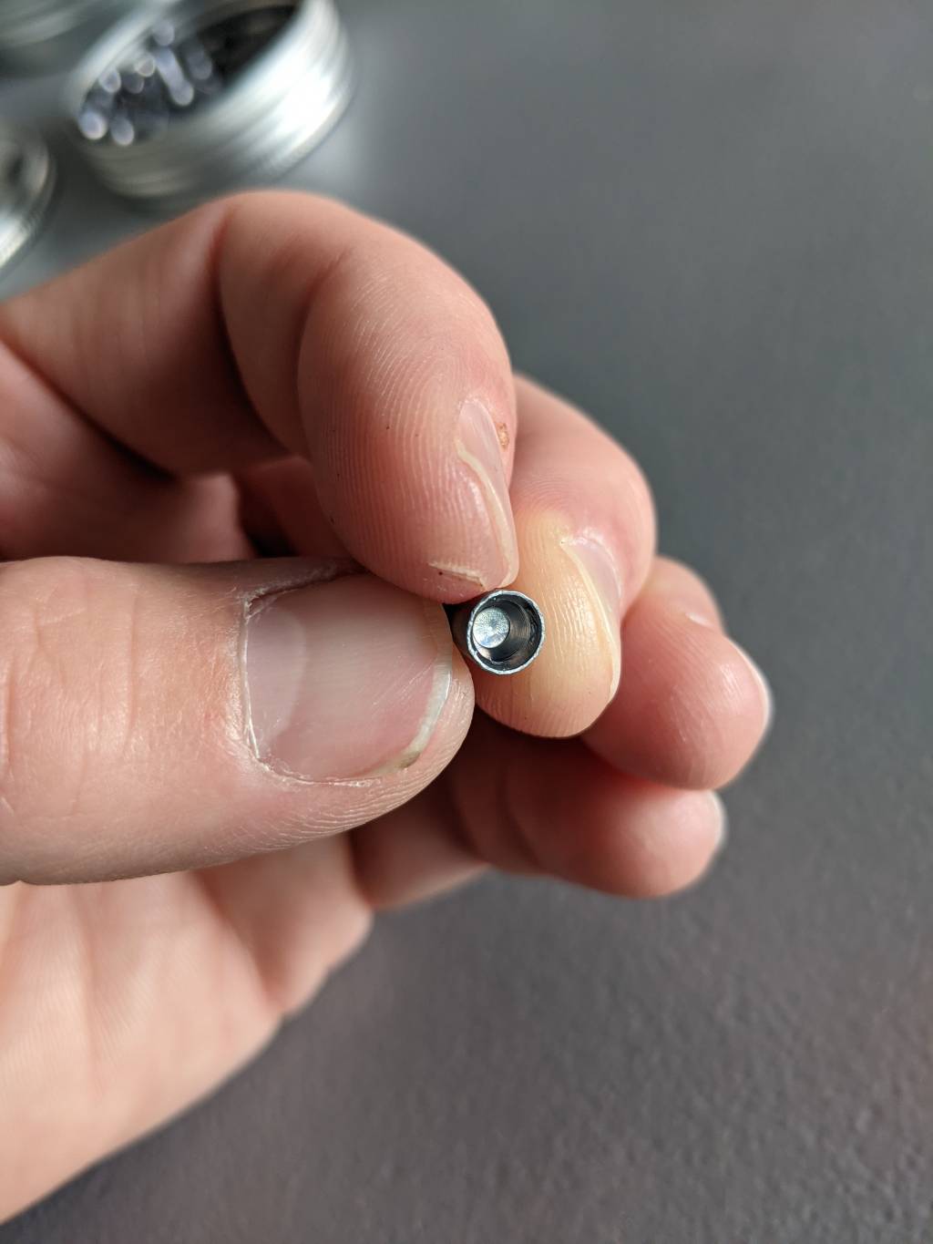

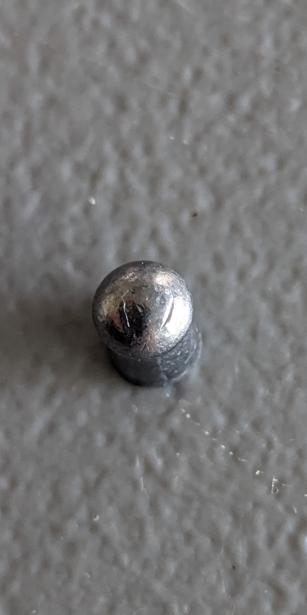

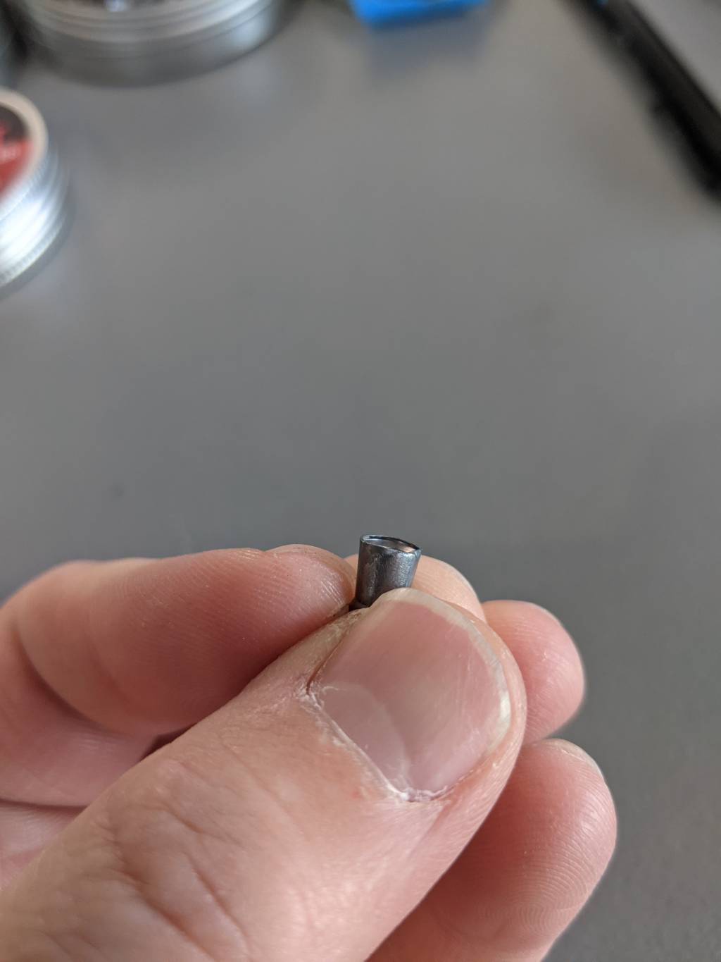

As for the peewee 24.2grainer, here's some pics of that little 💎
At first glance just a mangled skirt but closer inspection shows that it's missing lead in the skirt area (ie, weighs substantially less than it should)

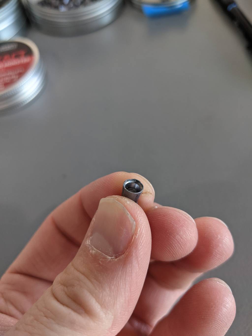

This is one of the 25.1grainers, appears to be missing lead where those divots shouldn't be.
And one of the 2, 24.7grainers seems to be missing some lead on one side of the deepest portion of the skirt. But otherwise, no visible deformities.

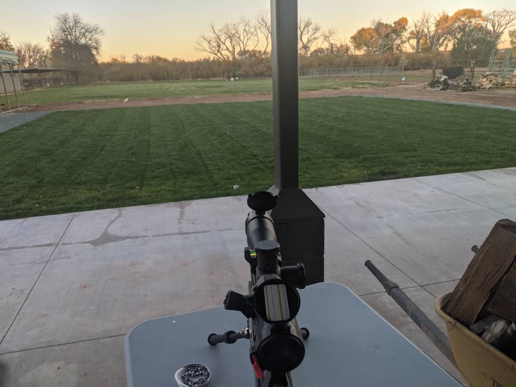

90 yards.
Minimal wind, about 0.3-0.6 mils left and right, mostly quartering in from 10 o'clock but occasionally quartering away from 5 o clock.

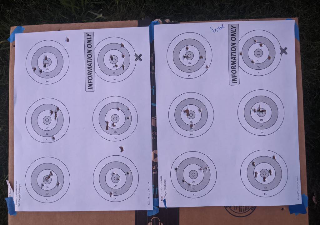

Shot 12, 5 shot groups with sorted and 12, 5 shot groups with unsorted pellets. Basically two condensed EBR "cards" using the sixth "sighter" bull also.
Shot one 5 shot group with sorted and then one five shot group with unsorted and alternated back and forth through all 24, 5 shot groups.
Sorted and unsorted pellets from the same lot# (sticker on the sleeve).
Used the pellets that weighed out as 25.4grains as the "sorted" arm of the comparison.
Both sorted and unsorted arms were lubed.

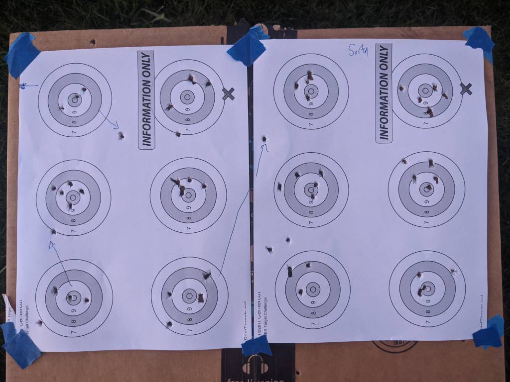

Arrows showing the flyers.

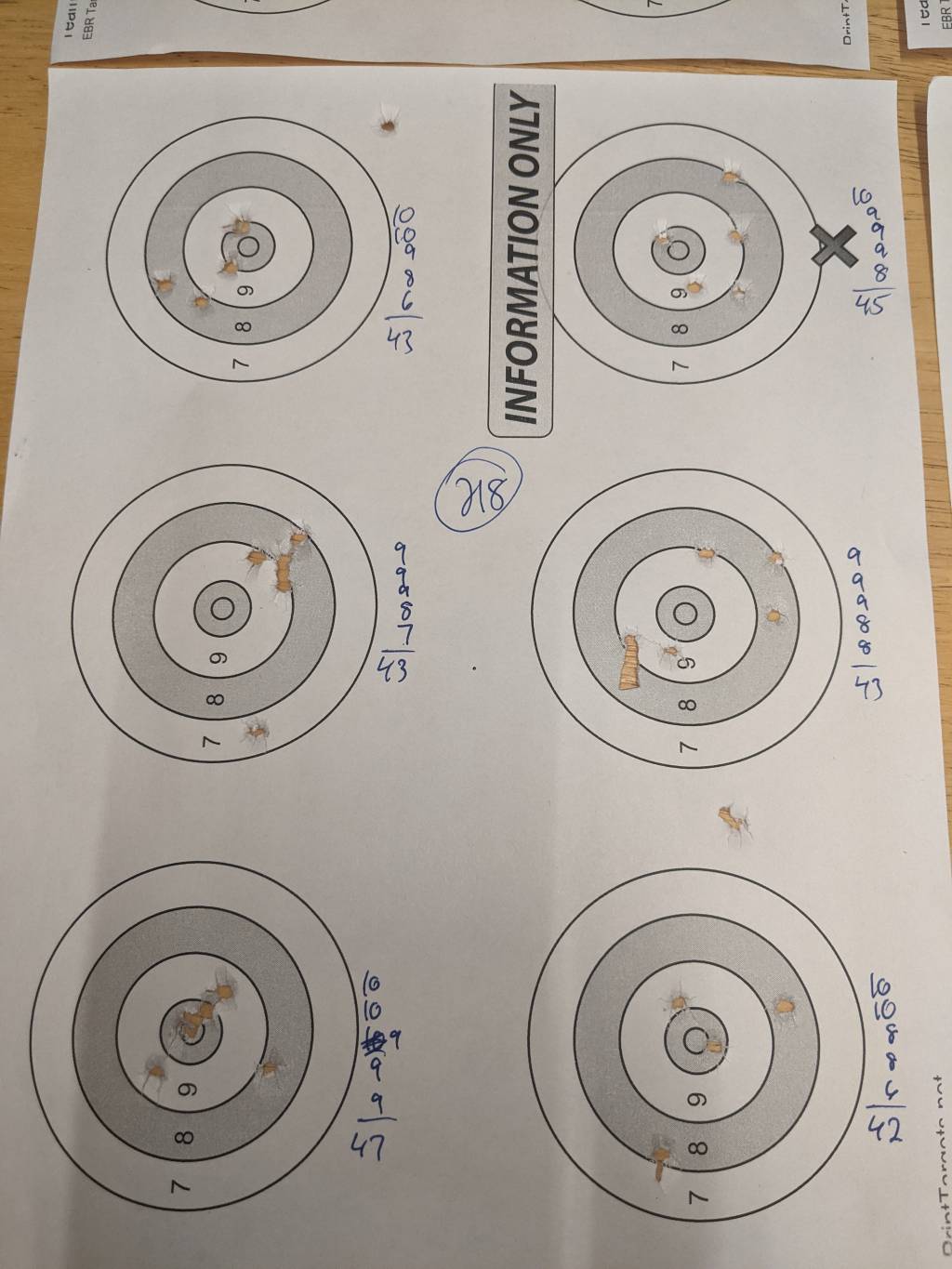

Scored:
Sorted comments:
Highest two aggregate scores were with sorted pellets. In 60 shots, there were only two sixs from sorted pellets and it was because the wind switched on me. I can live with changing winds, I can't live with pellets flying in a schizophrenic manner. NONE of the sorted pellets flew erratically or impacted somewhere that was screwy. Average 5 shot group score - 44.92, basically 45.
Unsorted comments:
Lowest two aggregate scores were with unsorted pellets. There were some really good five shot groups but they were the exception, not the norm. My assumption is that random draw from the tin equated to five "good" ones in a row on the good groups from the unsorted pellets. By rough count I'm seeing 7 sixs. One didn't even hit the paper, another impacted 6 inches from where it should have, and the others were two or more inches from where they should have been. Average 5 shot group score - 43.1.
So, it appears that, in this small sample size from this gun, from this lot of pellets, with me shooting, sorting nets roughly two points per five shot group, and 10 points per "card".

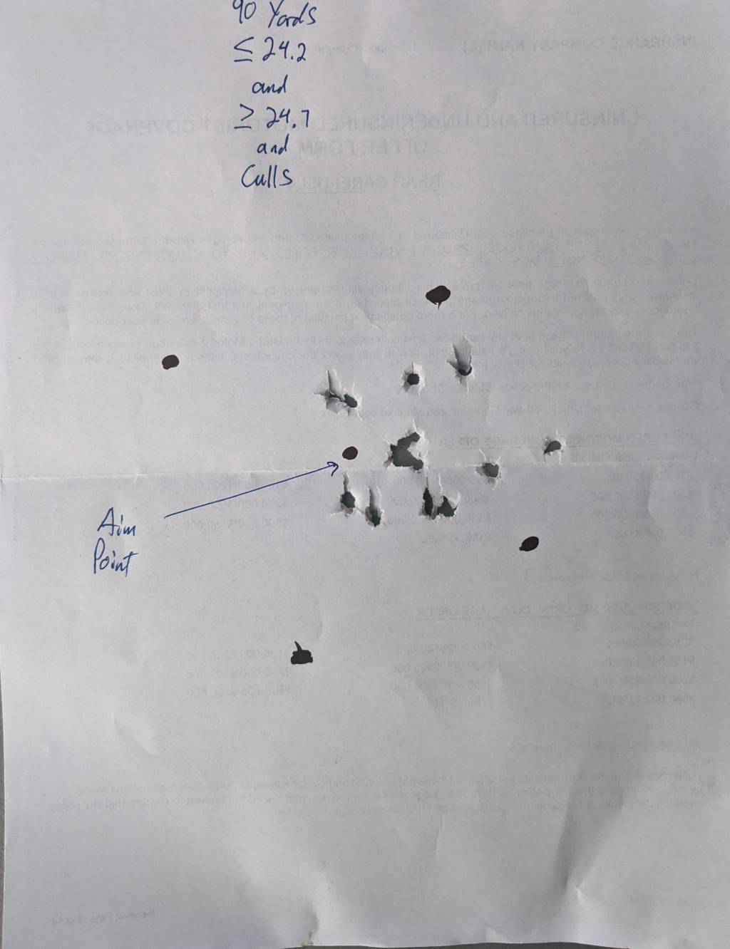

I shot the 13 worst pellets at 90 yards, just to see how much they'd open up, and here it is.
Handwritten typo on the photo, should say less than or equal to 25.2 grains, greater than or equal to 25.7grains, and the culls (visible defects).
There are five black marker dots, in the pattern of the five side of a pair of dice. Aim point was the middle black dot.
2.5 inch group, ctc, which makes even the culls plenty accurate for pesting. I expected worse.
