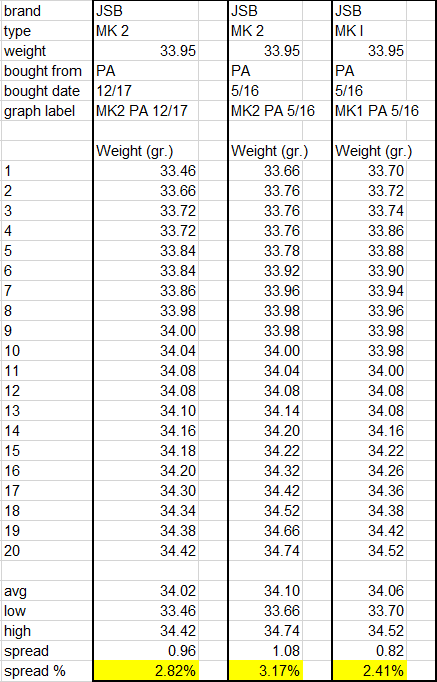

For what it's worth, I looked back at a sampling of pellets from 3 tins of the heavies bought at different times, and they showed a weight spread of around 3% (highlighted in the screen cap below).
It so happens that all 3 tins grouped well at my usual practice range of 50 yards.
Note this is from a sampling of only 60 pellets but that's usually enough to find evidence of major outliers, which is usually what I'm more interested in.
