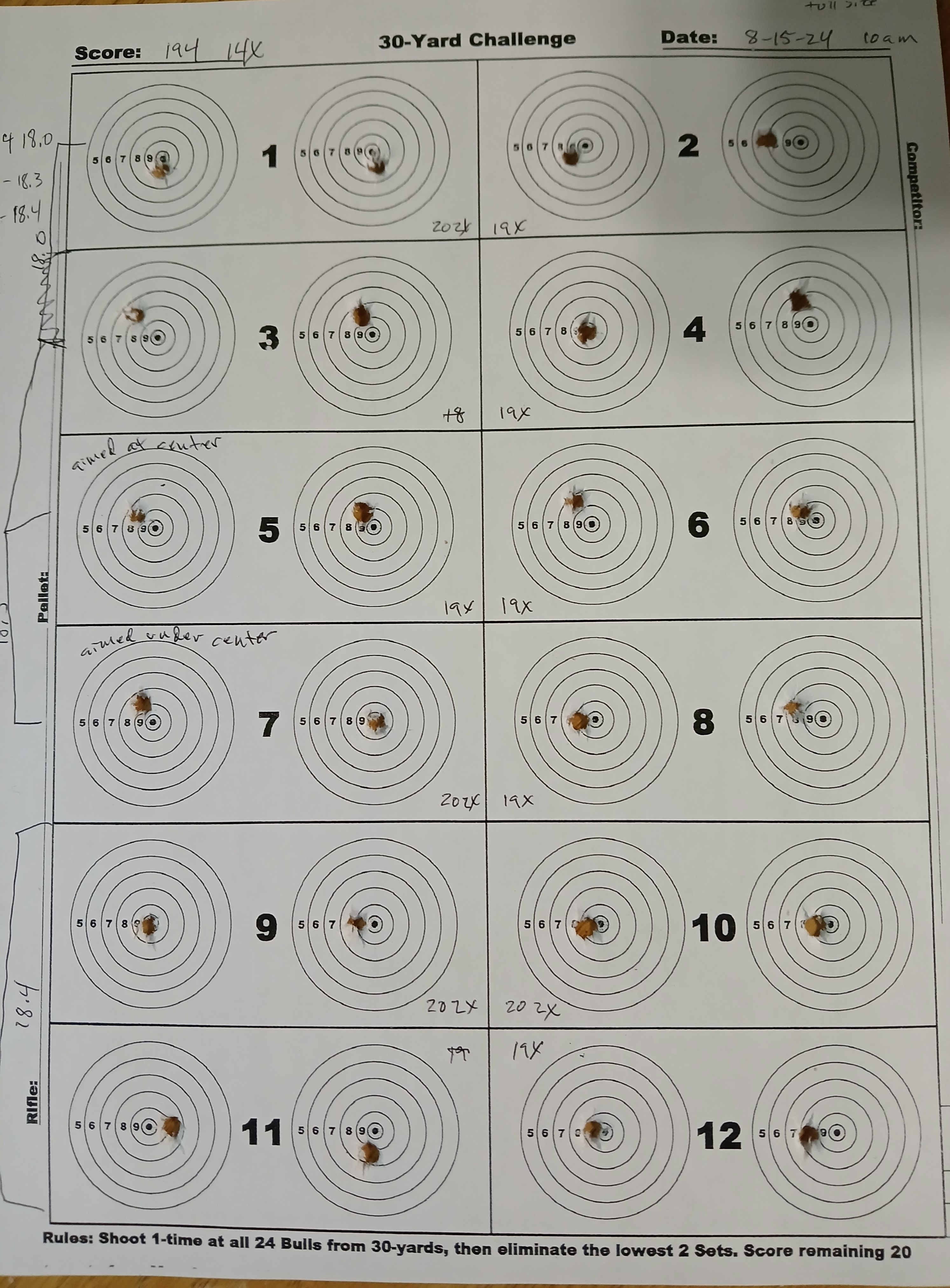

The most interesting part of this exercise was when I shot the more unusual 18.0, 18.3, and 18.4 grain pellets. I attached a target showing one of the two tests I did of weight. The top row of 4 targets is the 18.0s (all I had). The next 3 rows are 18.3s. The last two rows are 18.4s. 75% of the targets with 18 grain and 18.4 grain pellets were 10s. 50% of the targets with the 18.3 grain were 10s. 75% 10s would equate to a score of 195. 50% would equate to a 190 score. Not a tremendous difference but I decided it was worthwhile to do the weight sorting and sorted another tin yesterday. I shot another 199 with 17xs with it. Good but not better than the best with the unsorted pellets. I'll probably keep doing it until I get a 200, however.

I shot another target a few minutes ago and I no longer believe it makes sense for me to sort H&N Baracuda 18s. Let me explain. After my initial sorting of a partial tin of about 150 pellets I shot the different weights on a couple targets one of which I posted in this thread. Both targets showed 50% 10s with 18.3 and 75% 10s on other weights. This was a total of about 16 targets with 18.3s, however. That is all I had. Mostly they are 18.1 or 18.2 grains, at least the ones I've checked (2 tins of different lots so far). Then I sorted an entire tin. I shot one more 199 with a tin of 18.1 and 18.2 grain pellets but no 200, yet. Today I tried shooting a target with nothing but 18.3s. It is attached. I shot a 194 with 6Xs if I remember right, it is on the target. Half 10s would be a 190 so that is better and I shot a 195 yesterday with my 18.1/18.2 partial tin yesterday. But what seals the deal for me is the last 10 shots.
I shoot left to right, then down, then right to left, etc.. I am minimizing turning the screw on my rear rest which controls windage. So I shot 1&2, then 4, then 3, then 5, then 6, then 8. At that point I was significantly low as you can see and I checked the reg (I shoot left handed so I have to pick the gun up to see it) and I was below the 100 bar reg setting. So I refilled and shot 7, 9, 10, 12, and 11. All 10 targets in this last sequence are 10s (some barely, I use a scoring plug). I was struggling a little with elevation before 8 so 5 and 6 might have been affected by the pressure in the tank too. But for sure with a full tank 18.3s shot as well as I shoot anything. 10 10s in a row is about as well as I can do. 18.3s are OK.
I already decided 18 and 18.4 shoot well so there seems to be no reason to sort. I also shot 3 199s with unsorted pellets. Just another evidence it doesn't hurt my scores to just shoot them straight from the tin.
