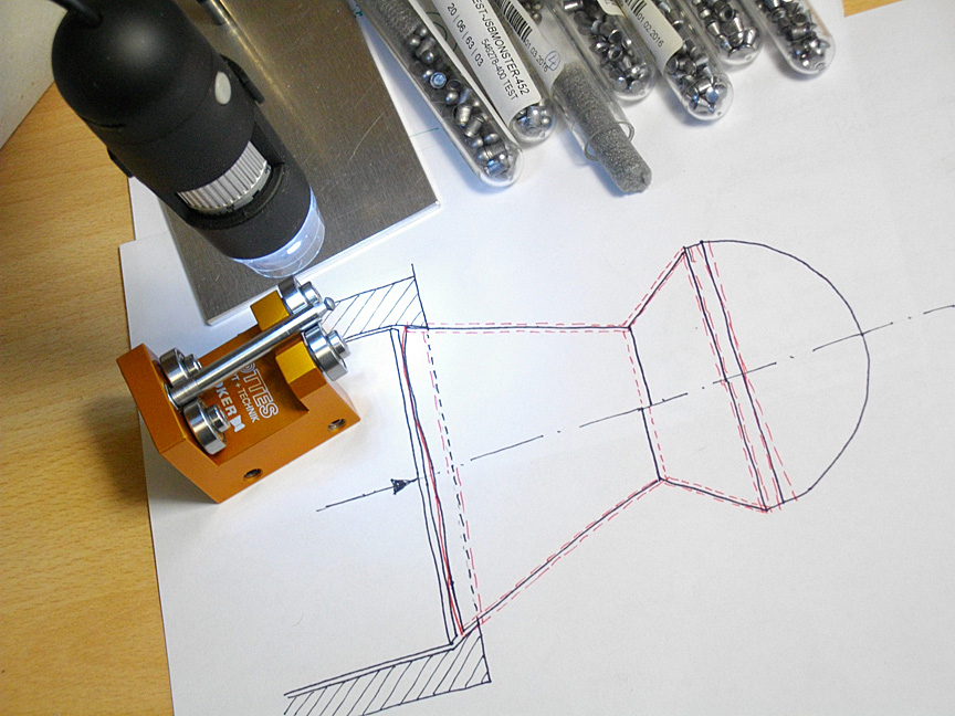

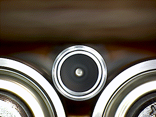

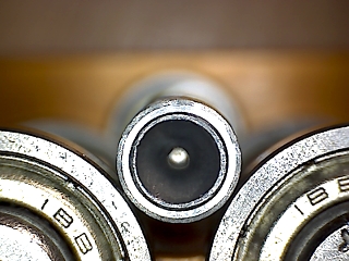

A few years ago I built a test device to look at the pellets. But the most important thing is to look at the pellets while they are moving !
I would like to write this article step by step. First of all, today I will show you good and bad holes on the back of the pellet.
What can you see? Nothing.

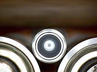

What can you see now?
Here are some more examples of good and bad holes.
Thanks, that's it for today.

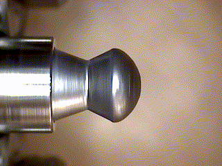

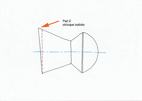

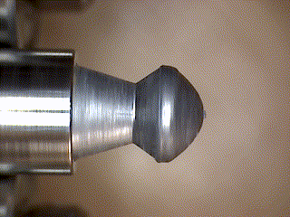

First, I would like to show you a real example of a pellet with a slanted rear end. This does not happen often, but even with premium pellets this defect can be slightly present.
The rear end is slanted and wobbles.

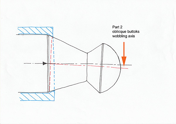

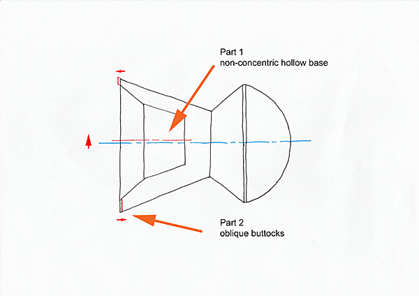

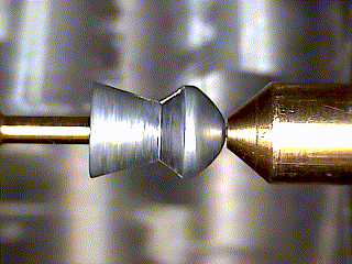

In my other test machine, the pellet is skewed and the axle wobbles.
Finally, an illustration to think forward and backward.

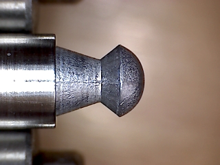

Hello,
today I make the last step. I'll show you the most common mistake that can cause poorer precision or a flyer with pellets.

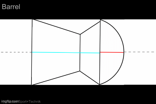

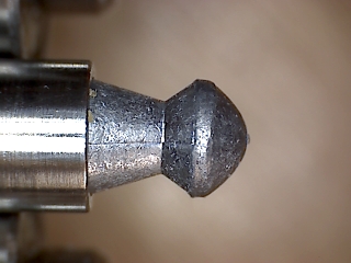

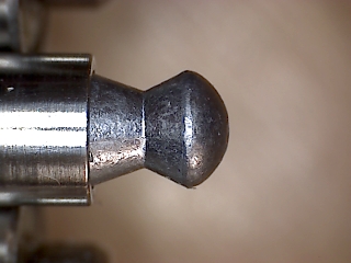

If the head of the pellet is bad, the hit is also bad. More precisely, it is the eccentricity or the concentricity of the pellet head.
A good pellet.
A bad pellet. The head is not centric to the two cones.
As an example, an electronic hit record of many tests I have done.
I wish all those who weigh, measure, roll, wash, and lubricate pellets much success. The fliers will not disappear.
NoLimits
