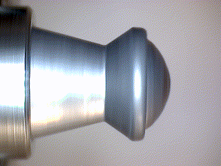

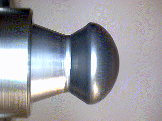

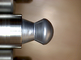

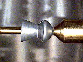

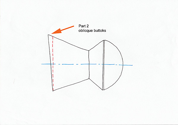

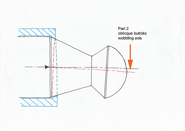

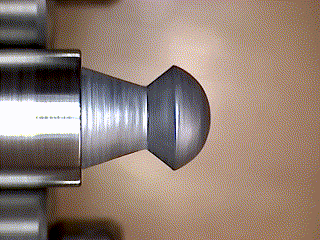

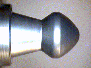

First, I would like to show you a real example of a pellet with a slanted rear end. This does not happen often, but even with premium pellets this defect can be slightly present.
The rear end is slanted and wobbles.
In my other test machine, the pellet is skewed and the axle wobbles.

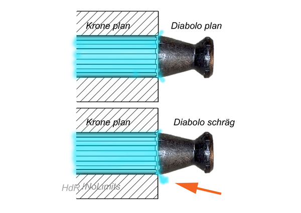

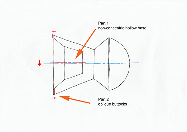

Finally, an illustration to think forward and backward.

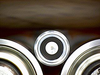

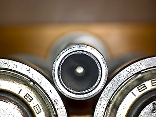

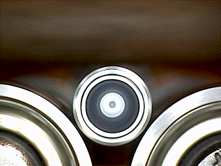

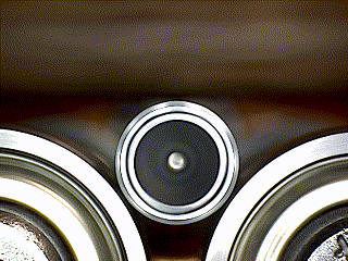

A few years ago I built a test device to look at the pellets. But the most important thing is to look at the pellets while they are moving !

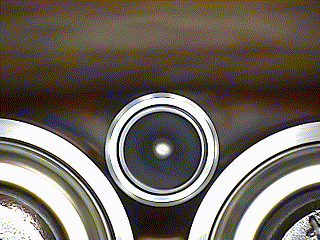

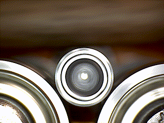

I would like to write this article step by step. First of all, today I will show you good and bad holes on the back of the pellet.
What can you see? Nothing.
What can you see now?
Here are some more examples of good and bad holes.
View attachment 170685View attachment 170690View attachment 170697View attachment 170700View attachment 170703View attachment 170707
