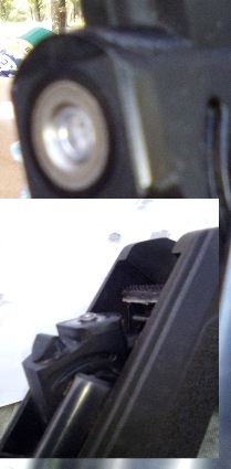

Fit is most important . A pellet that seats in the leade correctly . Loose pellets can cause premature piston seal spring damage from not enugh back pressure and then you get slamming .
Like if you pull the piston and see somthing like transfer port marks a few maybe fine but too many it could cit a chunk out in that area of a seal.. ive only had 2 i let go that far and thats several 1000's of shots... Anyway a properly seald gun and pellet is pretty spot on target and consistent. One thats not is not so much.
Skirts are oversized by a few thousandths of an inch, and are forced into conformity with the bore by the blast of air pressure. I have in some cases observed a subtle bump in velocity by flaring thick-skirted pellets for low power airguns (CO2, MSP at low pump counts, etc.), but every credible test I've seen or done myself has shown no meaningful benefit to accuracy by sizing skirts.
I could see that working somewhat on the loose ones . Sure could not hurt for sure. The pictures here are pellets just droppen in on there own weigh. the top is just helpless the bottom you can srat nice. .. but i may try your thing on them smalls and see. In the end your just not getting any head just a bit of up skirting🤤
