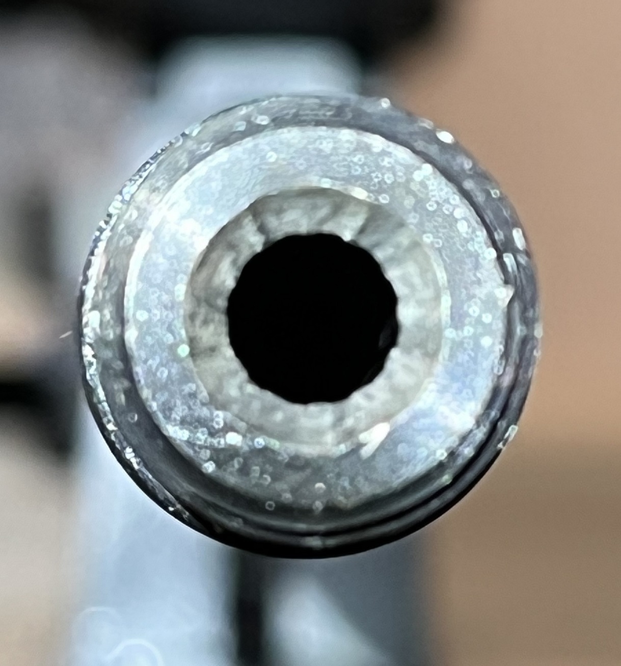

After that took a closer look at the barrel. Crown was looking like someone did it with drill and drill bit with an angle of 90 degrees, and drill bit chattering. And it was deep. Doing all that I was so into it that forgot to take before picture of that crown. Anyway did a new crown. Did 11 degree crown protective face and little 45 degree crown.
Yeah unfortunately SPA’s barrel machining has always been pretty horrid. Which is a shame because their barrels tend to be quite good once the workmanship defects are corrected. The silver lining in this particular case is that they did not trash the rifling at the muzzle with a piloted crowning tool like they did on both of my SPA rifles purchased years apart. At least I don’t think so, it’s hard to tell in the photo.

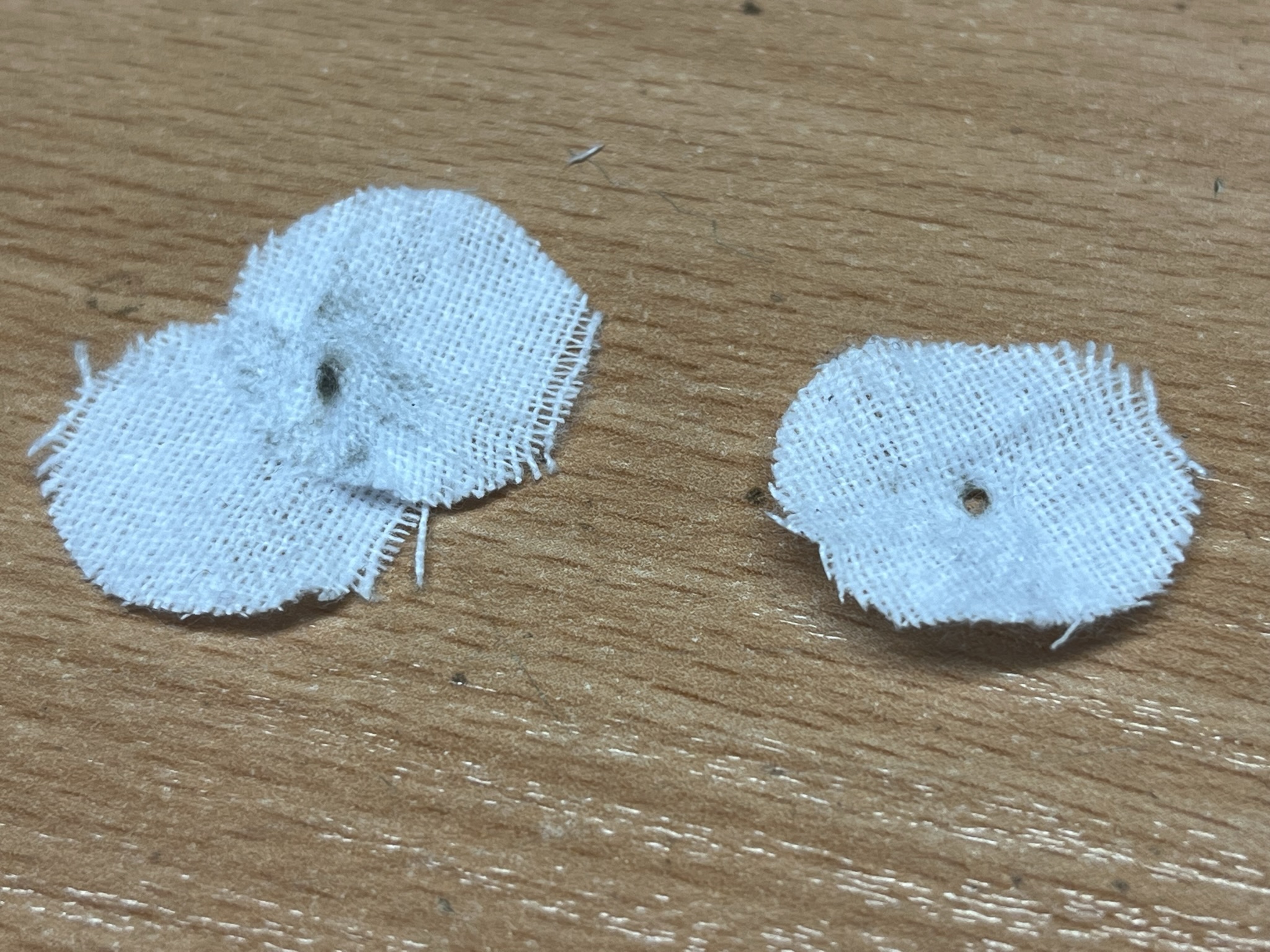

I'm using patchworm and 7/8" patches and 4.5mm felt buttons for cleaning and when pulling them through I can feel them twisting pulling cord.
For tightness wise, I sometimes combine 2 patches like this, the one on the left:
