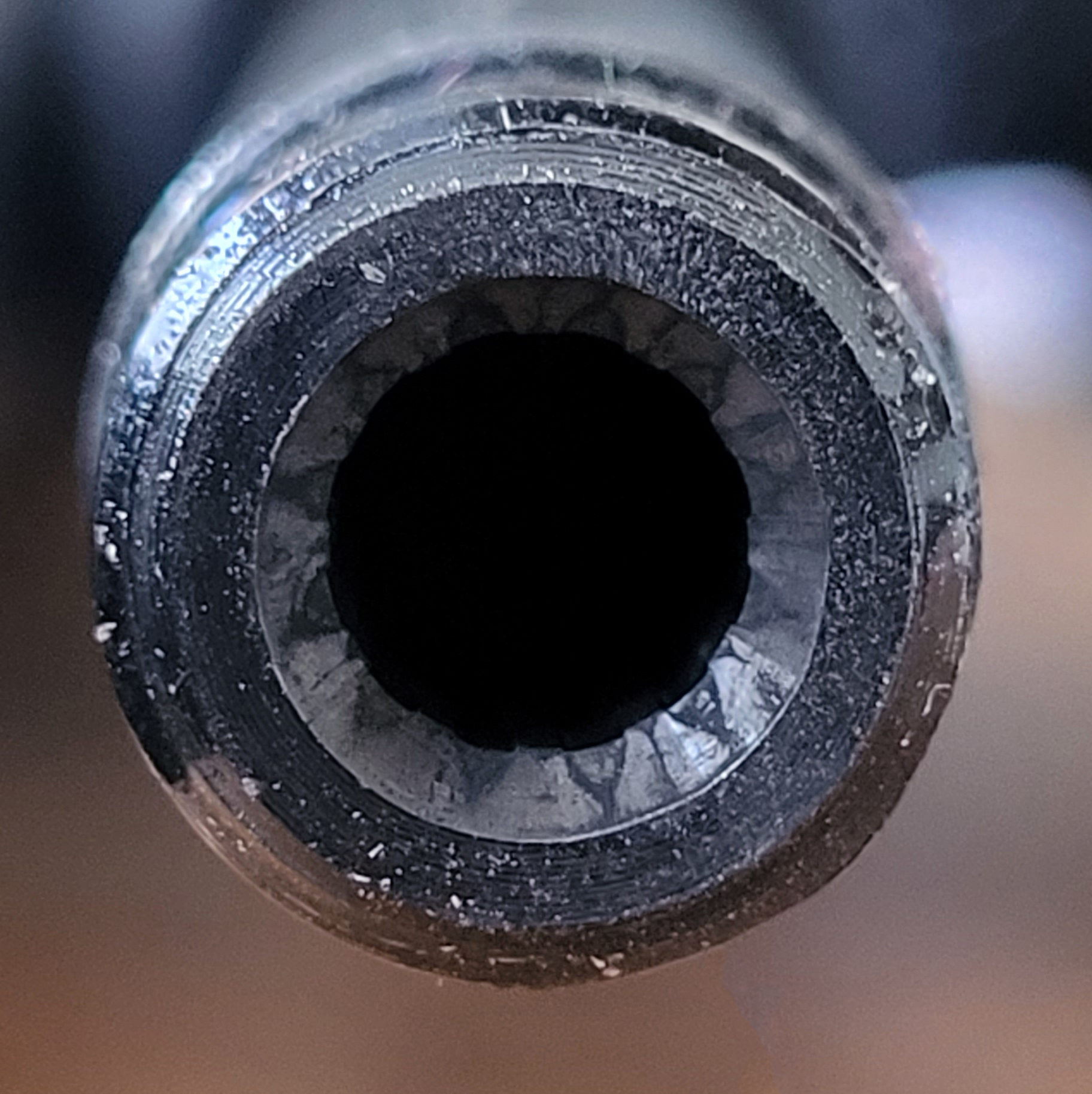

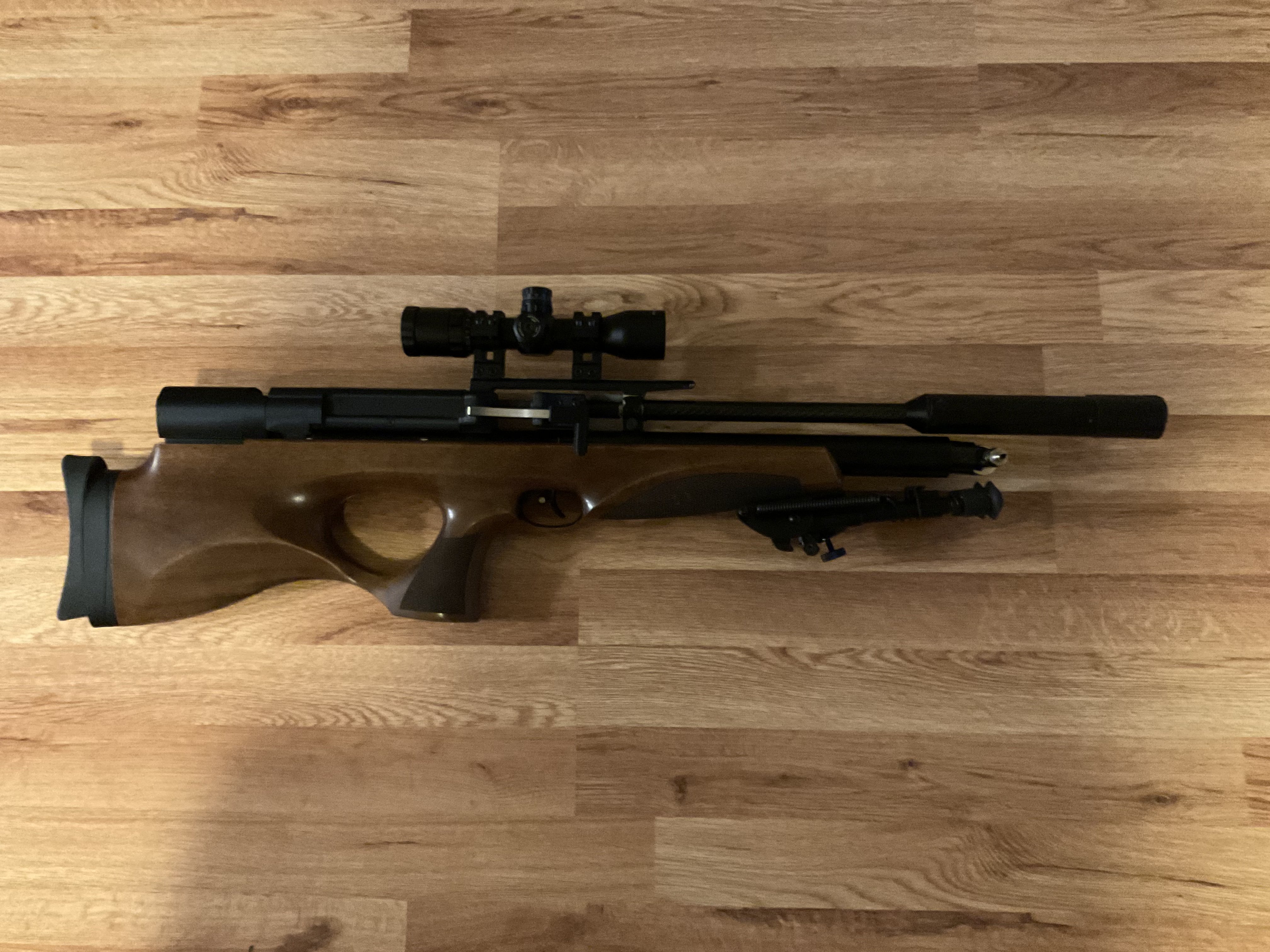

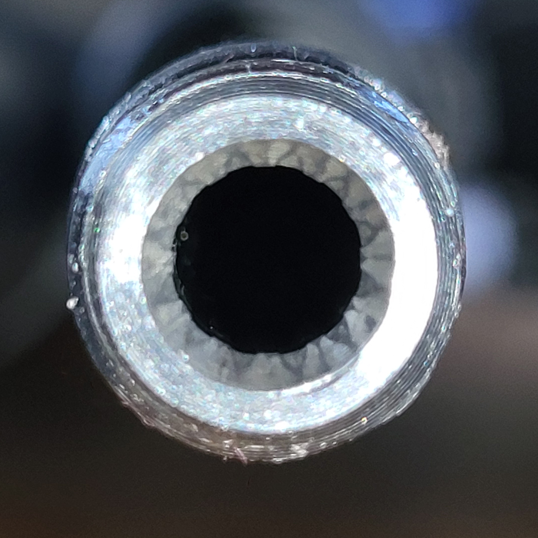

I got this P35 in a .22, and I’m having trouble with it. The gun was bought for pest control at 20 to 40 yards. I guess something’s up with the barrel as I’ve read up on SPA’s barrel lottery a bit, but I’d love a diagnosis from someone knowledgeable as this is my first PCP (after lots of break barrels).

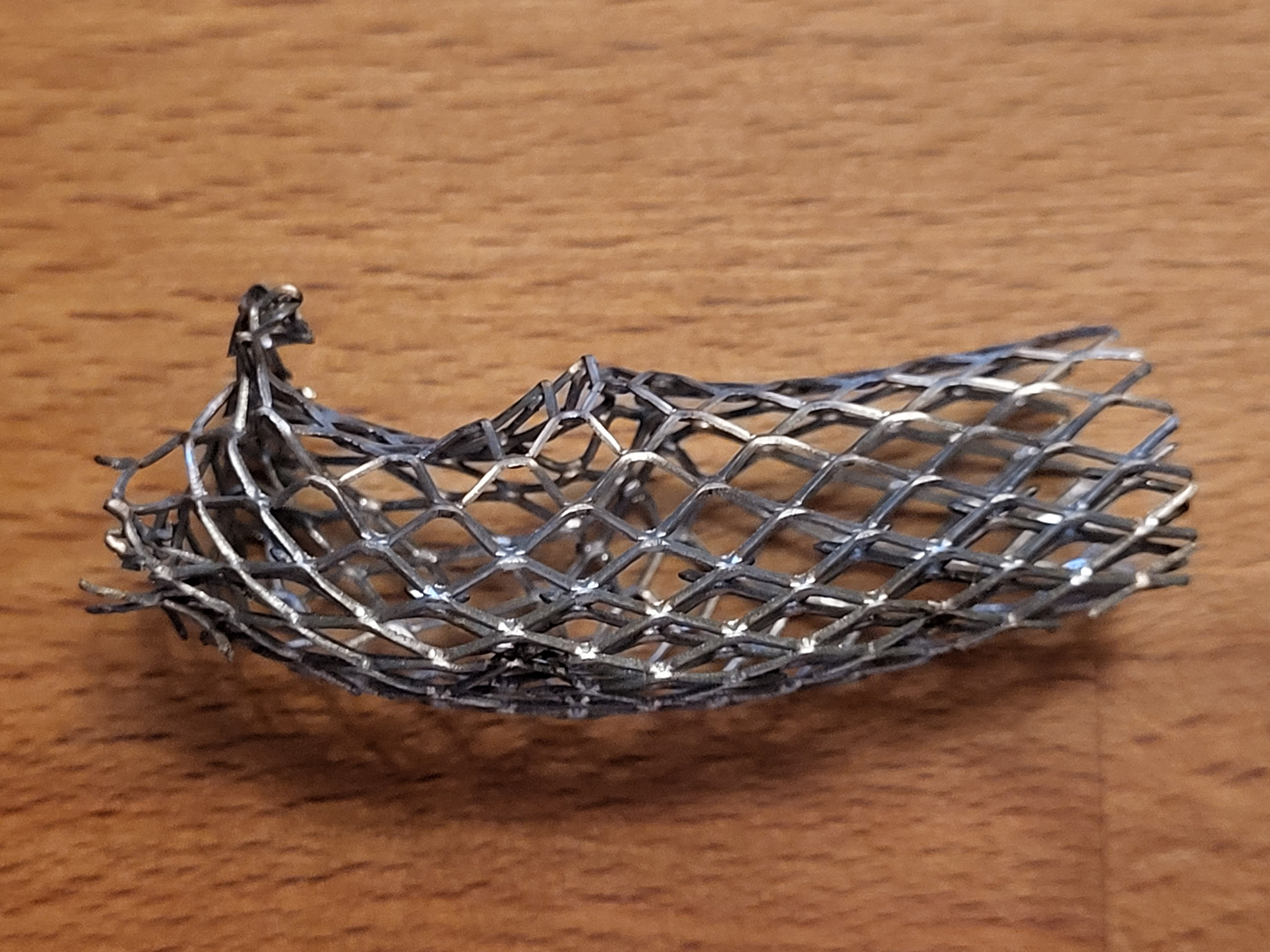

After a few 100 pellets, some baffles in the shroud already got clipped and deformed. Removed the clipped baffles and replaced ‘m with a tube (to keep the rest of the baffles in place). Then a few 100 pellets later, the inside of my Huma moderator got clipped and when opening it up, lead debris is found inside. When I shoot from about 2 yards inside the house through an opened window, I noticed tiny lead debris up to 2 feet next to the window embedded in the white wall. For some reason this gun spews lead debris, which I suspect of doing the damage, but something's off.
