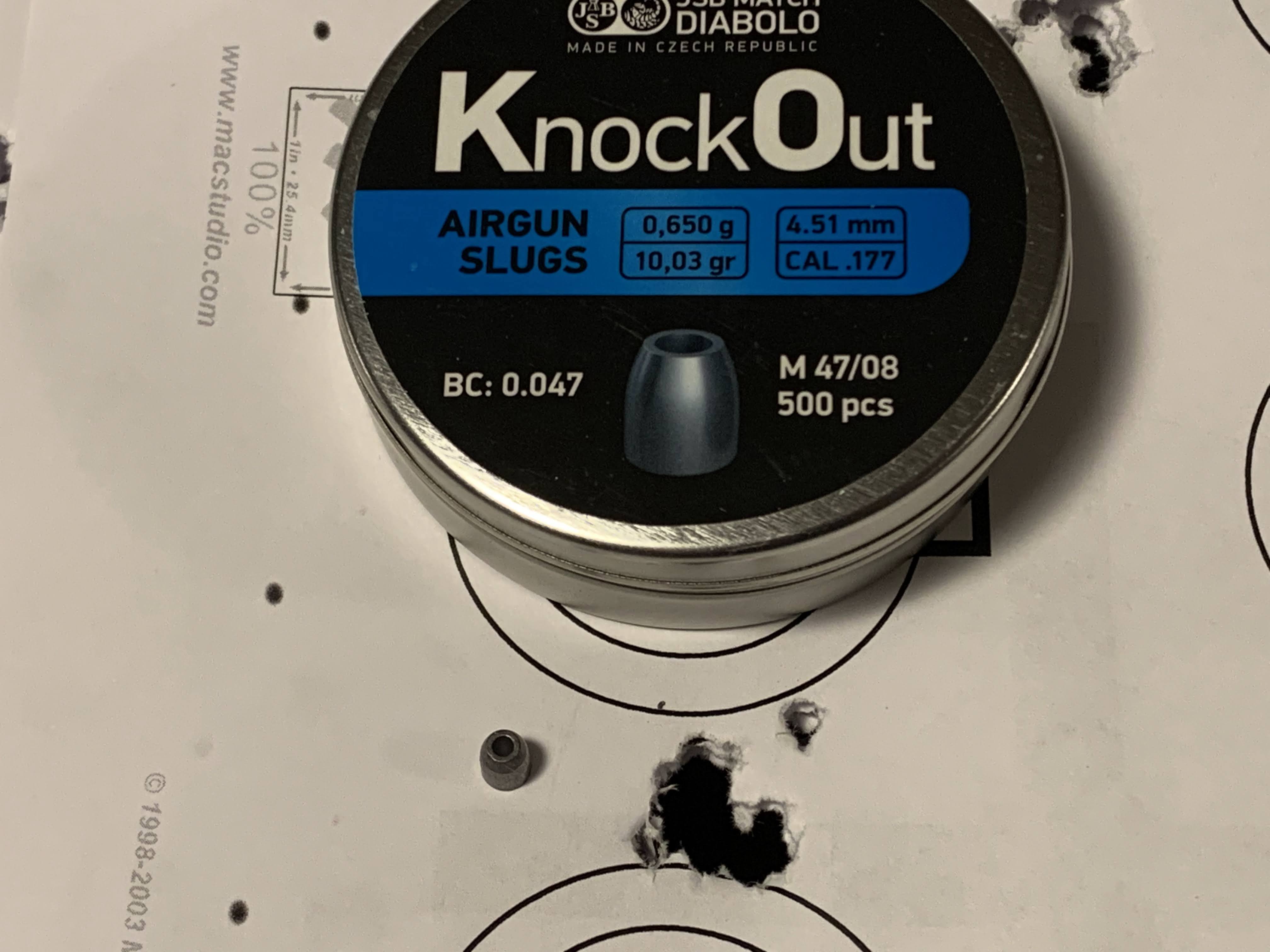

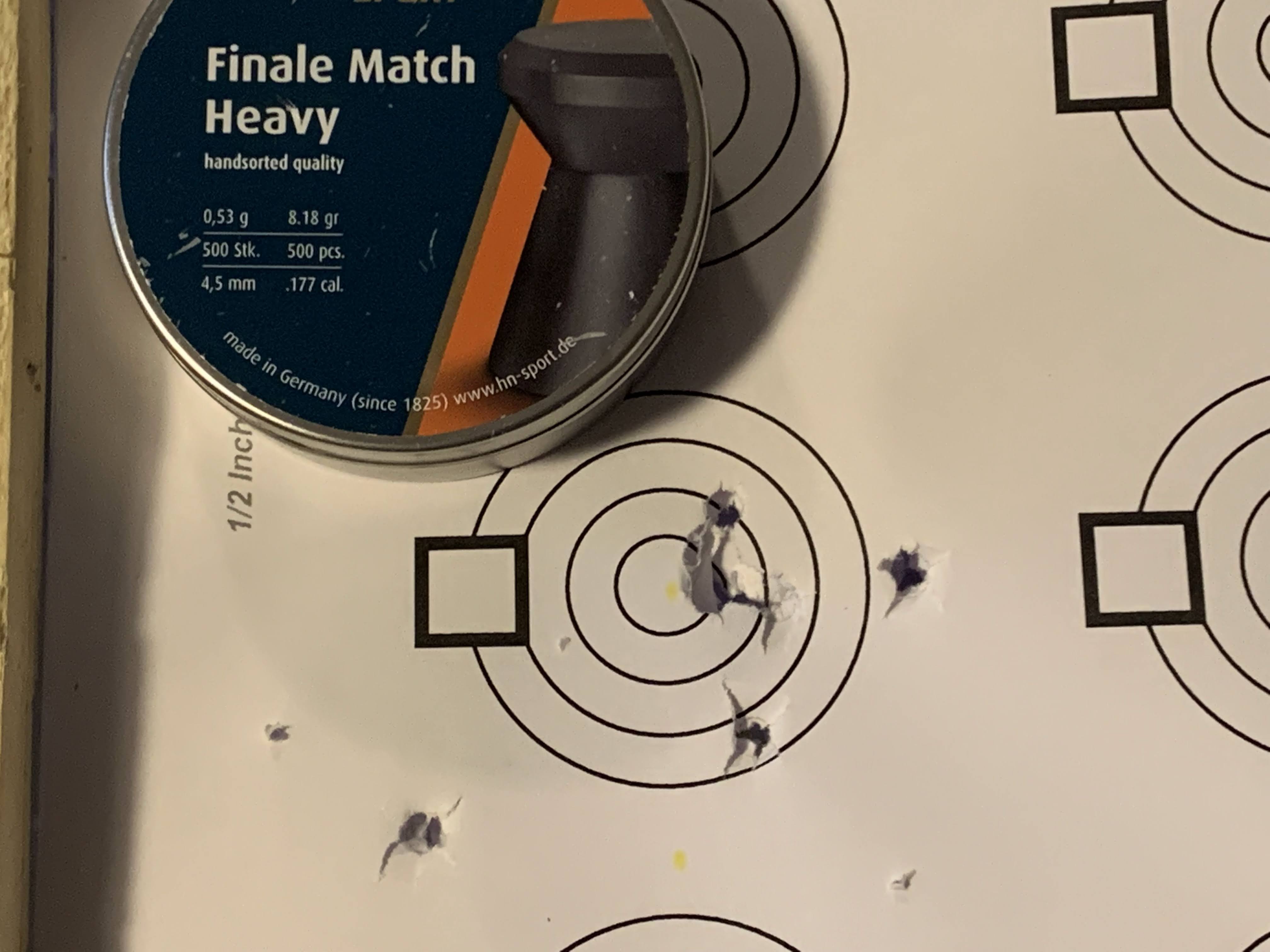

I've also had problems getting accuracy with any pellets from my P35 in .177, then a friend told me about Autosol polish cure and I to give it a try
After that its doing great with a few different pellets and JSB KO 10.03 gr
The pellets are with 980 fps and 9 shots at 60 m
JSB KO are with 885 fps and a lot of shots at 32 m

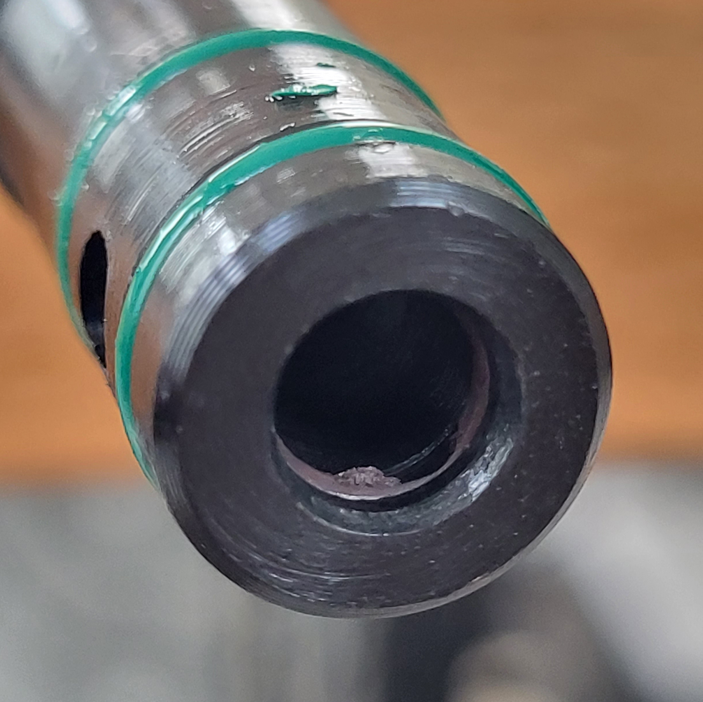

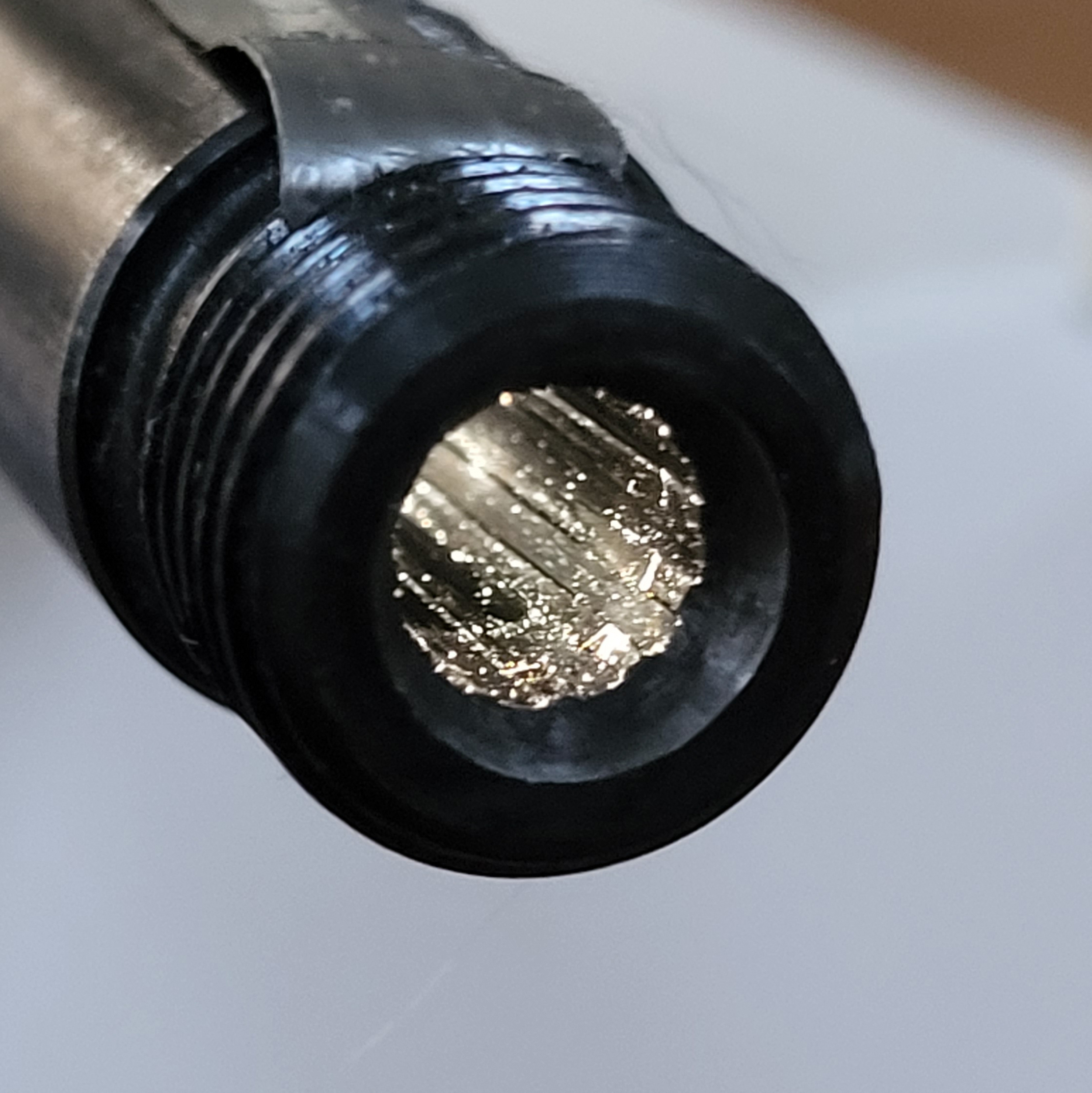

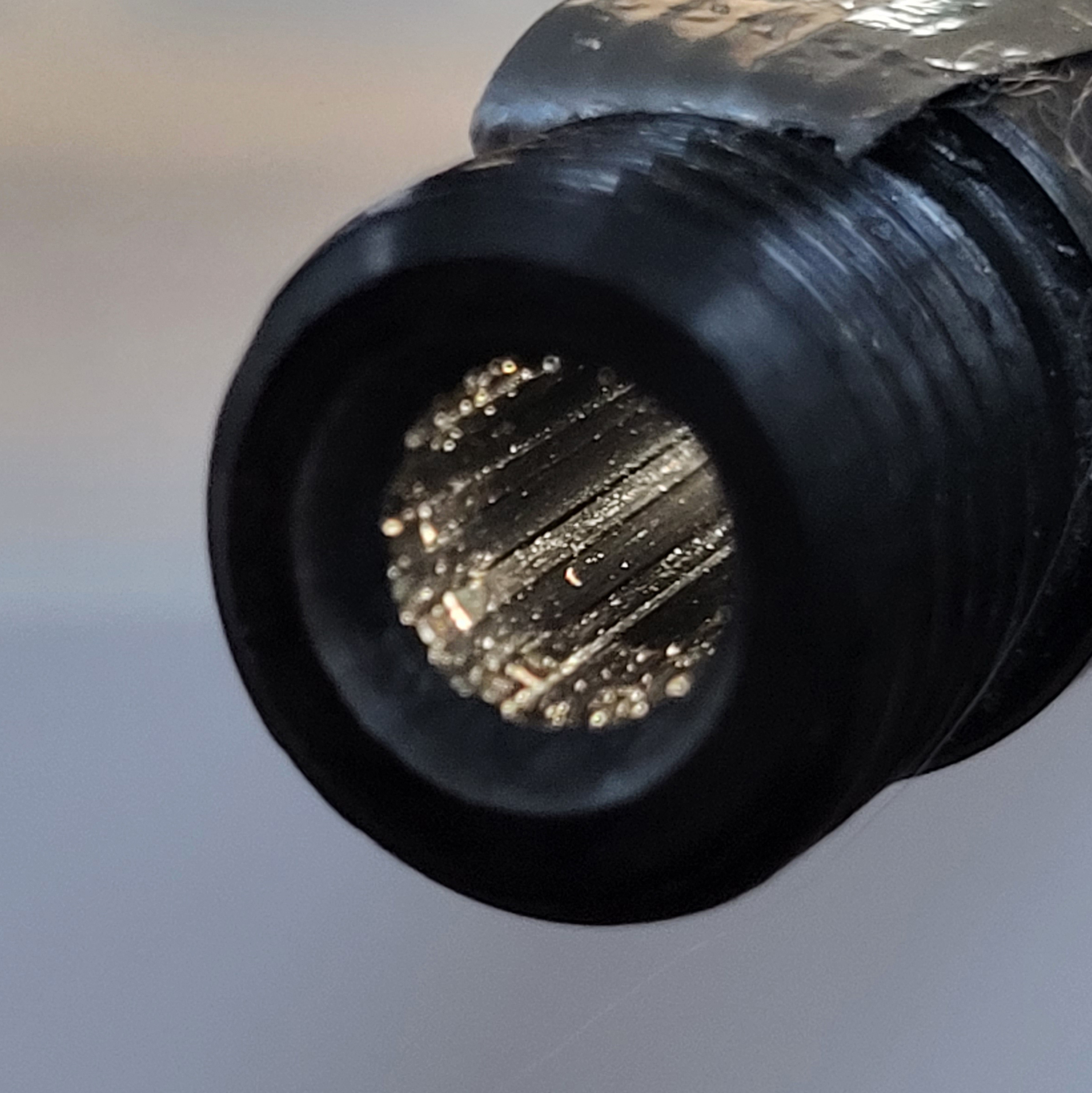

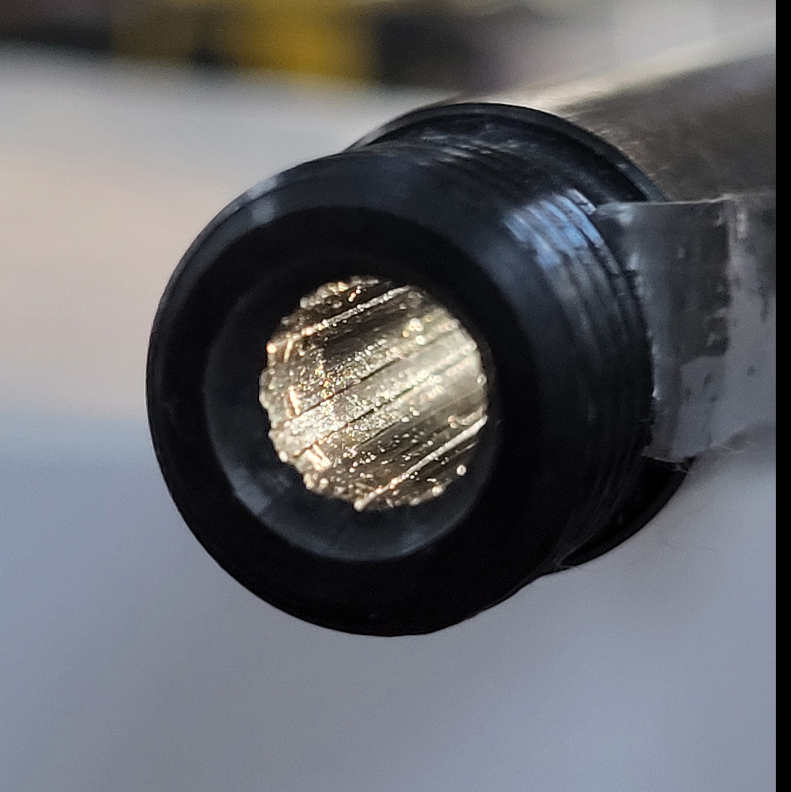

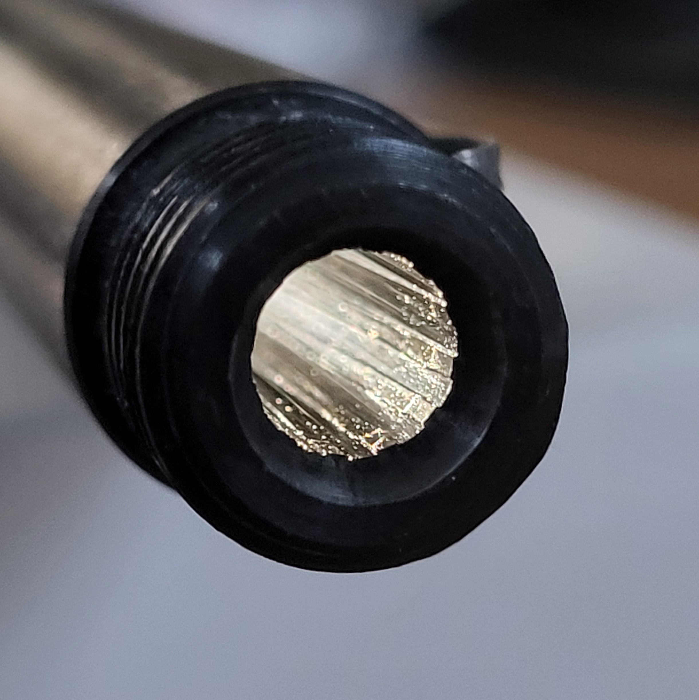

So I took the barrel out of the P35. It looks straight. The inside ring that holds the pellet does look damaged somewhat (see pic). No burrs to spot and looks smooth.
When pushing several pellets through the barrel, they do not pass uniformely smooth, as there are places in the barrel the pellet clearly needs to be pushed a little harder as it feels like it's suddenly getting more traction from the inside of the barrel, as if the barrel is just a fraction less wide in those spots. In the end of the barrel, for about the last 0.6" the pellets definately need an extra push to to get them through. I measured those other spots where the barrel seems somewhat narrower, as form the breach end of the barrel, at 12.8", 14.4", 15.2", 16.3" to eventually need an even harder push as from 16.5" till it drops out of the barrel at some 17.1". It really feels as if there's an irregular resistance on the pellet along the way and certainly at the end. I would've expected that to be more smooth and regular as it almost feels as if the inside of the barrel suddenly is scratching the pellet. Is that normal?
Finding roughness along with alternating loose and tight spots…is it normal? Yes, unfortunately. Desirable? No, but neither does it condemn the barrel to perform poorly. And it very likely can be improved with a modest effort _if_ it does not have the defect I described earlier so let’s revisit the topic.
The last little constriction at the muzzle could be a good thing or a bad thing depending on the nature of it. A good thing if it is simply a modest constriction. A bad thing if it feels tight because they mangled the rifling with a piloted crowning tool per the examples shown the “SPA still doesn’t get it” thread I linked to on p1. If present, it will be easy to spot with the naked eye by simply looking into the bore at a shallow angle with a source of light behind it. If so, the only viable options are to either return it or have someone remove the offending portion and recrown the barrel.
Your close-up photos are quite good so if you are unsure of what you’re seeing, post up some pictures for comment.

This is when all the happiness of how fast Krale ships and how good their prices are ends. I have also bought junkers or questionable quality guns from Krale but I have a machine shop. Good luck. For your needs and the distance you plan to shoot, why didn’t you just buy a gun like an Akela or Puncher Breaker from a US distributor? My advice is if you want to order from Krale but don’t want to fix guns, order a quality gun from them. The whole return process and distance/downtime doesn’t sound like a good airgun experience.
I wish there were something more optimistic I could say but no amount of polishing will fix the rifling that has been smeared and abraded at the muzzle. Most definitely not with felts and J-B or via fire lapping, nor even with a cast lap and something more aggressive.
Granted there is no harm in trying because it is in no condition to work acceptably in its present state, and one may indeed succeed in improving it but not to the extent that it would be considered fixed. The fix is a chop and recrown.
I lack the words to adequately express my disgust at SPA for this continued incompetence and apathy.
