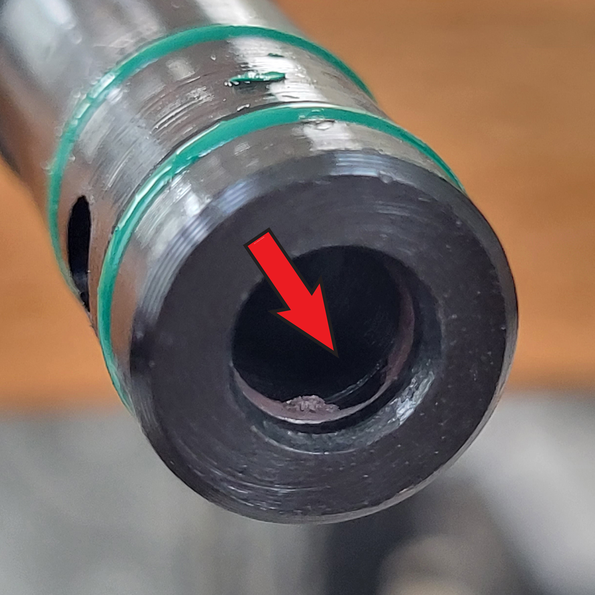

That looks like pellet probe is pushed to the side by magazine internal spring.
I took my magazine apart and loosened the spring pre-tension, also deburred and rounded pellet hole edges of magazine. I deburred pellet probe and polished it.
At firs, pushing pellet from mag to lead, mag cut piece off of a pellet. Pellet probe transfer hole edges were sharp to touch with finger tip.
Now it moves smoothly like my FX.
Also took my P35 completely apart and did lots of de-burring, smoothing, polishing. To barrel - lead de-burring and polish, crown was awfully cut, but rifling was ok. so managed to get away with re-crowning it in the lathe. Bore was true to OD.
