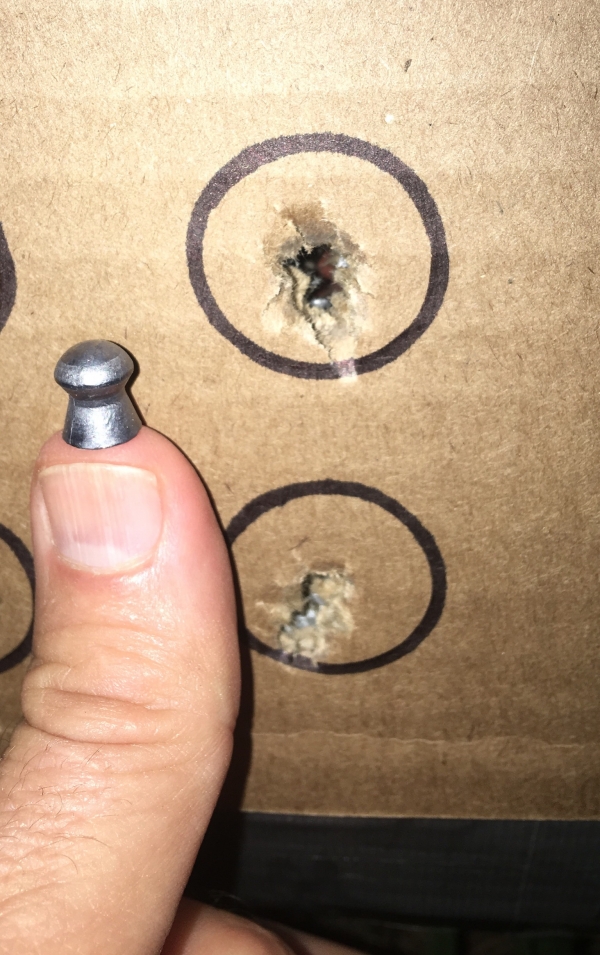

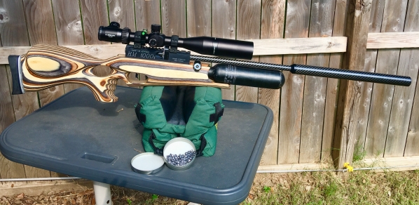

I received all today. Put my Athlon on and tested. Shooting the 44.75 gr at 870 fps. I’ll stretch it’s legs at longer ranges tomorrow and compete in a long range benchrest silhouette match Saturday. I haven’t tried the .25 yet but I am really impressed with the .30 kit. Here are a few pictures and 5-shot groups from 40 yards which is the furthest distance I have at the house. I think this RAW is ready to rock! Love the precise position adjustability that the Rowan trigger provides. Will continue to update in the RAW Report as things progress. I have a good feeling about this ?
